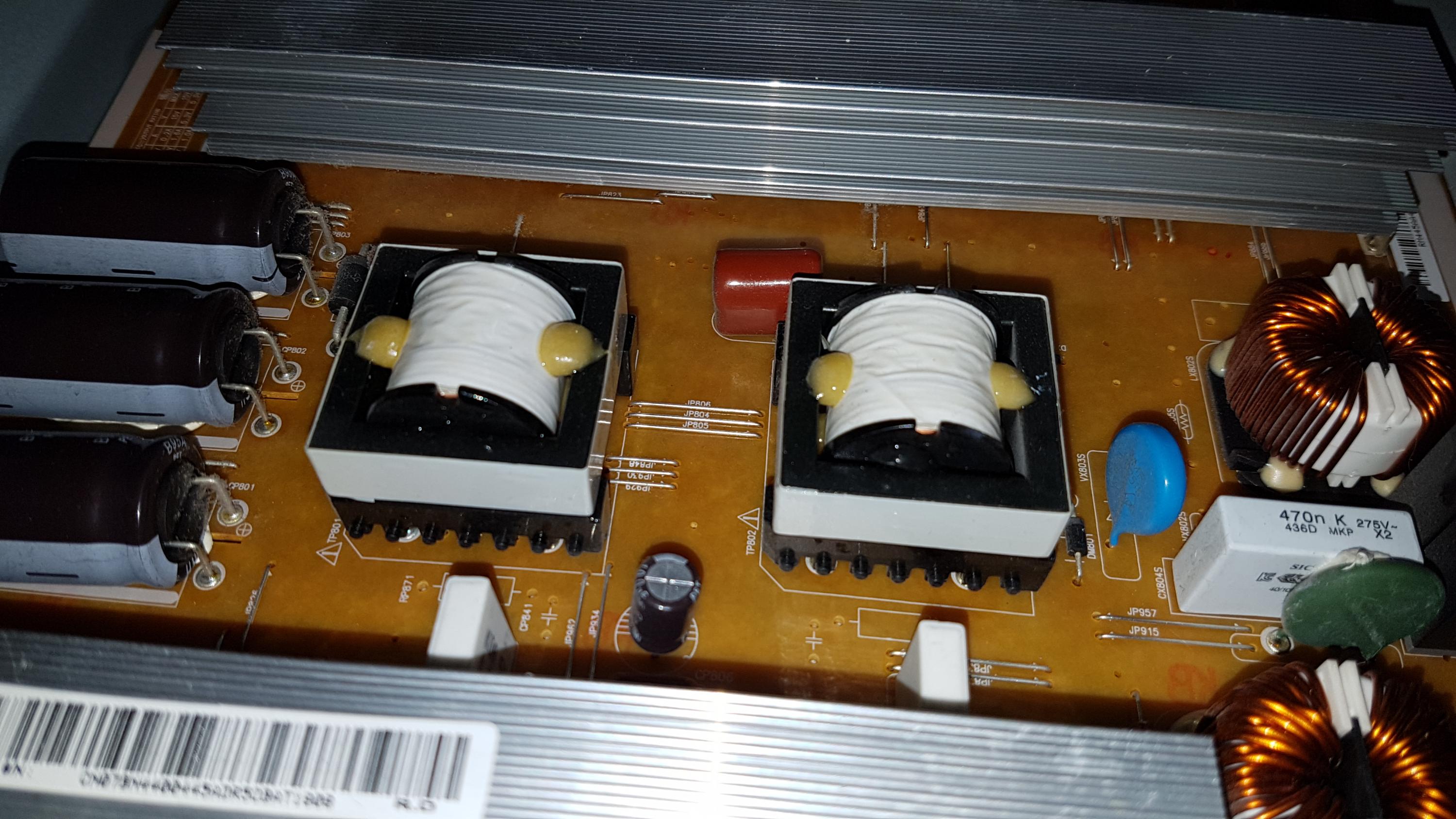

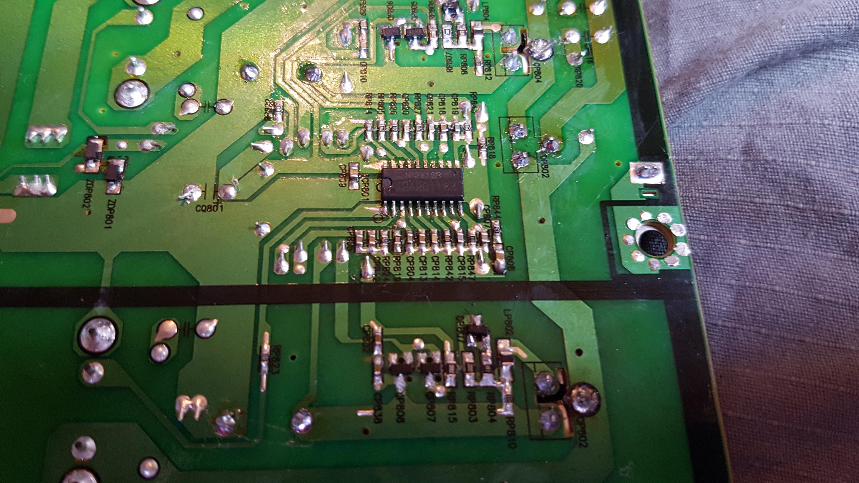

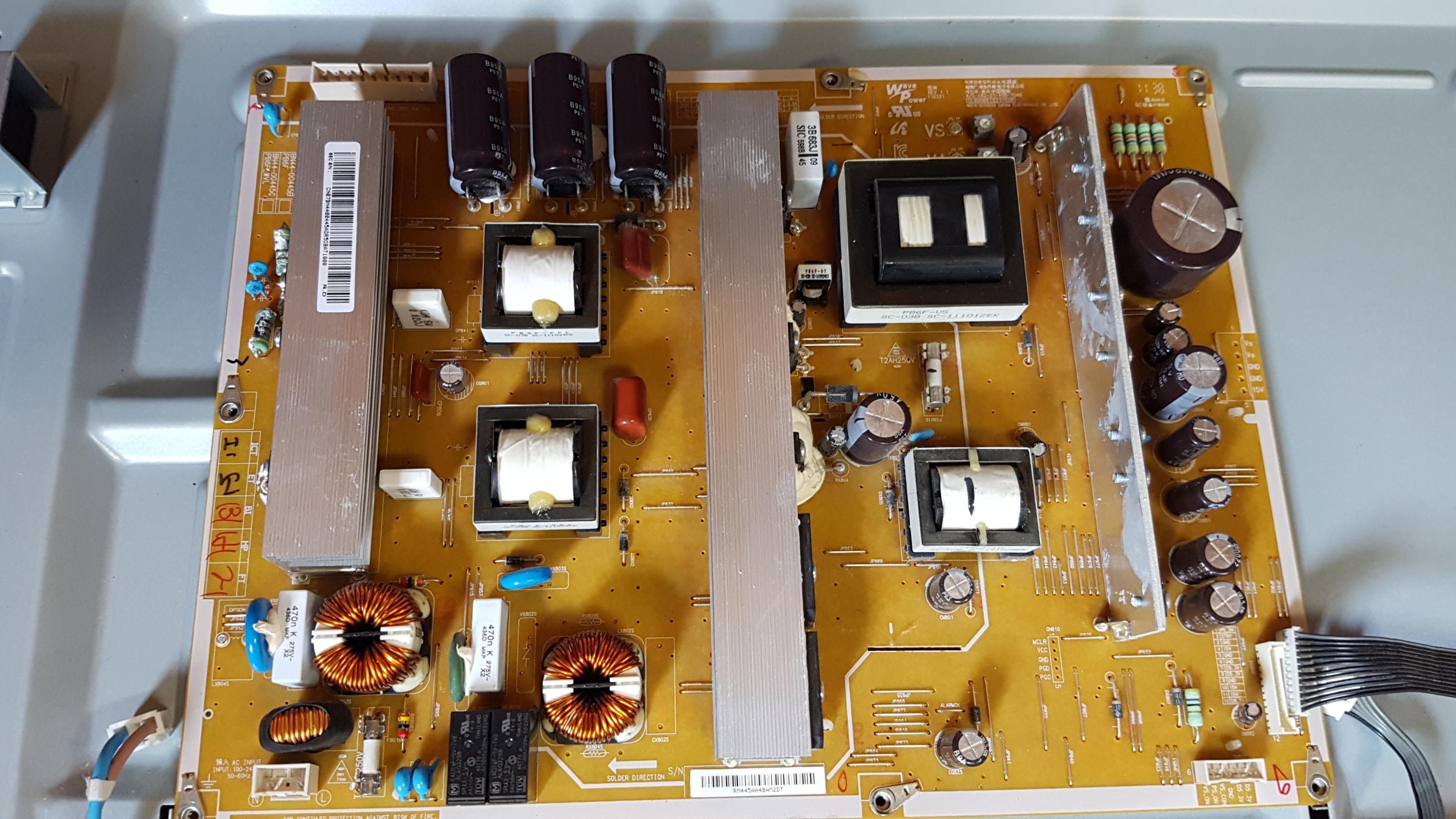

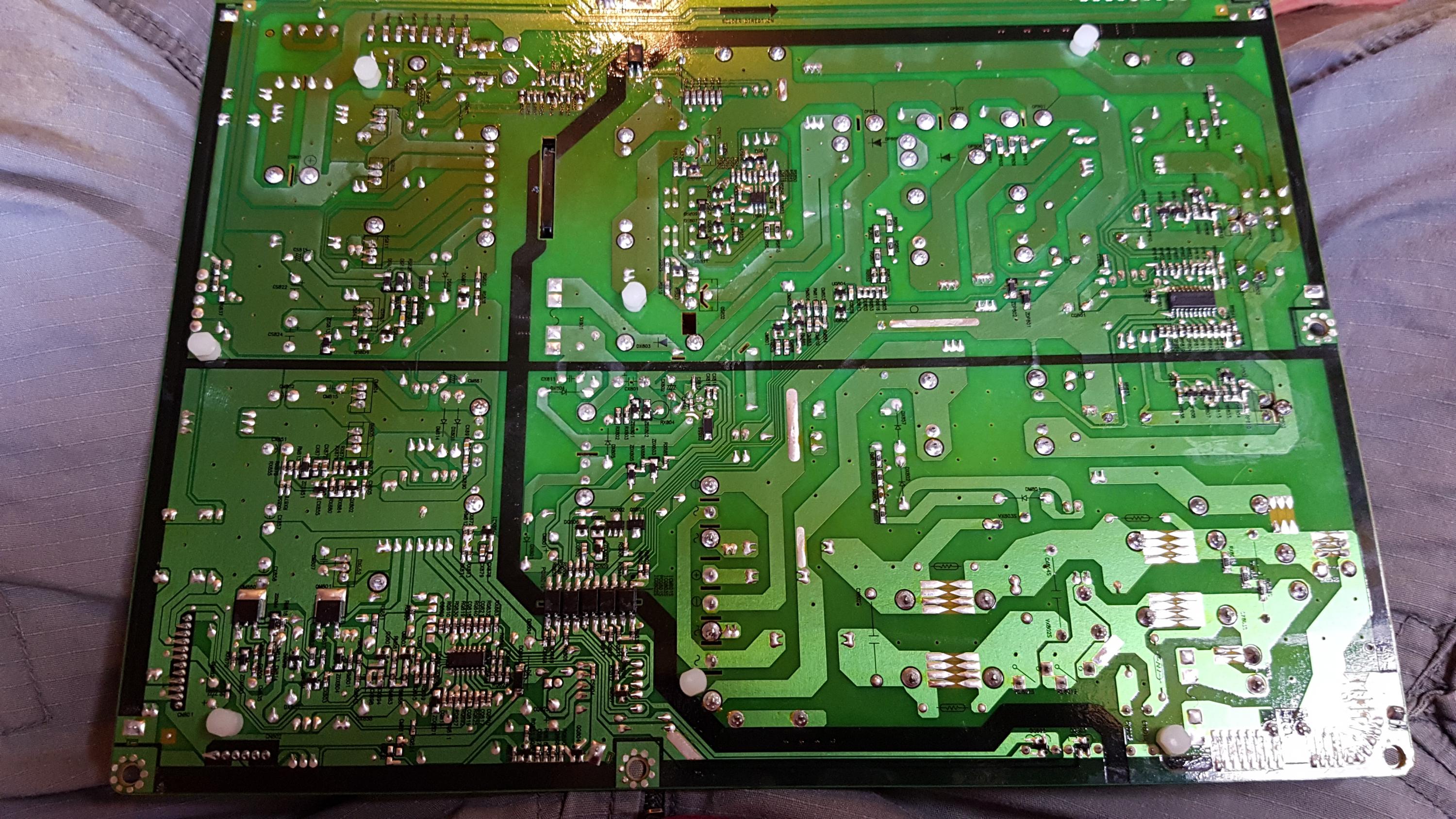

    Here are some pictures I took of the board. I see a little black plastic coming out of a coil .. I do not know if it is normal. My multimeter is not good enought to get any reading out of it, I'll have to go see my neighbor !

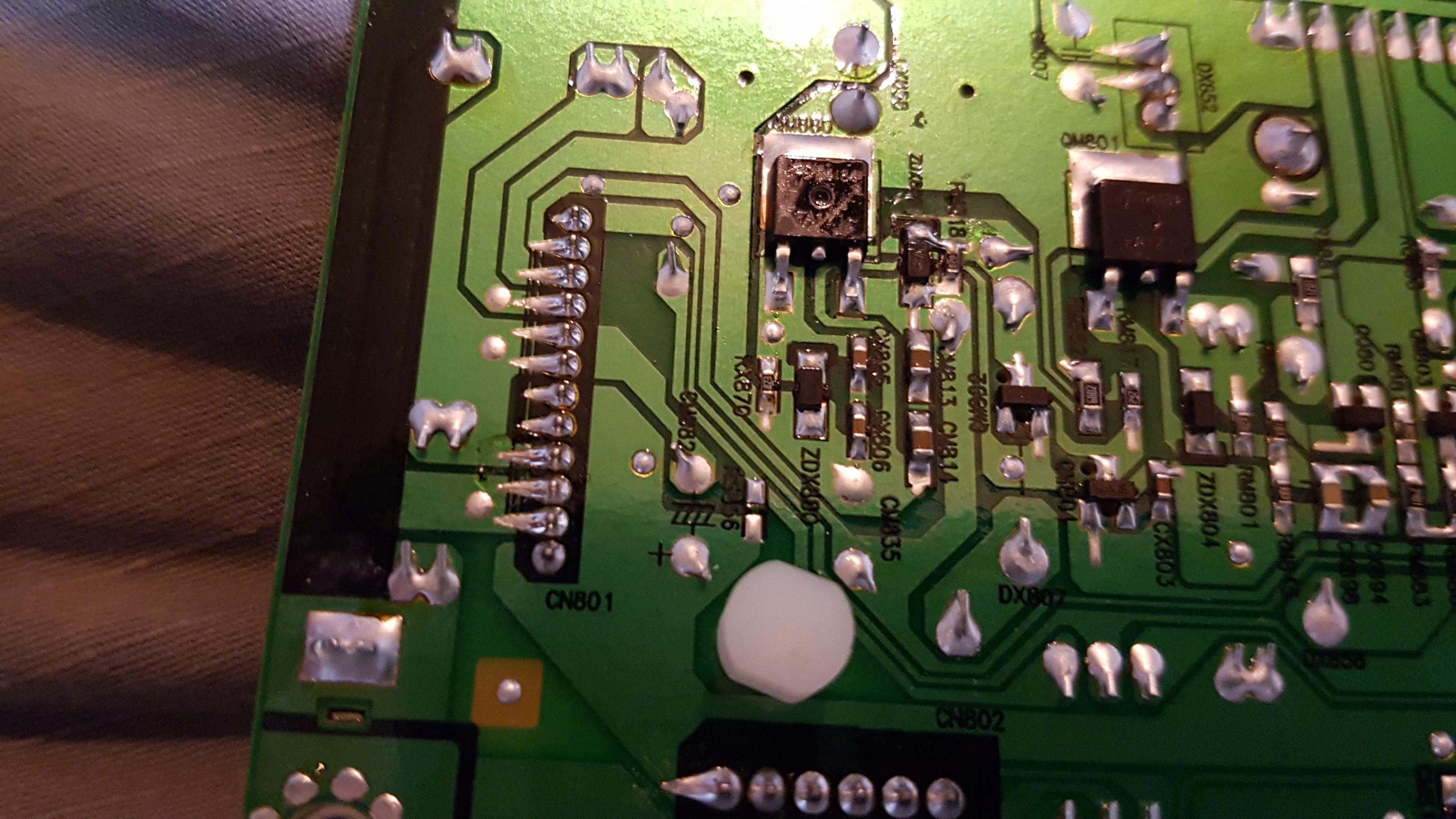

              What do you mean by cn801 ? I cannot find a capacitor their (see picture attached)

                Connector CN801 (12 pins), and also the 6-pin connector next to it.

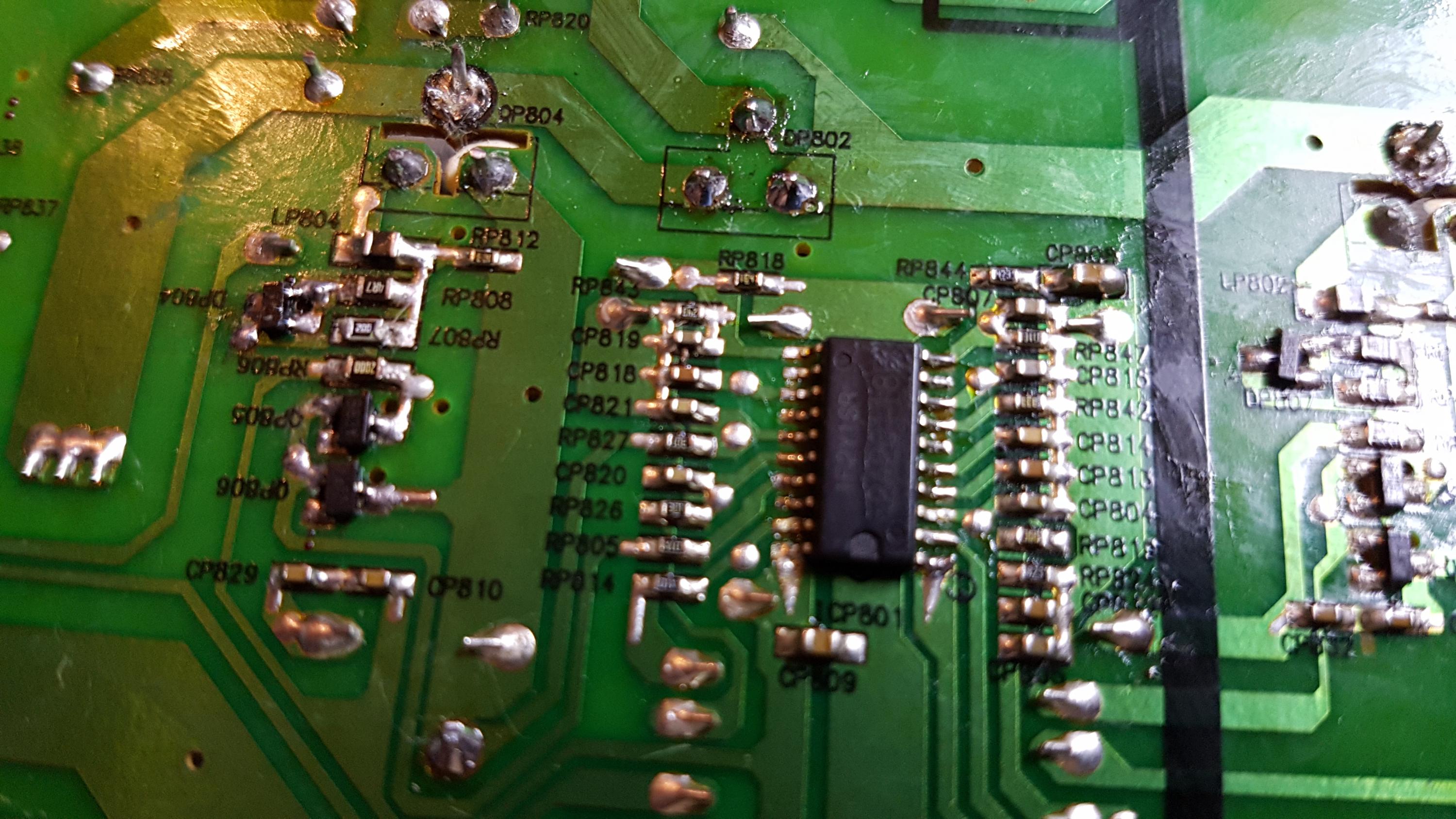

                            The solder works look really bad, I.E. QP804 (for PFC Voltage booster circuit) Drain pin does look like the solder even stick to the leg.

                                      The parts that you installed. Too me that pin looks really bad, may be some one else can chime in.
                                        Re: Samsung BN44-00445A failed
                                        It looks as though the through-hole solder sleeve has pulled away from the trace on QP804. I would at least do a continuity test on the Pin in QP804 to the bottom left leg of DP802. If continuity exists then the connection would be OK on this side of the board even though it looks ugly. But just looking at it makes me think it's no longer connected to the trace.
