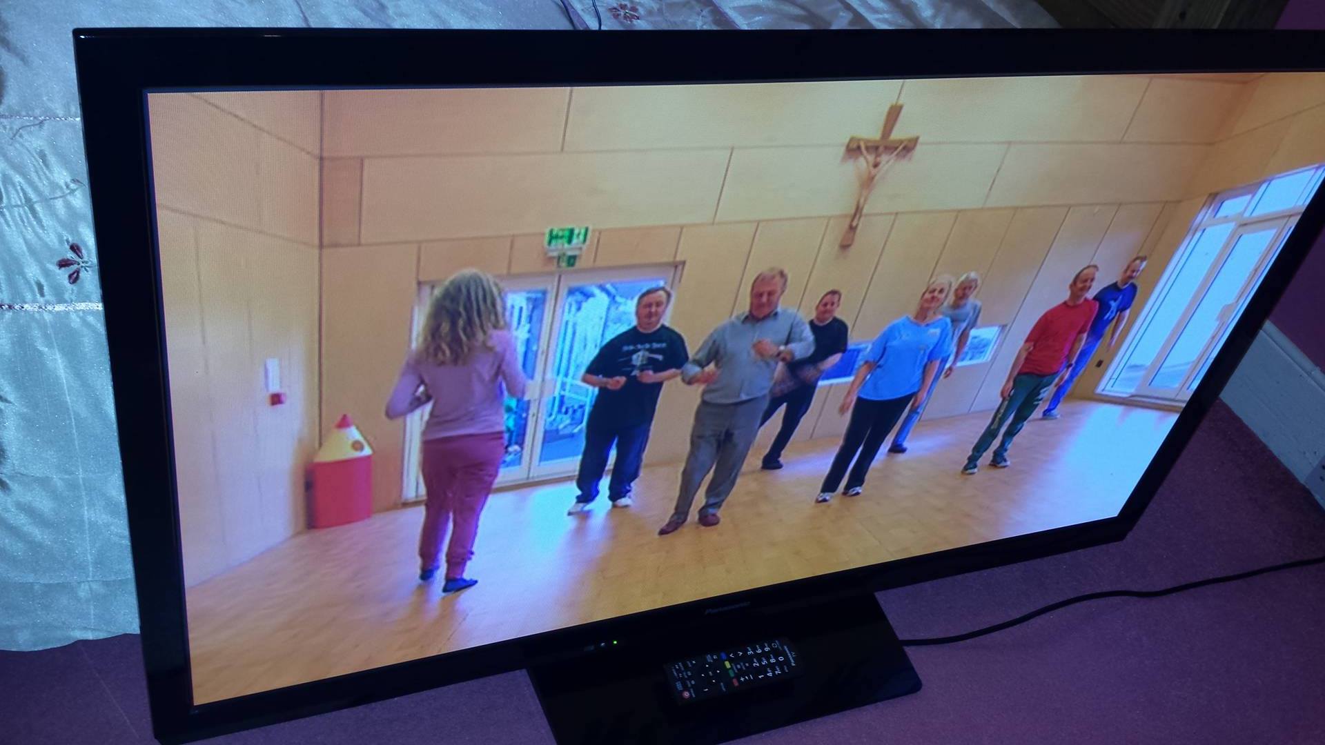

                                Β£9 replacement sn board all up and running
