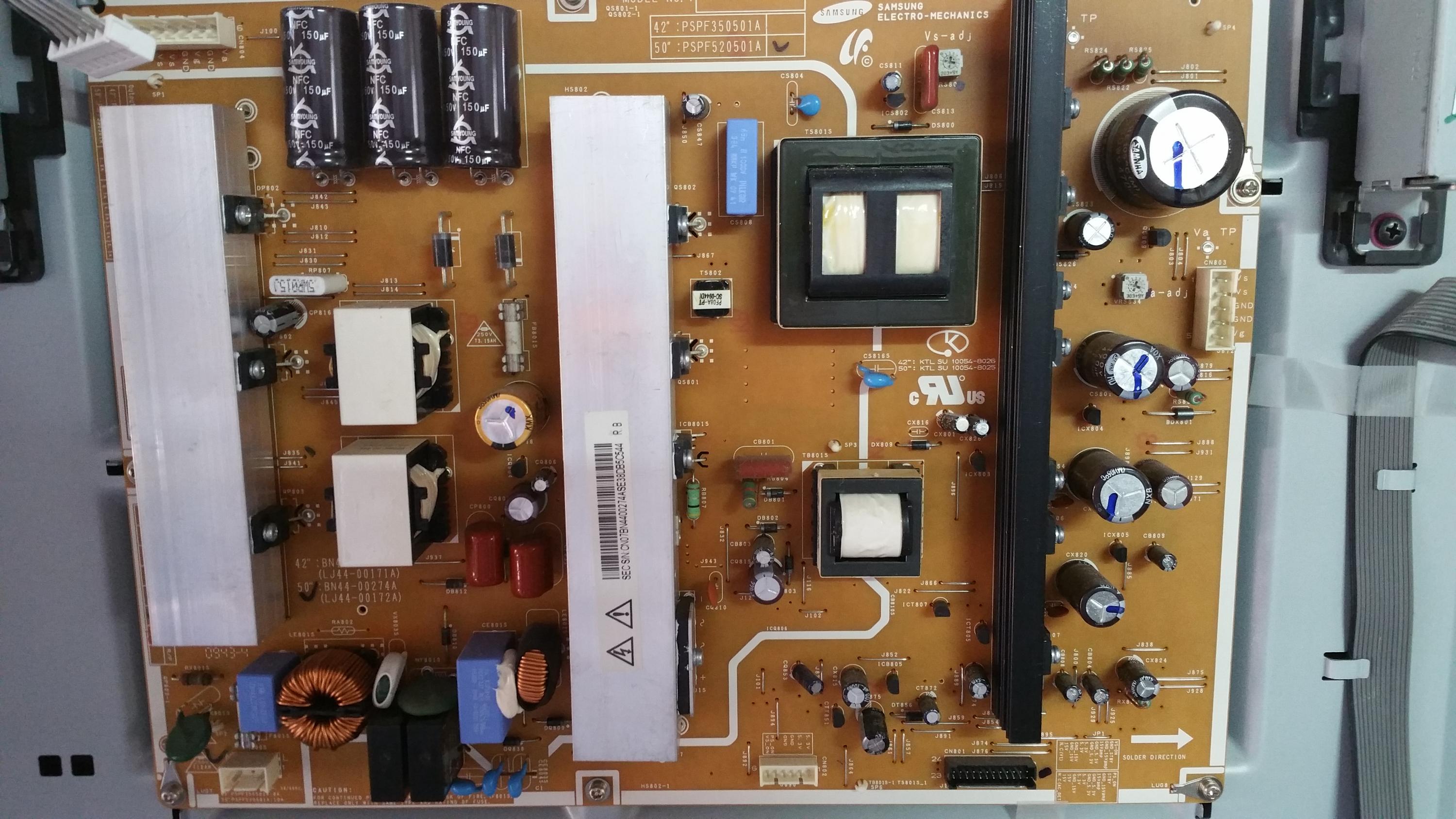

    Hi and thanks for looking!
    I believe I've determined the problem but wanted to run it by you guys to see if I'm correct.
    I have a pn50b450b1d that doesn't turn on. It's the classic clicking issue that a lot of plasmas have. I will upload images but there are no visably damaged capacitors. VA should be 55 and vs should be 209. When I plug in I get nothing close to those to values. A small spike and then nothing. When I unplug both the X and Y board from main I get the correct values immediately at power on but then they slow drop off to 0. I tried checking the values on the X and Y board themselves but nothing is correct. I removed the power board and used an ESR meter to start checking capacitors. It's the blue esr meter I built and calibrated it myself and it works well. Some of the capacitors have much higher readings then they should. I'm assuming that the power board is bad. Is there anything else I should do to make sure?
    Thanks!

    Re: pn50b450b1d No Power
    Your power supply is probably OK.
    The voltages only come up briefly on this model if you have the x and y unplugged.

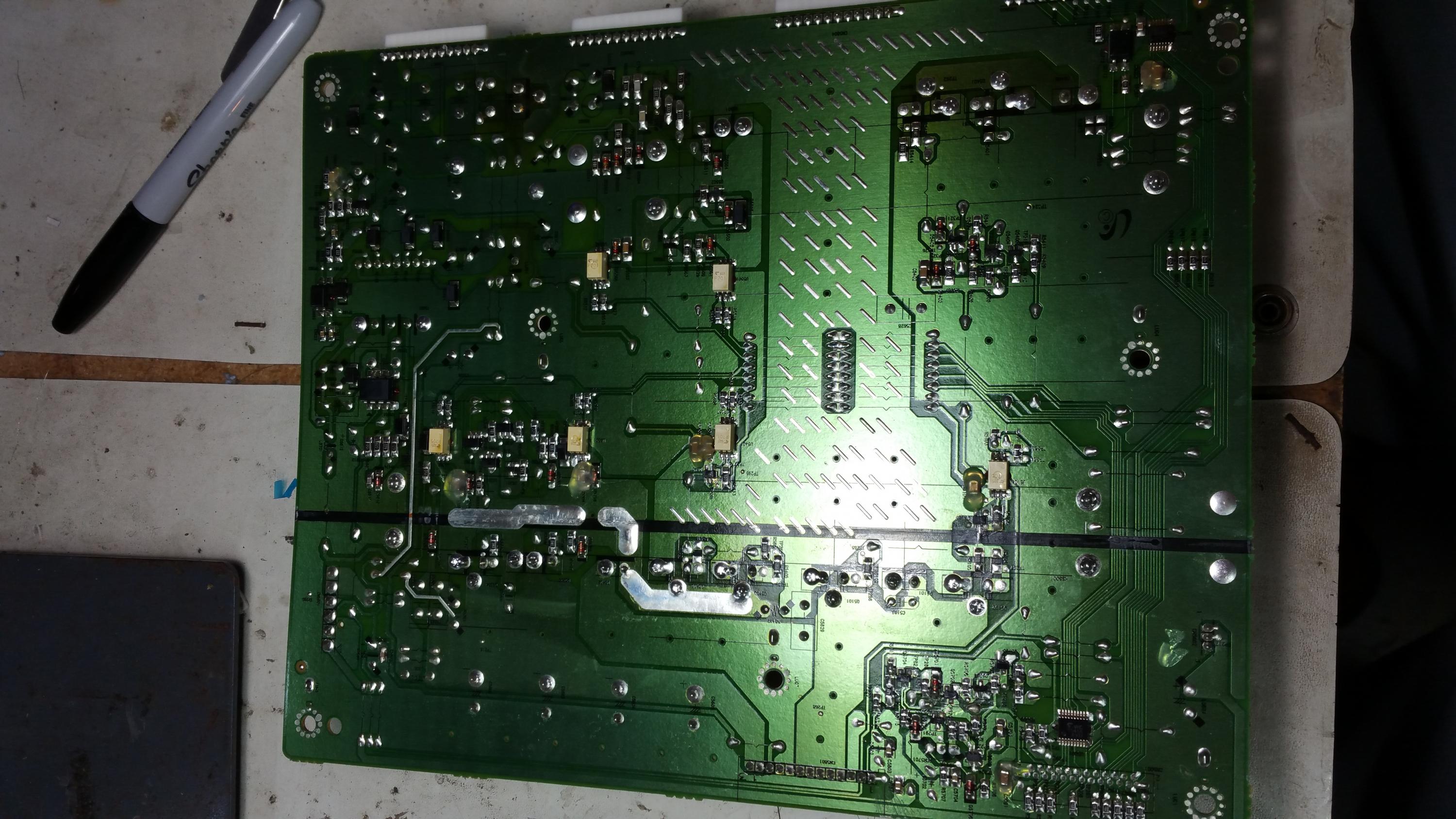

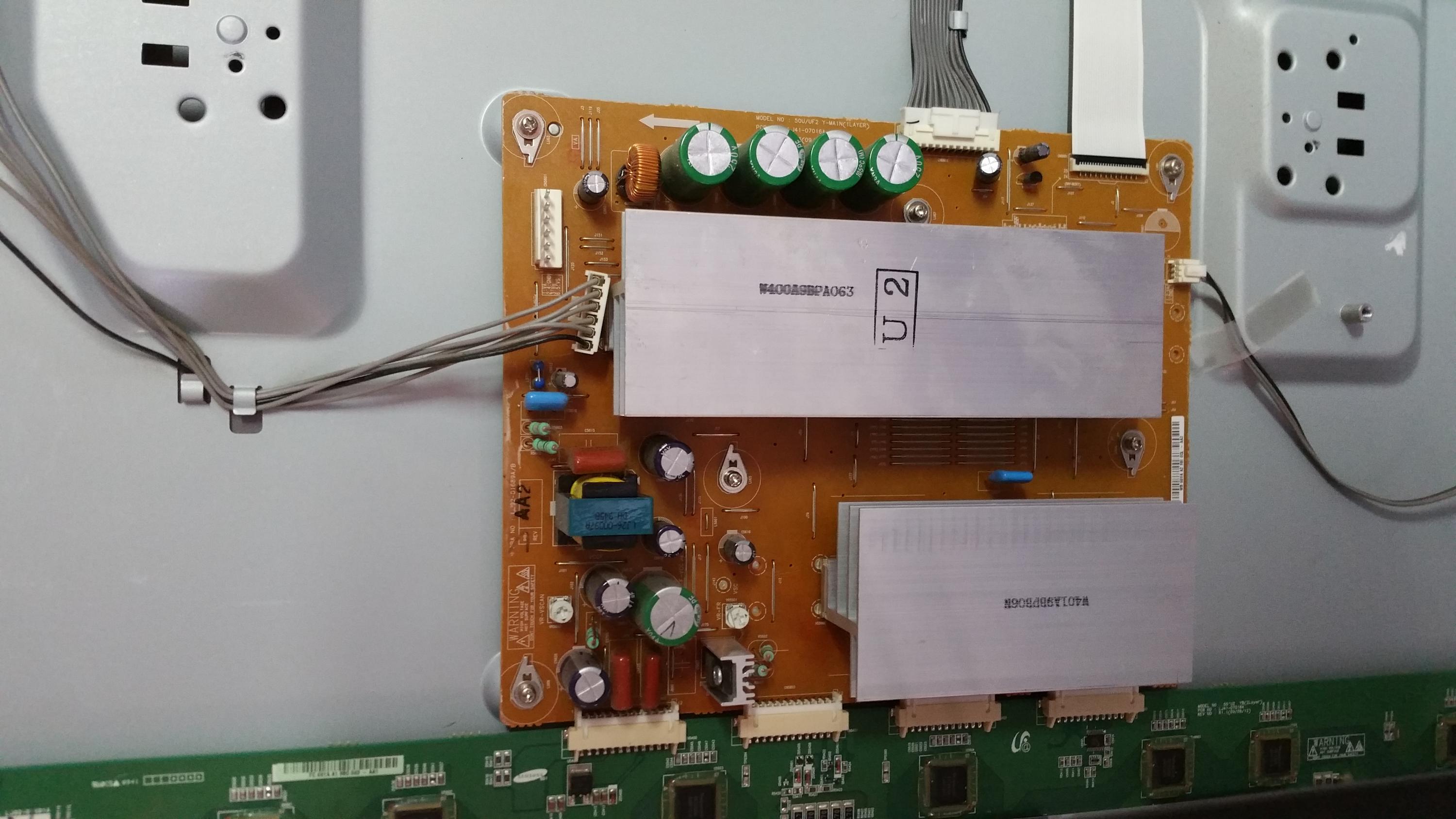

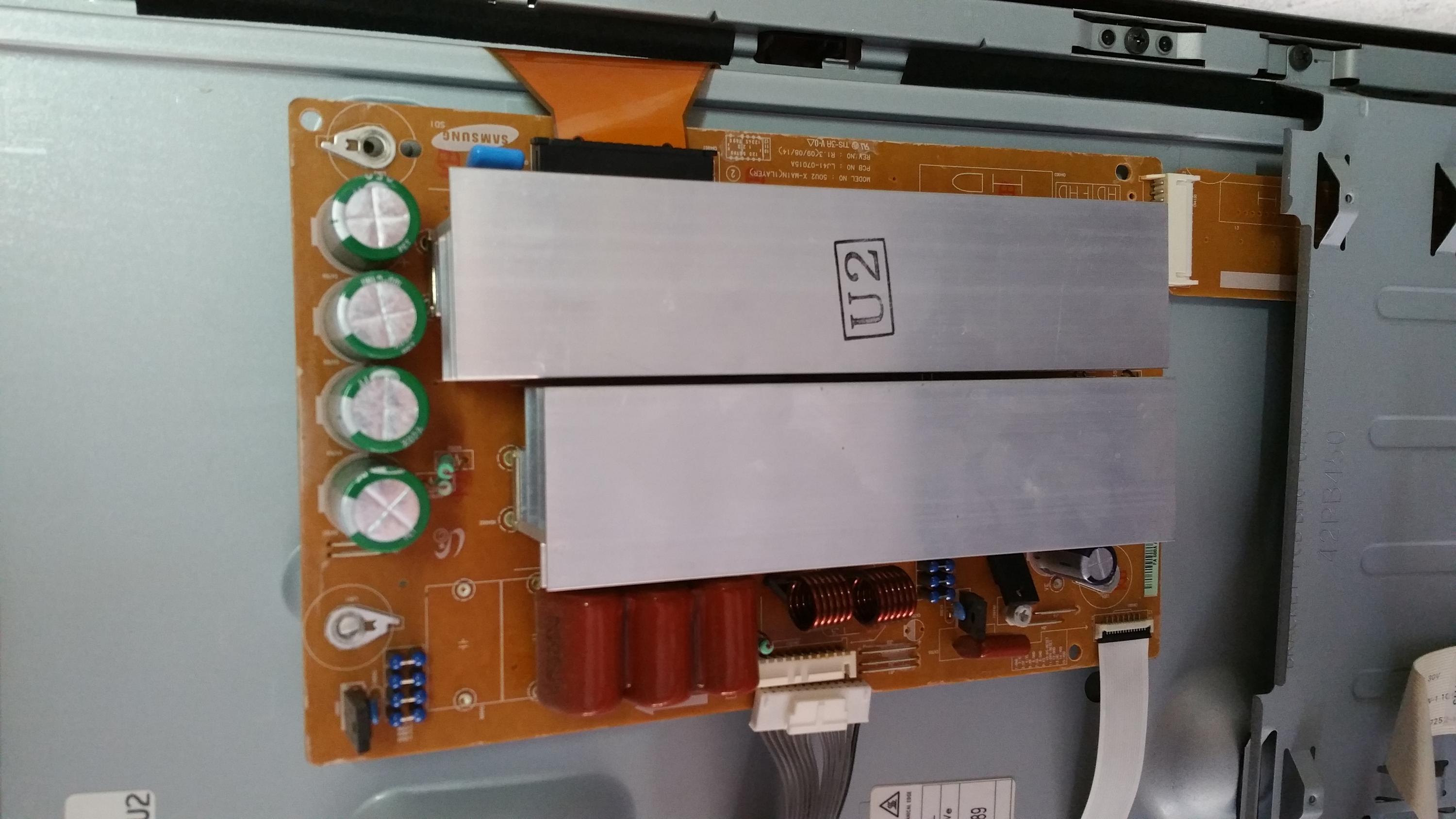

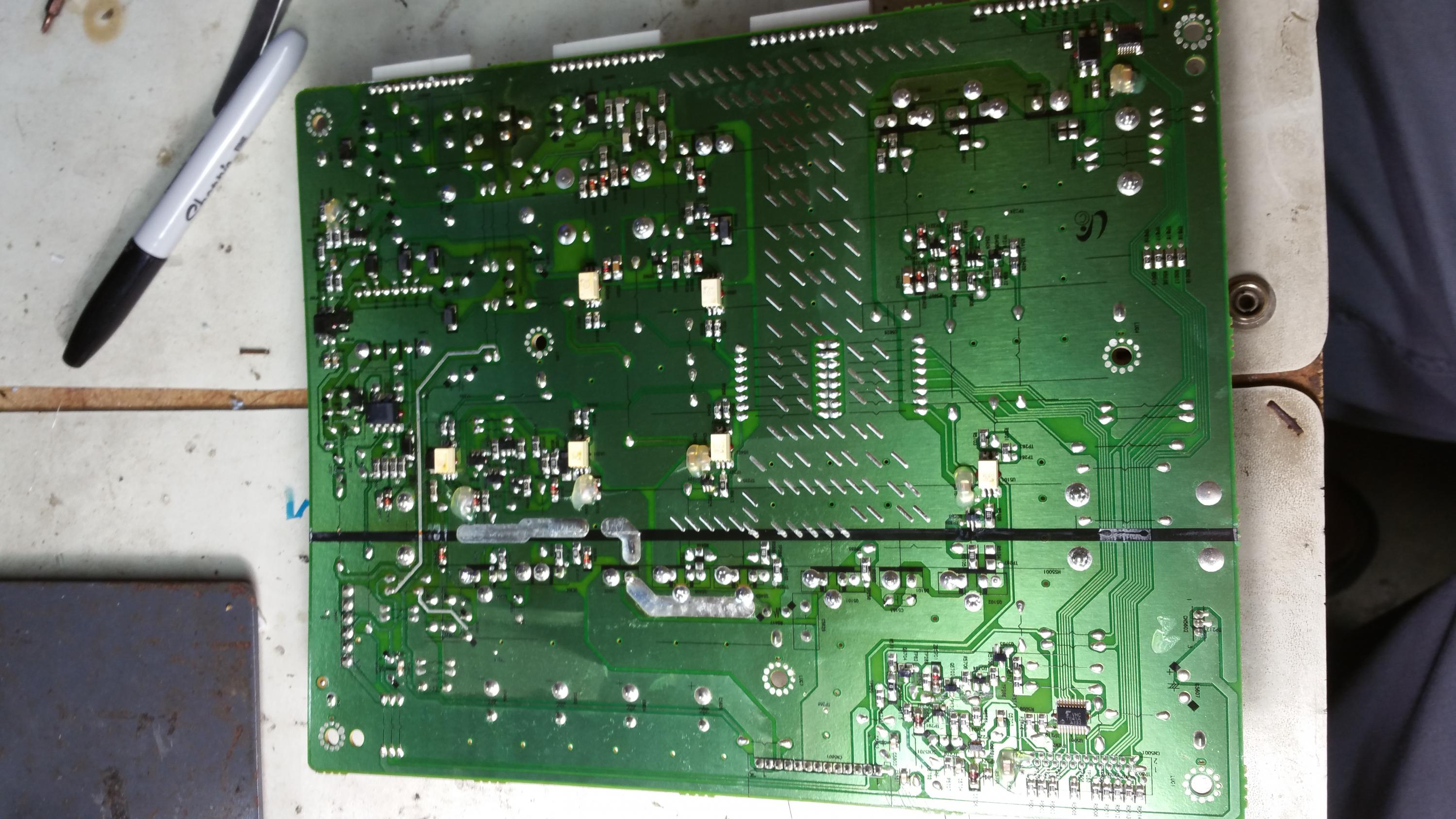

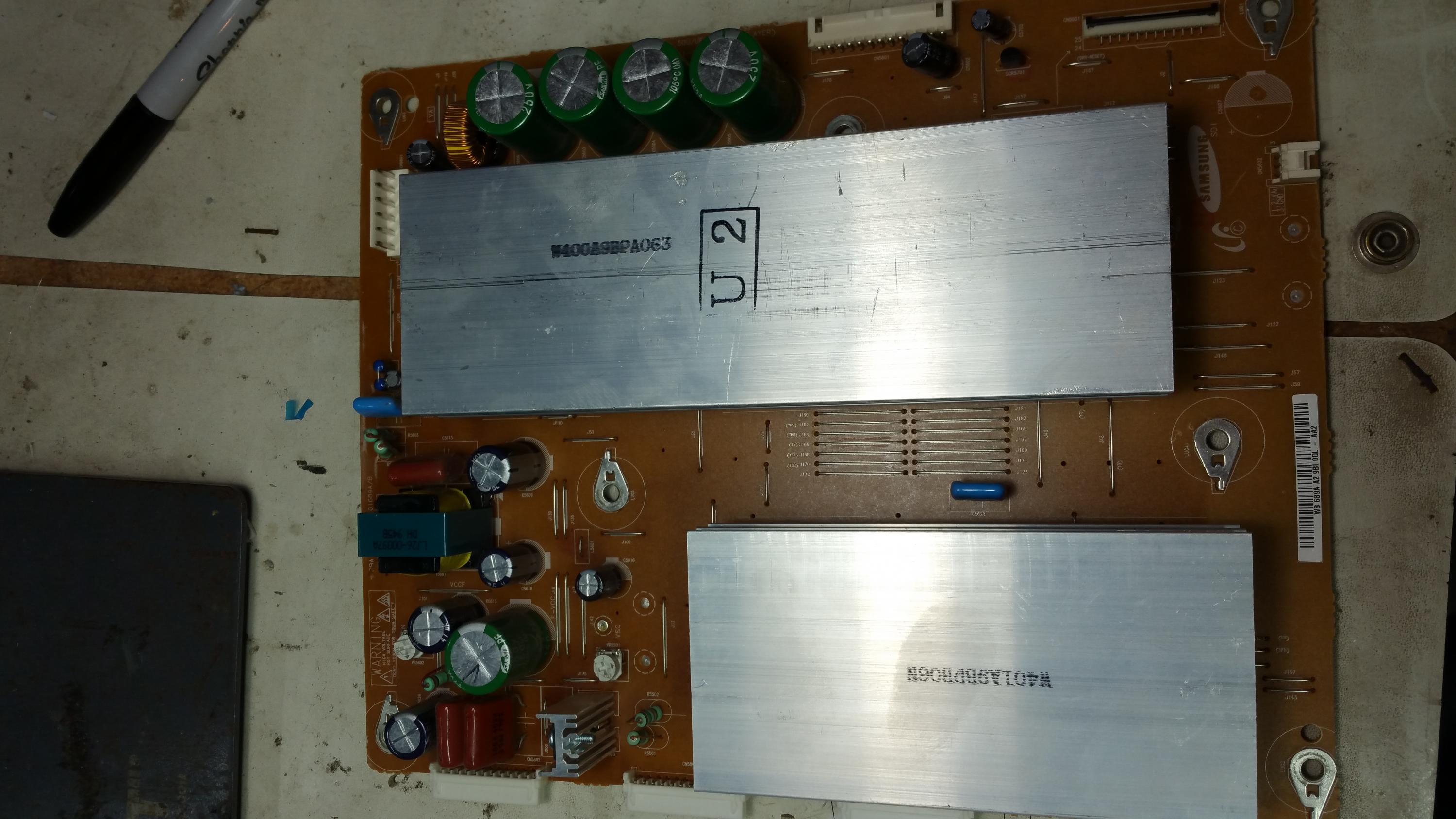

              Upload a photo of the top and bottom side of the y-sus.
                Did you confirm that vs input is shorted to ground?
                No, I did not. I apologize, I'm not familiar with how to do that. If you could please explain I'm sure I will catch on quick though. The pictures are attached.
