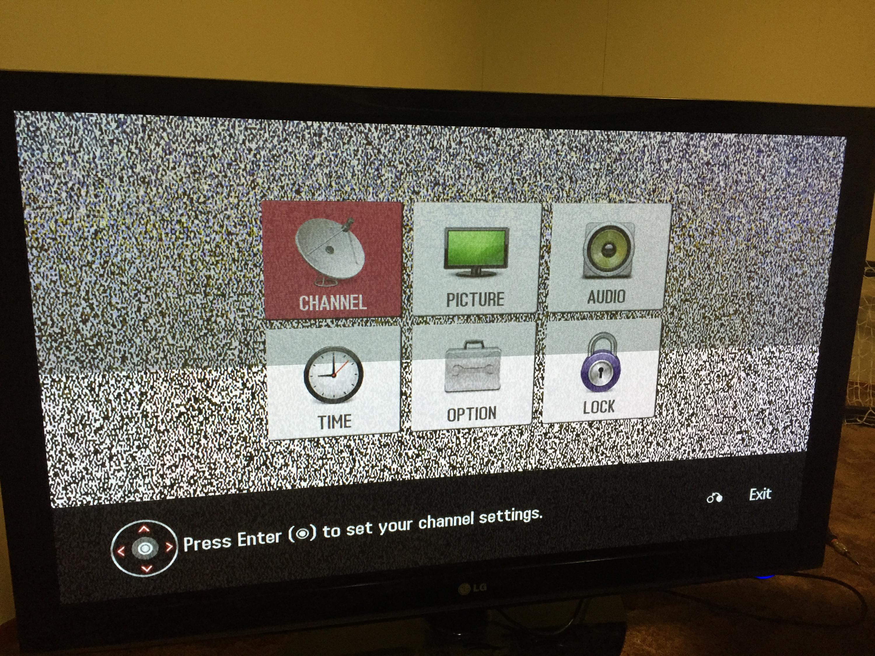

    I received this tv for cheap because owner said it would not power on. I brought it home, plugged it in and it powers on fine. However the top half (exactly half) of the screen is darker and has thin horizontal black lines. I've attached a picture.
    Is this likely a cable connection issue or something else??

    I was suspecting buffer boards if the screen was divided in half , but from the photo it looks more like 2/3 so i suspect the x sustain board connections to the panel or the board itself
    As the video image seems ok, i would go for the x sus as the possible culprit , re seat all connections and look for dry joints on that board especially high current inductor coils connections

      The picture is misleading because there is a bottom black bar that is part of the screen. So in reality, exactly half of the screen (top) has interspersed black lines, suggesting the upper buffer board is likely faulty. This board (part number EBR61831601 ) seems to be hard to find, so I'm wondering if it is repairable??

        I'm thinking buffer board. I actually replaced a lower board on a Pk350 and the lower board produced a slightly darker image to the top

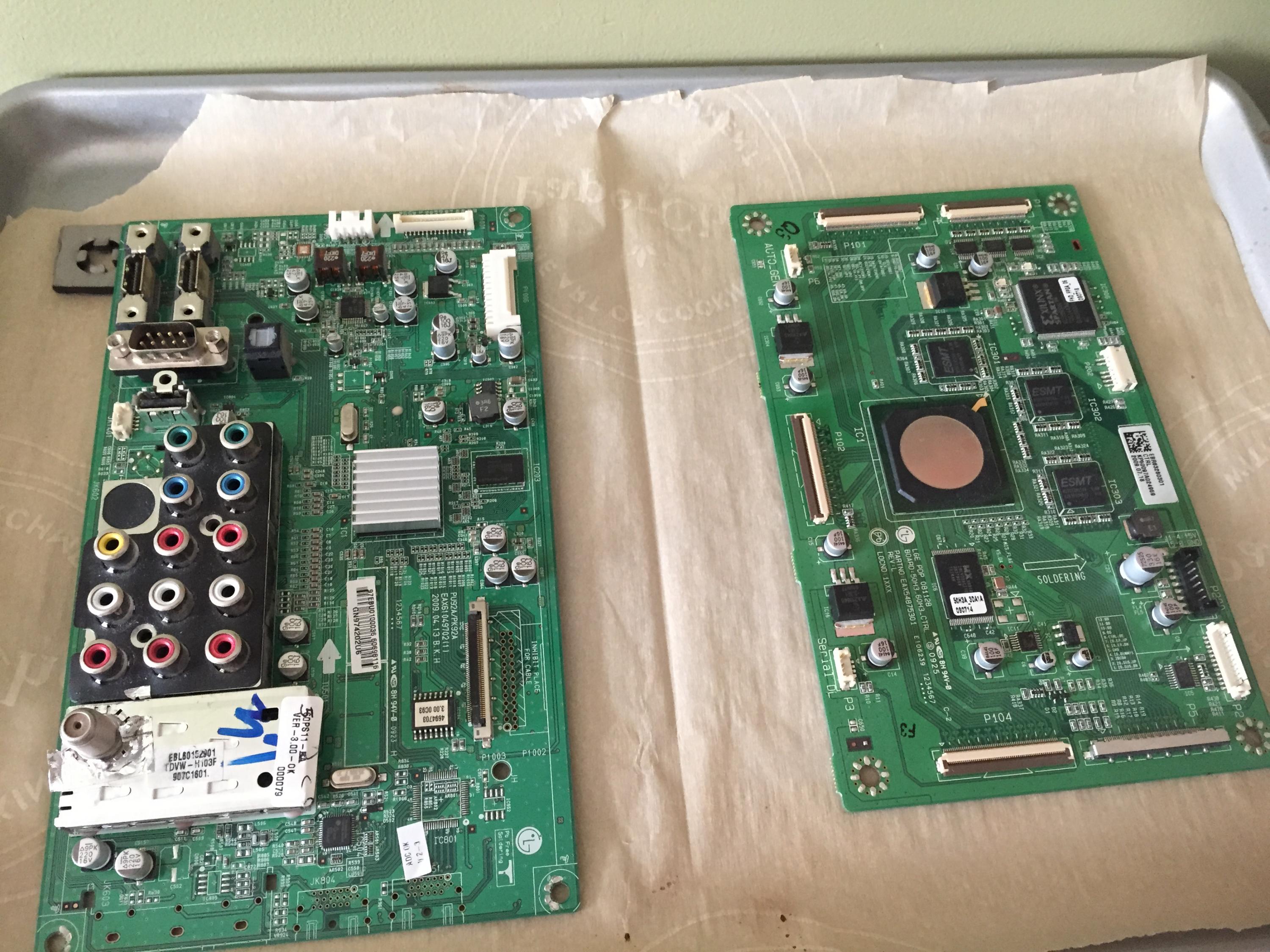

          I tried reflowing the upper buffer board in an oven at 385 for 10 minutes.
          No change.

                          I plan to take out the psu, y-sus and z-sus boards and check for cracked solder joints and resolder if necessary.
                          If that doesn't help, maybe I will reflow main board, control board and buffer boards in oven...

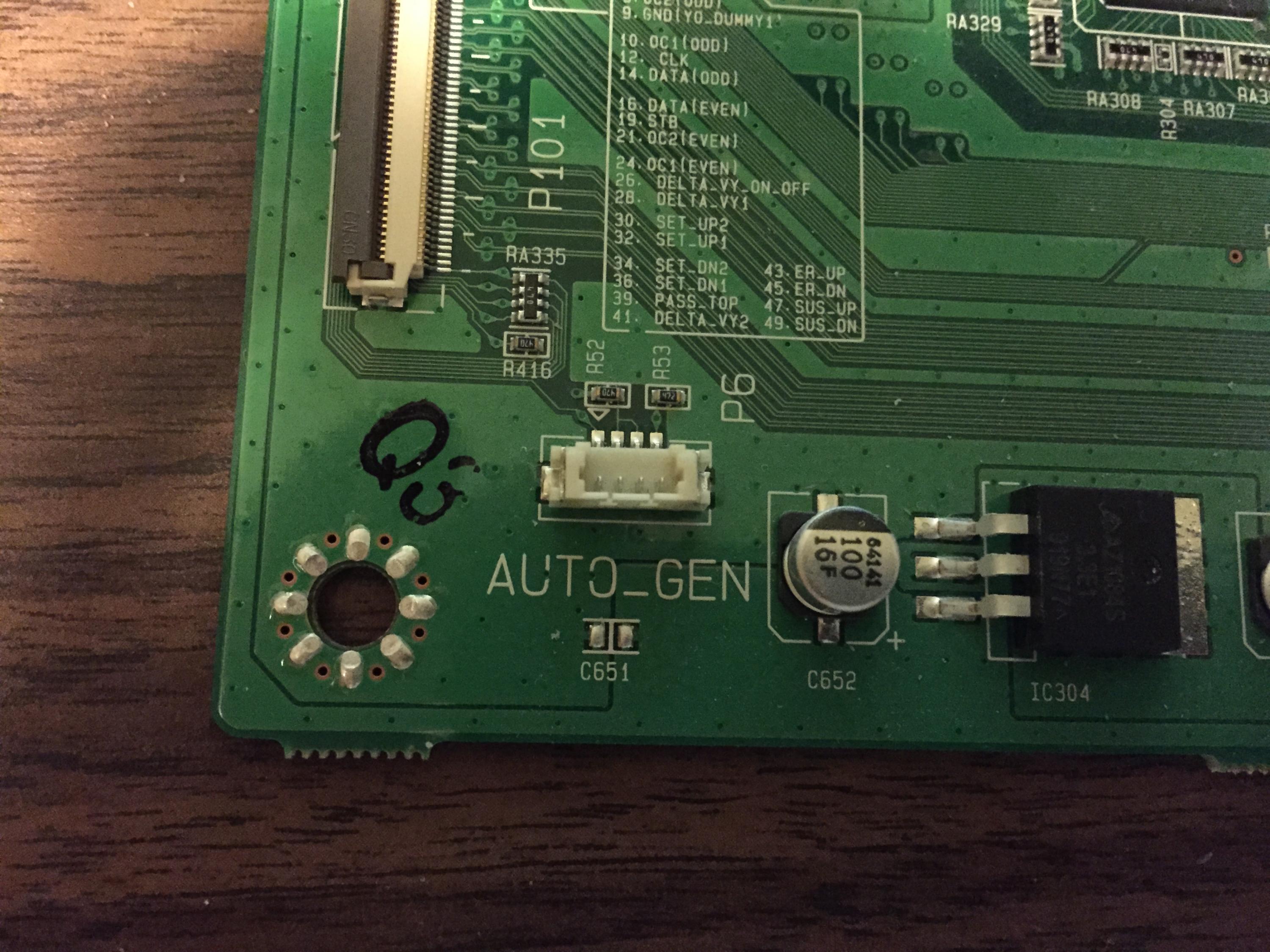

                                  would like to do an auto test pattern to determine if main board is a problem.
                                  I've attached a pic of the auto-gen area on the board with 4 pins.
                                  Which pins do I jumper?
