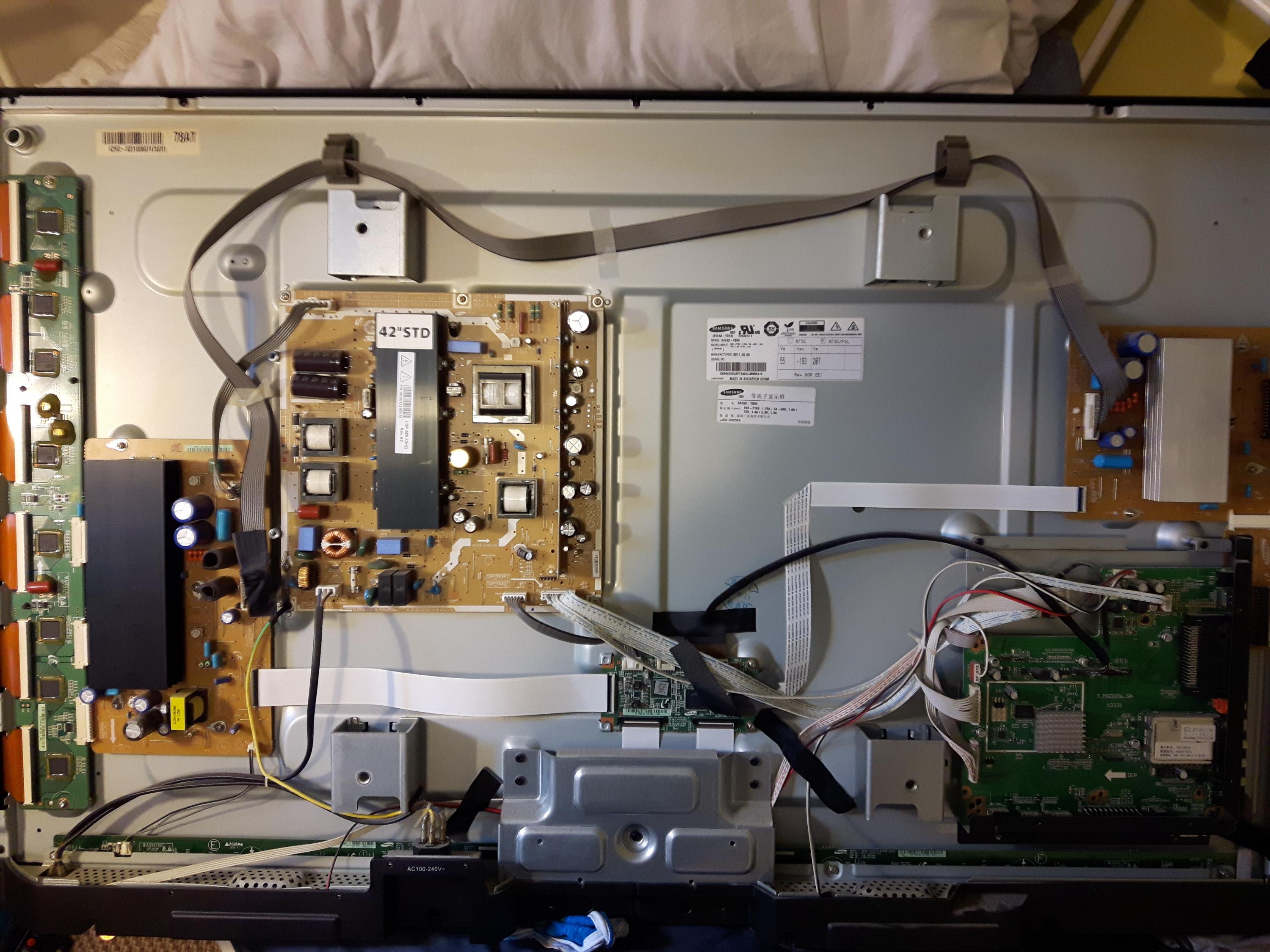

    Hi guys,
    Said I'd have a look at this for my old man, the tv turns on and then after a few seconds goes off with what seems like clicking from the PSU board relays. I've measured the Va, Vsc and Vs which all seem ok UNTIL the screen shuts off and the relay clicks then they quickly decay to zero. Assuming I have a short somewhere but my plasma knowledge is nil.. I don't even know which boards are what. I tried pulling boards to see if I could eliminate the board but the PSU won't output any voltages without the boards attached (assume that's normal?).
    Read over the odd post about these sets on here and I've heard they're a bit of a ball ache. Any help would be greatly appreciated. Thanks.

    Photo of the back. Thanks

      Re: Bush Bpdp42hd2 (Samsung S42AX-YB09) screen going off.
      Based on Samsung 42C450 this chassis suffers from X-SUS shorts and this can cause the Y-SUS to fail too. The IGBT's go short.
      They, (Makers) recommend changing all three if the X or Y is faulty (Inc Control-Board) during repairs.
      Worth pulling out buffers and with everything else still connected try see if it runs as indicated by LED on control-board short flashing and Vs voltage remaining at 200 odd...
        Thanks for the reply Alastair. Any chance you can tell me which boards are what in the back? Thank you.
        • sordids999
          • May 2013
          • 2161
          • uk
          Standing behind the TV ysus is to the left and joined to that is the y buffer board
          To the right top is the xsus board and finally the control board is in the middle of the tv
            Look on YouTube for how to test buffers
            • crt man
              • Mar 2013
              • 106
              • England
              Hi
              To test Y buffer put meter in ohm setting and put probes across
              the two large caps if the reading is low IE about 70 ohm's,
              or is out of mega ohms then the buffer is shorted,
              If the relays click more than once them the two RJH30E2
              on the X sus will be short also, that is the two on the
              outside of each end on the bank of FET,s
              Alan.
                    Had a quick look tonight at the y-buffer board. Test between both caps was about 5 ohms. I tested along all the pins for the IC's and found one pin on one of the middle IC's was shorted to ground. I'll check over the other components on the X and Y main boards as well. Anything specific to look out for? Thank you.
