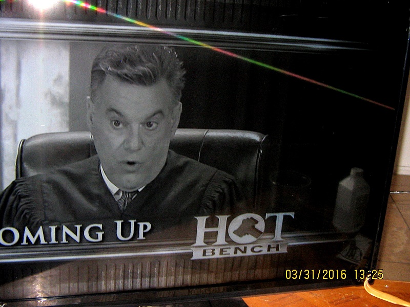

    After locating & replacing 6 defective LED Strips, I did get a pix..
    See attached pix Vizio #2..
    The TV turned on with a shading on the right side of the screen...

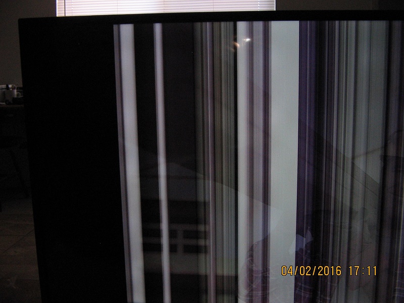

    See pix #1717...

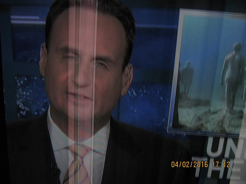

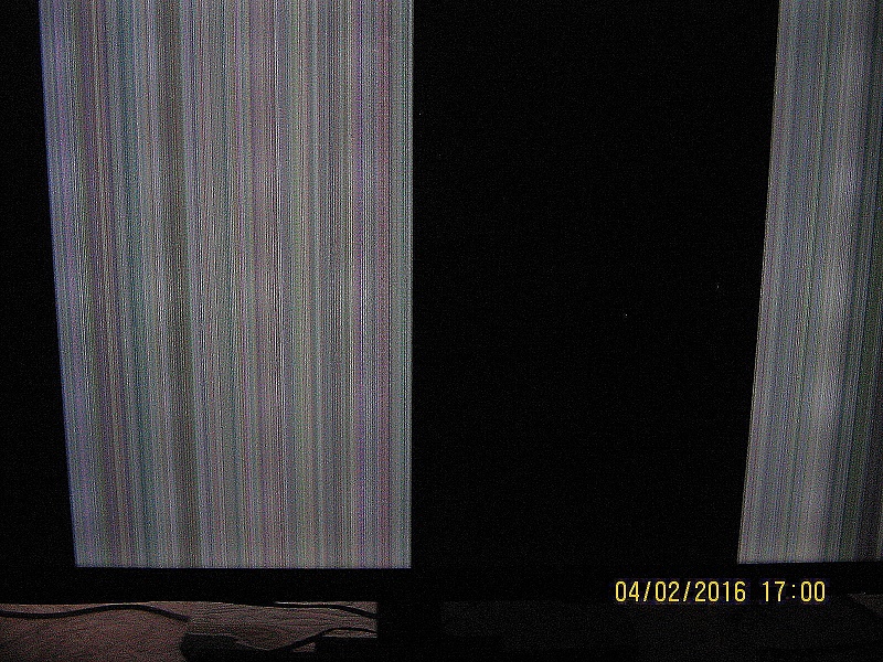

    After some more time the pix went to vertical lines on both sides of the screen..
    See pix #1711-1...
    That is the left side of the screen with part of the right side showing...
    Pix #1715 is the right side..

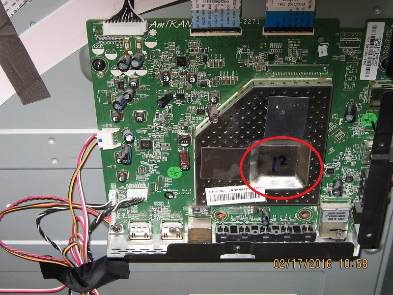

    When I used some freeze spray in the red circle in pix Vizio #3AB , the pix nearly totally returned to normal , albeit NOT 100%..
    I think that that's where the Micro is located...
    So , the Main Board was defective..

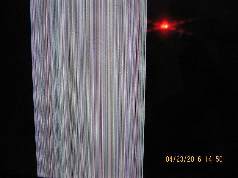

    The last pix IMG_1725 is what I'm getting now...
    The red dot is from the camera..
    The vertical lines are ONLY on the left side...
    IMHO , I think the LED Panel IS OK !!..
    Reason is that the lines on the left side are different between the 2 replaced Main Boards & the absence of lines on the right side of the screen..

        The reason that I think the LED panel is OK is that with the original Main Board I got those vertical lines on BOTH sides of the screen..
        Along with the shading on the right side , etc...
        Freeze spray removed all the vertical lines & almost restored the pix to normal...
        With the replacement Main Board I get vertical lines on the left side ONLY !!!
