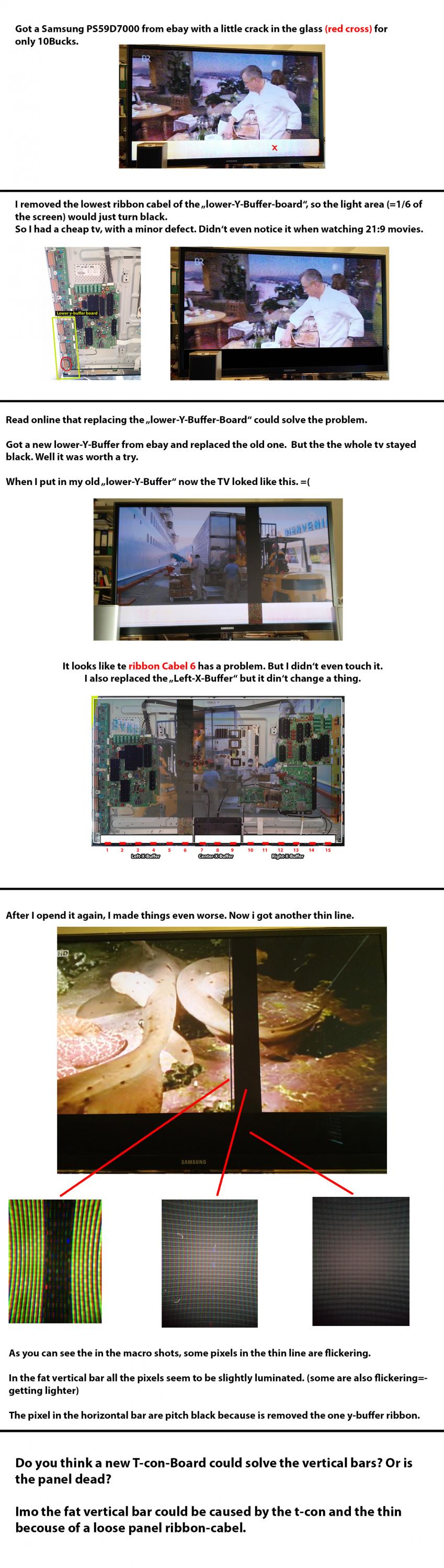

    Hey there,
    this is my first post.
    I have a problem with my beloved Samsung Plasma TV.
    The whole description of my problem is attached as a picture, because I had so many images. Hope this won't be a problem.
    Realy hope somebody got a few answers for me
    PS: It would be very nice if TOM66 could have a short explanation for the slighly luminated Pixels in the black vertical Bar. In another thread (link) he seemed to know something about this topic.
    Re: Samsung PS59D7000 vertical bars | Tcon or panel
    This is the panel (COF short), replacing the buffer board may have damaged the panel due to internal shorts.
    I don't know what causes the stray pixels. I just know it means that chip is still partially alive and it's not just a fuse or resistor failure
