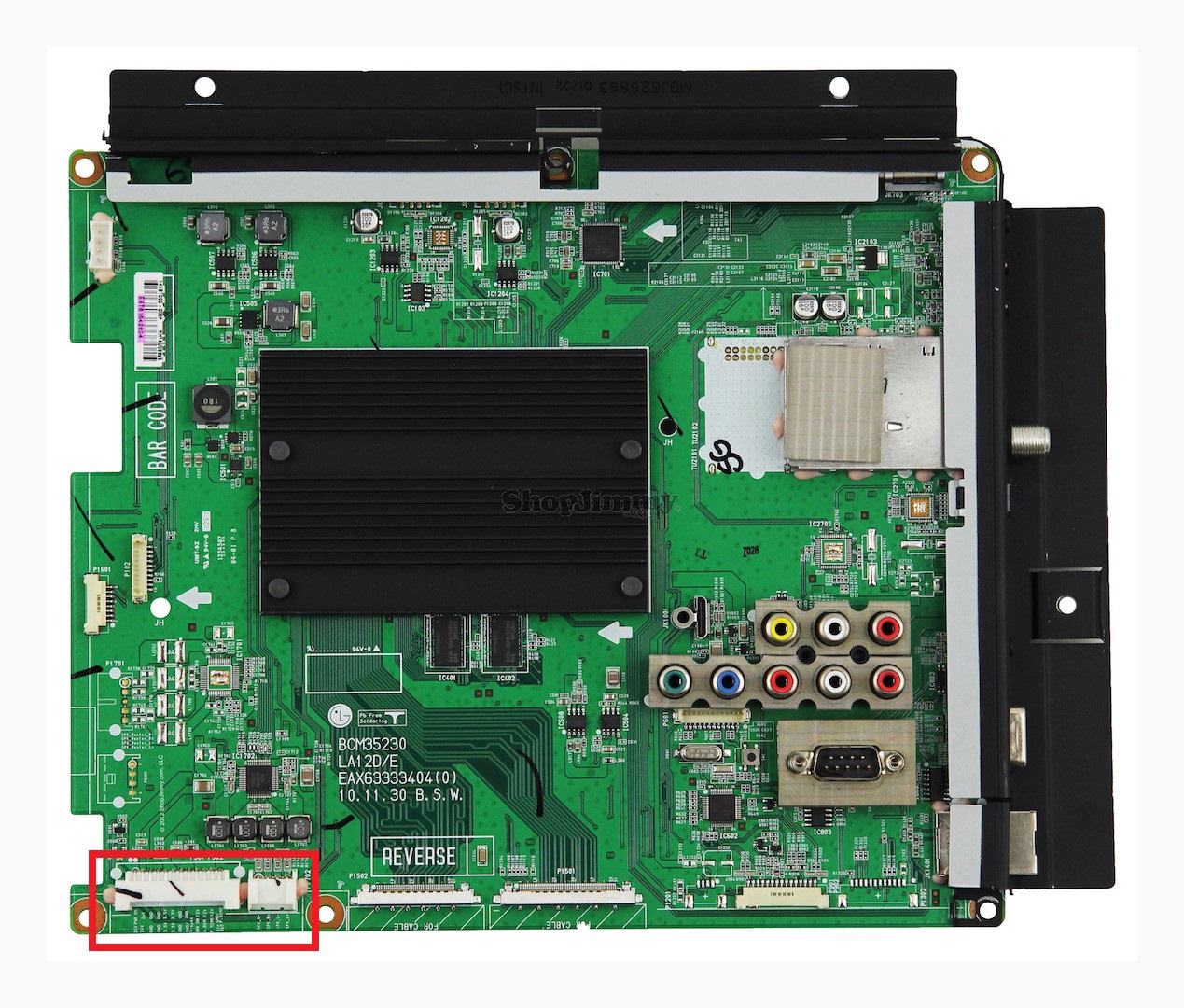

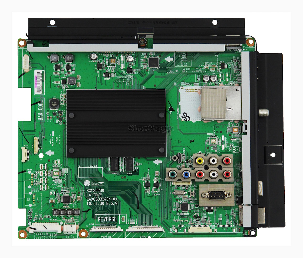

    I have an 47LV5400-UB (OCT 2011) that only turns on occasionally. When it has problems, it turns on as if the TV was booting as normal. The LED light stays on. The screen stays off with no backlight or sound.
    If you cycle the power a few times it may come on. Once on, all appears as normal. Inputs all work. Except the picture "flashes" every once in awhile on the home screen.
    An LG Repair person did a house call and said that the Main Board was the problem.
    I have removed both the power supply and main board for testing. I have tested the board to see if diodes, resistors and caps could be the problem.
    I did find 2 surface mount caps on the Main Board near the Antenna Input to be low. I did do the test with them on the board in-circuit and I don't know if the readings are reliable. There are 4 caps with all the same 100UF on the main board. Two tested at 105UF. One tested at 63UF. And the last one at 3UF. Could this be my power on problem?
    I have seen LG repair kits for the same board for other model TV's on eBay that include 2 surface mount caps. Others report the nand flash has problems as well.
    I could order the caps from Digikey and have someone solder them on. But I can't solder that well that small.
    Thanks for the pictures from ShopJimmy.com

    Re: Intermittent Power On LG 47LV5400-UB

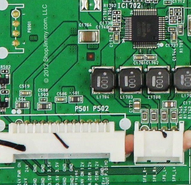

    Can you supply the legend alongside the two connectors and what voltages are present on each pin when you power up.
    (Photo courtesy of Shopjimmy)
    EG
    CON1
    Pin TXT Reading
    Pin1 12V 0V

        You have to start somewhere. So the first thing is to check that all the voltages are as they say on the legend as printed on the power supply. This should help to remove the power supply as the problem. You can then move onto the next step........

              OK then the connector on the left of the above picture has a legend alongside. Can you use your multimeter and measure the voltages on the 24 pins and write the legend alongside your readings.
                P501 is the double-row connector, the pins that you are seeing on the top side are for the ODD number pins corresponding to the labels of the top row:
                Pin 1 (left pin) has white circle marking on it.
                Pin 1 PWR ON = ???V
                Pin 3 24V = ???V
                Pin 5 GND
                Pin 7 GND
                Pin 9 3.5V = ???V
                Pin 11 3.5V = ???V
                Pin 13 GND
                Pin 15 GND
                Pin 17 12V =??V
                Pin 19
                on and on.
                The EVEN pins you will need small tip probe to to the backside of the female connector.
                • hackintoshx86
                  • Apr 2016
                  • 20
                  Okay, after the last few days of playing around.
                  All voltages on the power supply test good. I also swapped the power supply for a known good one to double check.
                  The main board seems to be the problem. Where do I go now that I know the voltages are good going into the Main.
                        Go straight to the main processor.
                        Board has a standby which rarely ever goes bad and main which BGA usually degrades and needs to be replaced.
                        http://www.coppelltvrepair.com/p/162...ausylhr-led-tv
