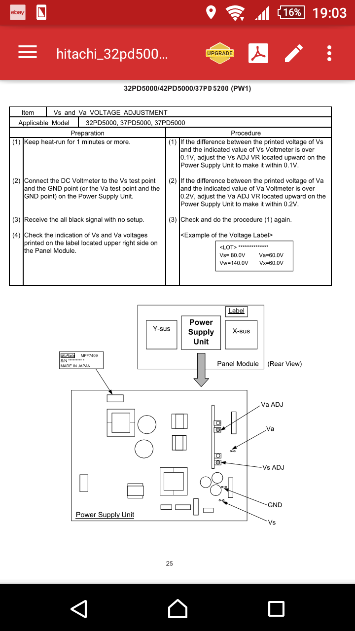

                              Re: Hitachi 42pd5200 power board mpf7409 has stopped
                              How about taking some voltage measurements. Do the pins have the voltages they say alongside. Are any voltages missing? All this information helps others help you.
                              This does look like the place to test vs / va. Would you agree?
                              Referencing this and my above image
                              If you zoom in it says va,vs,gnd.
                              https://picasaweb.google.com/1178467...eat=directlink
                              Don't seem to.be able to post pics today on here.

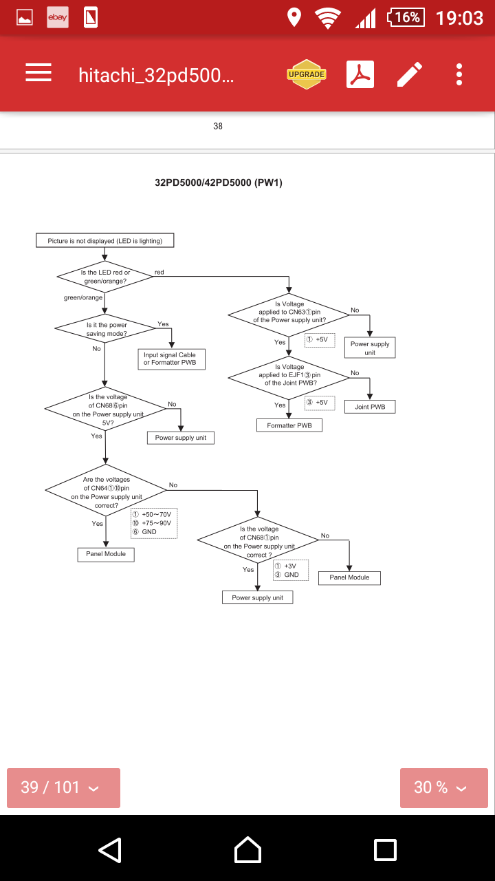

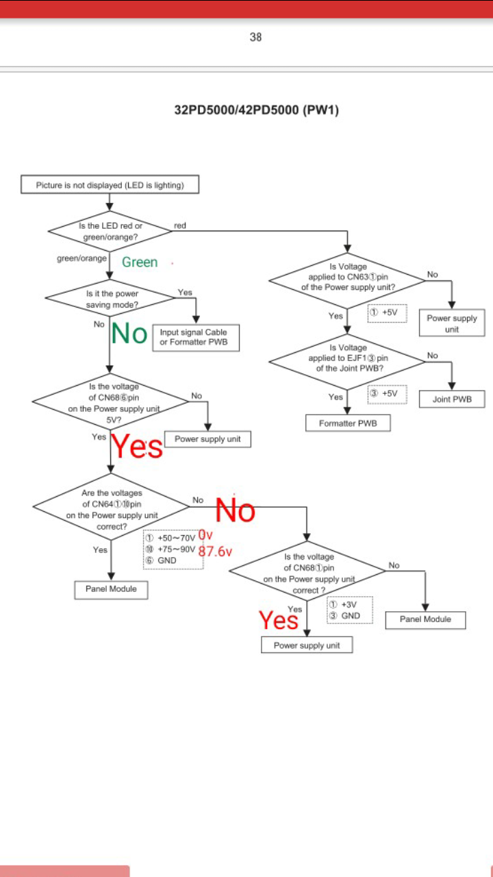

                                Ok so testing the pins it gives -
                                Dc voltage vs as 87.5
                                Da voltage va as 0
                                And working my way down the manuals flow chart as linked below it comes out as power supply fault.-
                                Led is green
                                Is it in power save mode. (unsure assuming no)????
                                Cn68 is 5 volt
                                Cn64 are not correct - pin 1=0v & pin 10 =87.6v (pin 1 should be 50 to 70v
                                Cn68 pin 1 is 3v
                                https://picasaweb.google.com/lh/phot...eat=directlink
                                Any thoughts guys....
                                      So--No Va.....
                                      No Va, No Picture....
                                      Investigate Va stage of PSU.
                                        Originally posted by Alastair E
                                        So--No Va.....
                                        Can you be a little more specific?? Can you narrow down where to check on my image?
