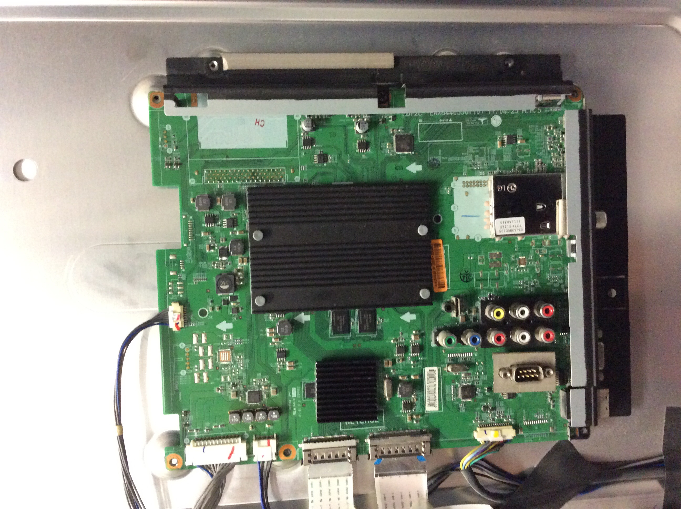

                Ok. So I have gone through the service manual and tested each output on the main board. Everything seems to be within spec. I'm getting power but no picture. So I guess it has something to do with the t-con board.
                I know the tcon is getting power via lvds from Q507 12v. It's measuring 12v at Q507 and L511.
                How do I test the tcon board. I can't find any schematics anywhere. The tcon board model is LG 6870C-0369C Ver 0.2 (2675E1).
                Anything else I'm missing.

                  • UND312DOG
                    • May 2014
                    • 63
                    Re: LG 55LW5700 Service Manual
                    I turn the tv on via the switch. Hear the relay click. And nothing. A completely black screen. No light at all. The only light showing is a slowly flashing red standby light.

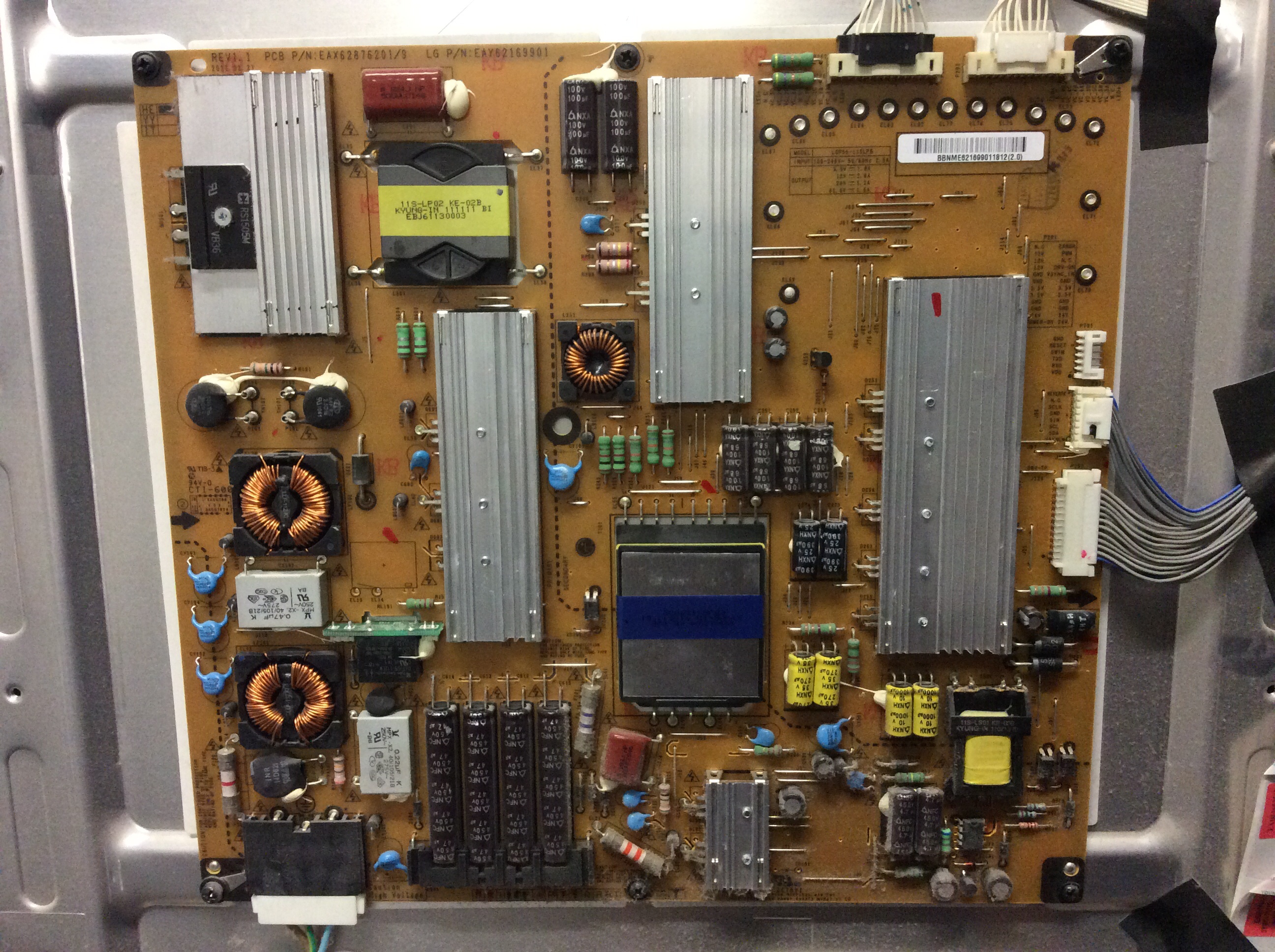

                      Well we need to see the board and especially around the power supply connectors so we can give you the test points to find out what are missing.
                        Main
                          Power

                              Yeah mate. I'm getting 24v.
                                  So from p501 Pin 4 = 24.8v
                                  L504 to ground (both sides) = 24.8v
                                  Continuity either side of L504. And continuity from inlet side of L504 to L1801. Which is where it goes on the board.
                                        In the link thoma provided, it shows you how to get the backlights to come on using resistors, you can look at the front or the back of the panel to see if it has glowing lights in the darkened room.
                                        Right now we want to know if we have more than one board problem.
