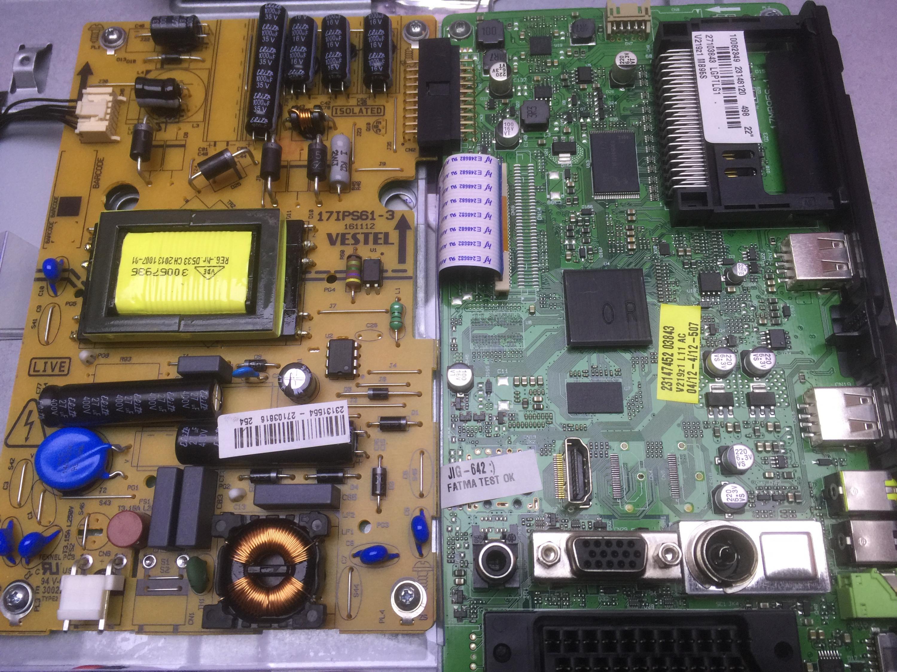

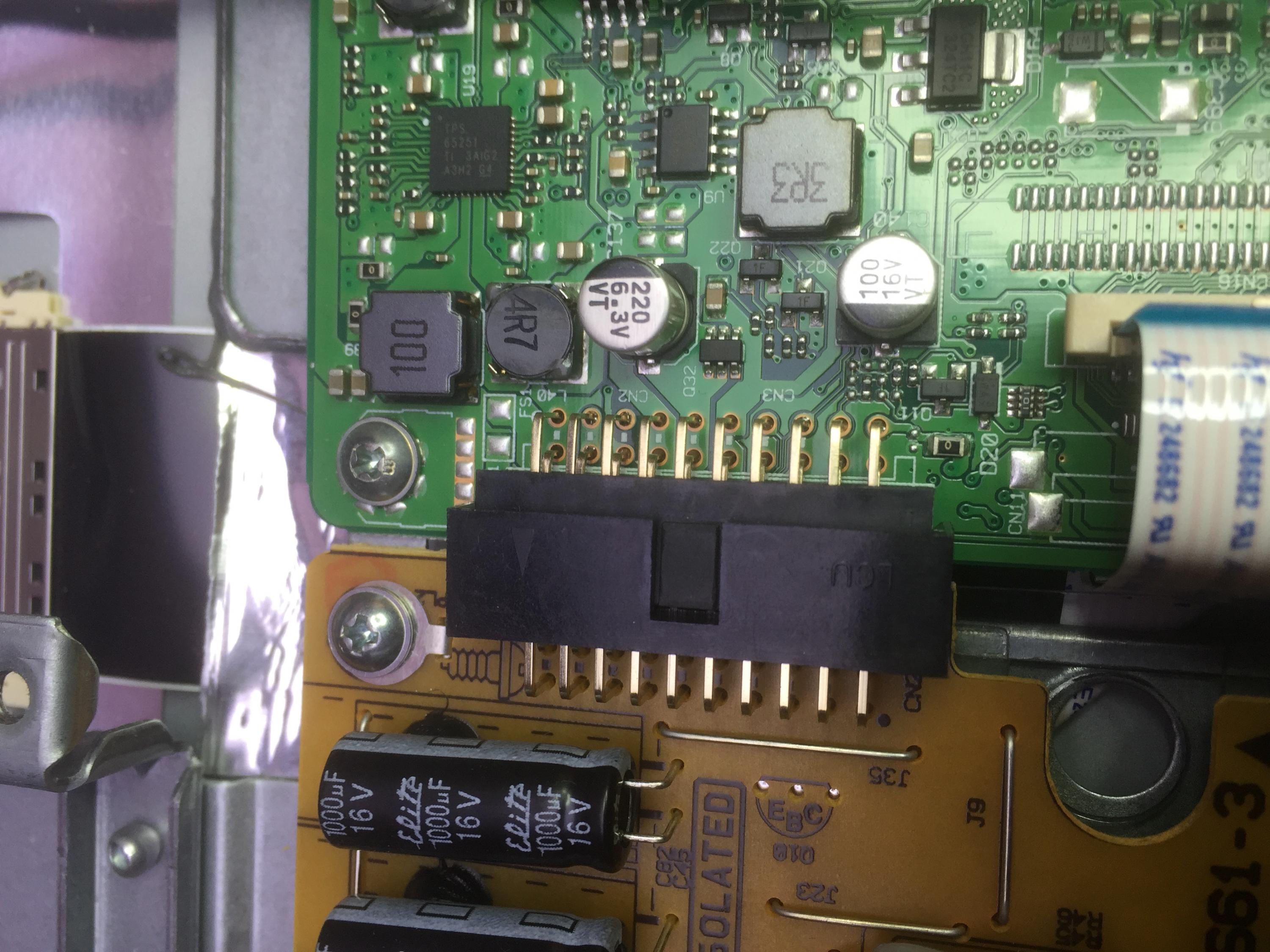

    Bought this thinking it would be the usual failed Diodes but no, in fact all voltages seem ok, where else should I check please,
    I am getting
    11.34 v
    5.23v
    3.31v
    3.31v
    5.23v
    all other pins read zero

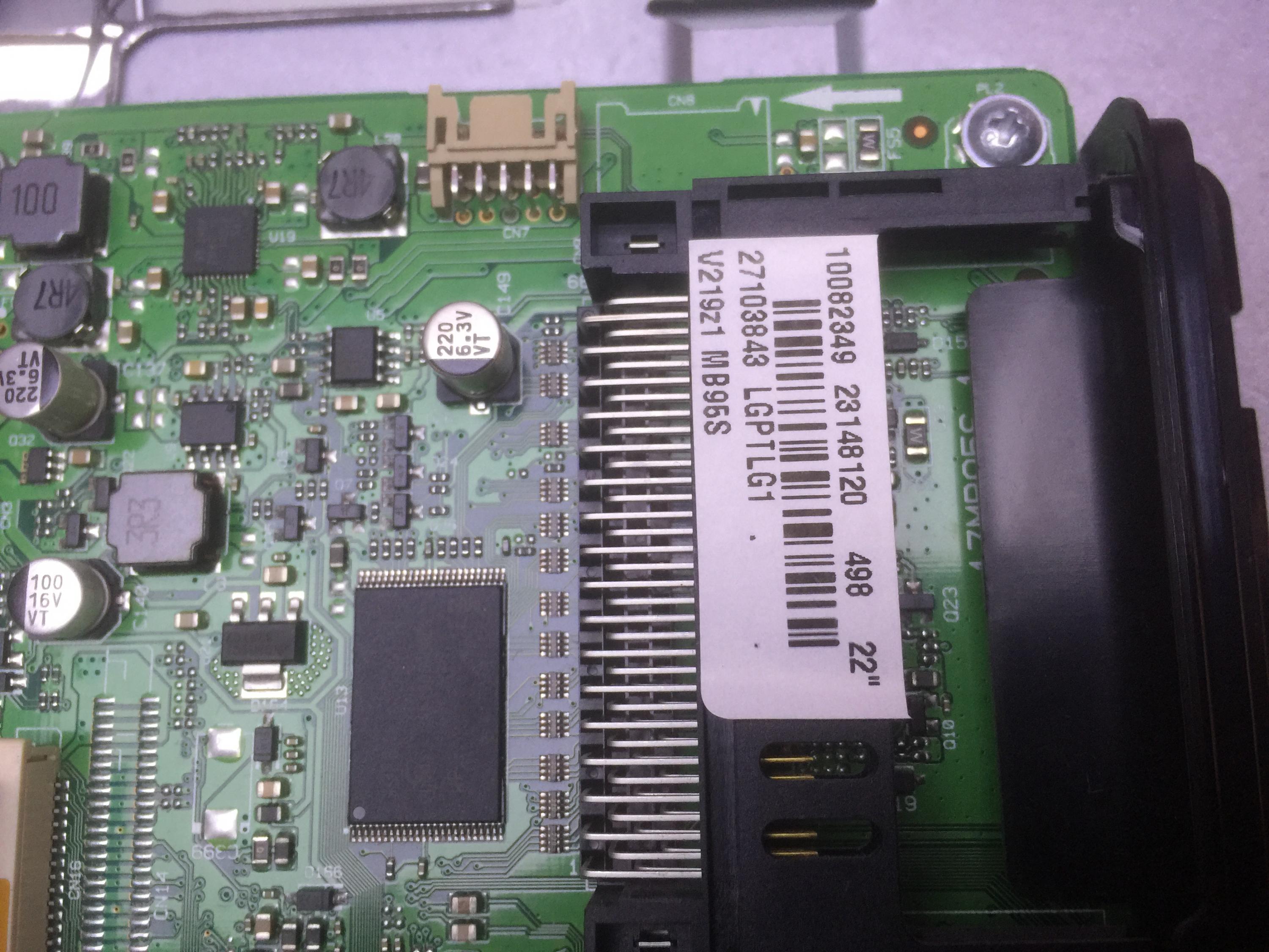

    maybe another case of bad firmware whats the mainboard part number.
      Re: Toshiba Vestel 22inch Dead, but not diodes
      Hi and thanks for replying 23148120 could bad firmware render the set dead, no stand by light etc ?
        maybe if it uses a 17MB95S-1 V.1 ive had a toshiba 32 in version with this fault a new mainboard solved it maybe wait and see what other peoples thoughts are.

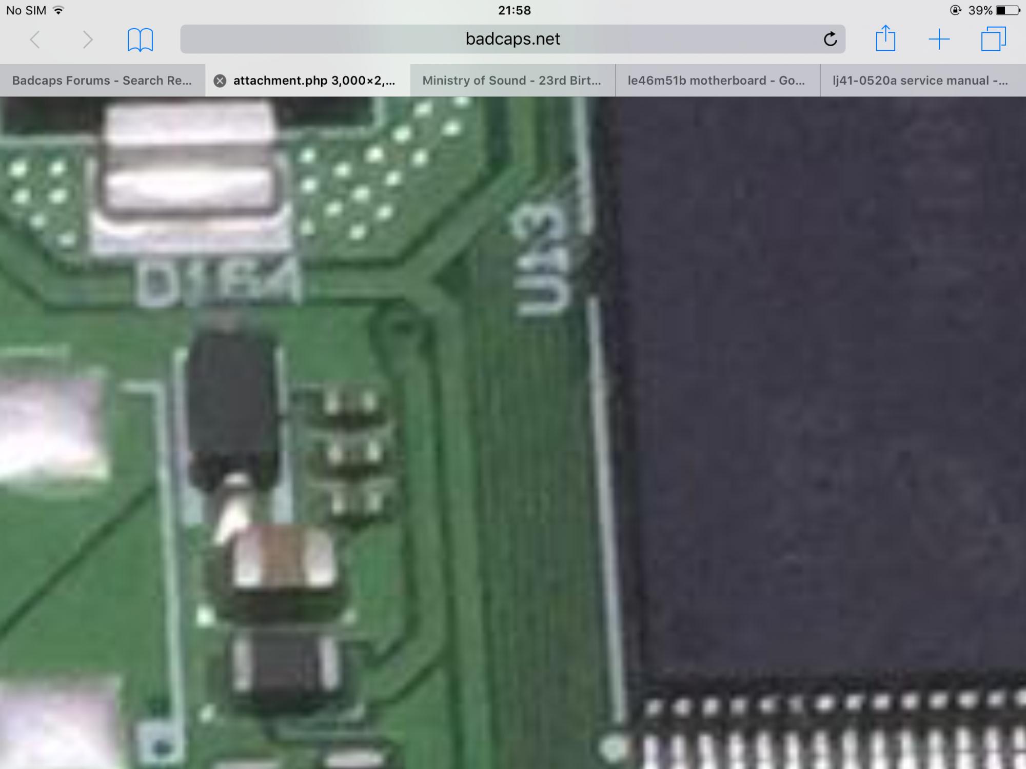

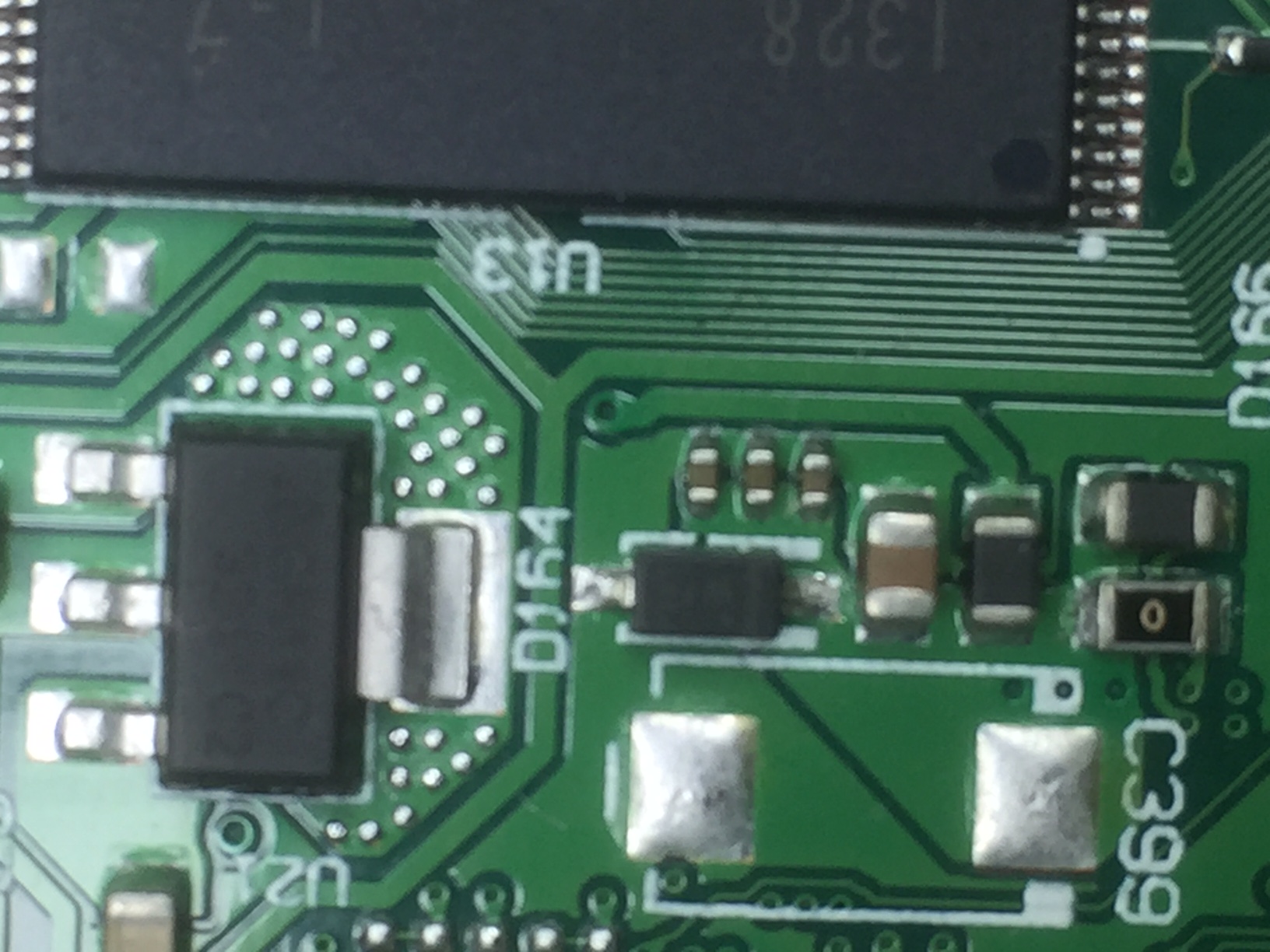

            There is a tiny diode near the Lvds out put not sure on the Pn but check it for S/C and see if its shorted.
              Its D164 see if its shorted out.
                you mean this one, its reading fine...... sadly, looks like a new Main board , does anyone know if there is one going, nothing on ebay
