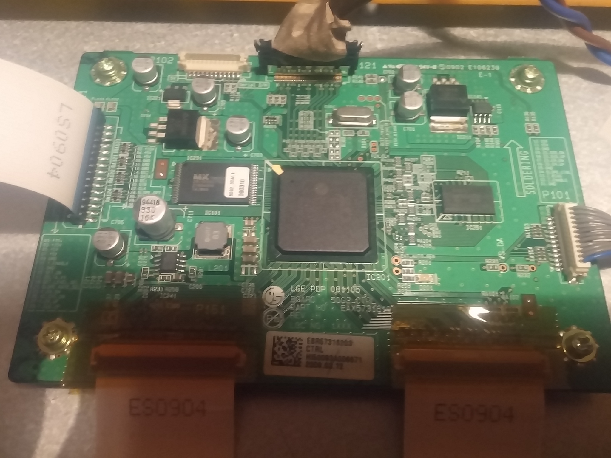

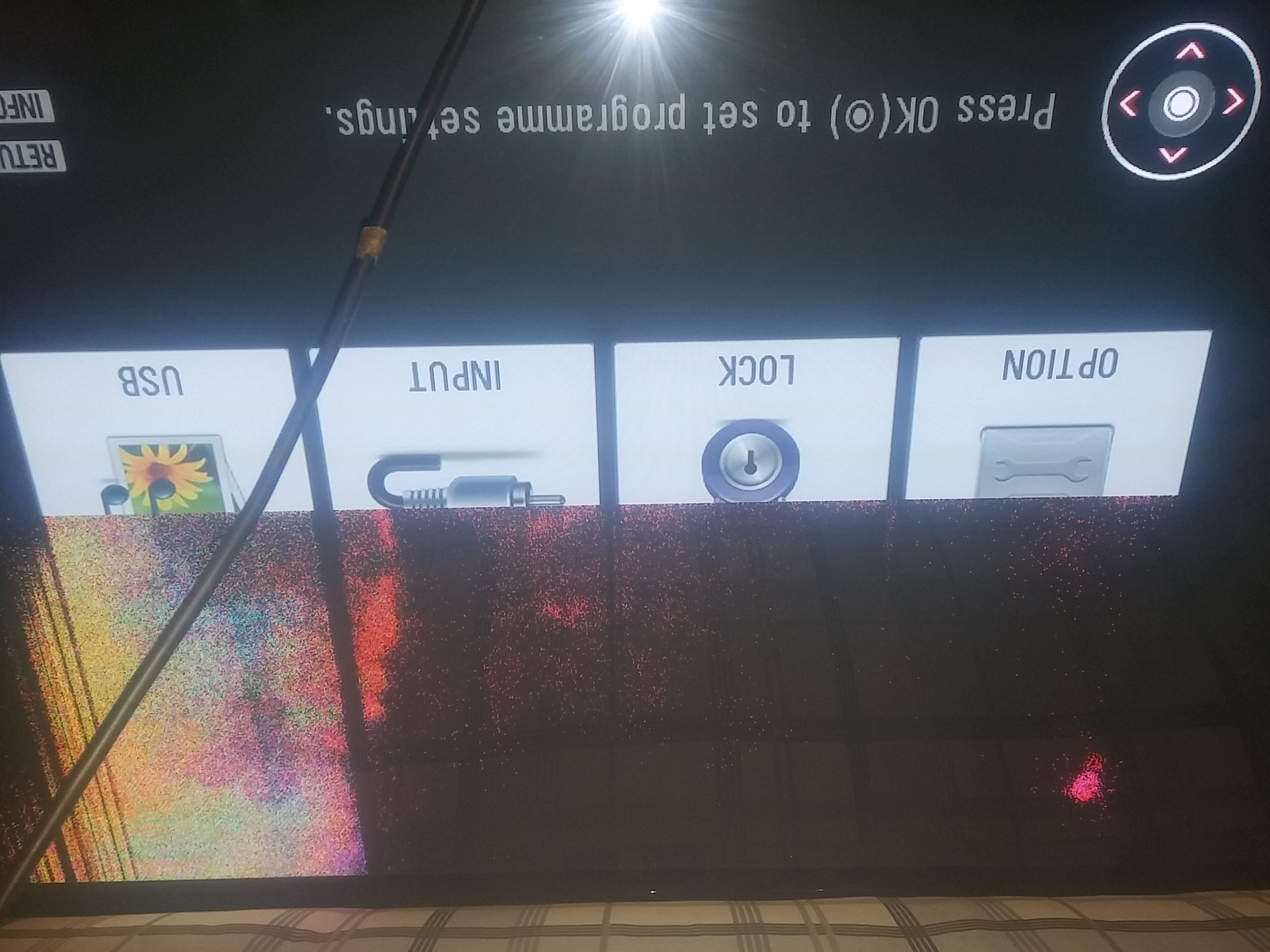

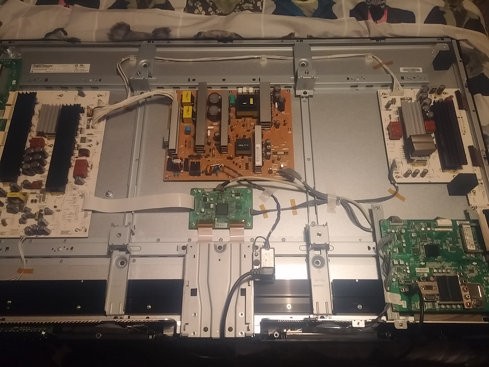

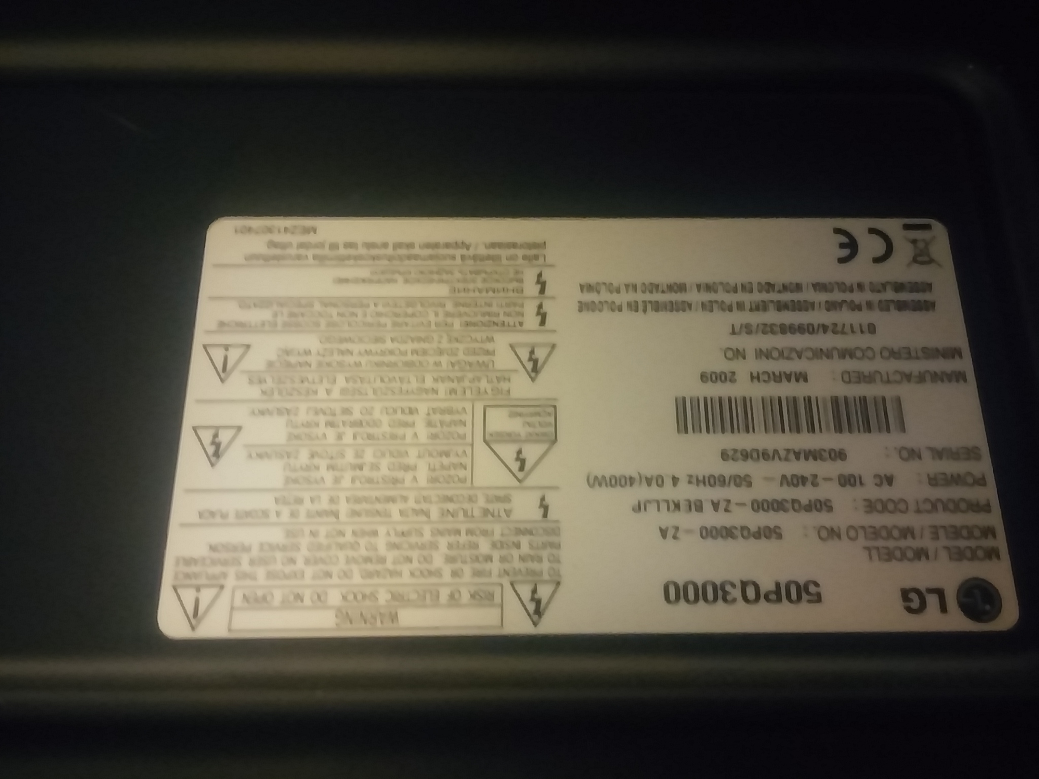

Ok so i have this plasma that has no picture. Ive checked all the fuses i can see and voltages on the y sus and x sus.

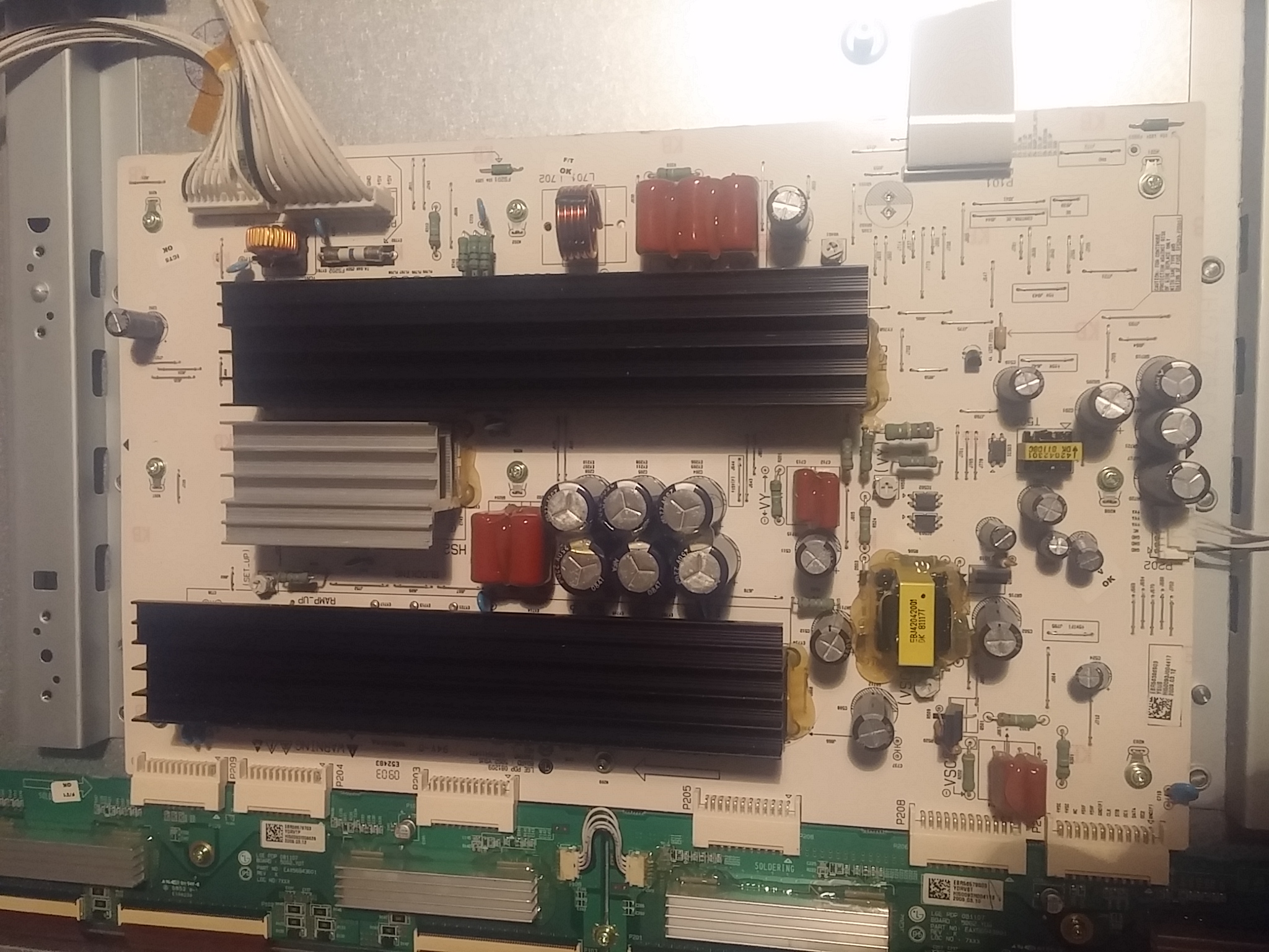

Y sus voltages.
Vs 192.4v
Va 60.1v
Vsc 134v
Vy 185.2v

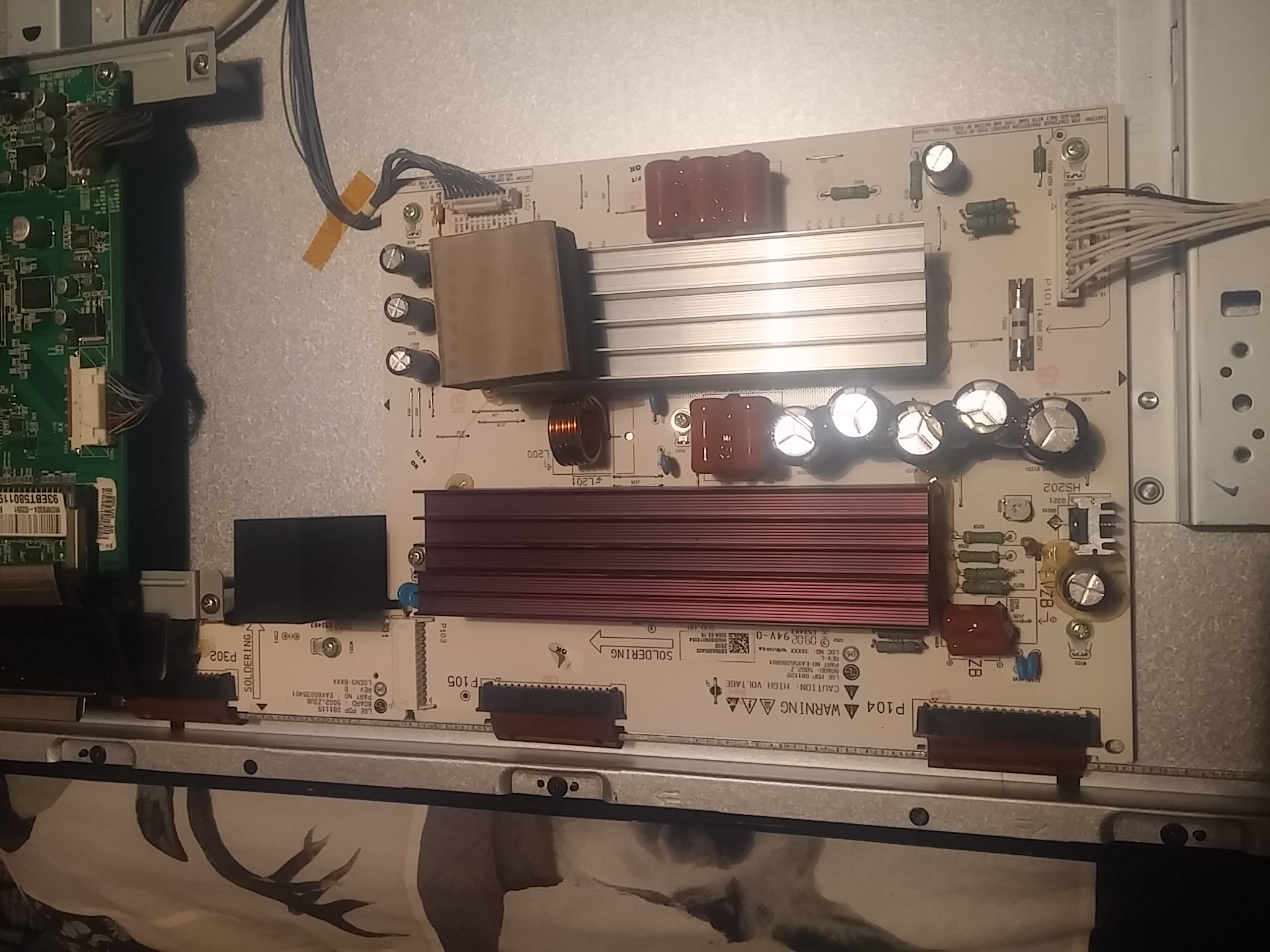

X sus.
Vzb 79.8v
Vs 192.4v

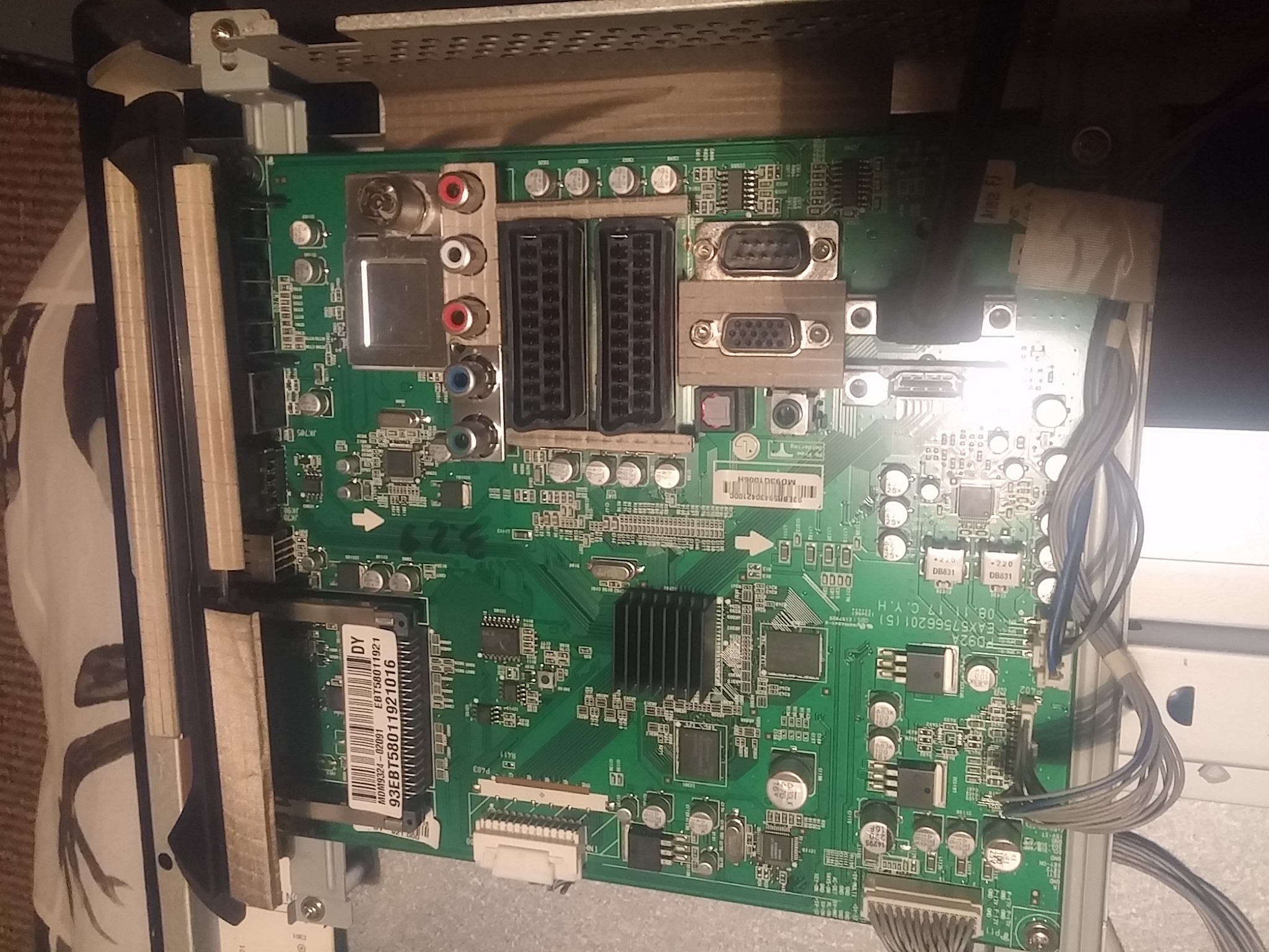

If tou need any more information or in depth photos of a paticular board let me know
