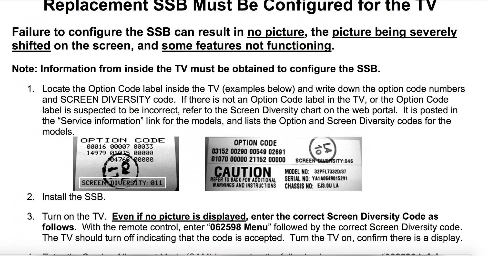

          It is a set of code numbers that allow the SSB to be reconfigured. I bought a replacement SSB and it is being delivered, but I won't be able to complete the repair properly without both a Screen Diversity Code (which I believe is either 027 or 001), and then the Option Code (which is a much longer string of numbers). I will take a picture of an example code sticker and post it here in a minute or two.

              Here is the example pic:

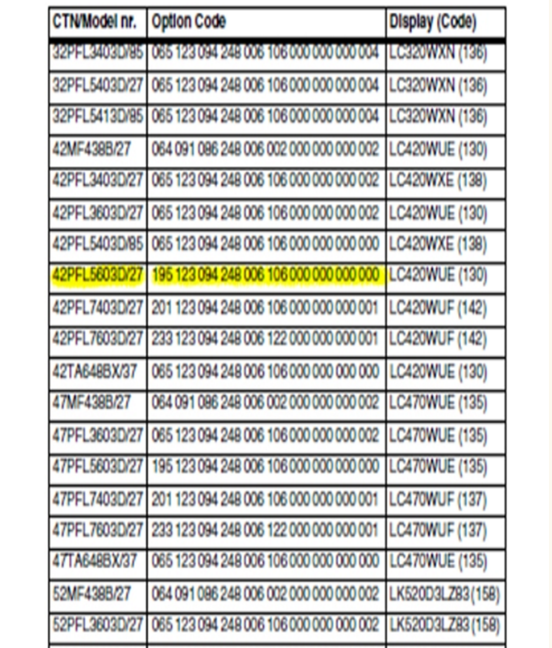

                          Yes, I have tried the Google Image search many times, and the closest I can get is this list (see pic below). But, as you can see, it does not include information from the 50PF7220A/37 model.

                              http://www.shopjimmy.com/philips-310432841173-ssb.htm
                              Notes on that page above: 'PLEASE NOTE: an SSB configuration procedure may be necessary with this board. The instructions can be found here:
                              i do not know if that will work or not. You may want to look through SJ site.
                              http://www.shopjimmy.com/catalogsear...50PF7220A%2F37
                              I hope it may help, Philips also said to look for the sticker on the outside and inside the TV.

                                Thanks for the link. I have come across this and while it helped me to conclude that the Screen Diversity Code is most likely 027 for my set (based on my Panel Number), it did not give me the specific Option Code numbers for the 50PF7220A37. I did look through the rest of the ShopJimmy site but could not locate any more detailed Option Code info there for Philips tv's.

                                  Philips Display code are just 5 or 6 over all model, try one by one, don't give attention on size or model
                                  DISPLAY CODE NOT SSB CODE

                                      I am not sure what you are referring to, Diah. The Screen Diversity Codes are all clearly three digits long, and the Option Code I am searching for is most likely 8 sets of numbers, with 5 digits in each set.
