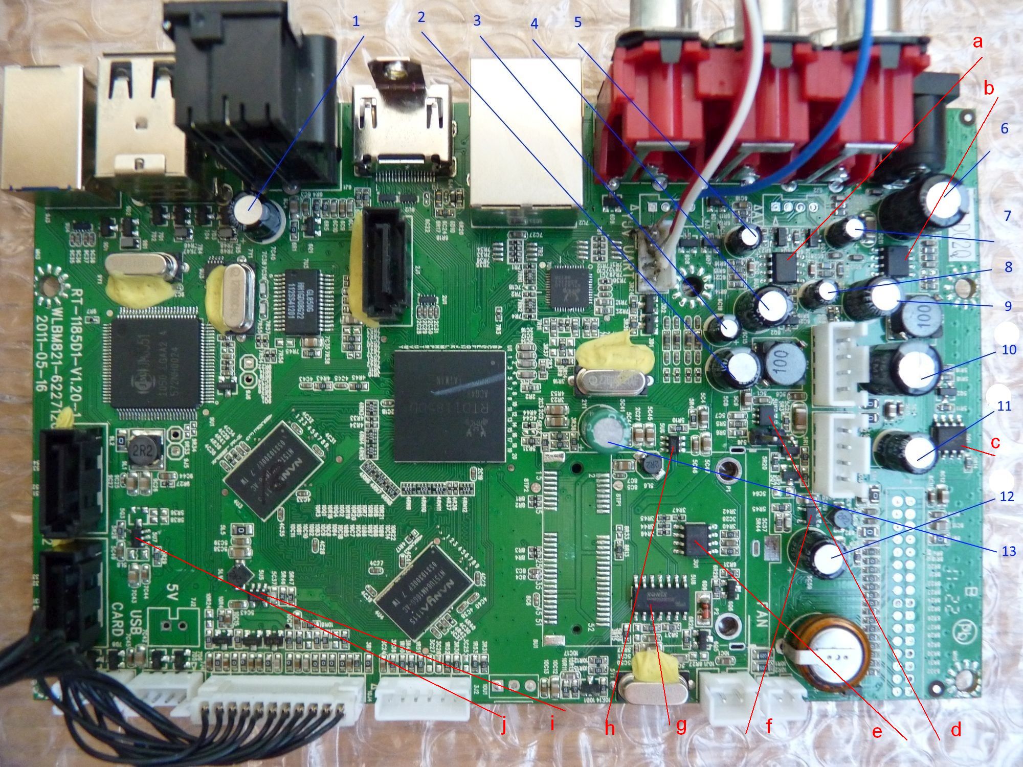

          Since the thread discussed various (ir)relevant things, I wanted to recap the problem:
          - MeLE S1 media center worked OK one night, but can't spin up any internal drives next day and hanged showing desktop after booting firmware OK. It's designed to work with and without HDDs, playing web content
          - HDDs tested OK. Rebooted the player without HDDs - same result. Reinstalled factory firmware - bootloader hanged at launching FW as seen on HDMI and analog screen, can't show desktop
          - re-inserted power plug - by error into (my) outside female connector leading to UART port used to test FW mods. A spark seen. Reinserted to power connector - same result, bootloader hangs at starting FW seen on screen
          - disassembled player to erase EEPROM and reinstall FW. Found no UART output, suspect - UART circuitry damage due to hooking 12v power plug btw Tx and Rx by mistake
          - tried to boot - still on-screen seen bootloader starts and hangs at launching FW. Reinstalled FW again - same result

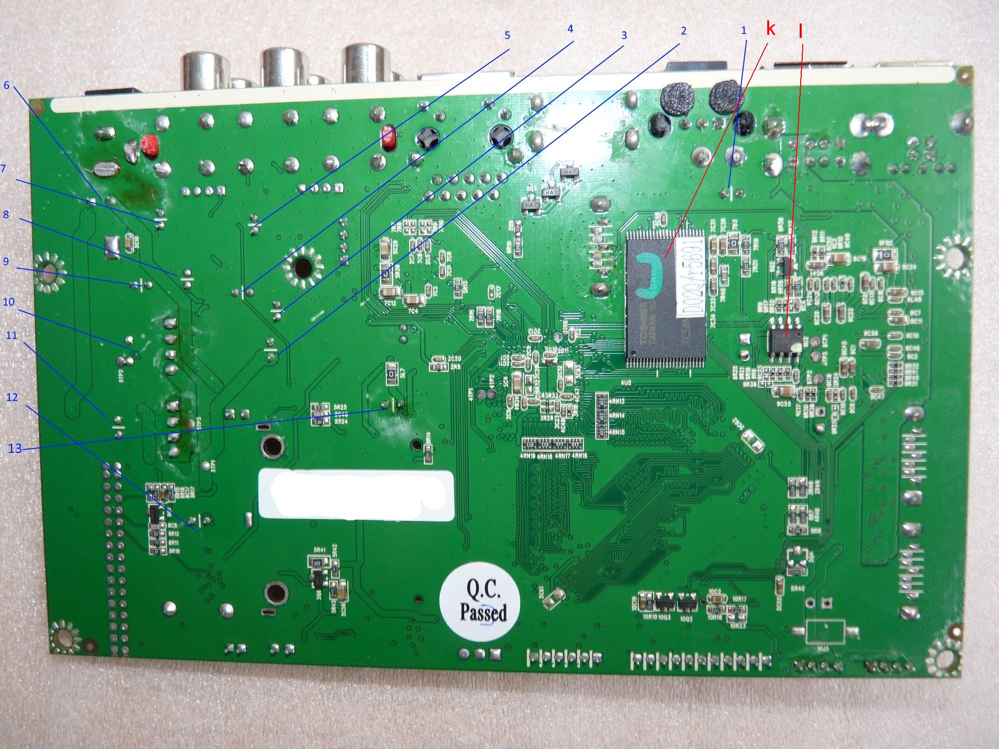

          - measured cap voltages and resistance on-board. One suspect cap with low resistance replaced. Result - no analog and digital video now. Placed the original cap back - still no video or UART output. Suspect: bootloader & BIOS (if used) now can't start, nothing to send to screen
          - under power CPU, RAM, SATA, LAN, USB chipsets are warm as normal, Toshiba EEPROM chip on the back is cold (it might always been)
          Cap voltages:
          1. 25v 100uF 5v
          2. 25v 100uF 5.75v
          3. 25v 10uF 2.90v
          4. 25v 100uF 6.55v
          5. 25v 10uF 6.55v
          6. 16v 470uF 13.8v
          7. 25v 10uF 6.55v
          8. 25v 10uF 2.90v
          9. 25v 100uF 13.8v
          10. 16v 470uF 5.80v
          11. 25v 100uF 13.8v
          12. 25v 100uF 3.68v 36 Ohm
          13. 25v 100uF 1.18v 27 Ohm
          12VDC original Power Adapter output current ripple showing 0.03v at idle measured by DMM in AC mode.
          Found on another forum: "A similar MeLE player RTD1185DD based - doesn't boot beyond bootloader. Advice: check power 3.3V; 1.0V; 1.8V (5 & 12V not used by this CPU)". Where should I check these values on this particular board?
          Some relevant components:
          a. ST C4558 Op. amp
          b. MP1484EN mosfet
          c. Will WPM9435 mosfet
          d. CG0WA power ic 6-pin
          e. AT88SC crypto chip
          f. AB1CB 5-pin
          g. Sonix SN8P250 rc oscillator
          h. CU0WB 6-pin
          i. AB1CB 5-pin
          j. HY0C 5-pin
          k. Toshiba ND2452 NAND Flash
          l. Eon F10-100GIP serial flash
          Other:
          - CPU RTD1185DD
          - NANYA 1115 (NT5TU64m16GG-AC) RAM
          - RTL8211D LAN
          - GL850G USB 2.0 Hub Controller Genesys Logic
          - JMS551 USB 3.0 to 2-port SATA II Controller
          - JMS390 chipset multiplier
          Note: some chipset marks are unclear, so some models above might be wrong, but I doubt so. Couldn't find some chip datasheets.

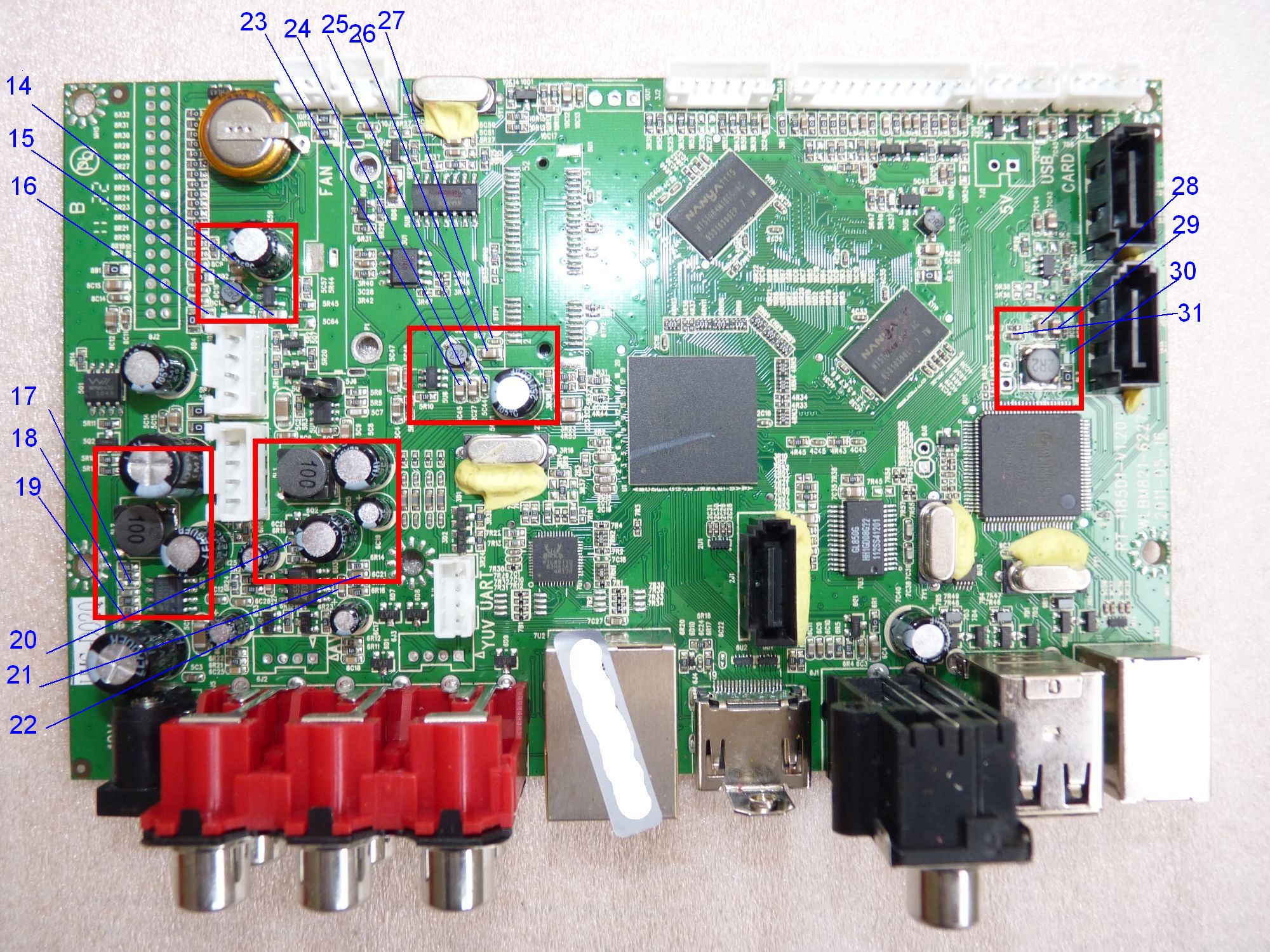

            Check the DCV (measure between the two legs of the caps) of those filter caps in those red boxes (SMPS) to see what you get.
            Notes: the one on the far right next to SATA connectors may not be for SMPS.
            Which cap should I measure in the far right box, probably its of different type, can't find electrolytic axial ones? That circuit appears to power the device Front Panel mounted small board and buttons & connectors (LED, Power button, Copy button, Flash Card port, USB2.0 port - all work OK, I reinstalled FW from it earlier confirmed OK on screen), also possibly powers EEPROM and another small flash chip (BIOS?) on the back of the main board. Doesn't seem relevant to SATA data ports, while 2 SATA white power ports are on the opposite board side.
            Higher resolution board images linked (click to enlarge):
            Front & Back

              those to SMD chip caps on the far right in the far right box.

                SMD cap voltages
                14. 3.7v
                15. 5.7v
                16. 6.0v
                17. 0v
                18. 0v
                19. 0v
                20. 0v
                21. 6.7v
                22. 0v
                23. 1.2v
                24. 1.2v
                25. 1.2v
                26. 3.7v
                27. 0v
                28. 1.4v
                29. 1.4v
                30. 1.4v
                31. 3.7v
                Some caps with 0v are so tiny, its hard to reach them and press firmly, so some of these might actually have some voltage.

                  nope... that was meant for the FAR RIGHT BOX! At the others we want the electrolytics.

                    The electrolytic caps voltages were given twice already in this thread, not sure why you didn't comment on these before.
                    As to SMD cap voltages, I measured all such caps in the outlined boxes, as I don't know who needs what. I need a working player for sure.

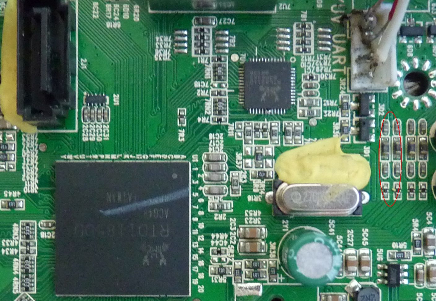

                            Been thinking on the UART. Came to find out that is coming from the RTD1185. So that main ic is toasted for sure if you put 12v to the rx tx lines. Once that's is fixed you can look again at the HDD issue

                              Your sense of humor is truly unsurpassed. However, you are wrong - imagine that! The key is to read attentively this post. It says that after I managed to stupidly put the plug into the wrong spot, the CPU still worked as usual, resulting in FW update progress shown on screen and finished with "Updated OK" message. The player kept showing pic any time I tried to boot, just can't complete boot, and the same was happening even before reinserting power plug. So I don't think Mele girls hooked UART directly to CPU. And duration of impact matters.
                              Edit: In fact if you look on higher resolution images linked above, the traces show UART is hooked to CPU through a chain of resistors and other components. One of these may be toast or not. When bootloader can't start from flash, there might be nothing to send to UART. I don't think these boards have BIOS, so hardware is ID'd by bootloader and kernel at boot.

                                Easy to say for you. So fix the UART then already if you know how to.
                                There is always something to send at the UART. Even if it is just a little something, like one character at every boot. This way I unbricked quite a few devices.
                                Right now you are the one with the board and I am done with this jazz.

                                        Still working on UART trace, but no tight schematics like this.

                                          Also, as per datasheet, there're 2 UART I/O, so is there a 2-nd UART access on the board?
