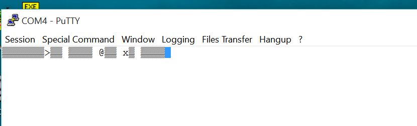

    Thanks for the link. I'll try to find one with similar chipset M12864 on Ebay or such. There are a large number of ESR units on Ebay, but I didn't know which one makes sense to buy. Also, VC9808+ has Capacitor measurement, and over time it proven to show relatively accurate capacitor values matching their printed spec values, of course when removed from a board.
    I read that current ripple can be accessed by measuring DC and AC values, and then doing some calculations. Here is another relevant thread.
    Tried to get UART output at 115200, 19200 and 9600 with 8n1, and on some occasions I'm getting what you see below, but on most occasions there is none. I tested the UART cable just now on a plug PC like Raspberry, and it works perfect. Also a year ago I read UART output from this player board using the same layout while testing some FW updates. It failed just recently after being out of power for a day, before it was always under power, while switched On and Off when watching movies by its front panel button. Does it hint about any possible failing components?
