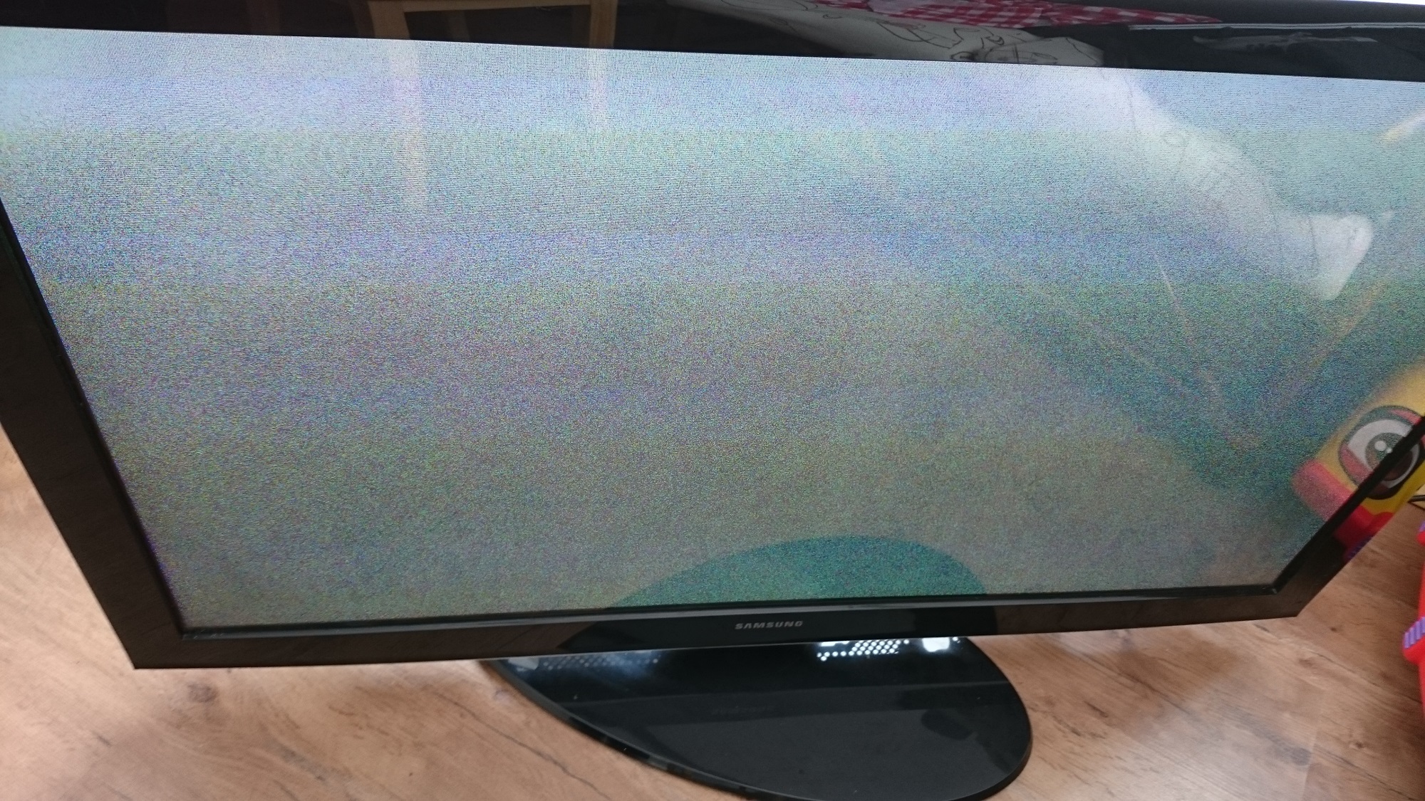

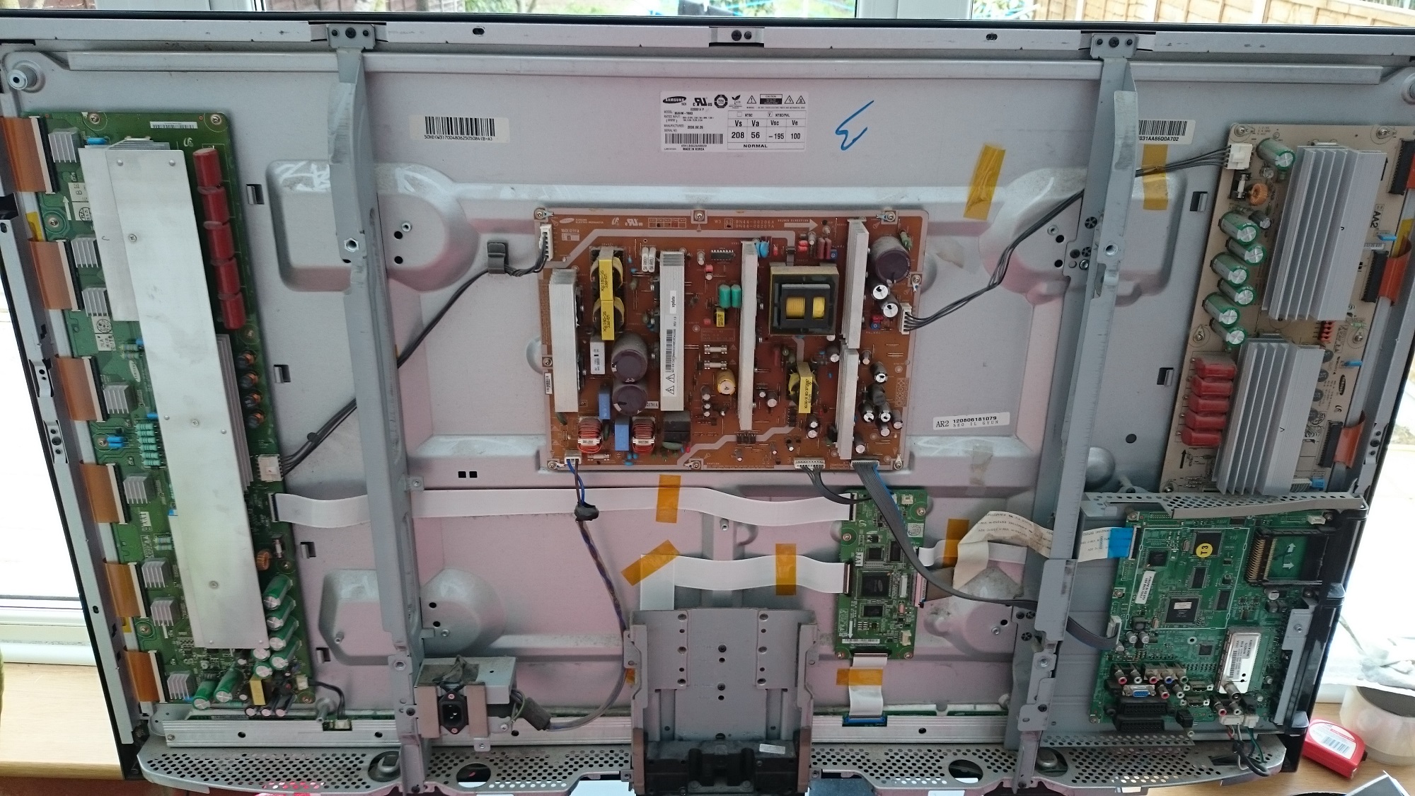

    Hello I have this samsung plasma PS50A457 I have sound but no Picture.
    I have already changed the Y-sus board with one I am 100% is working and still no picture.

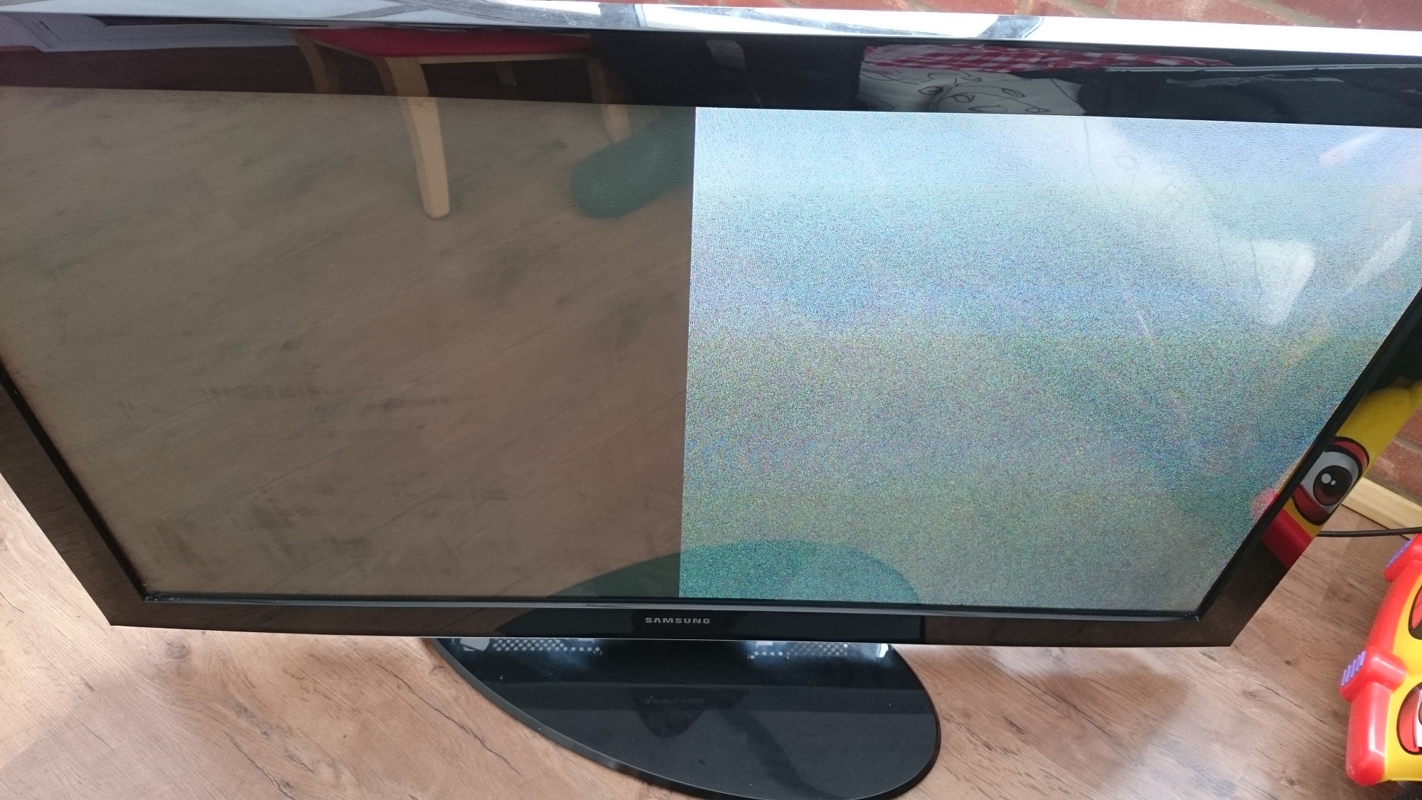

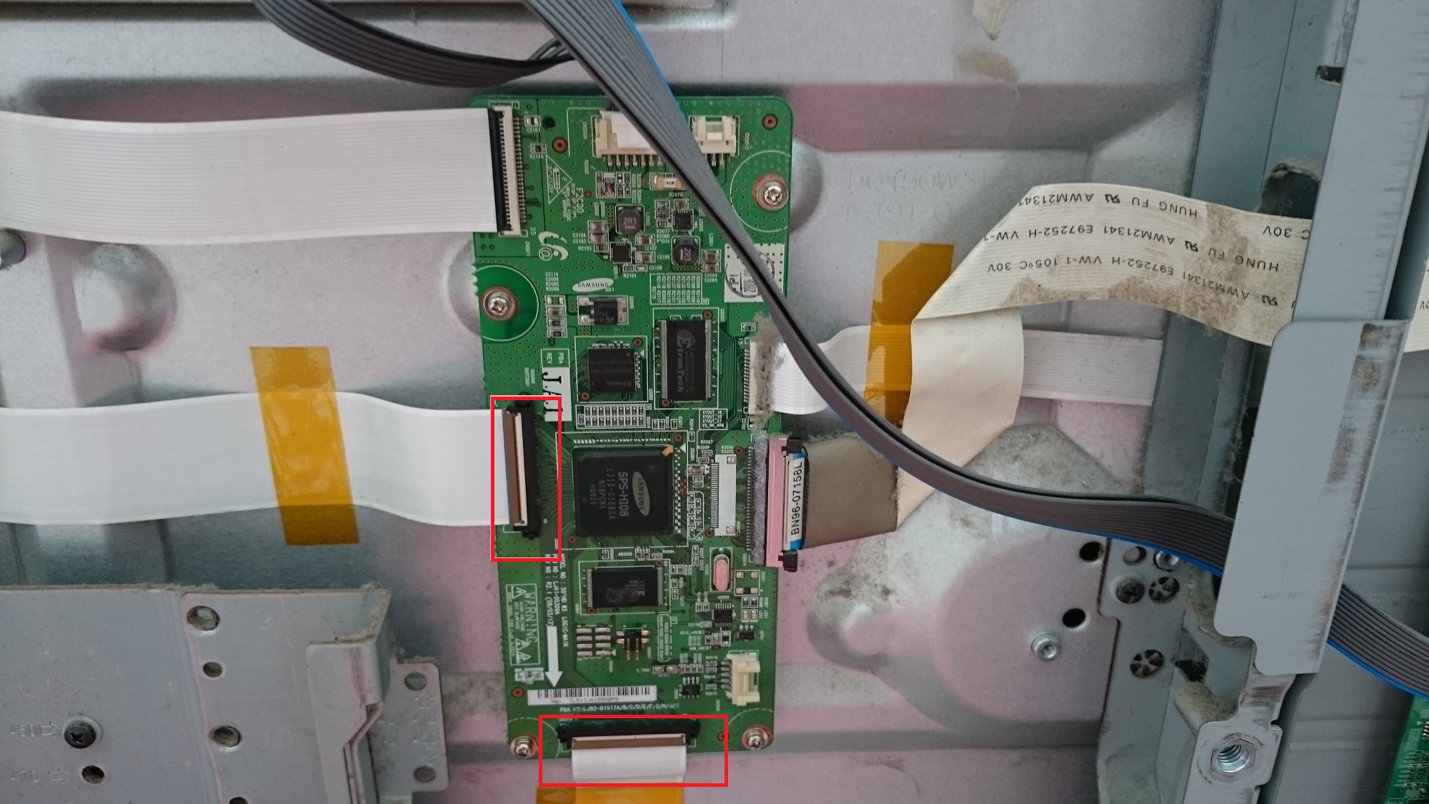

    After disconnecting the 2 ribon from the control board highlighted with red in the picture I get all screen white .If disconnecting only 1 ribon I get half screen white.
    Could anybody help me what would be the next test ?Thanks in advance .

    Re: Samsung plasma PS50A457 No Picture
    Have u tried test patterns ?
      Could You Help me to do test pattern on the tv? I have never tried.
        This may help you.
        https://www.badcaps.net/forum/showthread.php?t=26790
