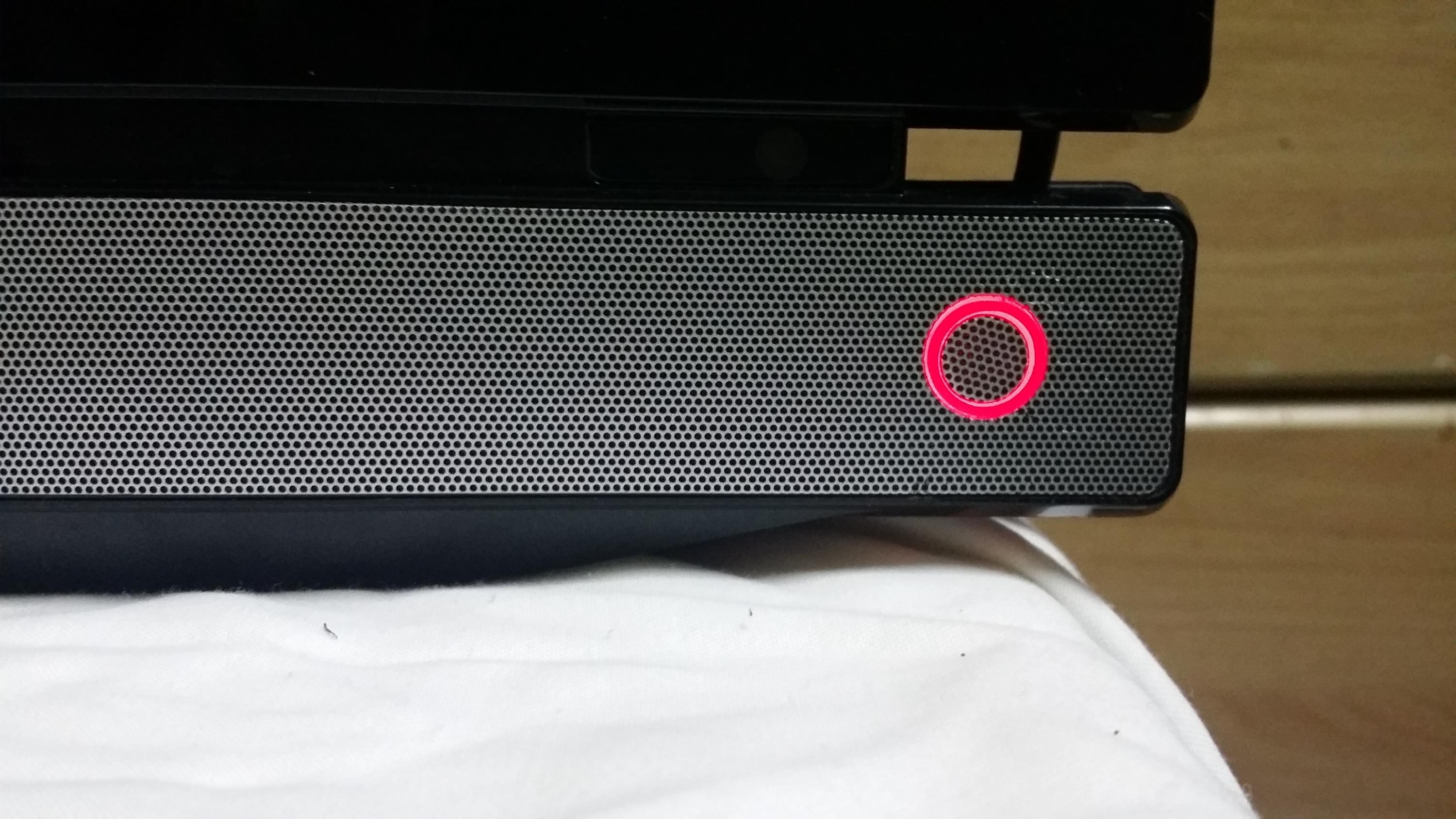

    I have this unit a year sens i purchase it. last 3 days ago it wont turn on even
    in manual start. he have a standby light indicator solid red and its also a 5v stand voltage. could you give me guys a suggestion if what parts it could be damage or what testing procedure i cant do to rectify the problem.

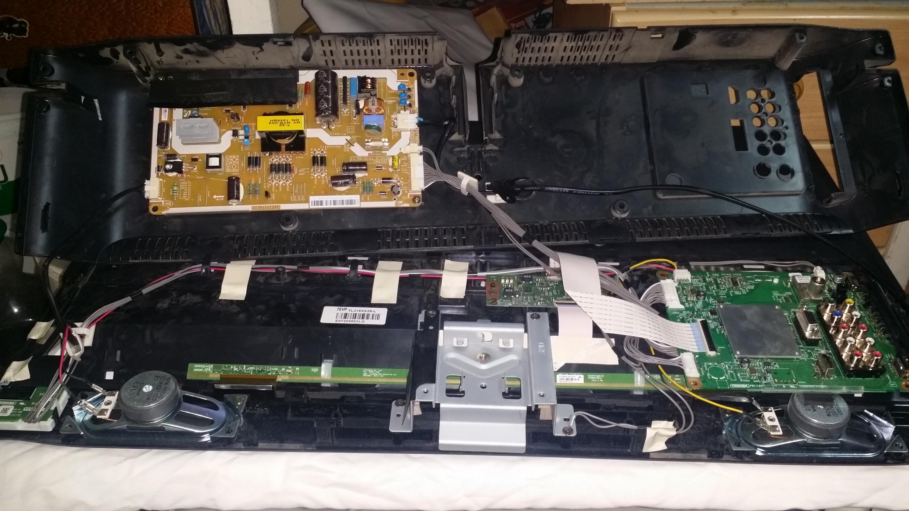

          Re: Toshiba led tv 32P2305EE won't turn on
          Uploading good clear pictures of the boards and the whole back side of the TV so we can see how all the boards are connected together will be a great help for troubleshooting your TV.

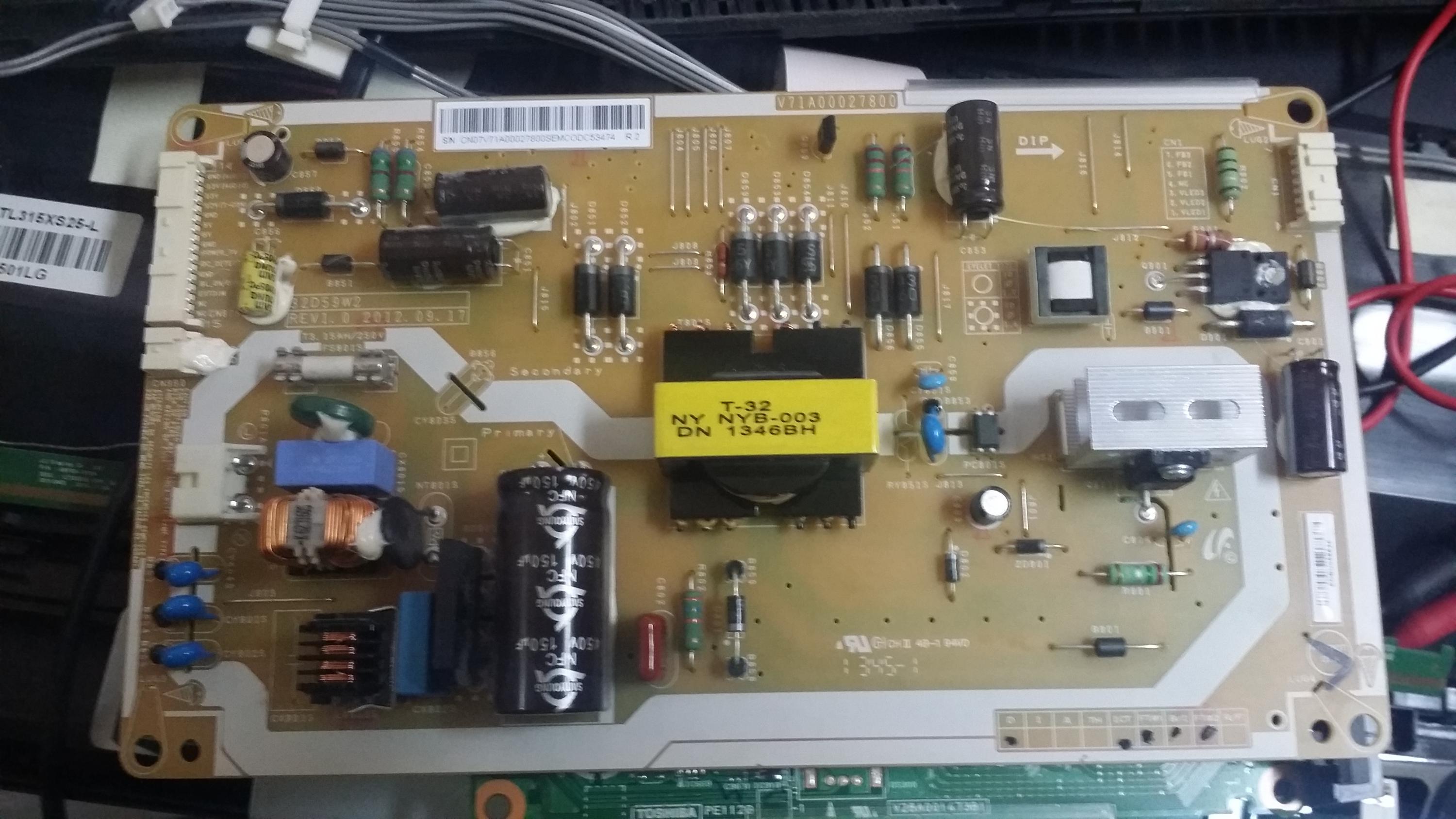

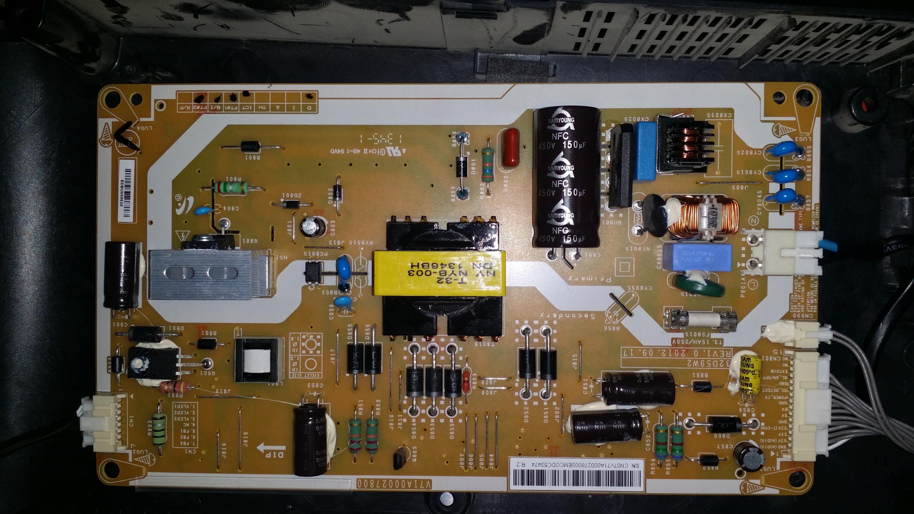

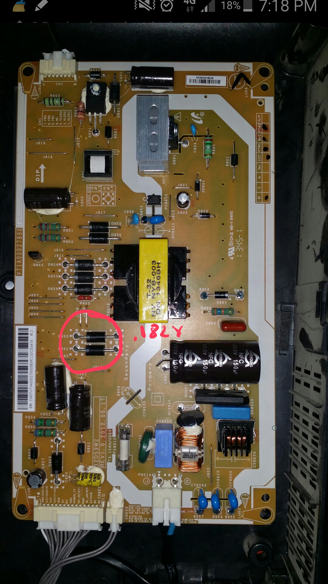

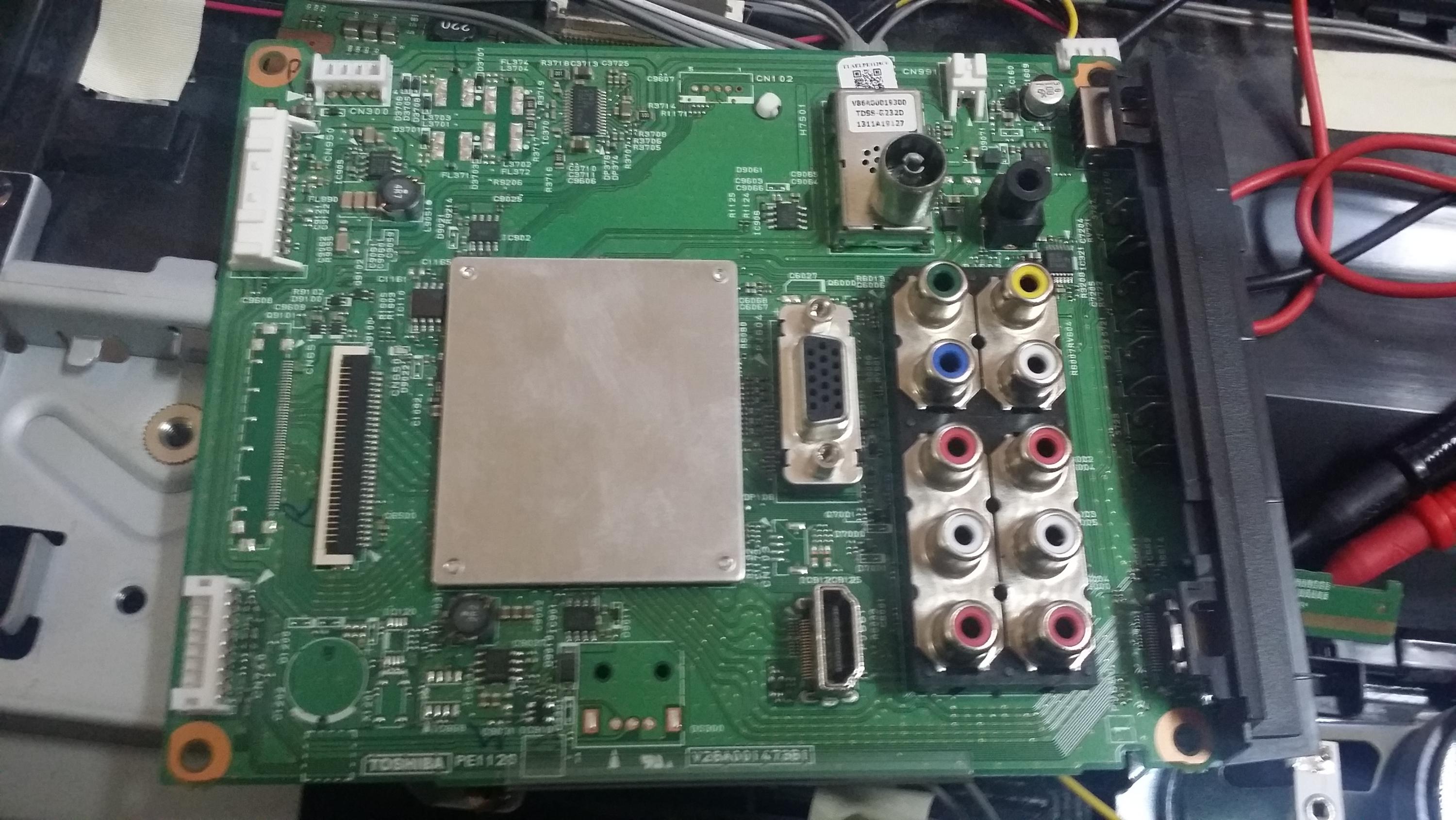

            This is the power supply board and main board
            Thanks.
                https://www.badcaps.net/forum/attach...6&d=1458575881
                Pictures is too out of focus to read the pin labels for the connector.

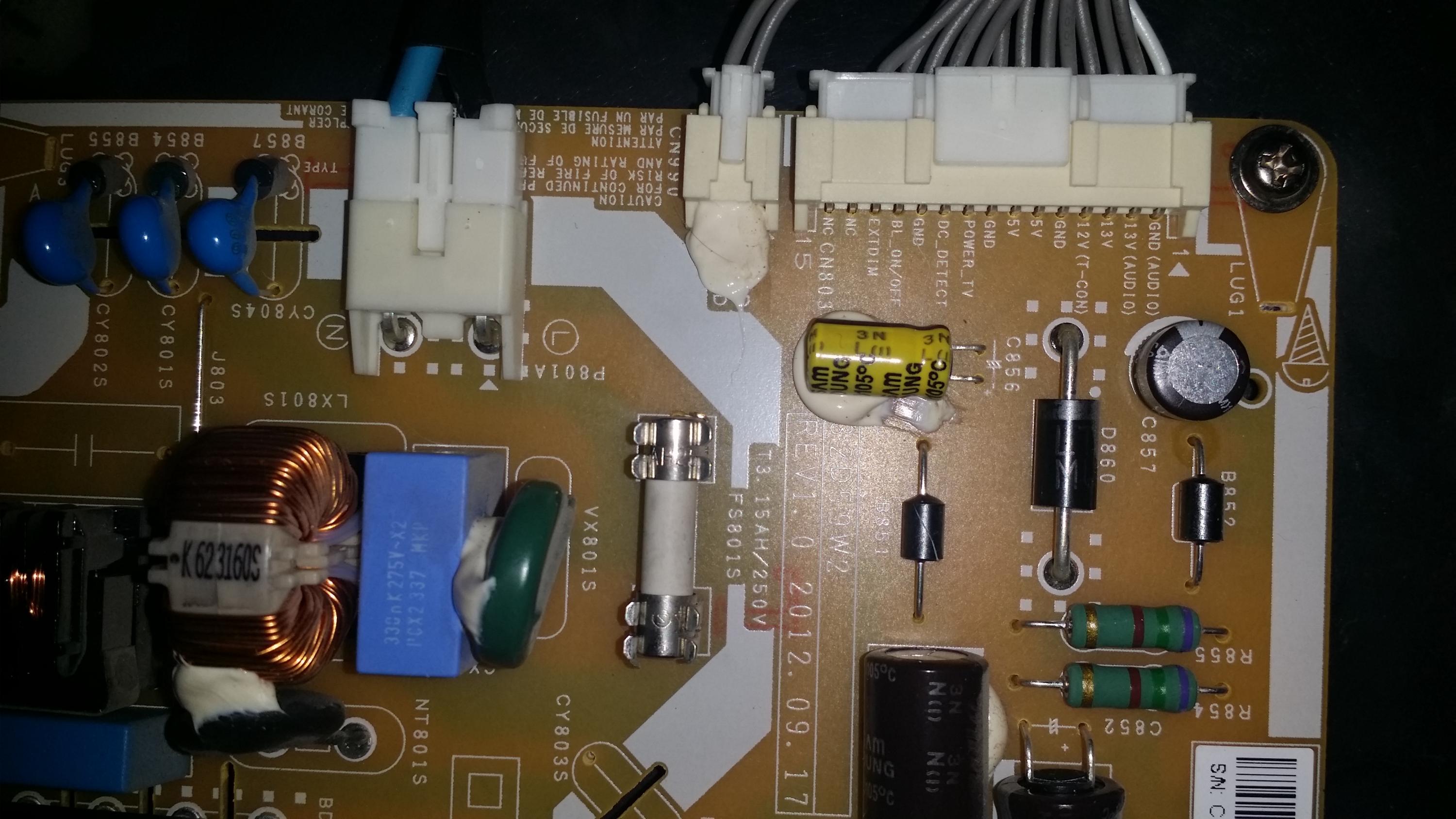

                  Can we get a closeup photo of the white 15-pin connector on the left side of the PSU board, next to the yellow capacitor? Need to see what the labeling is for those pins.

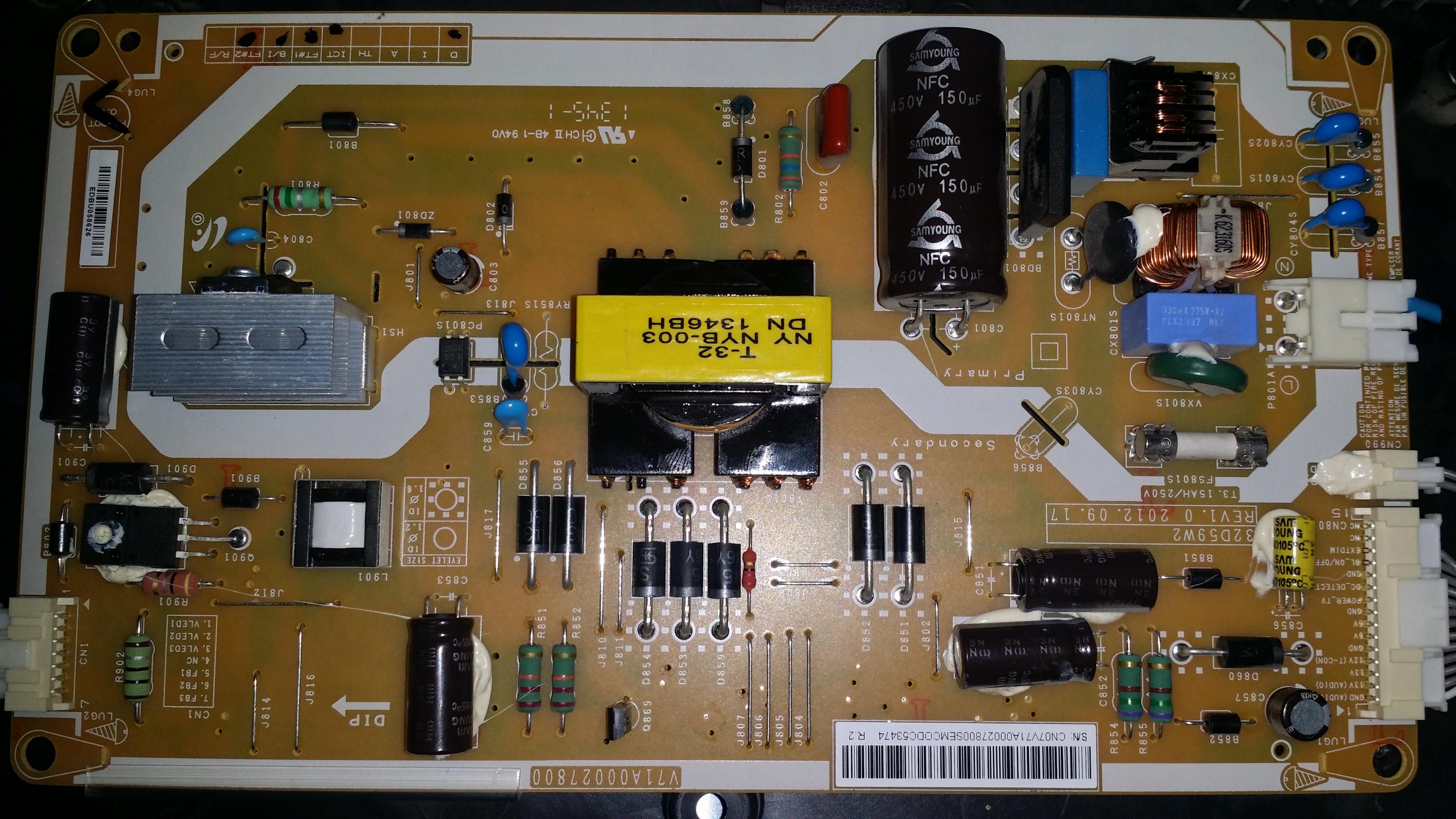

                      Good day.
                      This is the clear copy picture psu board and
                      Symptoms
                        I found 2 diode supplying 5v was already. 1v
                        When I test in digital tester. But when you check
                        The standby voltage still giving 5vdc

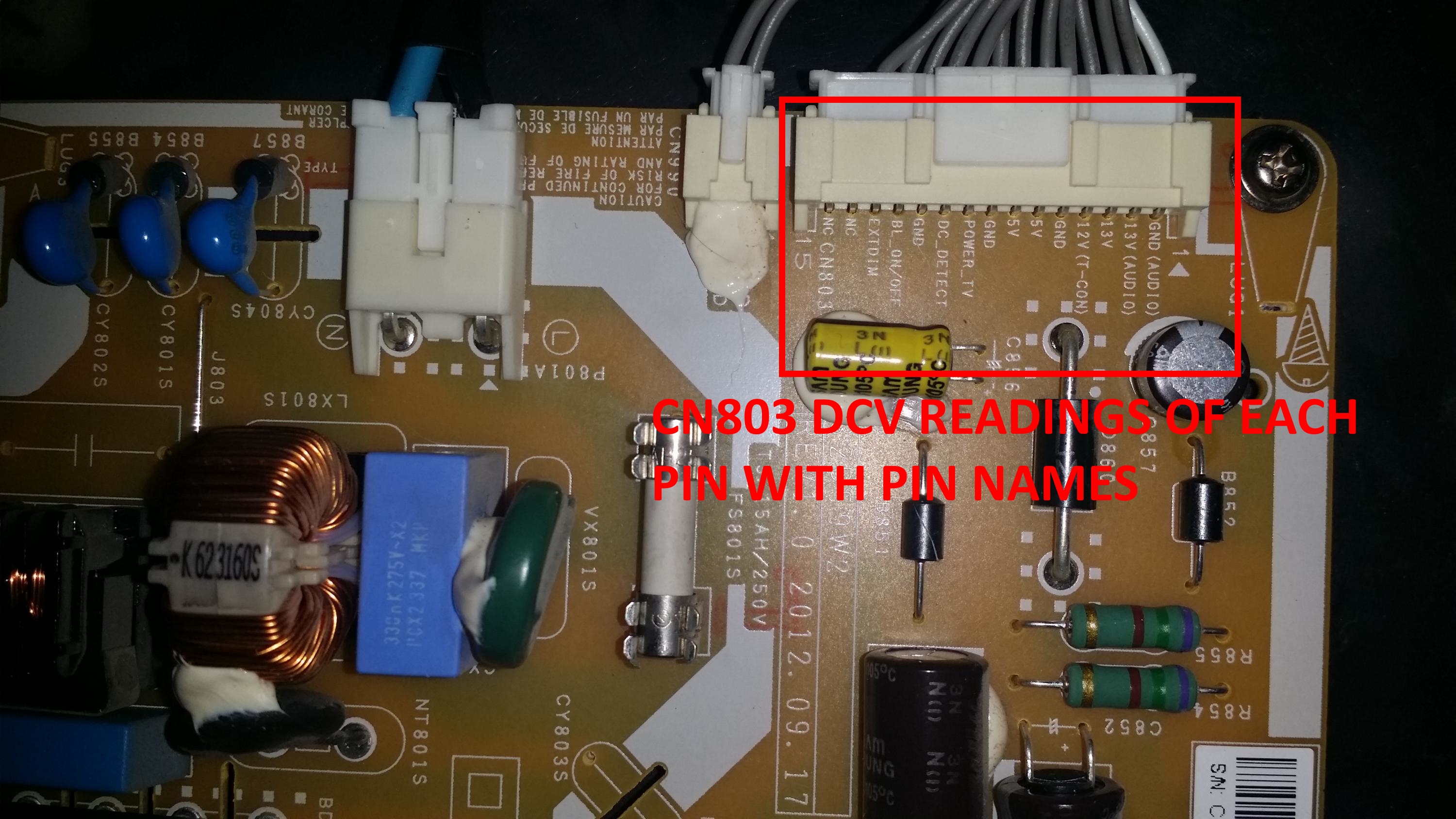

                          Please report the DCV reading of each pin foe the connector CN803 when poweer switch is activated.
                          Please report in this format so it will be easy for us to see what are missing:
                          For example
                          13V = ??? V
                          13V = ???? V
                          12V(T-CON) = ??? V
                          • Nasha
                            • Mar 2016
                            • 25
                            • Riyadh saudi arabia
                            Pin 1 GND
                            2 13V audio= 13V
                            3 13V = 13V
                            4 12 T-CON = 12V
                            5 GND
                            6 5V = 5V
                            7 5V = 5V
                            8 GND
                            9 POWER_TV = 3.2V
                            10 DC_ON OFF= 3.2V
                            11 GND
                            13 EXTDIM = .4V
                            14 NC
                            15 NC
                              Originally posted by Nasha
                              Pin 1 GND
                              2 13V audio= 13V
                              3 13V = 13V
                              4 12 T-CON = 12V
                              5 GND
                              6 5V = 5V
                              7 5V = 5V
                              8 GND
                              9 POWER_TV = 3.2V
                              10 DC_ON OFF= 3.2V
                              11 GND
                              13 EXTDIM = .4V
                              14 NC
                              15 NC
                              OK, so it has the correct Voltages and signals with an exception of the EXTDIM of only 0.4V. You may want to turn the TV off, then put the meter probe on this pin , then turn the TV on to see if the Voltage does jump up much higher than 0.4V and then goes down to 0.4V.
                              Did you see the LED backlights even flash on for second?
                              So far it looks like what you do not have are the backlights for you to see the images on the screen.
                              BTW, please stick to this thread so we do not have to follow the progress of the repair in two threads.
                                You've missed out pin 12? BL_ON
                                  Ah, good catch!
                                  • Nasha
                                    • Mar 2016
                                    • 25
                                    Pin 12 BL_ON OFF =0V
                                    also I found out this diode who's series in pin
                                    6&7 5V when I test in diode testing I get only .1v
                                    Supose to we get is .3V to 8V correct me if I rong.
                                    • Nasha
                                      • Mar 2016
                                      • 25
                                      .8V sorry
                                        OK, the main board is not sending the signal to turn on the backlights circuits, and also the dimming command is also very low.
                                        Your standby power supply is fine otherwise you will not have the PS-ON signal.
