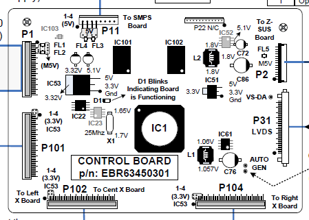

        I am not sure if your model has the AUTO GEN feature on the Control Board, but you could check if by shorting it and removing the LVDS cable would show anything. This way you could see if the problem is with the Main Board or not.
        • cybericius
          • Mar 2016
          • 15
          • Hungary
          Re: Please help lg plasma 60pz550 ua no picture or sound after changing mainboard
          LVDS is the one that connects the Main Board to the Control Board.
