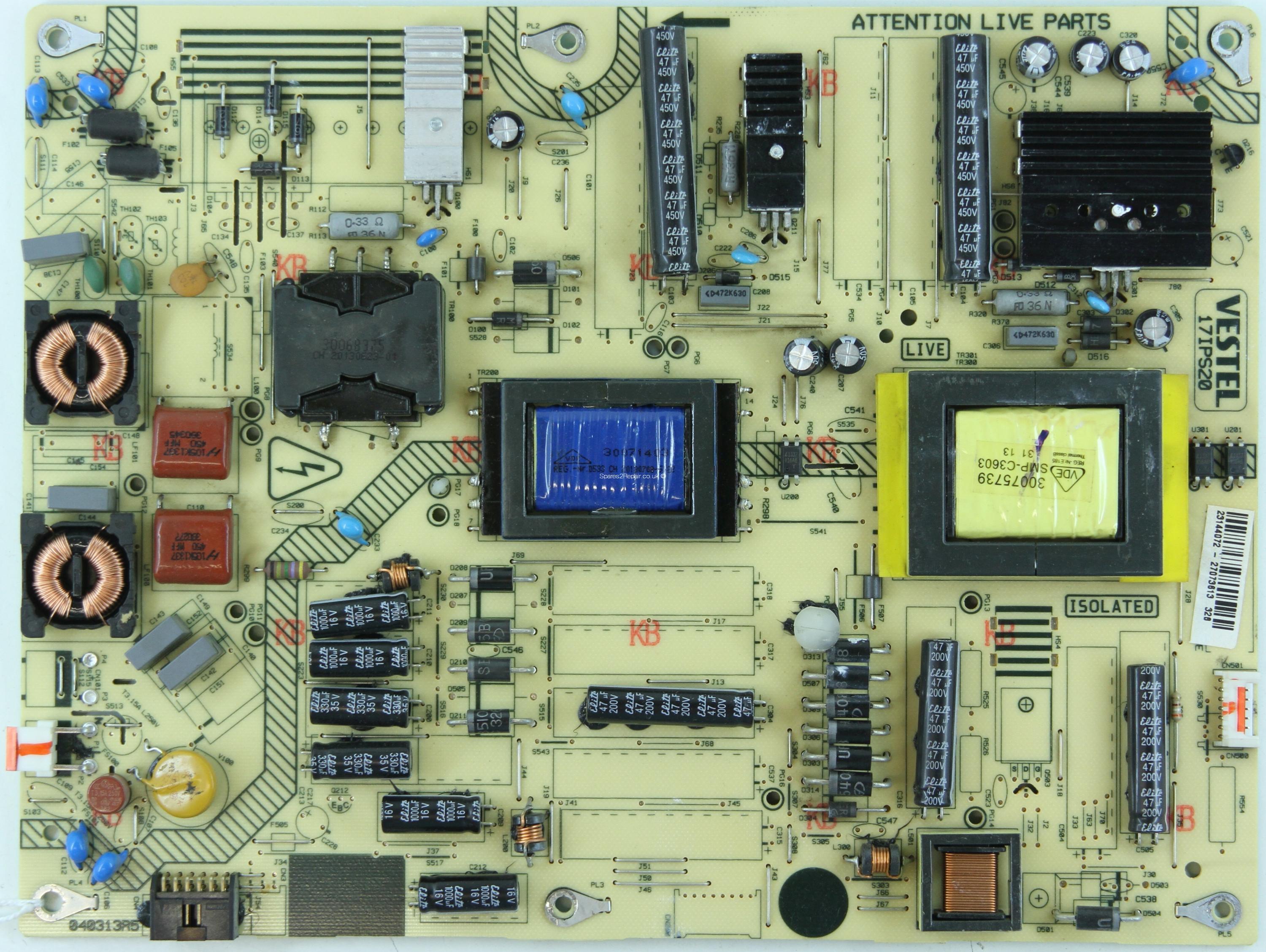

JVC LT-40DJ51J - Vestel 17IPS20 - LEDs very dim
  • ReeceyBurger123
    Never Give Up !
    • May 2014
    • 7325
    • Britain
    #41
    Re: JVC LT-40DJ51J - Vestel 17IPS20 - LEDs very dim
    Originally posted by flocko
    J60 is a plain jumper wire, what have you been putting in that vape of yours?
    Lol also mine had a resistor will get image of it
    • m4life
      • Sep 2018
      • Nigeria
      #42
      Any update on Vestel 17IPS20 - LEDs very dim
      • R_J
        • Jun 2012
        • 9624
        #43
        17IPS20 with resistor at J60, some of the boards have nothing at J60, some have only a 2 pin plug at CN500
        • ictc
          • May 2015
          • 46
          • Italy
          #44
          Same issue with same PSU. I still can't figure out the main cause of the low voltage.I have other two working spares PSU were backlight rise until 140v and stays stable. On the faulty one the voltage measured on the connector cn 500 with led connected, rise till around 114v than fall down to 107v remaning stable but never reaches the 140v needed to light up the leds...
          Any hint?
