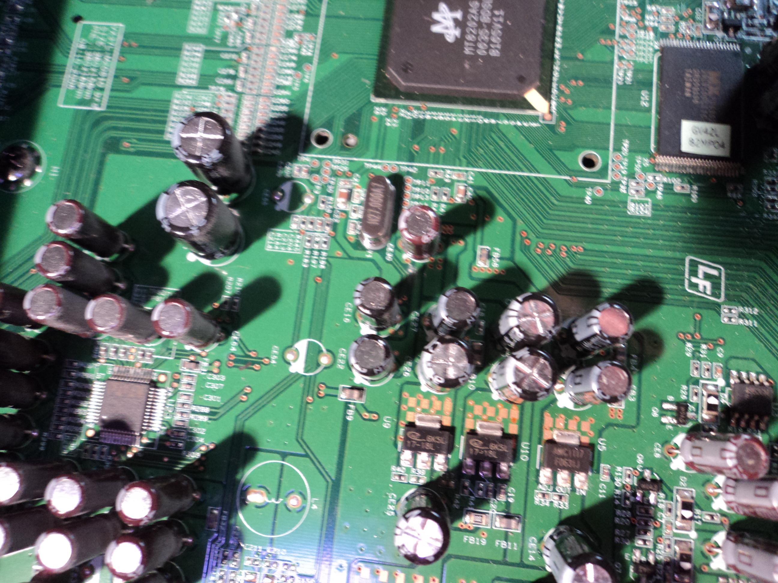

    Vizio GV42L relay clicks tv dead.
    Hi guys; after my big disappointing with My Sony KDl46S410, bad panel,one of my friends knocked at my door with a Vizio GV42L i would normal say no but he's been threw a rough time fighting his cancel and he' still an Yong man, i couldn't say no, this Vizio came in with power clicking relay with white logo led on,
    I have all the voltages right per manual,except U5 that i suspect, i went through the outstanding Bad-caps thread files help on this model#.
    https://www.badcaps.net/forum/showth...ht=vizio+gv42l
    U5
    pin 1=0.323v
    pin 2=0.900 output pin=0.900
    pin 2=3.30

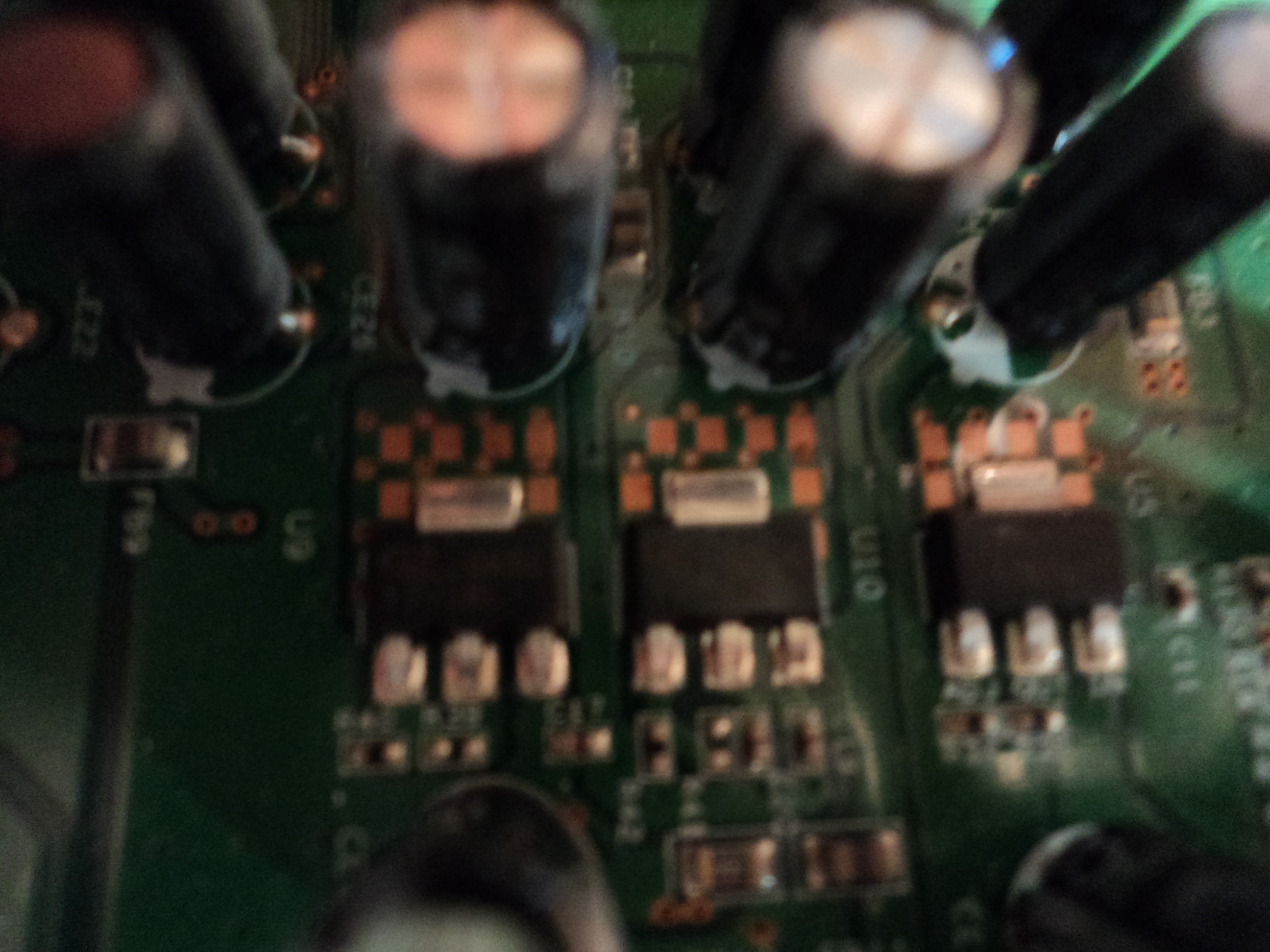

    there are 2 other regulators next to U5
    U-10
    pin 1=0.00v
    pin 2=1.8v output 3.30v
    pin 3=3.29
    U9
    pin 1=0.00v
    pin 2=1.80v output=3.29v
    pin 3=3.29v
    so i think U5 is bad, can it cause the tv not to work? before i have my friend to send for a Main board i'd like you help and expertise, thanks in advance.

    What' the part number of U5?

      my friend says he was waching video and just heard a pop before tv went out.
      Thanks jetadm; Regulator U5 - AMC 1117 -F0631j
      maybe this pic attach. is better.
      Also if i have to try this U5 regulator, can you please suggest a good seller also is this part number AMS1117 0450 compatible?

        U5 is bad and it appears to be an adjustable regulator. The AMS version appears to be compatible. It's just made by a different company- AMS versus AMC. The 1117 adjustable regulator is made by several companies and can be easily found on a site like digikey.com.

            Hi guys; update on Vizio 42GVL,as i said this guy brought me this LCD tv to repair,story short i troubleshooted it and found out U5 on Main Board bad so i called the guy and told him to order Regulator U5 - AMC 1117 -F0631j, but it would not be a sure thing and after installing it if it would not work he could try and order the main board,well it's been more than 2 weeks and no regulator, a part that costs 1 buck or so and no response not even an email.well since i have a Main board from a Vizio 32 VW32L on my scrap and checked for a Adjust regulator 1117 that would not be faulty and found U4 LO23-G1117
            i took it out and soldered it on Vizio GV42L main Board on U5,and power TV up and voila it's working again,but i'll be darned if i tell him that tv is fixed, before he comes up with the part i asked for, if he never brings the Part i will keep TV.
            And for future reference here voltages on the regulator before repair and after repair.
            U5 =Bad AMC 1117 -F0631j
            pin 1=0.323v
            pin 3=3.30
            U5-Good LO23 -G1117
            Pin 1 adjust=0.701
            Pin 2 out =1.9v
            Pin 3 In =3.2v
