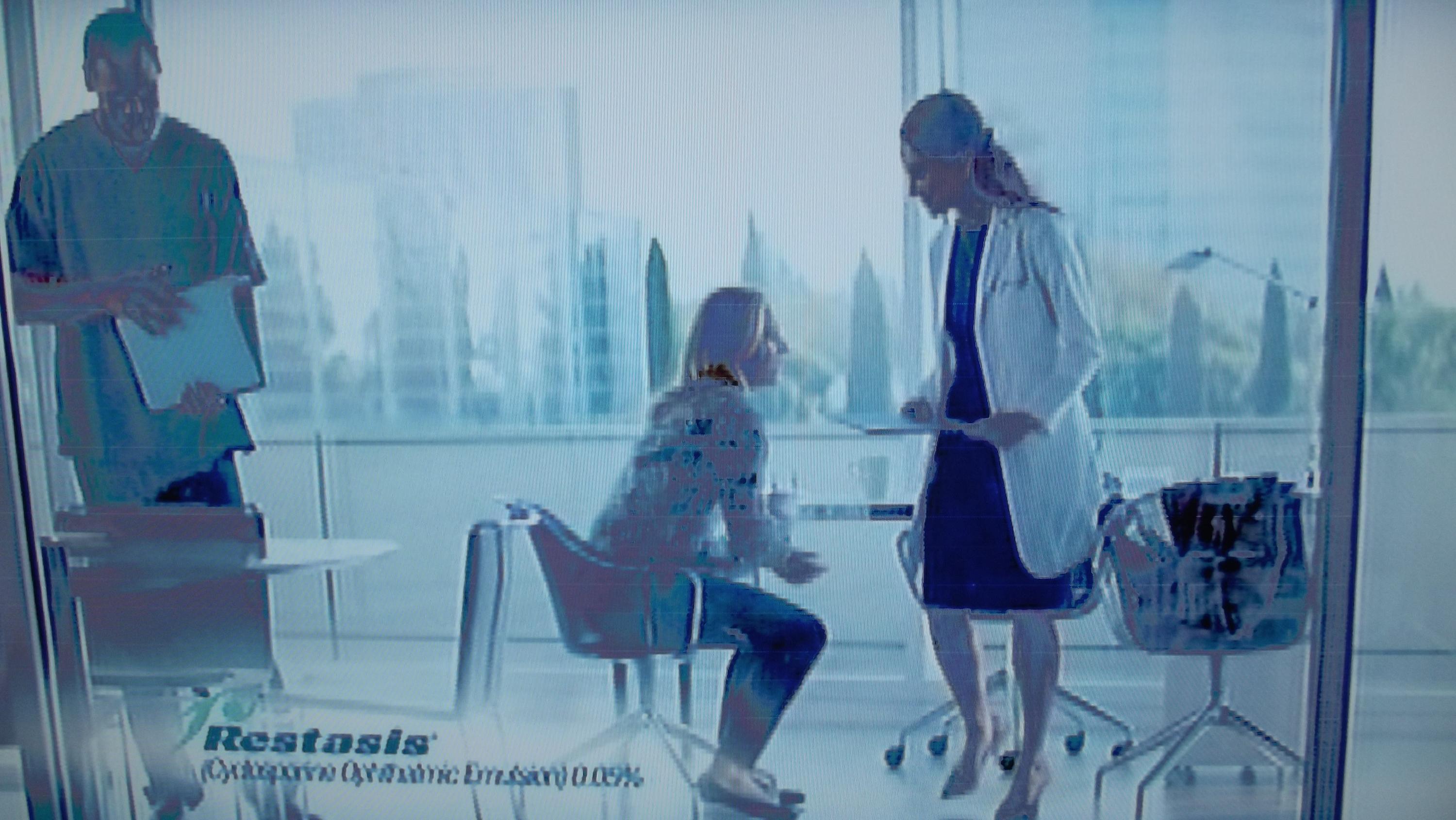

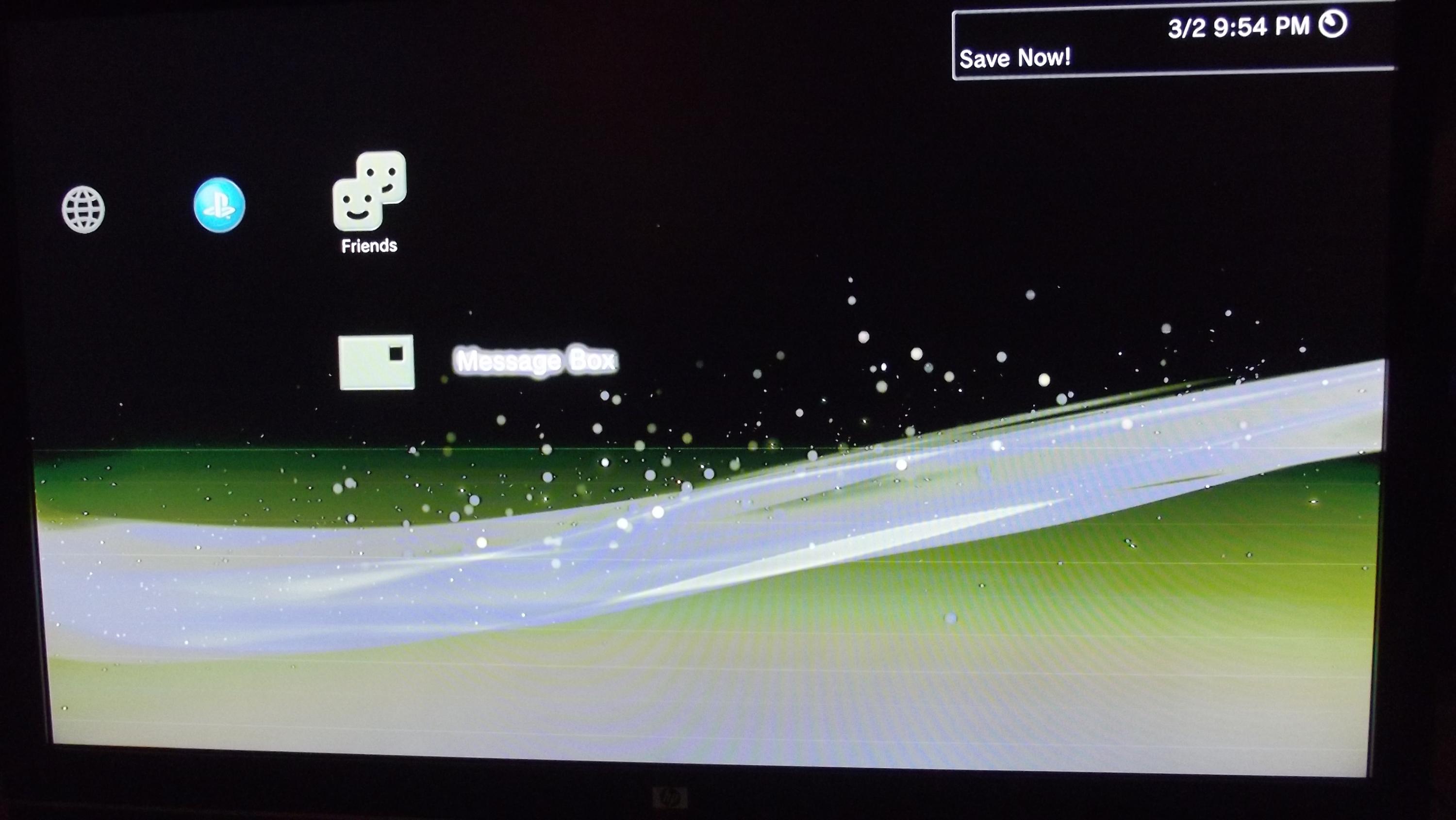

    Here I go again.
    I now have a HP TV/monitor that has a fuzzy semi focused picture with washed colors and thin horizontal white lines that jump around.
    I haven't fully tested it, can't get the components input to work as well as one of the HDMI ports. Cable/antenna in works, HDMI #2 works. Have sound, all functions via remote work.
    The picture is worse when in cable mode.
    The white lines show up only when there is a picture, without any inputs the screen is fine.
    Am I looking at a Tcon board?
    HP LC4776N 47"
    Product # RP850AA
    MDL CPT04 0708
  • dsc
    • Aug 2015
    • 53
    Re: Hp lc4776n
    Ran a few checks, finally took a shot at it being the tcon and picked up one from Shop Jimmy.
    Took care of just about everything, just need to fine tune it using the power off press power button 5 sec. procedure.
    Not a bad set for a total of $14.
