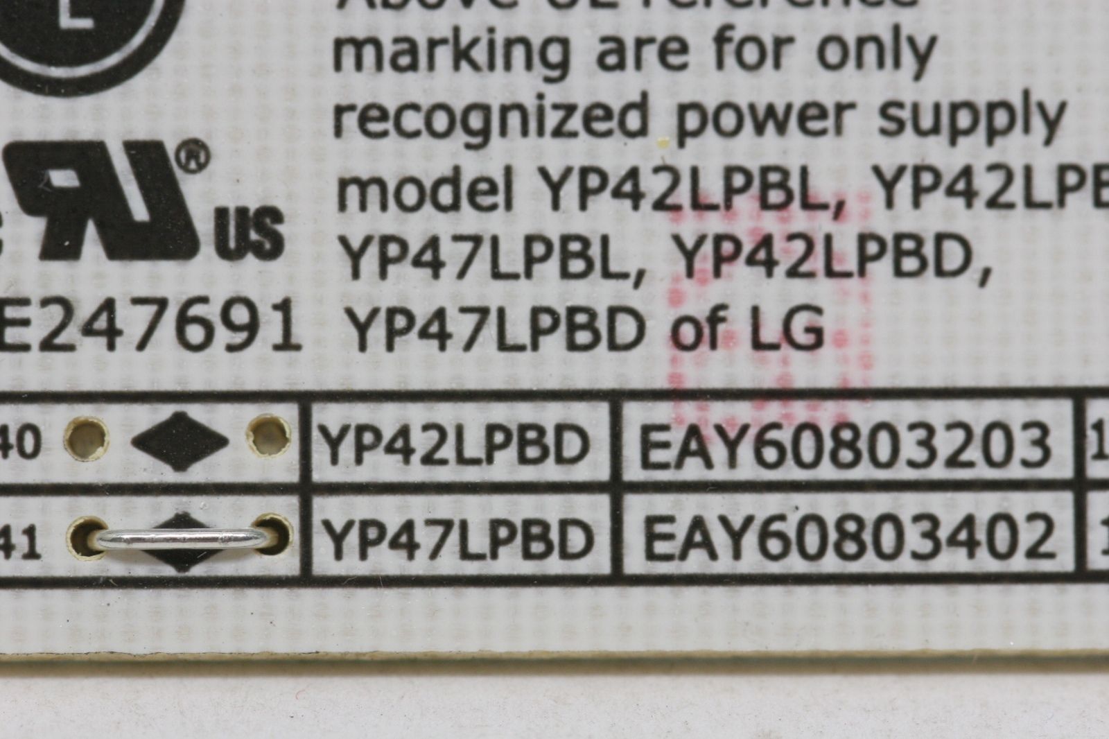

      is this your power supply-LED drivers?
      http://www.shopjimmy.com/lg-eay60803...upply-unit.htm
      There are many LED strings in this TV, you will have to test the Voltage on each string to see what have and go from there.

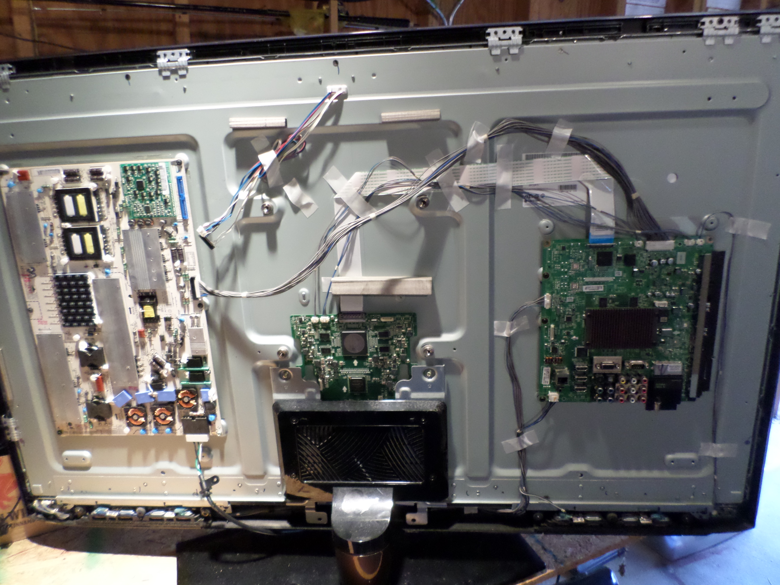

                  Well in my post 3 I asked for the verification if the link I gave has the correct pictures of your board or not (LG EAY60803402 (YP47LPBD) Power Supply / LED Board: http://www.shopjimmy.com/lg-eay60803...upply-unit.htm), at this point I have no idea which board you have.
                  We also need the pictures of the whole back side of the TV so we can see the board, and the whole pictures of your power supply-LED drivers board, and the closed up pictures of the LED connectors.
                  Right now I have no idea what the 115V input wires and the 13V are.

                    YES-The one on shop jimmy is the one-EAY60803402 . I will try to take pictures tomorrow--THANKS

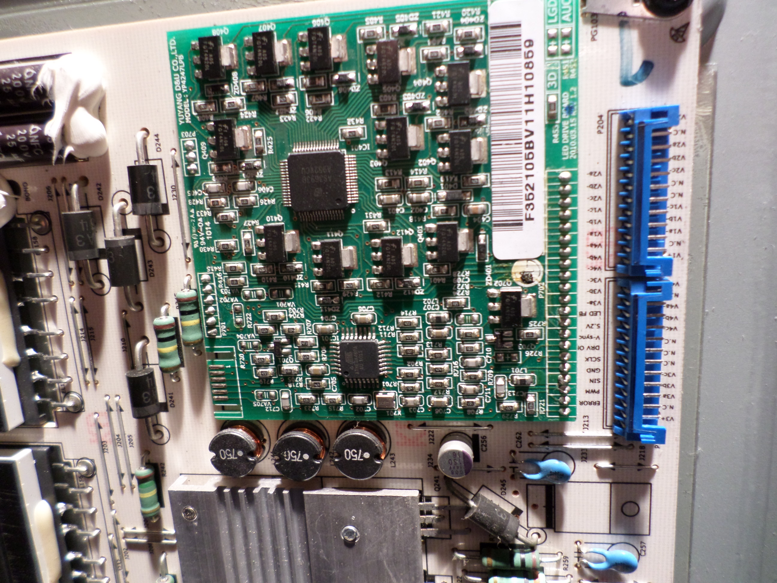

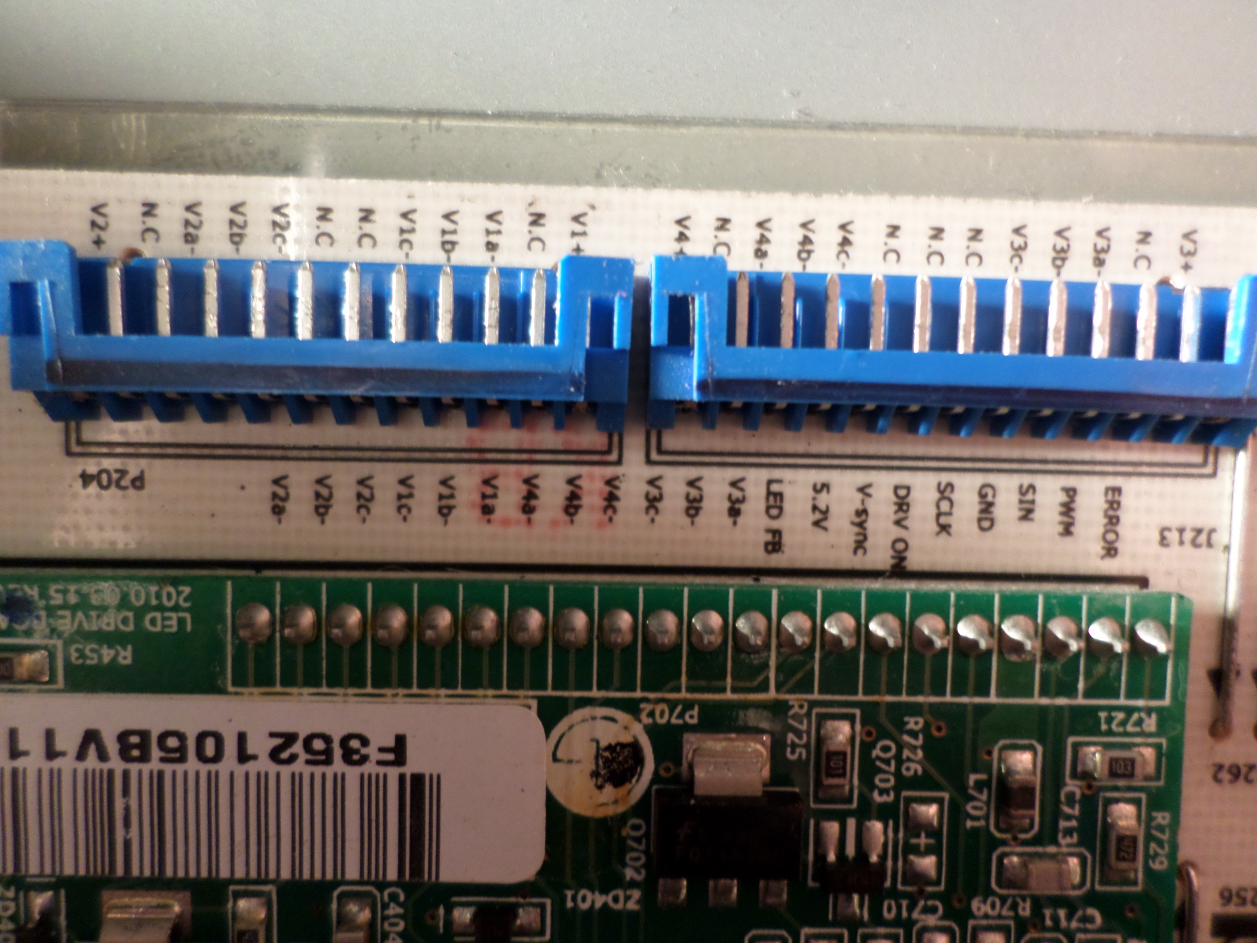

                        I also need good clear pictures around the LED driver board connectors so I can read the labels for each pin.
                        This LG has this feature called LED Plus Technology:
                        From LG: LED Plus Technology
                        Tired of dark scenes or dull colors? LG's LED Plus technology provides even greater control of brightness through local dimming to deliver amazing clarity and color detail, as well as a more energy efficient TV compared to conventional TVs.
                        It has more than TWO LED strings, as you can see on the sub board, there are many PWM Controlled power MOSFETs for a bunch of LED strings to achieve local dimmimg.

                          Heres pictures-First time trying. Hope they turn out ok

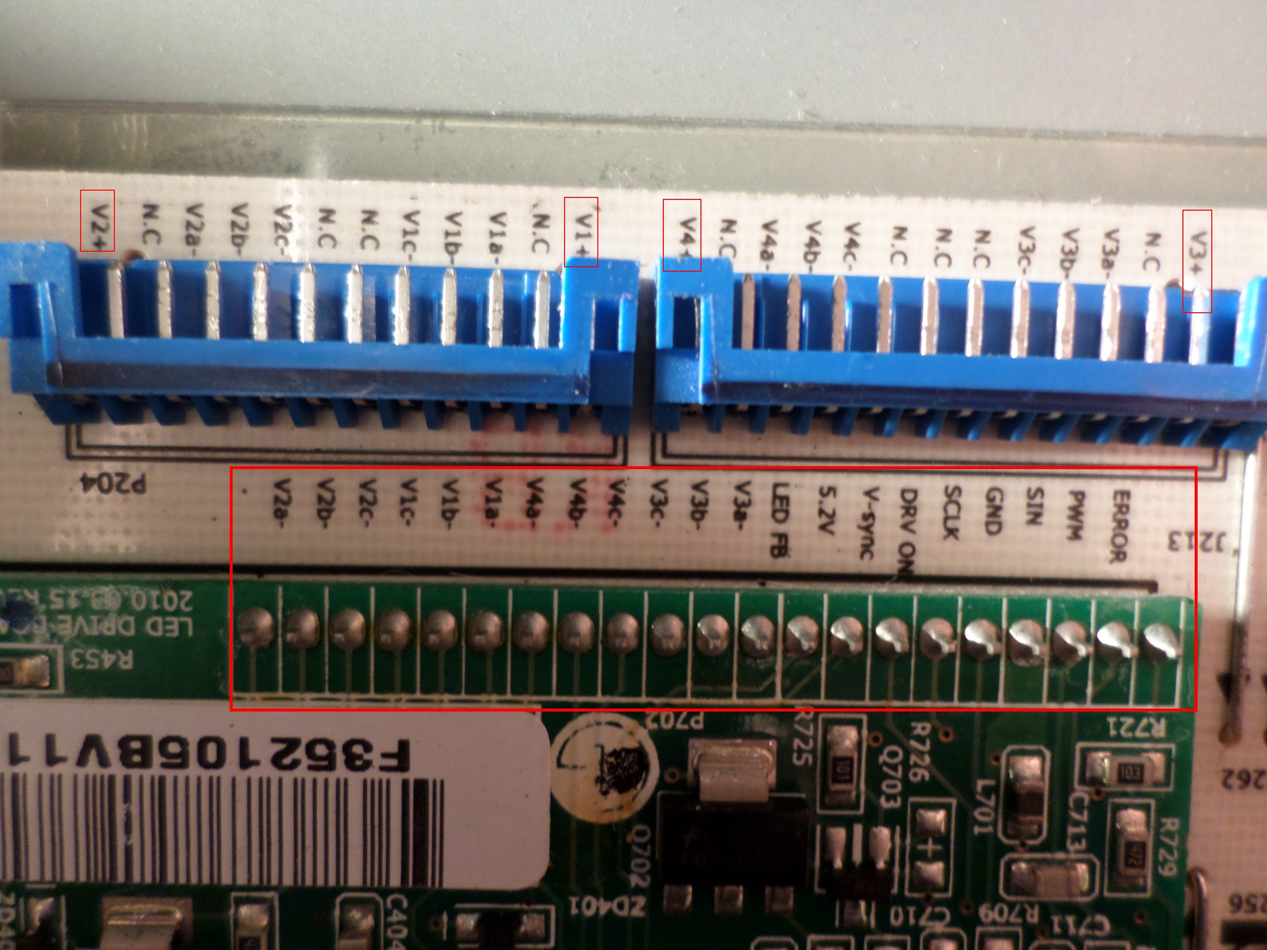

                            Re: 47 inch lg model 47lx6500 blacks out
                            So it has 12 LED strings (1A/B/C, 2A/B/C, 3A/B/C, 4A/B/C), V1+, V2+, V3+ and V4+ are for feeding boosted Voltage to the Anode of each LED strings
                            You need to take the readings of all those pins as marked by red boxes and the pins V1+, V2+, V3+ and V4+.
                            You need to have the red probe of the meter on each of the V+ one at a time before turning on the TV to see if the Voltage jumps up to over 100VDC and drops down a few second later or not, black probe on the chassis.

                              YES- They are wired together and they all jump to around 135 vdc and jumps little higher and lower and then settles down to 115 vdc and holds steady. Its the same with backlights plugged in or out. There is a power diode that goes from 115 steady voltage to backlight ckt' and it is steady at all times. A couple of filter cap are there but they are good. There is a ckt. that goes from pos. side and think it might be shut down ckt. Don't know for sure. A schematic would be a big help. Any thoughts?
