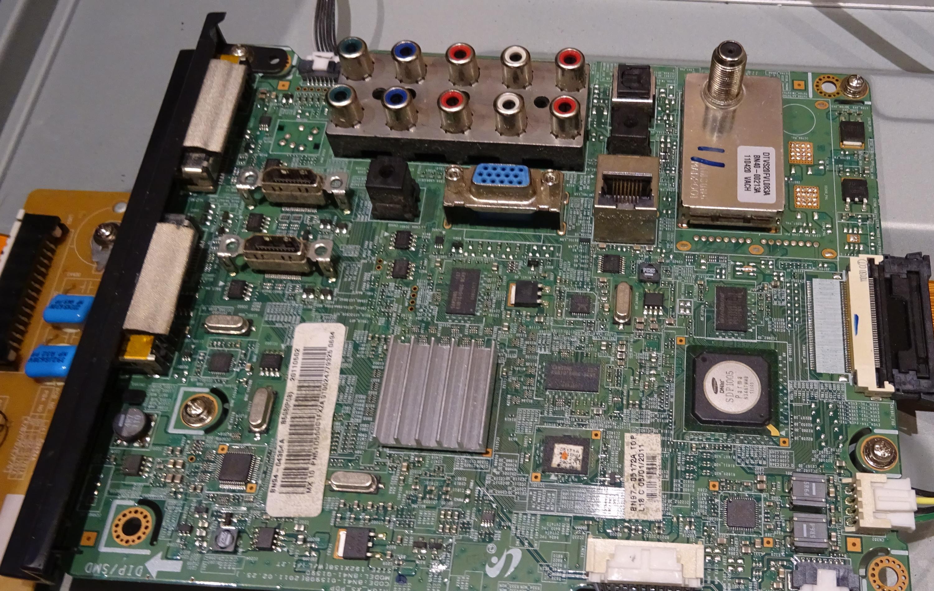

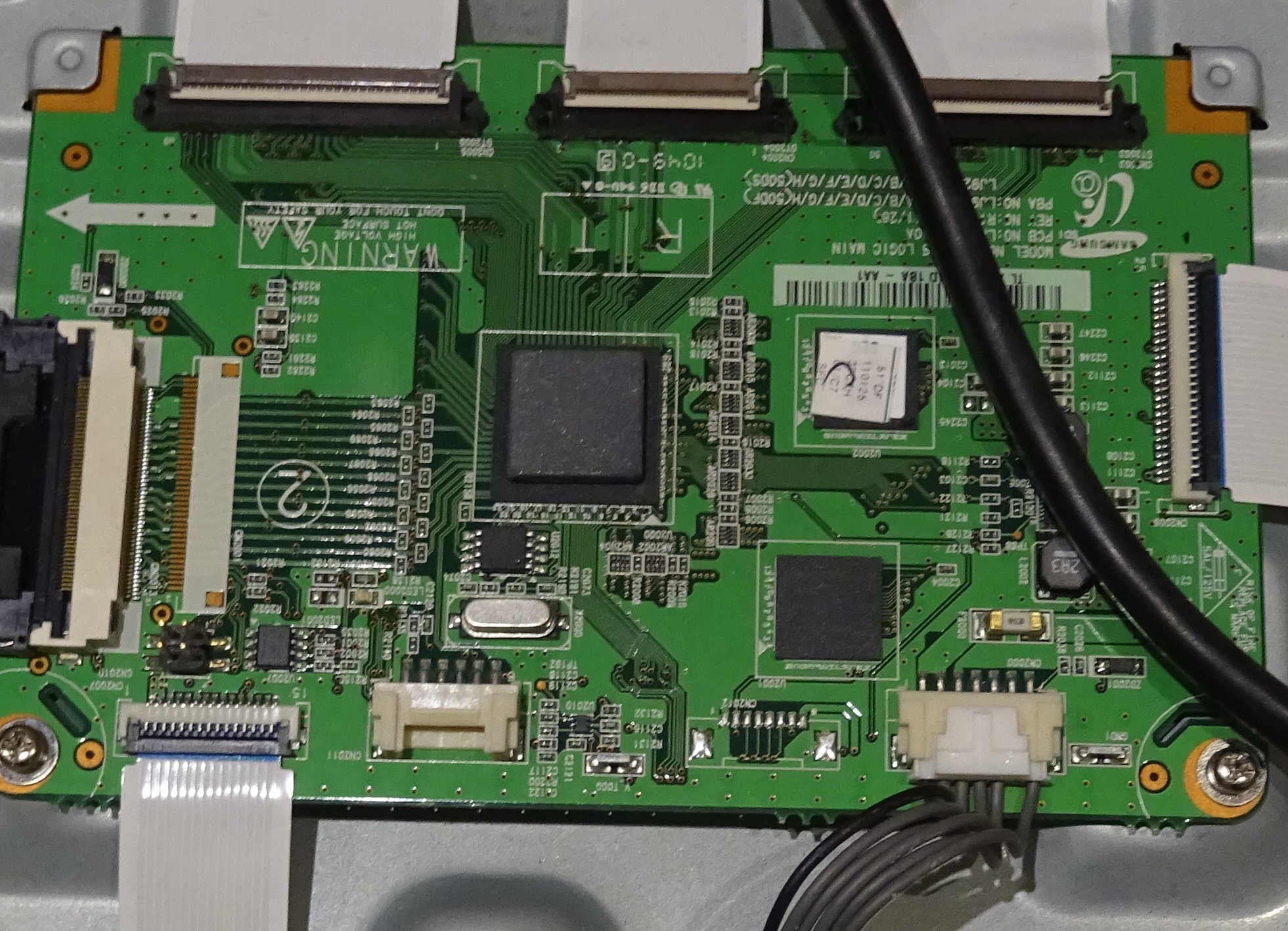

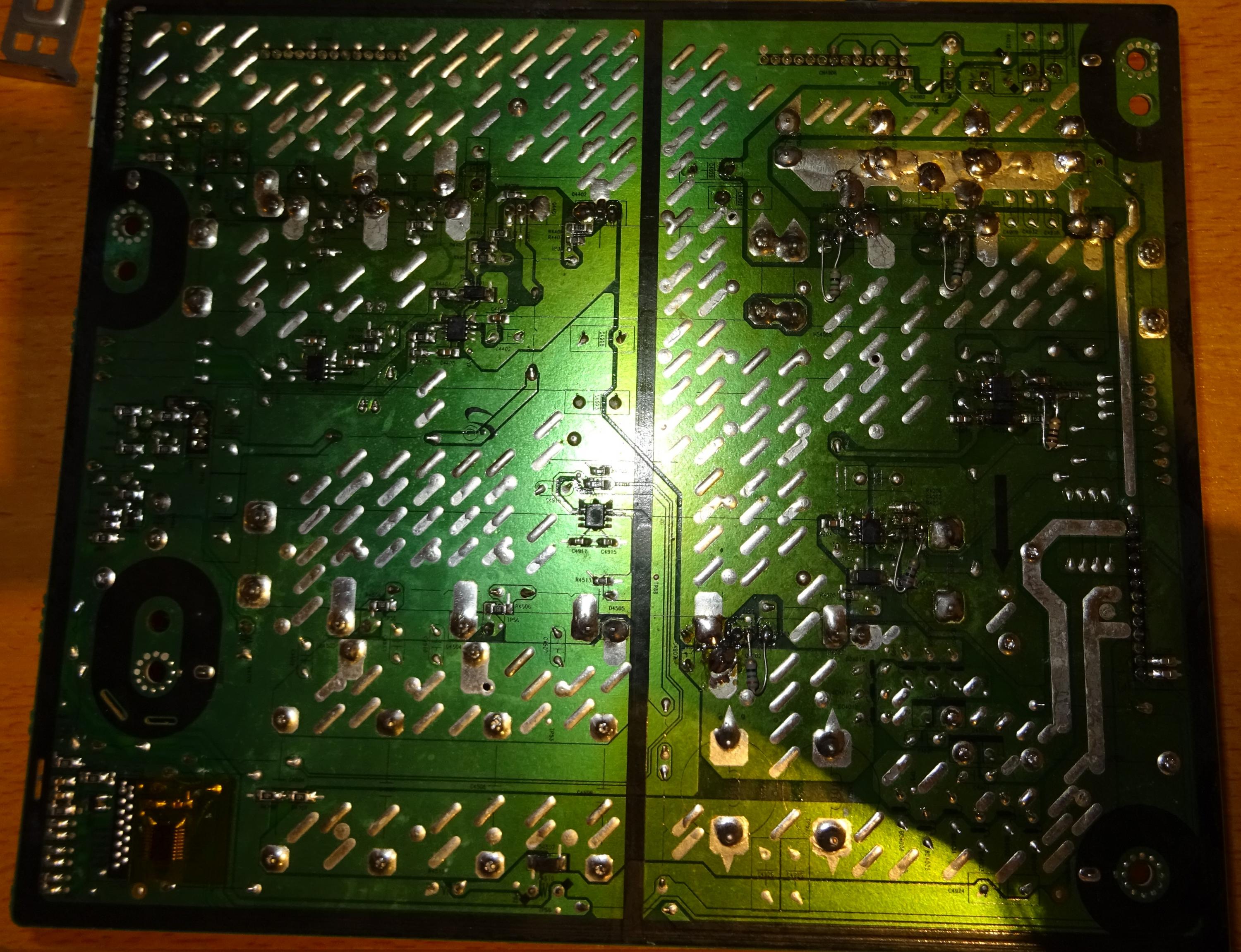

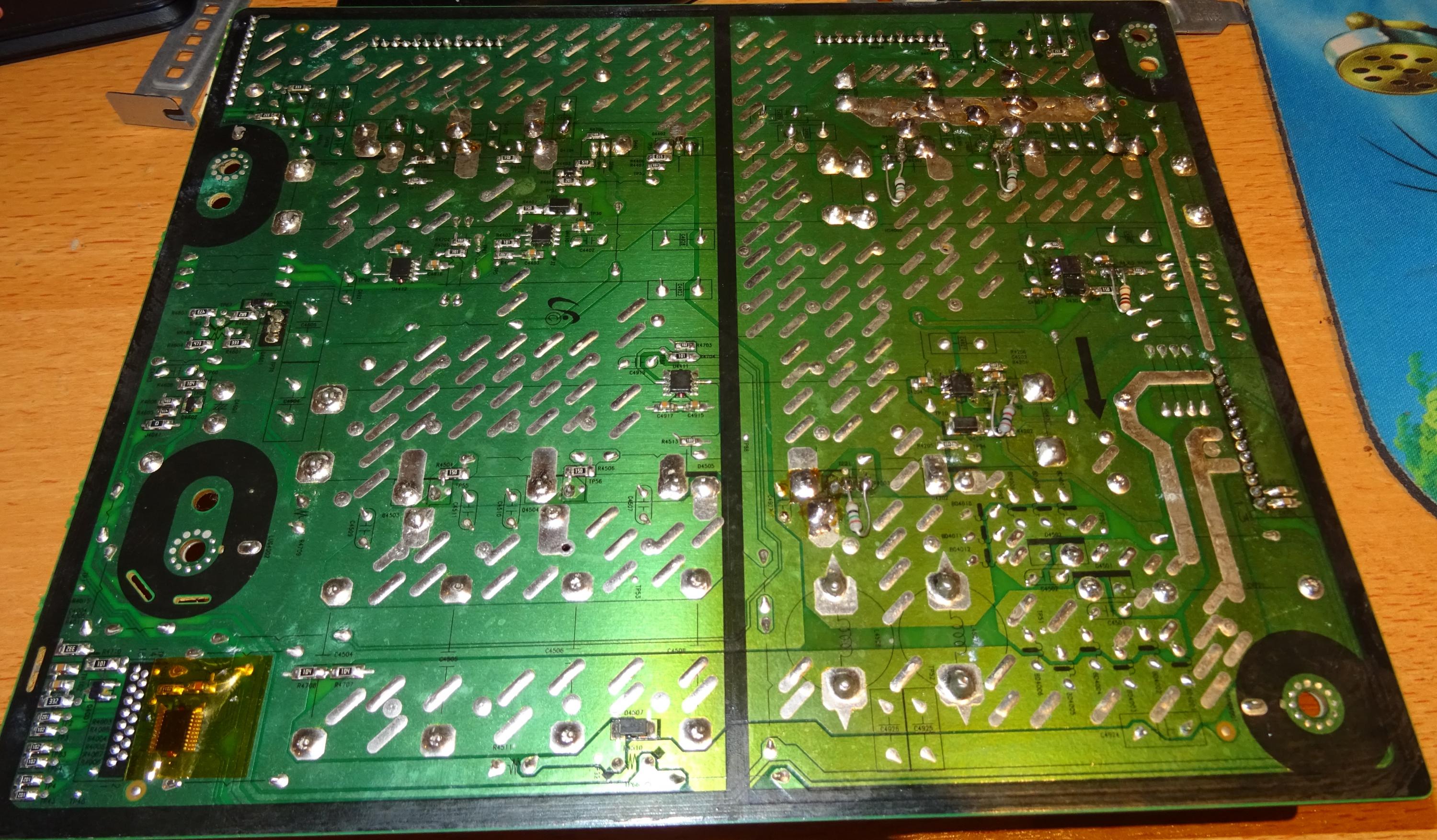

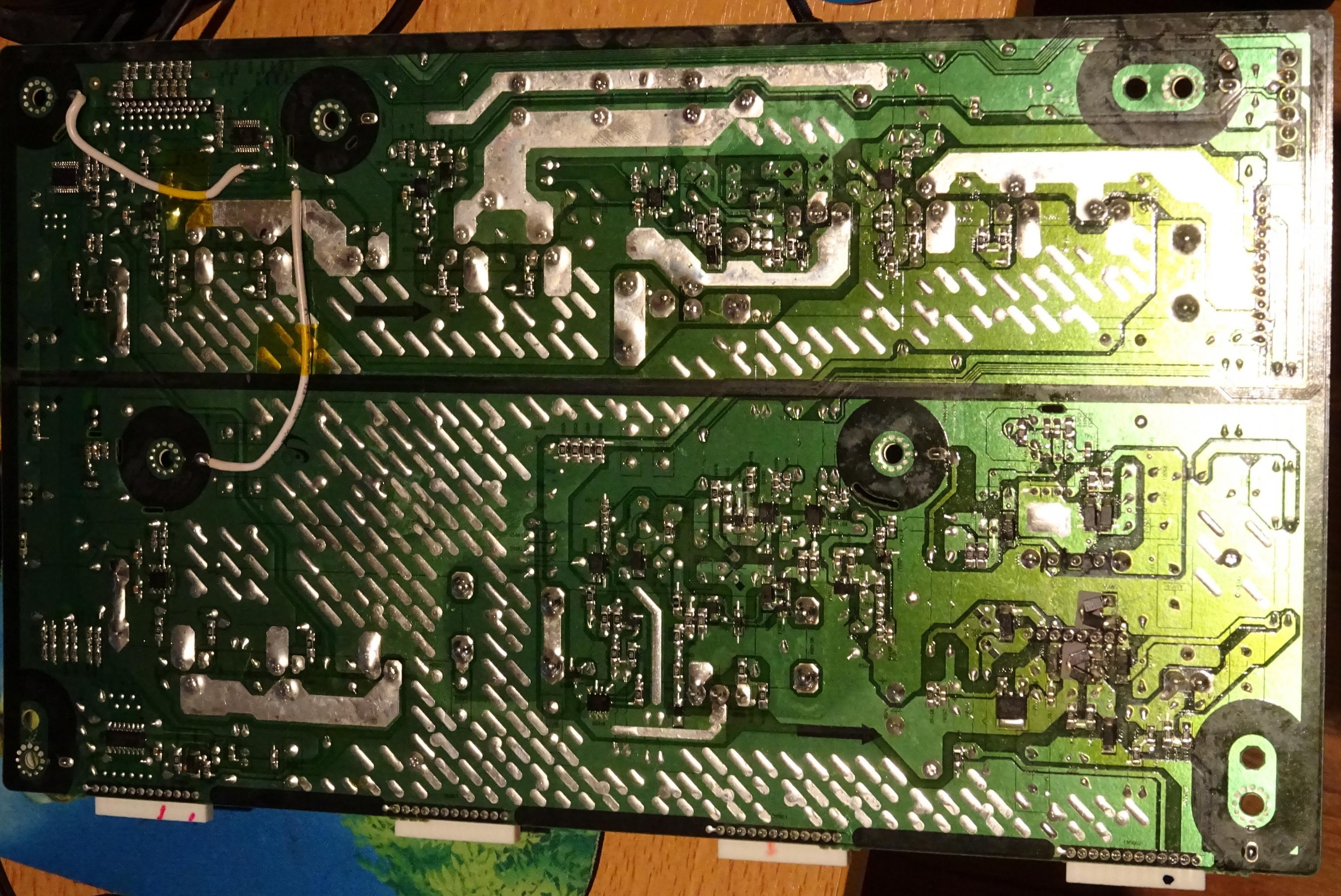

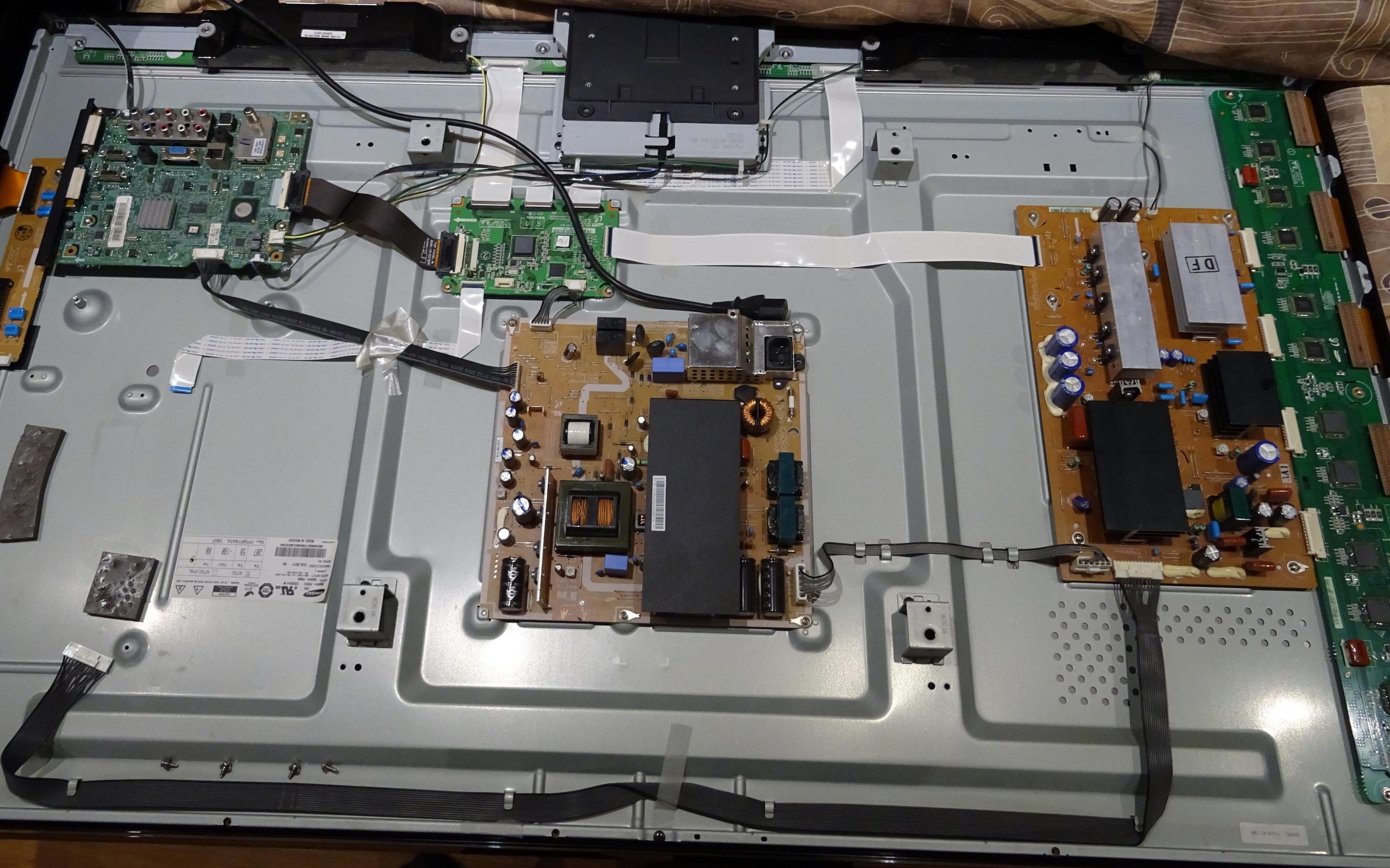

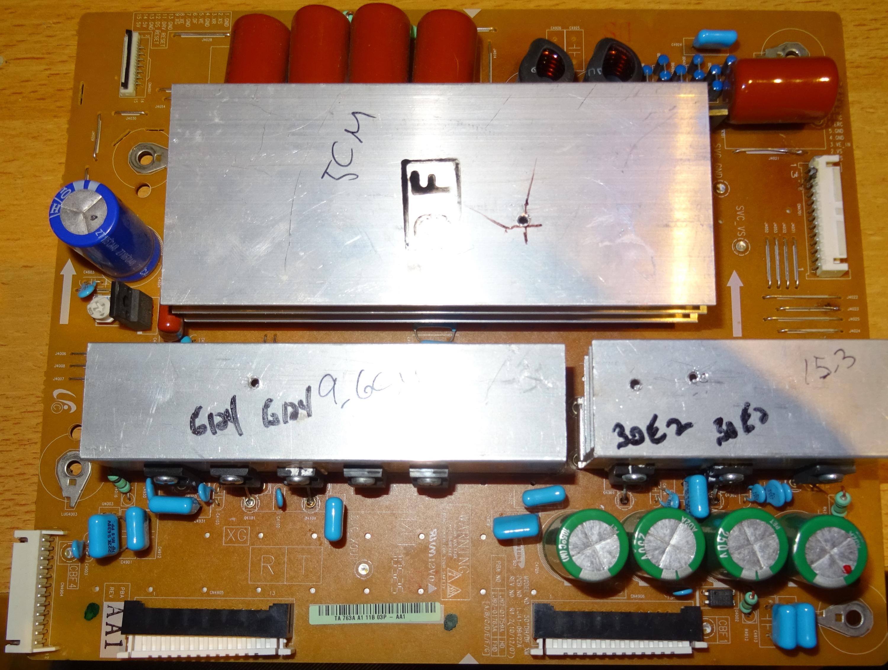

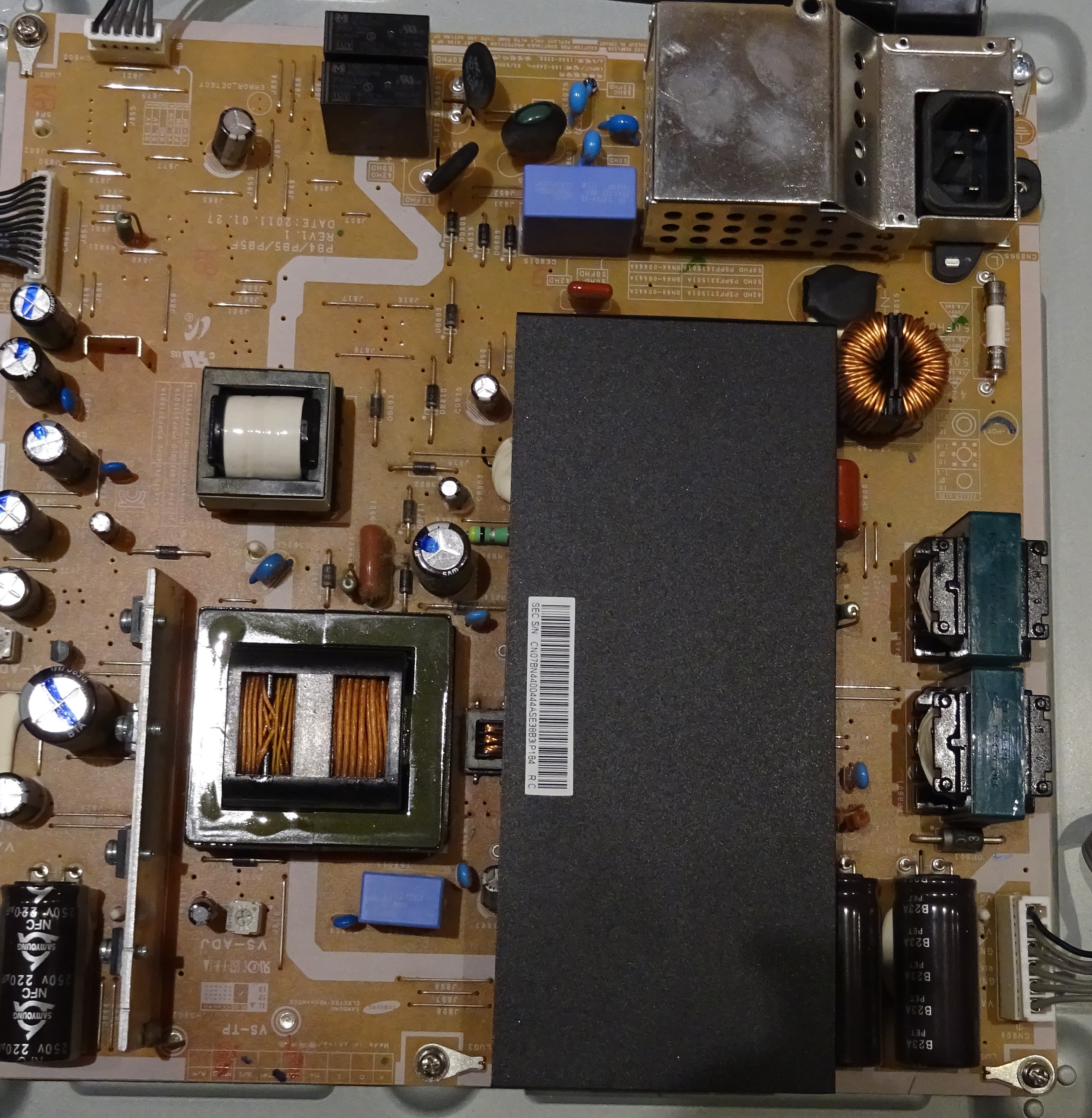

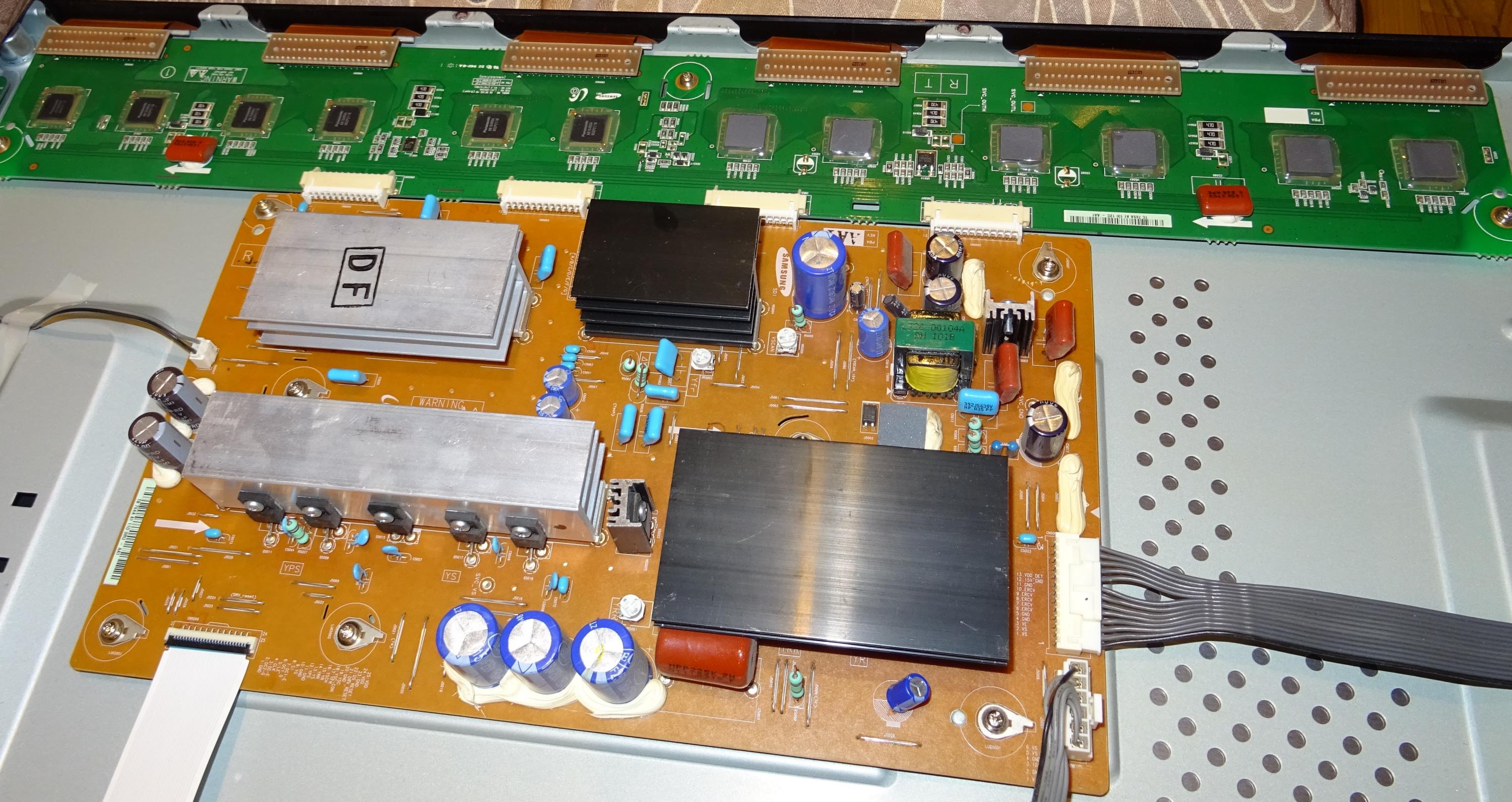

    Hello, i just got this tv and i found out it has alredy been repair. They repaired the x-main but the last owner told me that the repair lasted 15 minutes then 4 hours in a secound repair.
    is it possible that a bad y-main will kill the x-main?? What i want to do is to buy a new x-main and test it but dont want to toast it.
    If i disconnect the main-x the tv will turn on (no red light) but im not able to turn it off.
    If i disconnect the fcc cable from the main-y boad now im able to turn it on and off normal.
    here are some pictures.

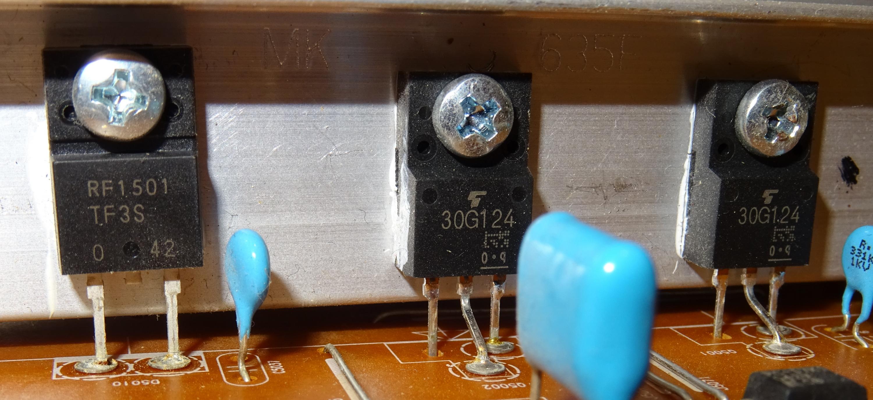

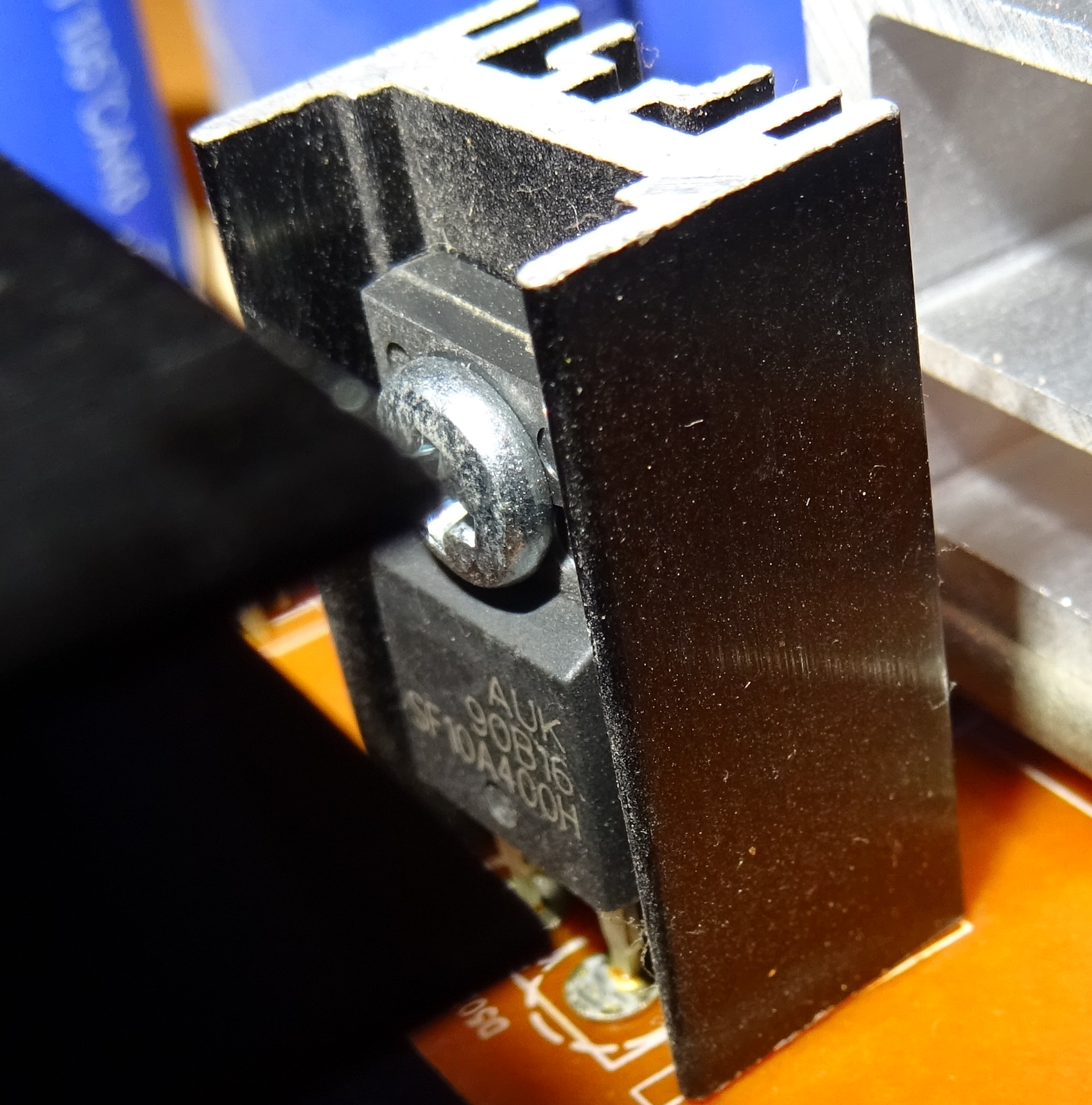

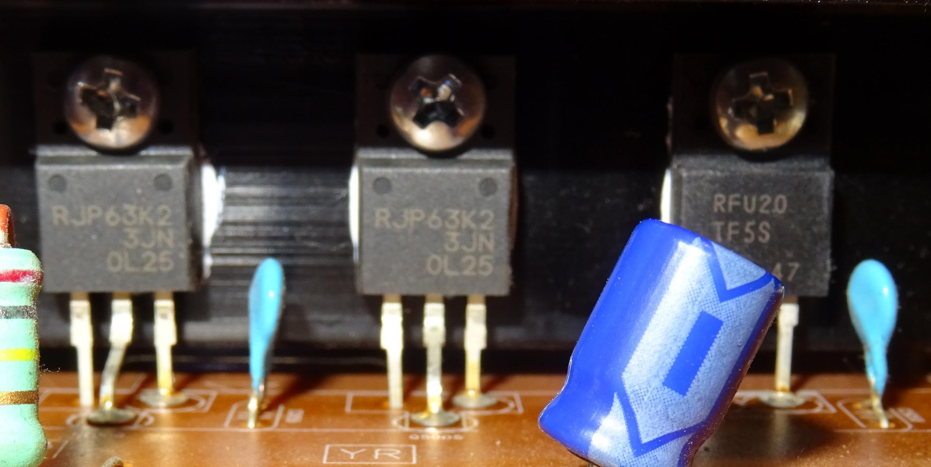

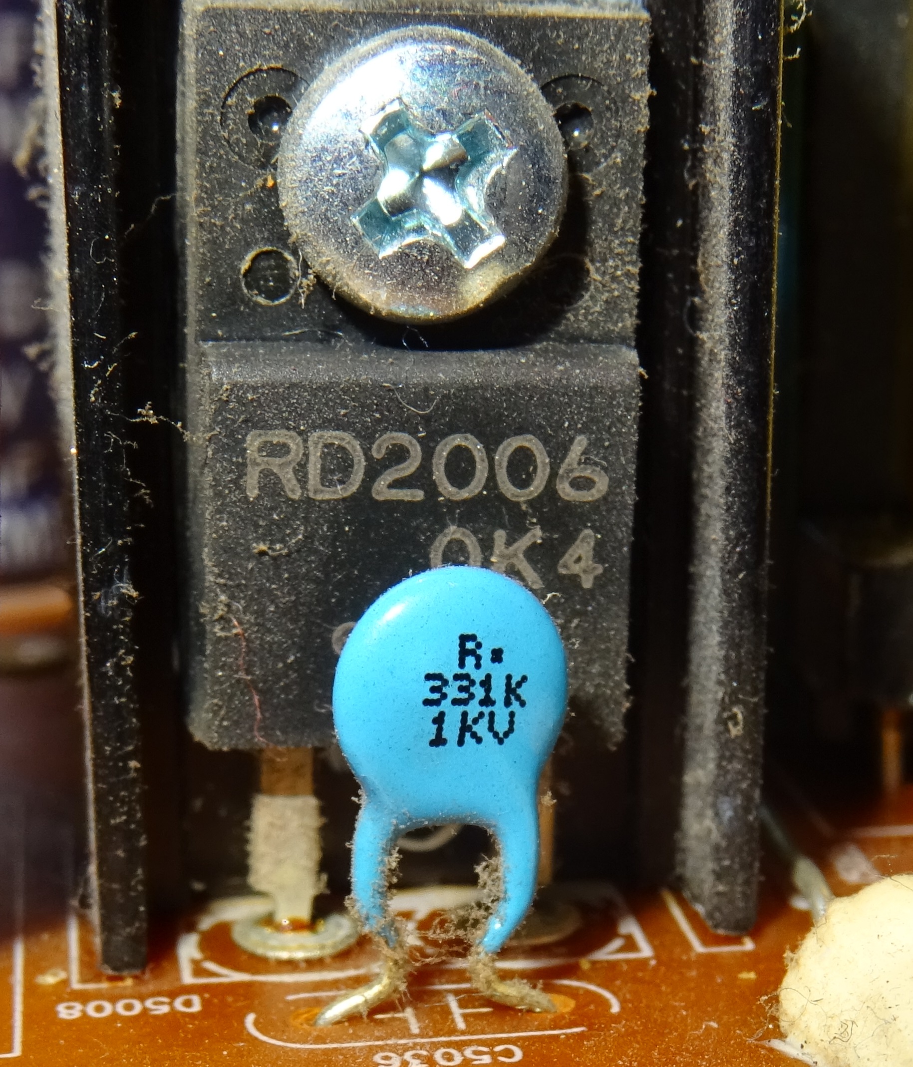

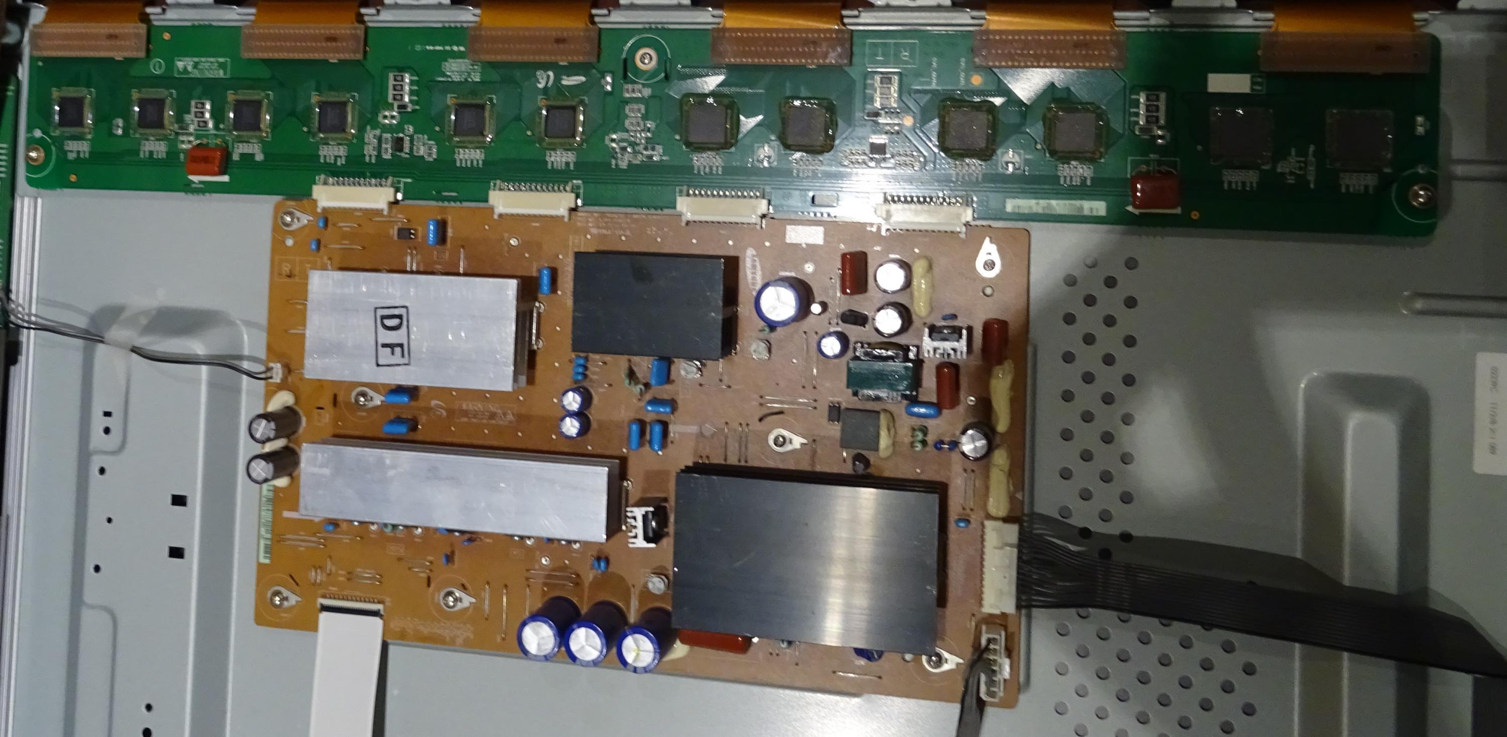

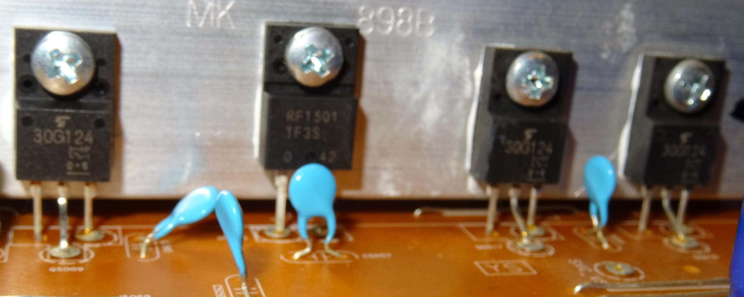

                    Can you help me ifdentify those mosfet and transistor you talk about?? here are some hi res picture of all chip i think you talk about. I dont know how to test.
                    Thank you.

                      Re: Samsung PN51D550C1F Clicking and flashing power led
                      Each buffer board should have three mosfets on it..if any of them are shorted all of them will be..most likely took out a few components on Ysus. Good clear pictures of the boards in your set will help.

                        That's weird, I would say something is intermittent. If there was a shorted fet on Ybuffer or Ymain it would have blown up instantly not 15mins or 4 hours later. Have you checked for cold solder joints on the Ymain ?
                          Does not apply to this model, only to older LGs. Samsung do not use FETs on their buffers, they are on the Y-main instead.
