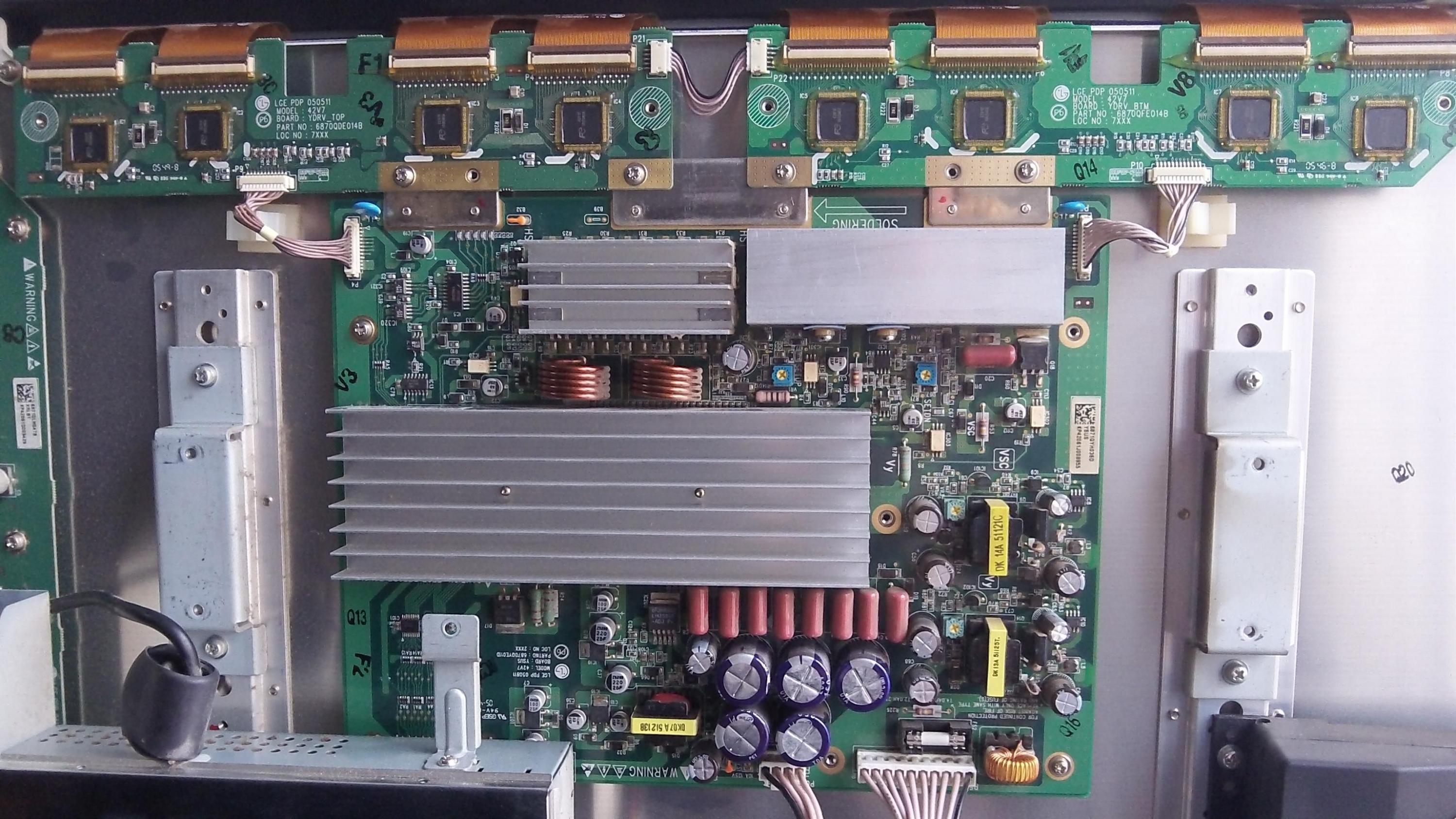

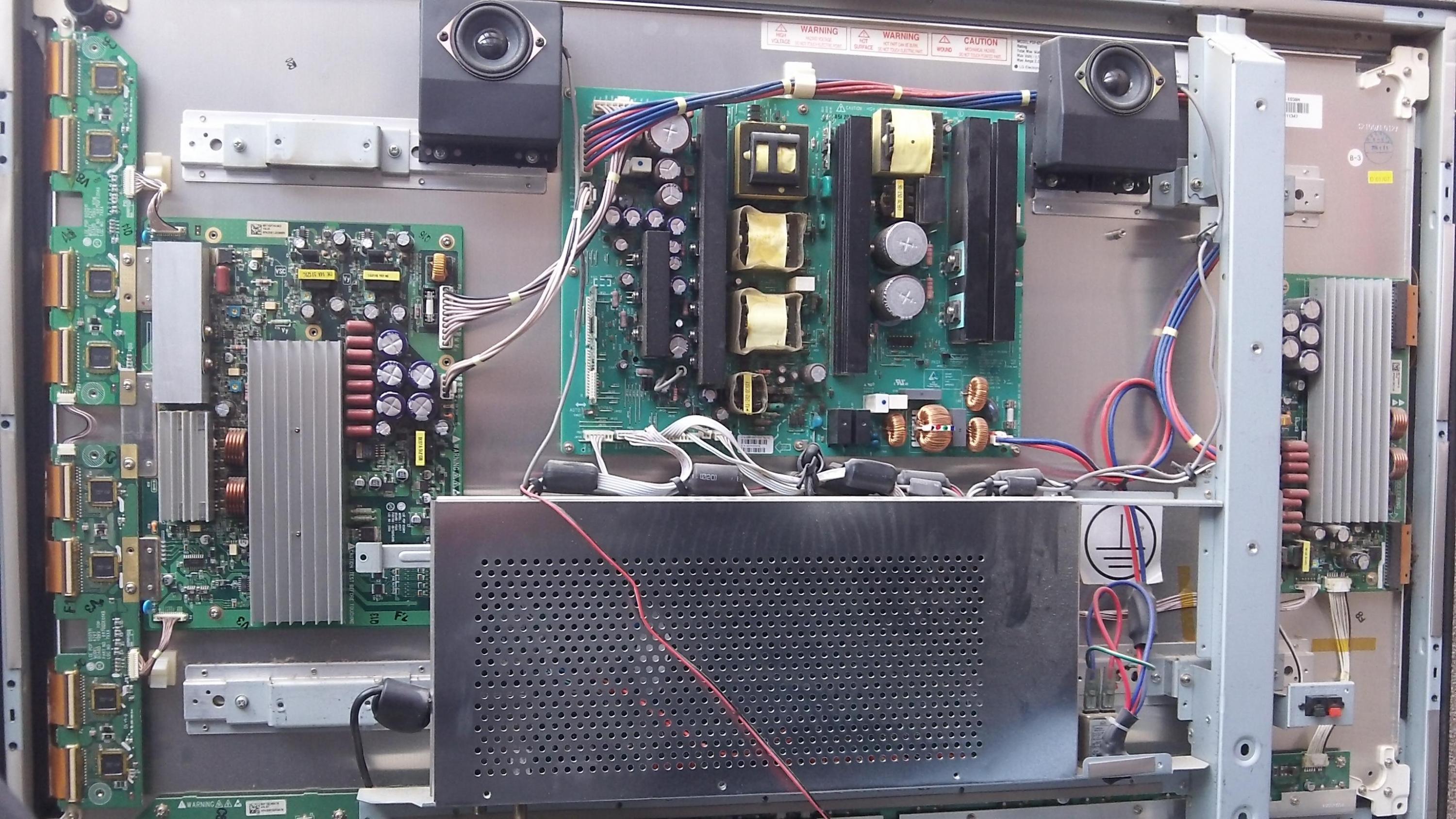

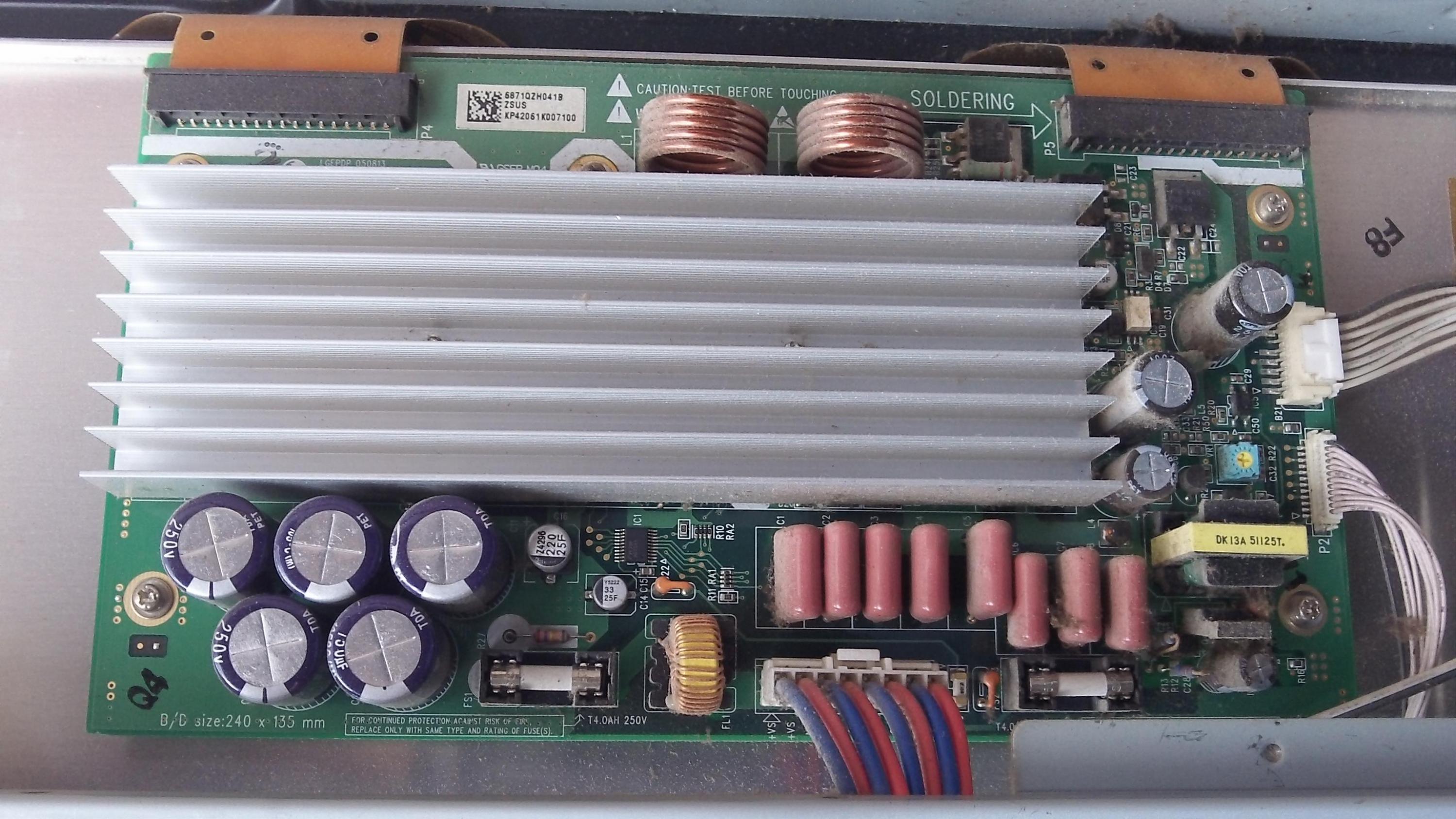

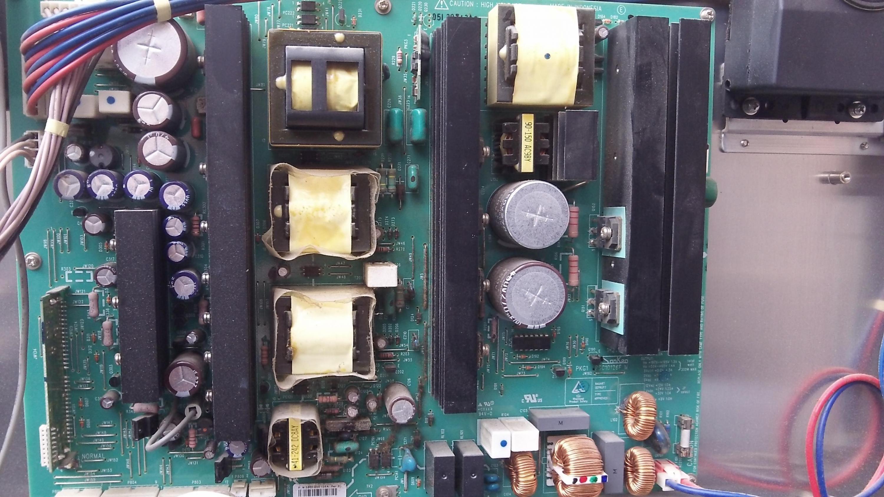

        Re: ILO PDP4210ea1 unstable Buffer Voltage from Ysus

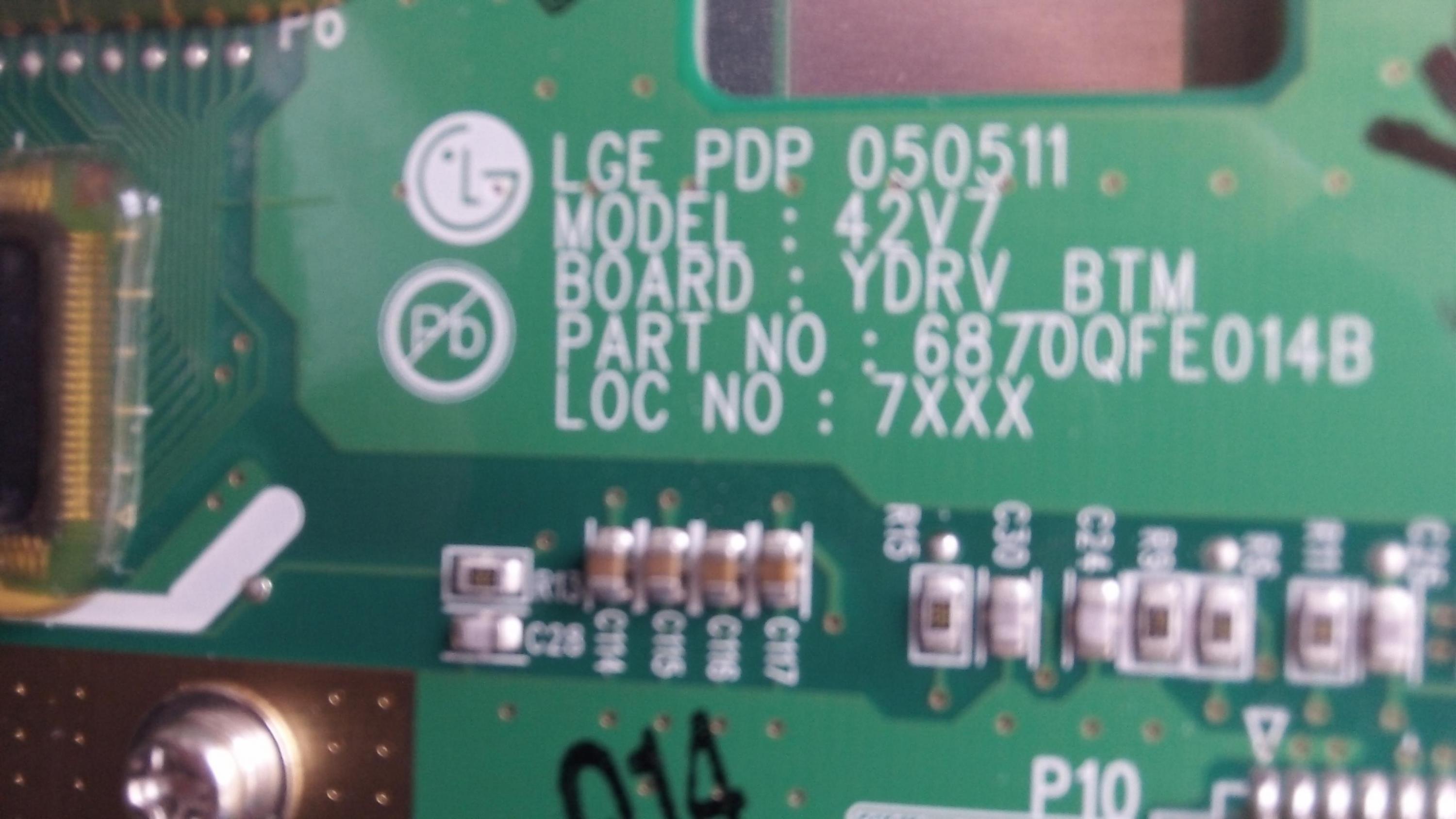

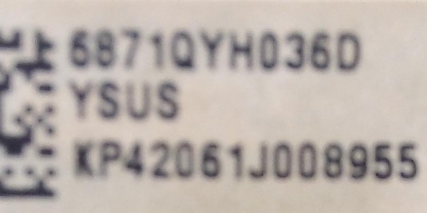

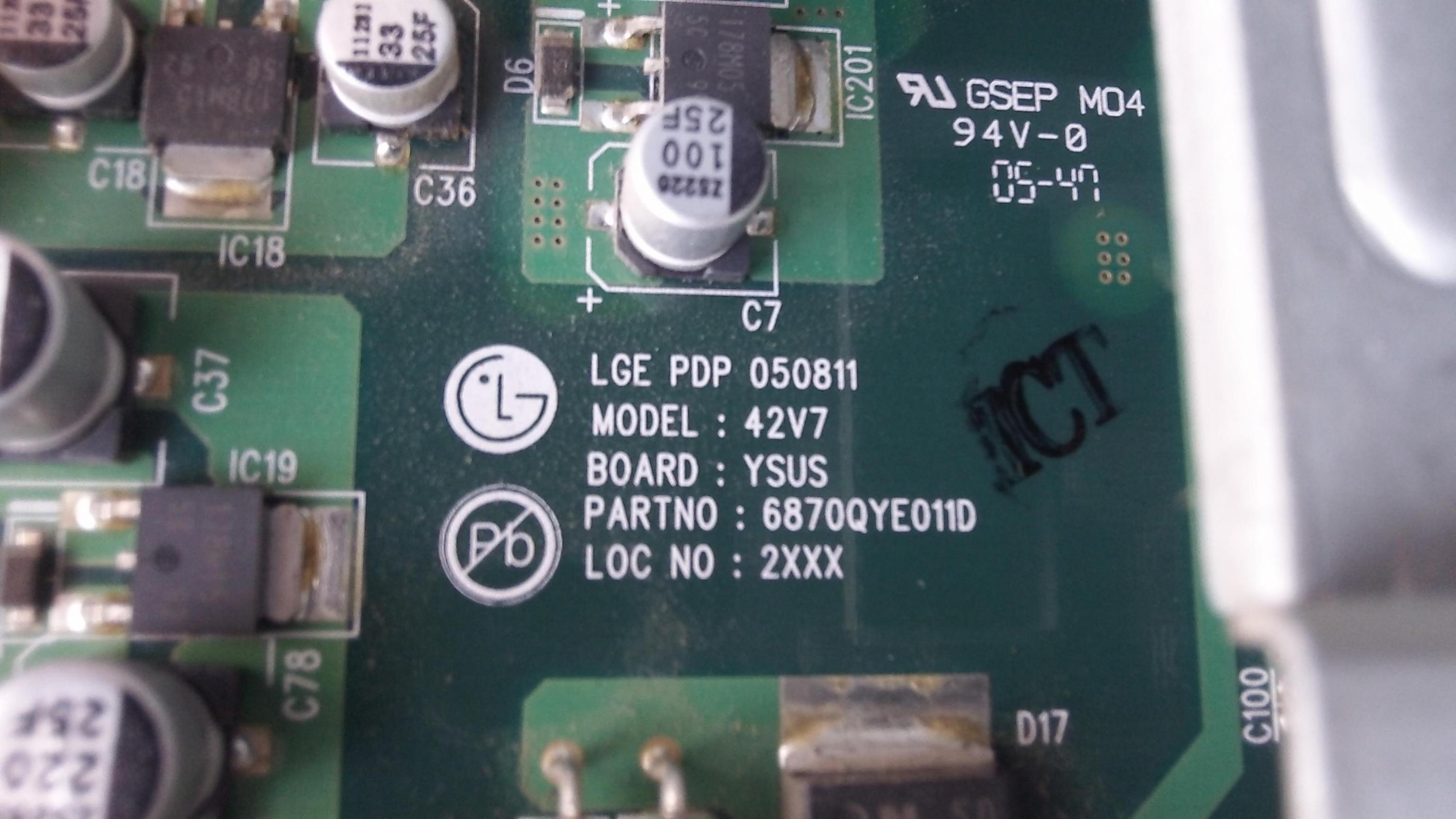

        Pictures of inside of TV. Inside is similar to other TV that uses the same LG panel.
          I'll bet one of the IPM's is open....
          --Prob the Y-SUS one, seeing there's nothing on screen.....

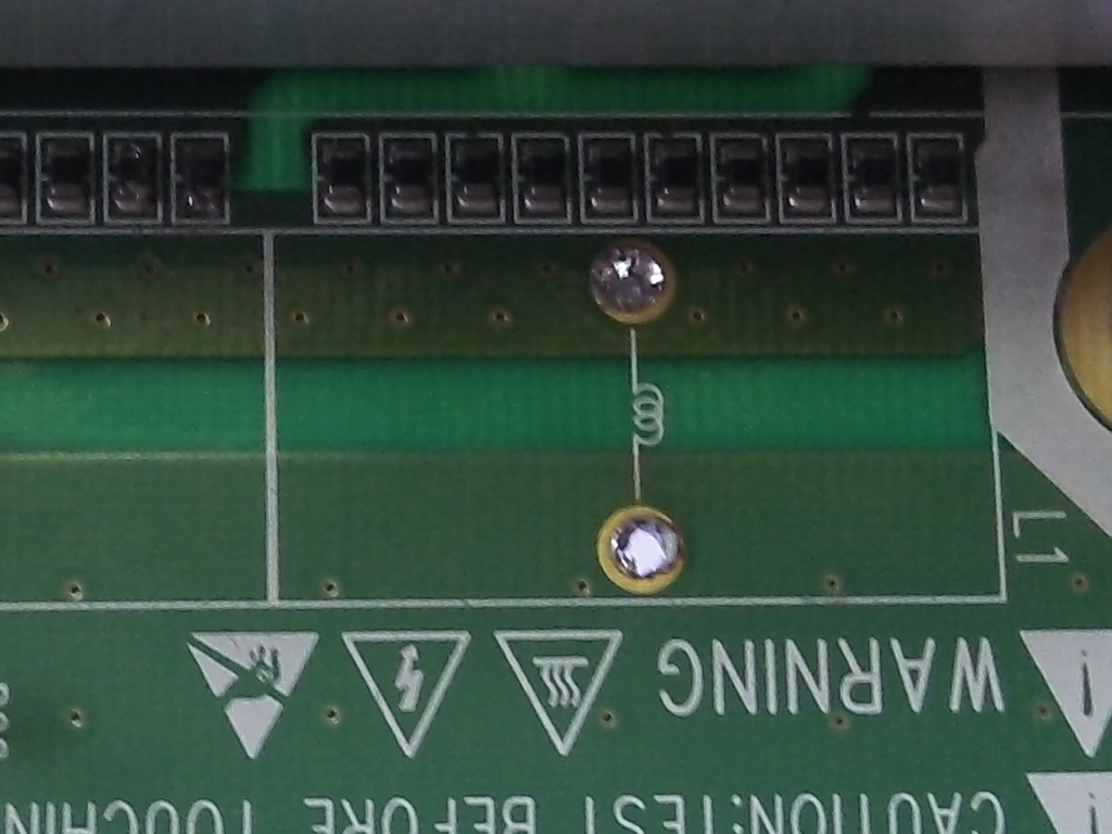

                                  OK, found something that measured short! The Parallel row of MLCC Caps are measuring 0 ohms. So I will try to shake this frustration, maybe it just may be the Z-SUS the only one board I didn't change!
                                  The Capacitors are coupling the AC output from the output of the IPM to the output coils right? So there should be no short across them right? I wonder why I hear the board buzzing as if it is working? The IPM seems to measure fine with no shorts..............but if I measure from ER_UP_OUT OR ER_DN_OUT to the output of the Z-SUS board, I get a 0 ohm reading.
                                    I just removed the output inductor coils to ensure the IPM isn't shorted!
                                    The capacitors are shorted for sure!
                                    Does anyone know the value of the capacitance of these MLCC caps? I want to replace them with POLY caps of the same rating. I have a BUNCH of 3.3uf and 1uf poly HV caps from plasma TV that should work. If not, I'll just replace them with like parts.
                                      Here is a photo of the failed rows of MLCC capacitors...............
                                      There are actually 20 of these caps (10 per output) but I had to crop the pic to fit the forum size using a photo editing program in Linux I am still getting used to.
                                      Sorry about part of the pic being cut off
