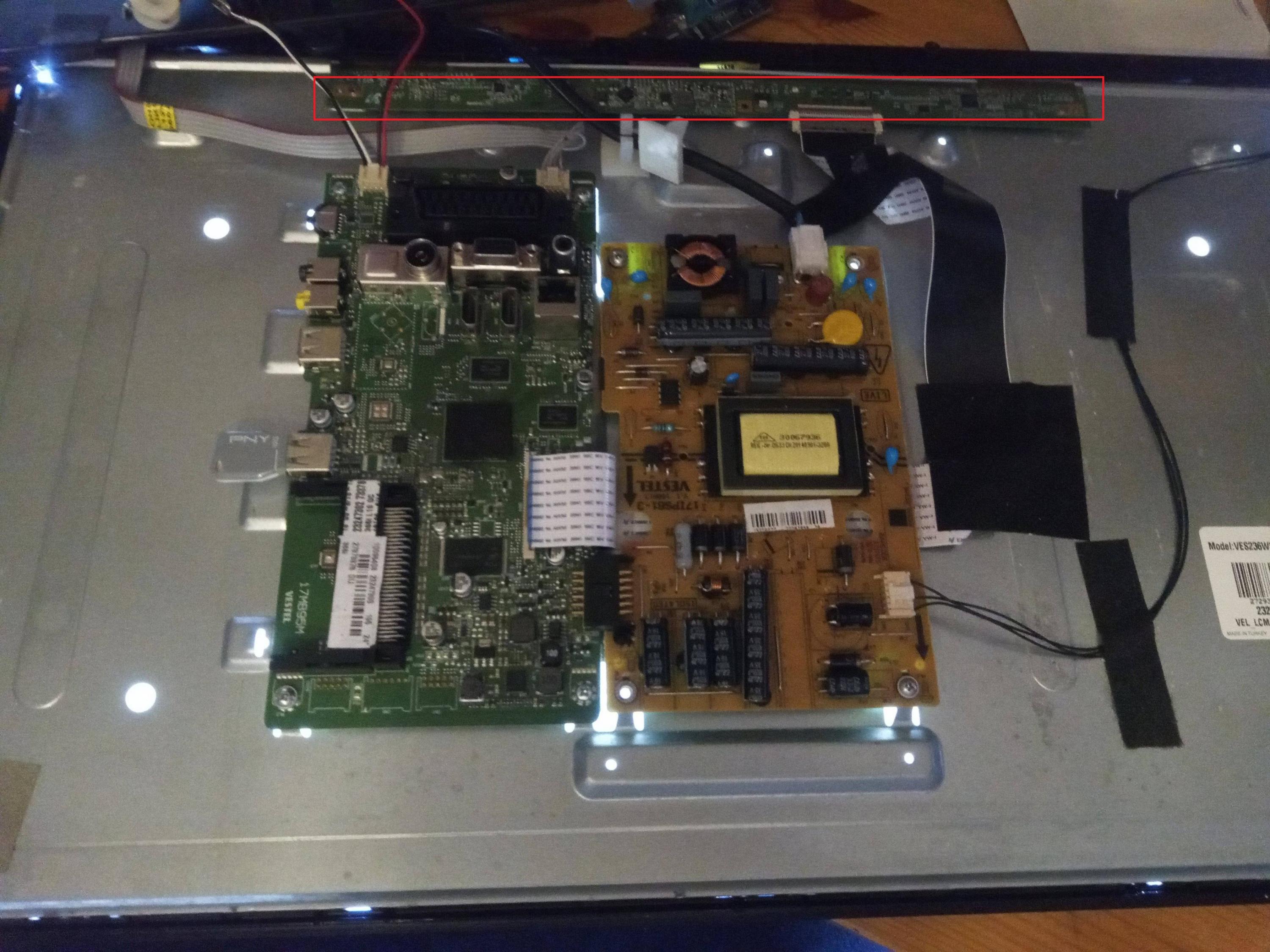

                Can you take a picture with the back of the TV? Without cover.
                • Magio
                  • Dec 2019
                  • 14
                  #48
                  Re: VESTEL FIRMWARE: Toshiba 32W1333B
                  Sure, there we go:
                  That's what's the T-Con says. innolux mv-0s94v-0E88441

                    T-con is part of the panel. Near the connector is a fuse. See if it's good and you have 12v (or 5v) on both ends.

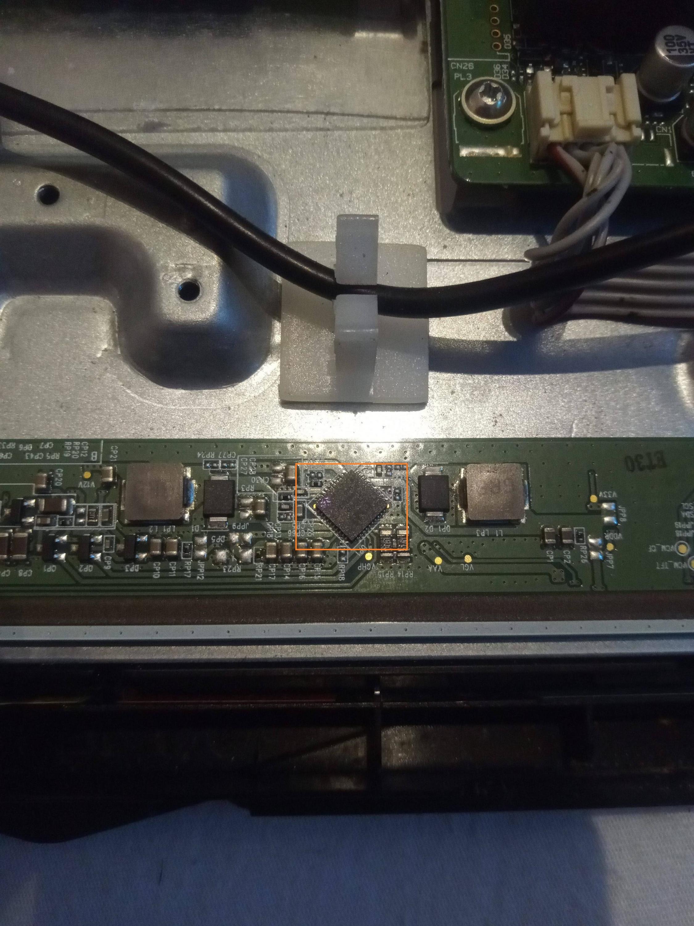

                                    This means that the integrated dc-dc converter is defective. If you can take a close up picture I'll tell you what it is. But I don't think you have the tools to replace it. The t-cone being glued to the panel does not pose the problem of its replacement.
                                    • Magio
                                      • Dec 2019
                                      • 14
                                      #58
                                      which tools would I need, I got a hot air gun somewhere and to be honest, can't make it any worse anyway Let me take some close up pictures first.
                                      There we go:
                                      • yokoono
                                        • Apr 2010
                                        • 515
                                        #59
                                        This is the dc-dc converter that I think is faulty. After it is detached, measure between VGL and VGH. If it is shorter it means that the fault is in the panel.
