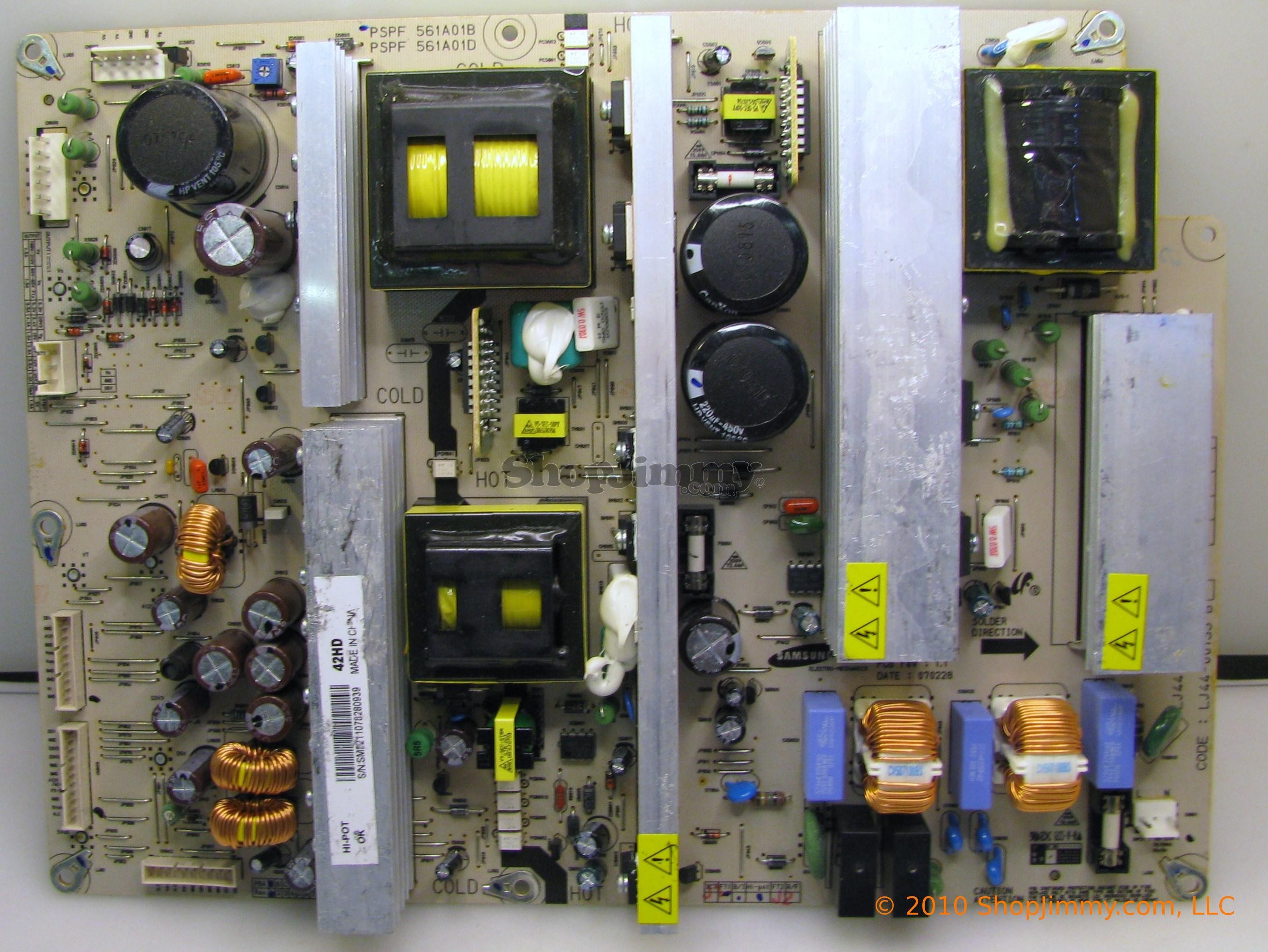

    This Plasma TV has 8.24v, Vs and 14.97v, Vcc going to the Y and X sustain boards from a Samsung LJ44-133A P/S Its supposed to be 97v and 205v I think? I cant find anything wrong with the P/S,Ive checked the electro capacitors with a capacitance meter and checked all the semiconductors for shorts,burn marks and anything out of the ordinary,then re-flowed all the dodgy solder joints,etc.. All the boards inside are Samsung except for the input board its SmartVisionTech.Ive never tried to fix one of these plasma TVs before so any advice/suggestions are welcome.

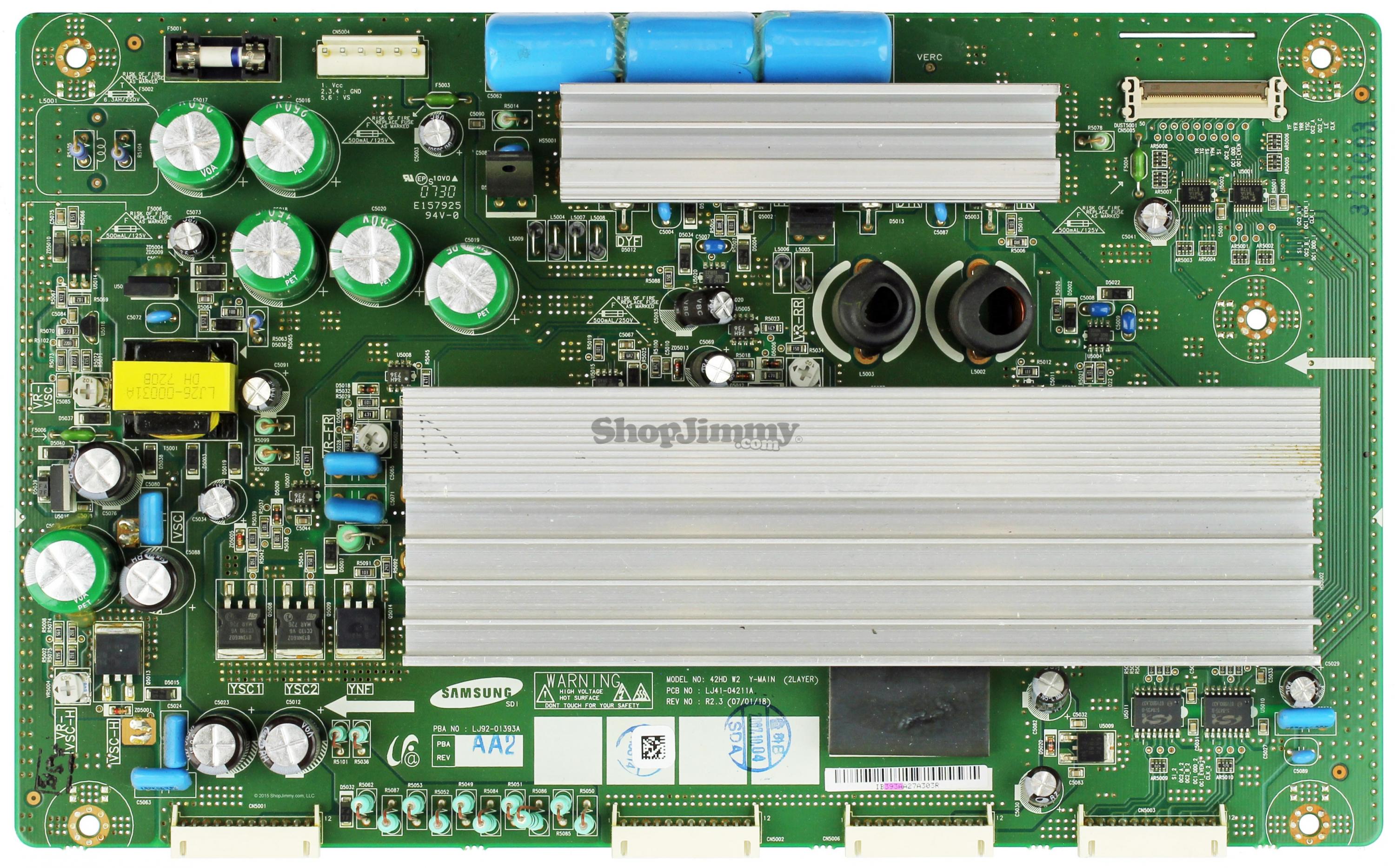

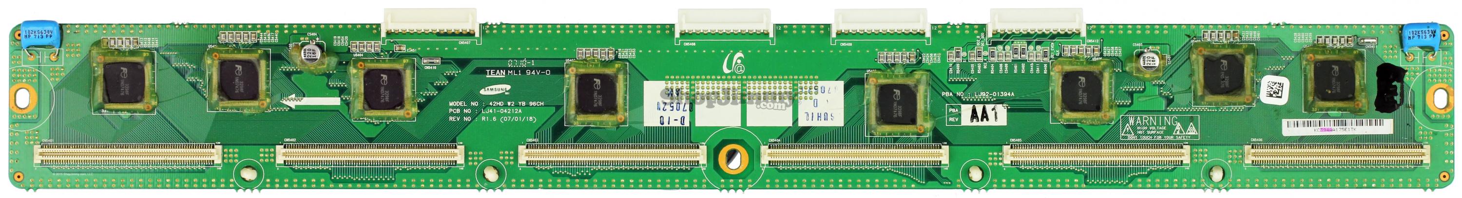

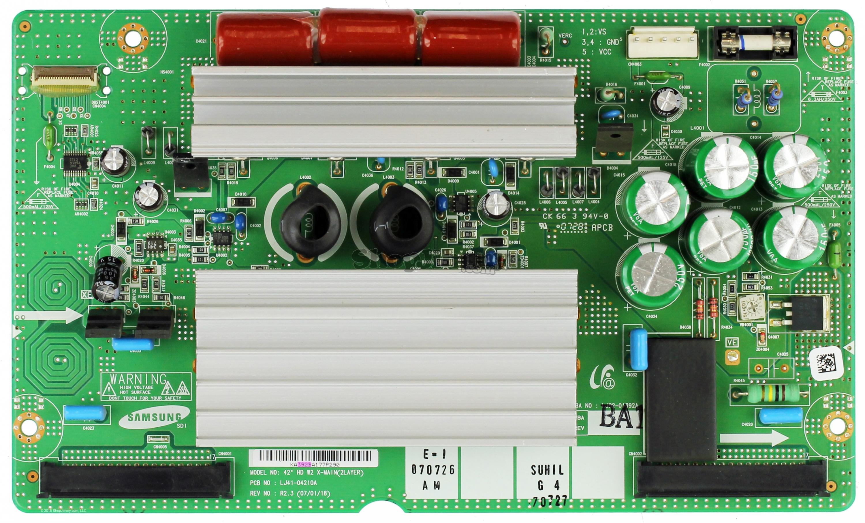

    I think you may mean LJ44-00133A for the PSU. Not a bad idea to put some pics of the boards too for anyone who may recognise them as depending on what part of the globe you're from a Celestial won't mean much but the panel and boards will for common faults.
    always a chance it's in protection, maybe blown buffer ICs on the ybuffer or shorted FETs on the Ymain, checked those ?
    here's some shots to see if these are close for the boards.
    Did you reflow the large FETs that generate Va & Vs? Checked the fuses?
    What's the green LED on the ctrl logic board doing? Is it blinking every sec or once every few seconds?

      They are all the same boards except for the Y sustain board,its similar though.Ive checked all the fuses including the little green ones,I haven't re-flowed the large FETS yet but I will in a minute. I cant see the little green LED light because its hidden away under the main input board! I just remembered Ive got a dentists mirror so Ill have a look to see what its doing and get back to you.Thanks for taking the trouble to help me out mate.

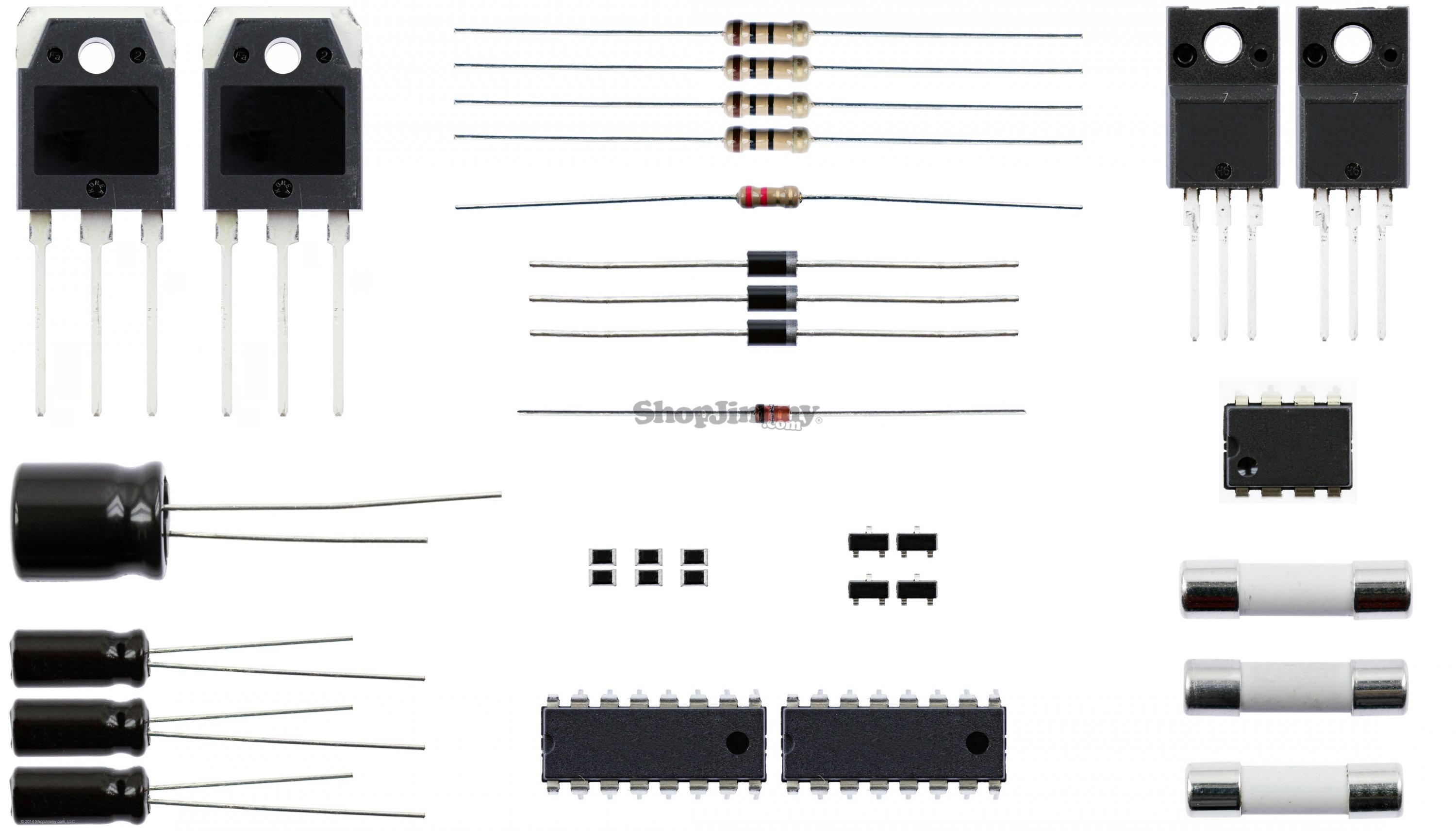

        maybe the kit contents may give some clues what to check if it's PSU.

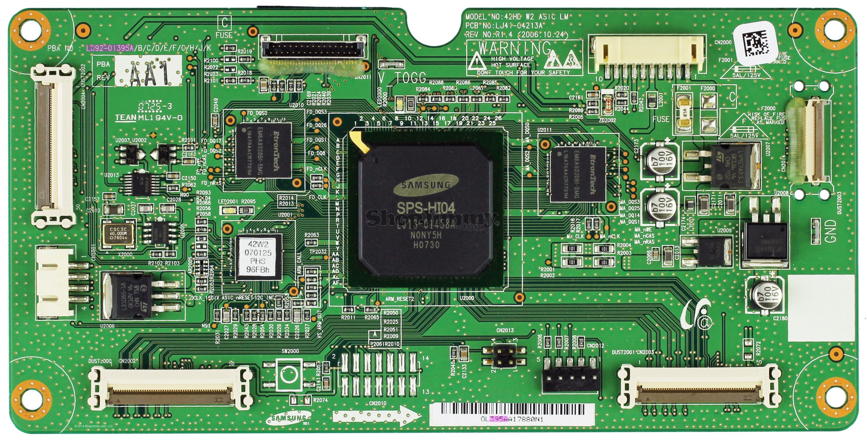

            I'm not that Samsung savvy but I would try and have a very close look at the logic board. If it's the same as the image there's 2 tiny LEDs and one is usually like a heartbeat but if there's no LEDs at all maybe that's part of the issue because as far as I know that board is what controls the panel voltages and drive signals.
            LED2000, LED2001. If you look at the zoomed image you should see them. One above and left of the processor.
            Also there is a fuse F2001, maybe confirm what voltages are getting to the logic board.

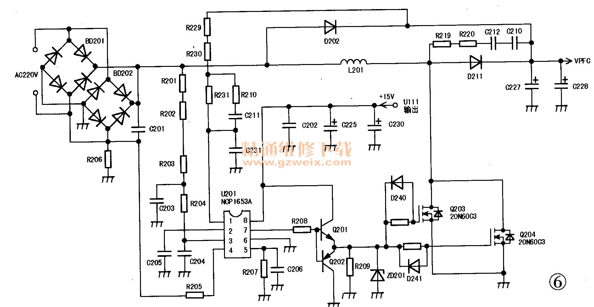

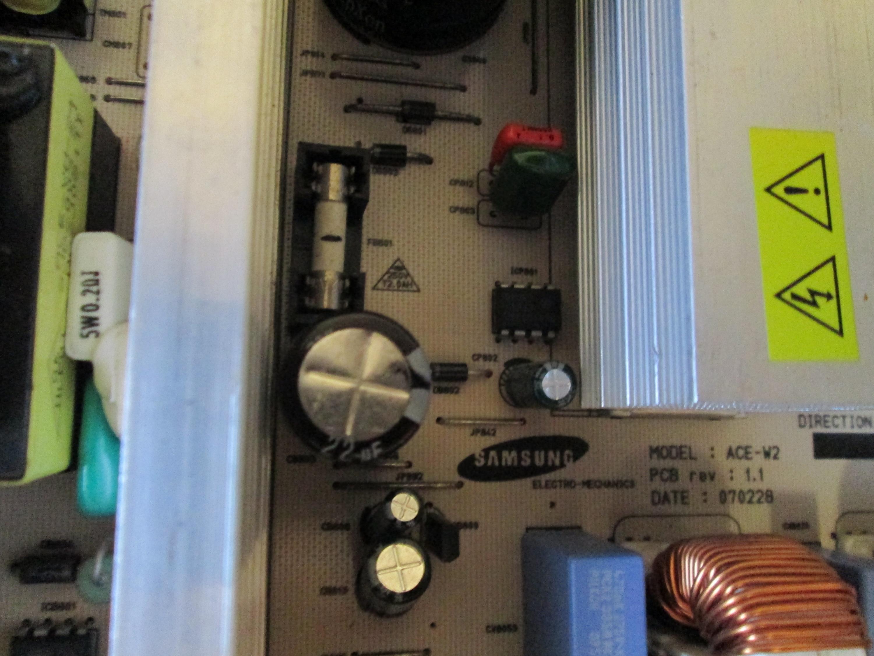

                  Whoa!!! I got 135v on pin 4 on 8 pin IC NCP1653a,its supposed to be 15v? Sorry about the quality of the photo its getting dark here.

                    In an area I can't help, sounds like you're in the hot side so be careful.
                    I would think if 135V was fed to a point needing 15V it would have exploded?
                    Sure you got the right pinouts? I see pin 8 has Vcc of 15V and looking at pin 4 it looks like it being fed much higher than that from the mains in this example.
                    • redrooster
                      • May 2011
                      • 114
                      Re: Celestial PT4299HDS,Sound,No Picture?
                      It was the top left hand pin in the photo that I took the reading from,so its pin#4, it sounded like the relay started to chatter a bit when I was measuring it? So its supposed to be around that voltage then?

                        I don't know, You need someone who understands SMPS better.

                          I just shorted pins 7 & 8 trying to measure voltages on the IC and it blew the fuse so I replaced the fuse and checked that the pins weren't shorted together so I turned it on and blew the fuse again along with the two big FETs SD20N60 so Ill just get another P/S on ebay and that should fix it.Thanks for the help mate I appreciate it. They say you only learn from your mistakes! That must make me a genius? lol
