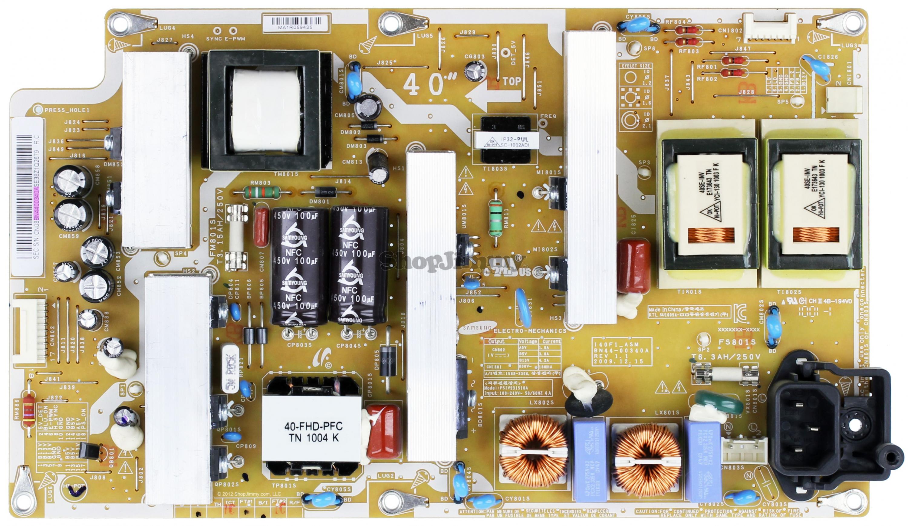

    Got this LCD, friend gave it to me. Found PSU BN44-00340A had issues.
    dead, no stdby. backlights failing prior to total loss.
    MI801S,MI802S 12N50 FETs blown,
    FM801S 3.15A fuse
    Now have stdby and erratic backlights, missed the small stuff and now it went pop.
    I have no schematic and found no images good enough to work out the resistors which have burnt.
    R1845,1859 30K
    R1841,1846 270 ohm
    need ID of R1844,1842
    Bn44-00340B is a different board and cct
    Images are SJ and not clear enough to get the numbers

    Can you upload the images direct to Badcaps or to a site like Imgur? Shopjimmy is blocking UK IP addresses for some reason.

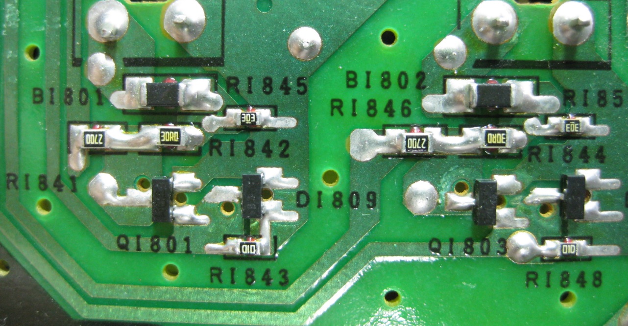

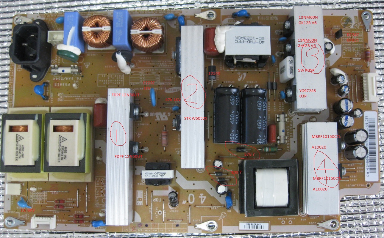

          Thanks to Sevenqi who sent these images to me.
          Unfortunately, I replaced the parts and the TV lit up but I noticed flickering. After a while you know when you get that resin odour from the PCB things are heating up and sure enough the heatsink with FETS MI801S & MI802S was red hot. After a few cycles when I started adjusting the backlight that familiar pop was heard.
          To help others here's a list and most of this was damaged on mine which had no stdby. I did not replace UM801S IC so maybe that was the issue.
          FM801S T3.15AH, 250V FUSE
          UM801S STRW6052S
          MI801S FDPF12N50UT
          MI802S FDPF12N50UT
          RM811 0.3 OHM 1W
          RI842 30 OHM
          RI844 30 OHM
          RI843 100k OHM (Marking is 01D)
          RI848 100k OHM (Marking is 01D)
          RI845 30K ohm
          RI850 30k ohm
          RI841 270 ohm
          RI846 270 ohm
          QI801 2N7002K (WC)
          QI802 2N7002K (WC)
          DI809 BAV70
          DI811 BAV70
