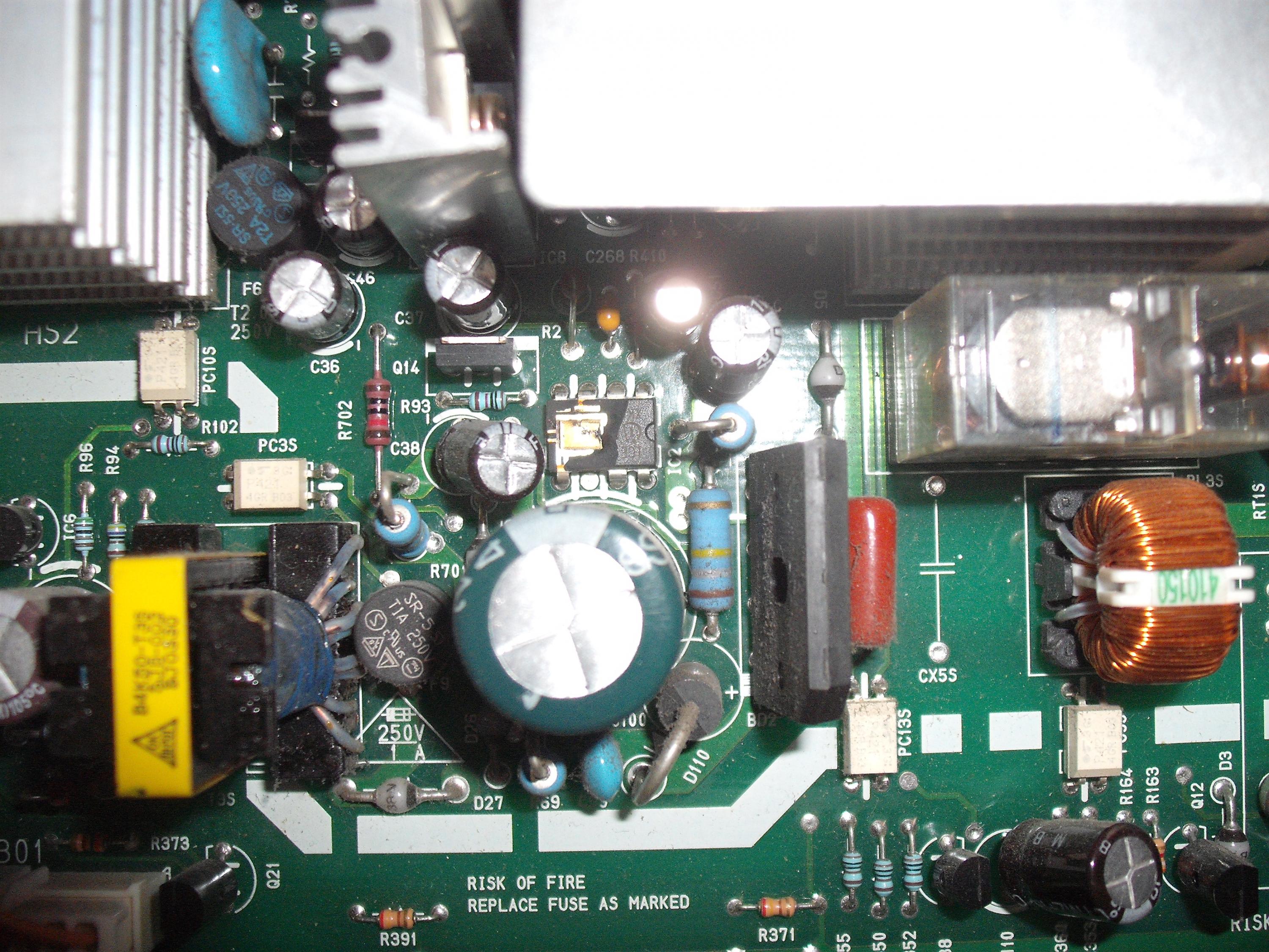

    OK upon further inspection I see something wrong. There is a chip or not sure what you call it but it's blown or cracked etc. It is right next to a 22uf 450v cap and looks to have about 8 solder locations. The board is labeled ic2 next to it. What now?

            Pic
              Re: Samsung plasma SPN4235 does not turn on
              Blown SMPS IC IC2. The black round fuses are good? I expect some blown fuse too.
              How about the pictures of the whole board and the board P/N, BN44-?????

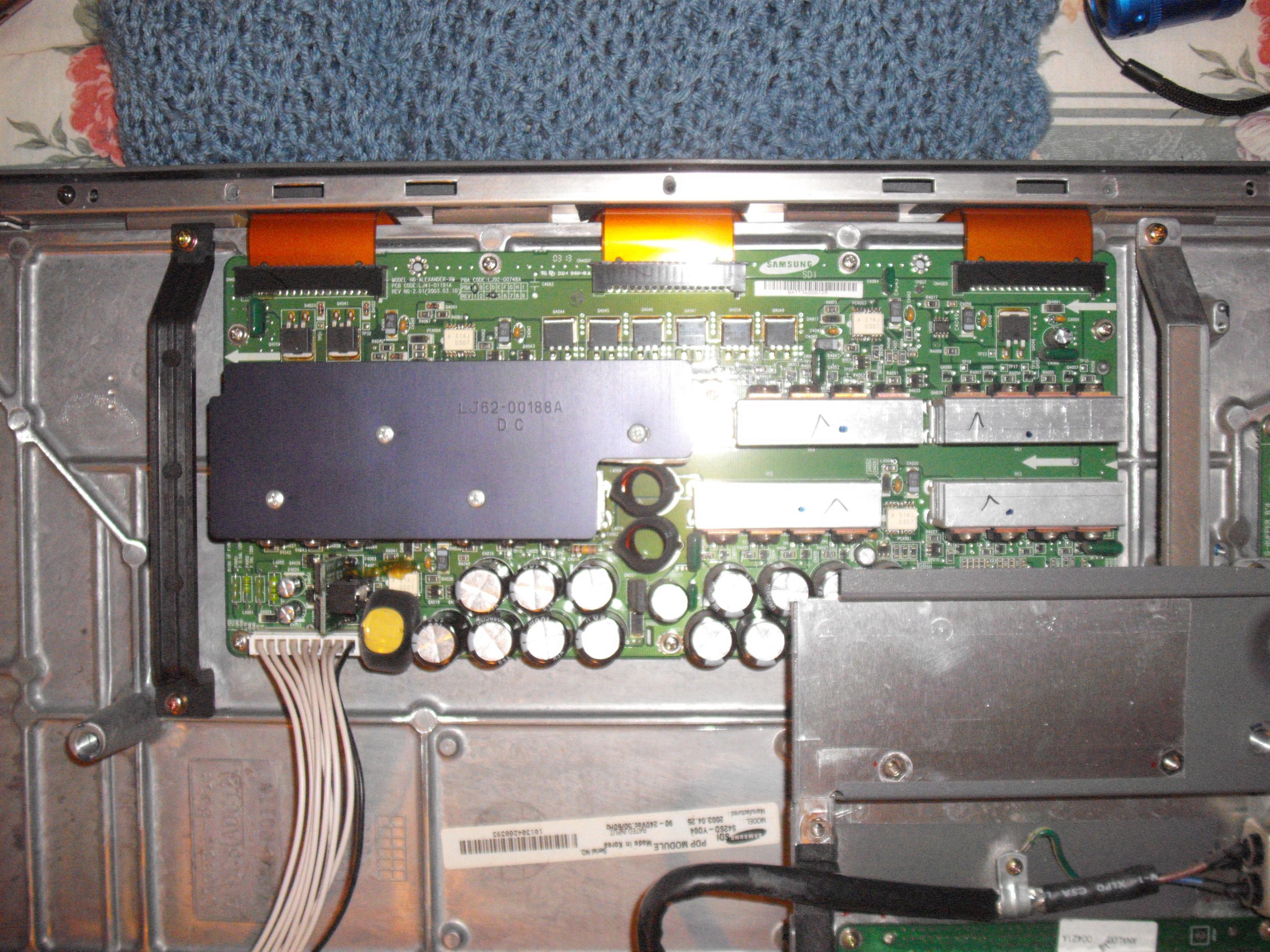

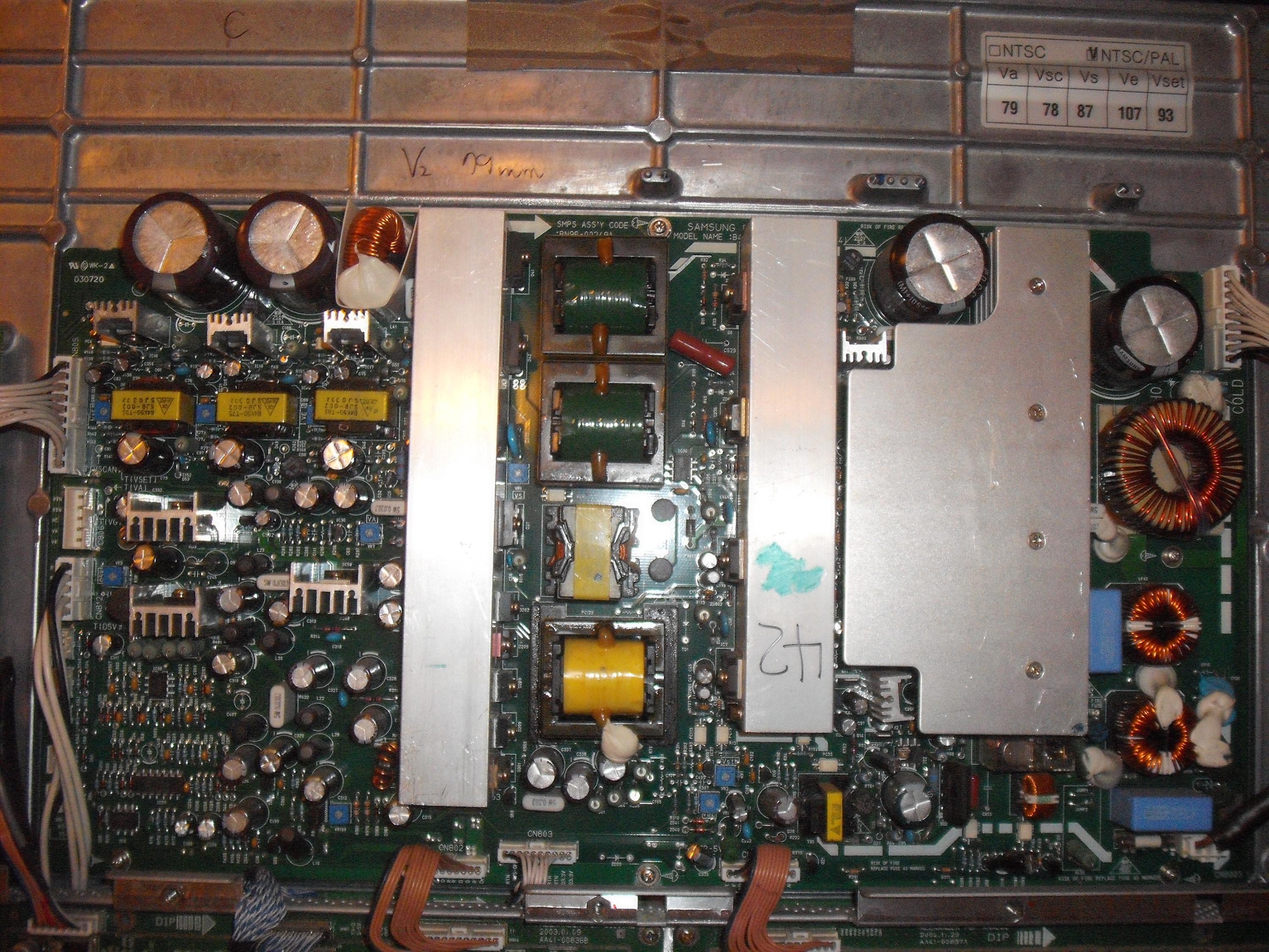

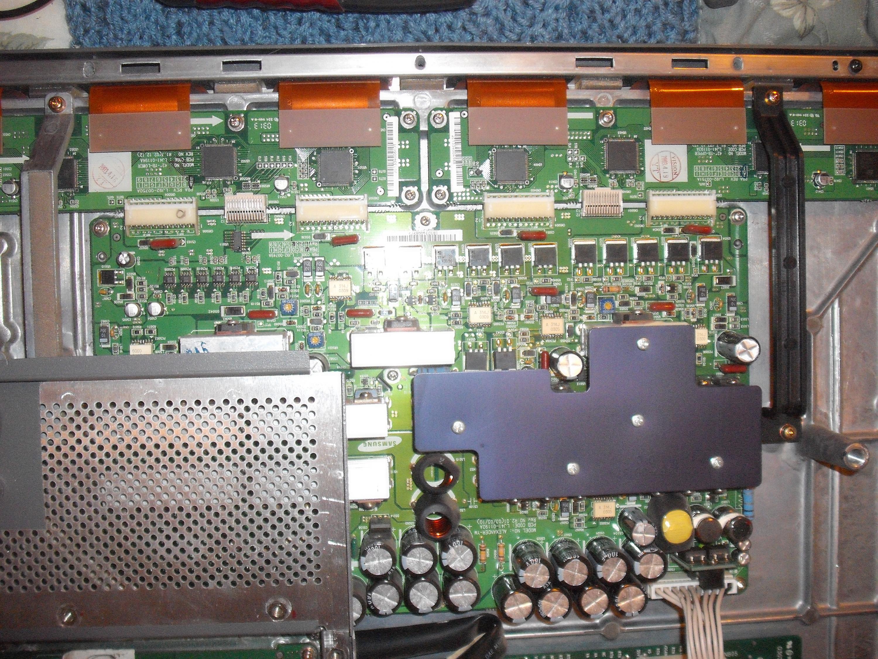

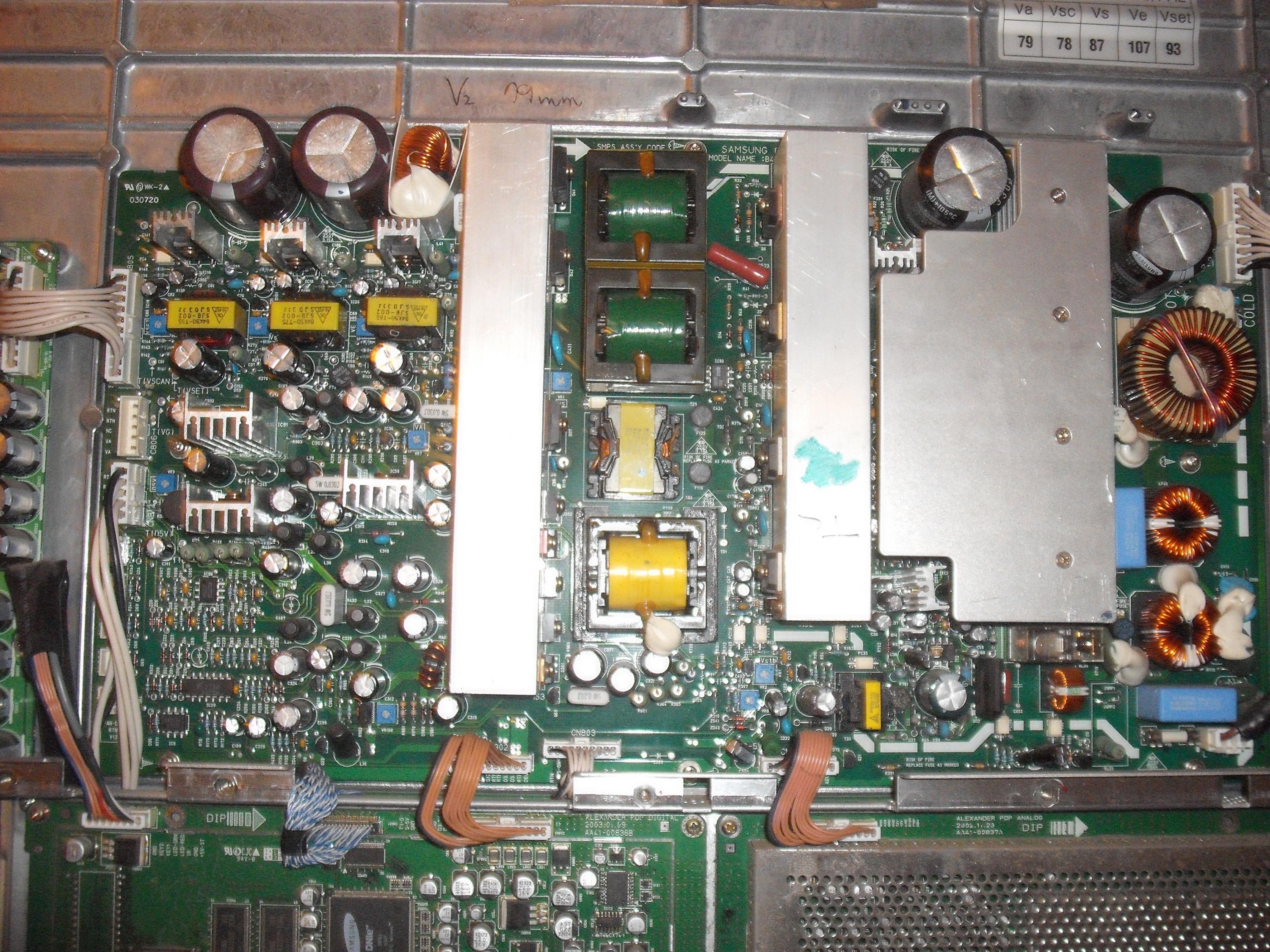

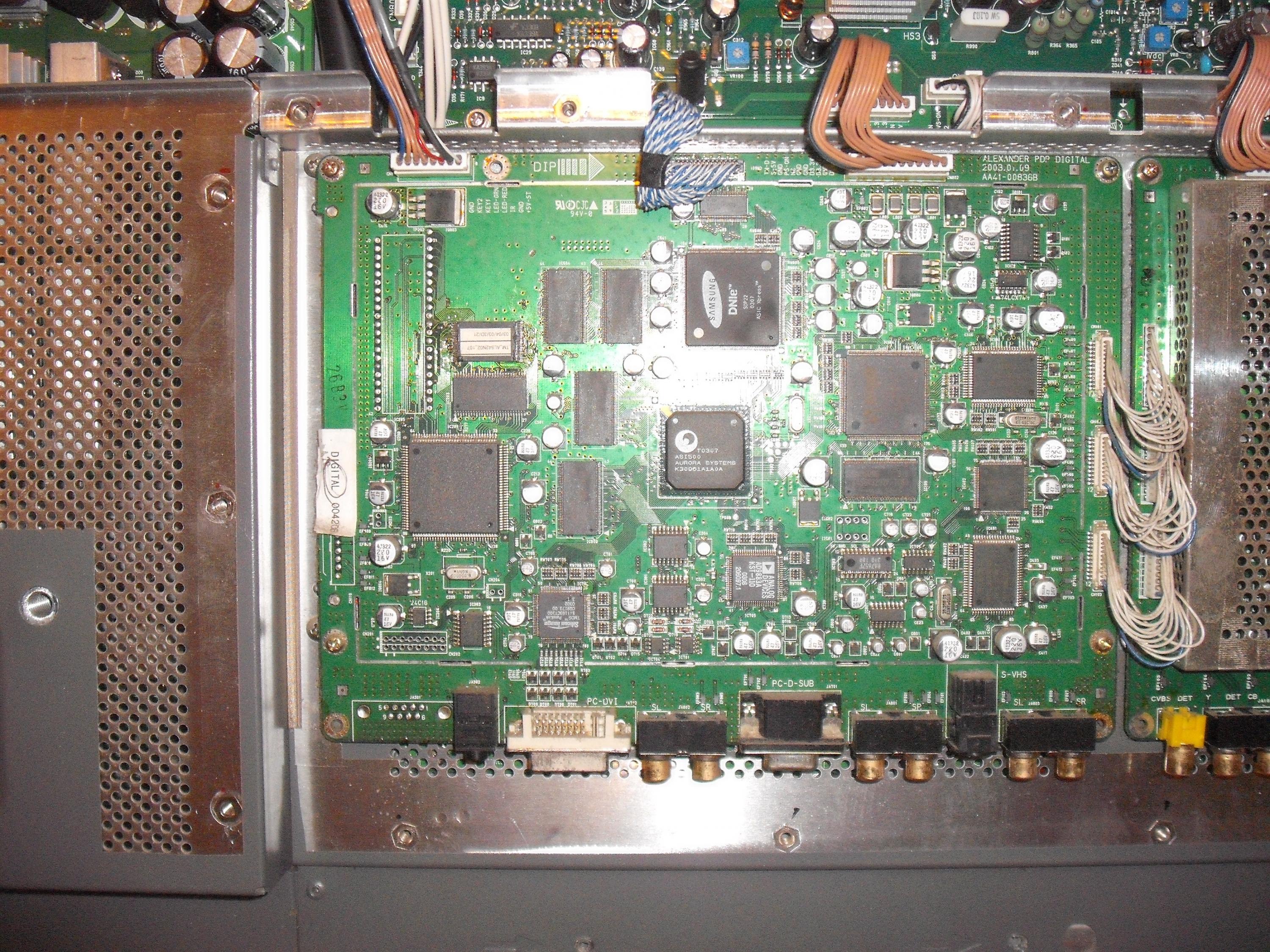

                pics

                  Yep your 5vstby Ic has had a meltdown, check this video out and I will also link a thread on this fault too:
                  https://www.youtube.com/watch?v=VgcoAd04EtQ

                          Try it on ebay or on google for the oart, also replace the resistor and small caps around that area as well as the 22uf 450v cap. If not get a PSU its worth saving this old unit
