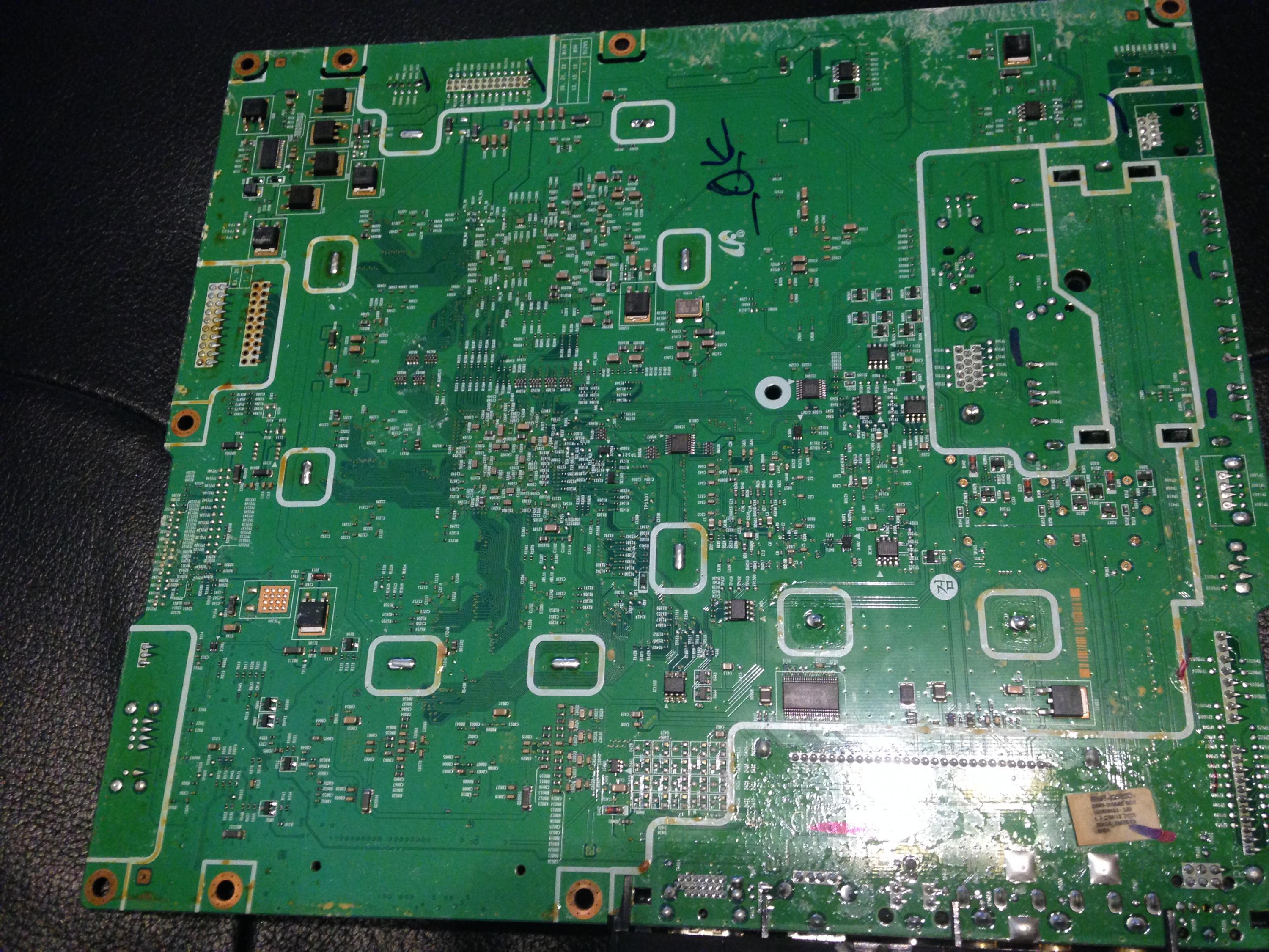

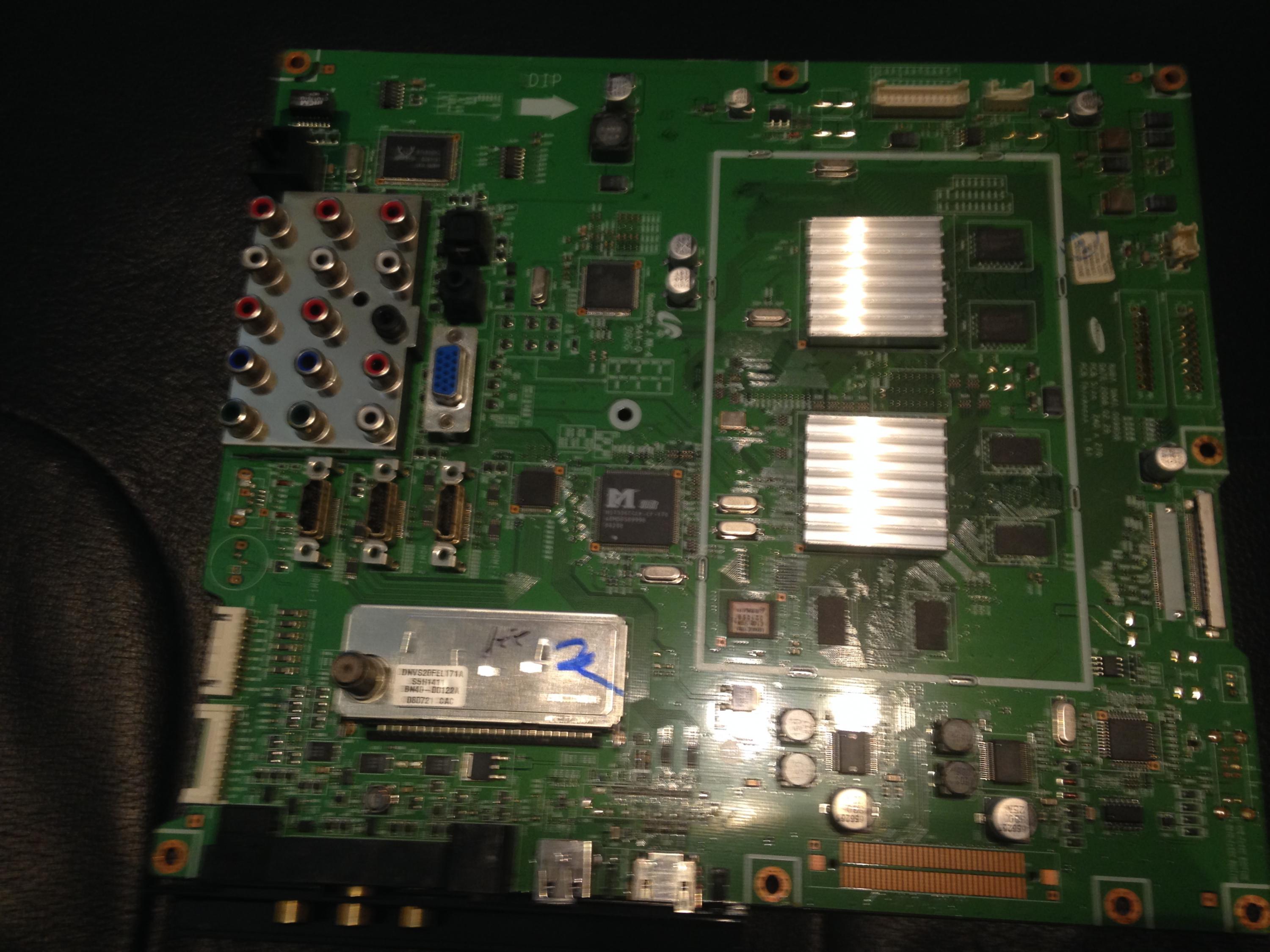

    Has anyone seen and fixed this problem on a Samsung LN52A750R1FXZA? I have come across two different issues with these TV's on these boards. One was the capacitor issue with the bulging capacitors. I have replaced the capacitors with no luck and the problem persist. The TV will go into a constant loop of powering off and powering on. Only way to stop it, is to unplug the power.
    I also came across this thread,
    https://www.badcaps.net/forum/showthread.php?t=32061, which discusses the same issue on many Samsung TV's about the same age. All were fixed by changing out the c102 Tantalum Capacitor. Thought that I found my fix for sure; however, my main board is slightly different and doesn't have that capacitor.
    I have posted two different pics (front and back of my board). Anyone have any ideas with this specific model?
    Thanks,
    Bobby

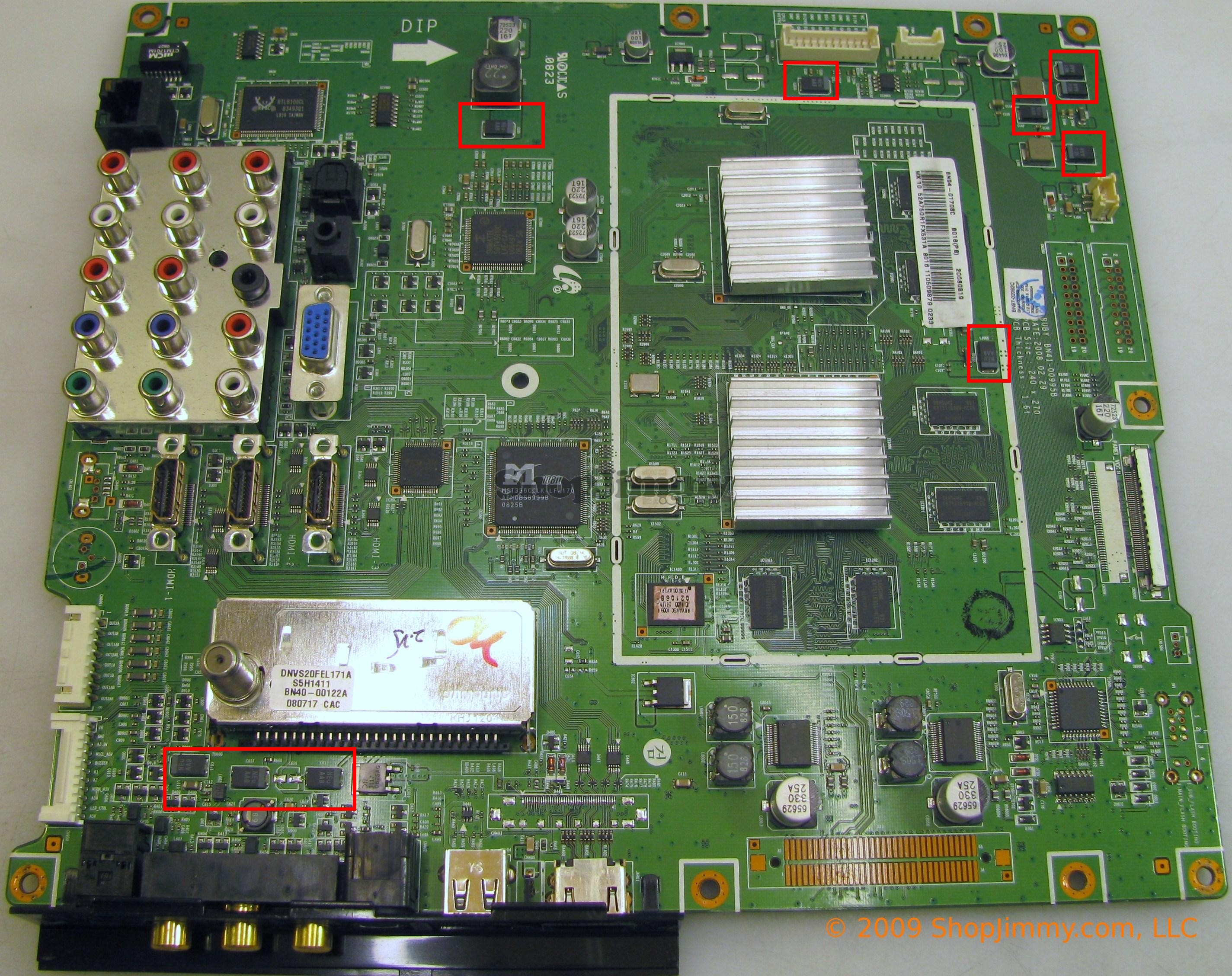

    Try heating those NEC-TOKIN caps (those are the same type of failed cap as used for C102).
    Pictures provided bu shopjimmy.
      Re: Samsung model LN52A750R1FXZA Power cycling
      I heated the chips as recommended. This worked for about 4 days. The TV started cycling again over the weekend. I think I will start replacing these and see if I can make the fix more permanent.

                SAMSUNG BN94-01658E C102 location number is under IC101 if you are looking for that first, good luck.
                The kit from ShopJimmy is a ceramic replacement cap with no polarity which can be installed in either direction.
                Shopjimmy offers no support at all!
                IC1203 - STA335BWS (SSOP-36) I could only find this on Ebay!
                IC101 - (MP2363DN) Digi-key P/N 1589-1366-ND
                C102 - 47uF 10V Tantalum Capacitor Digi-key P/N P16230CT-ND
                I used an iron to mount C102 after I mounted IC101 due to size, worked nice for me!
                Hope this will help someone!
