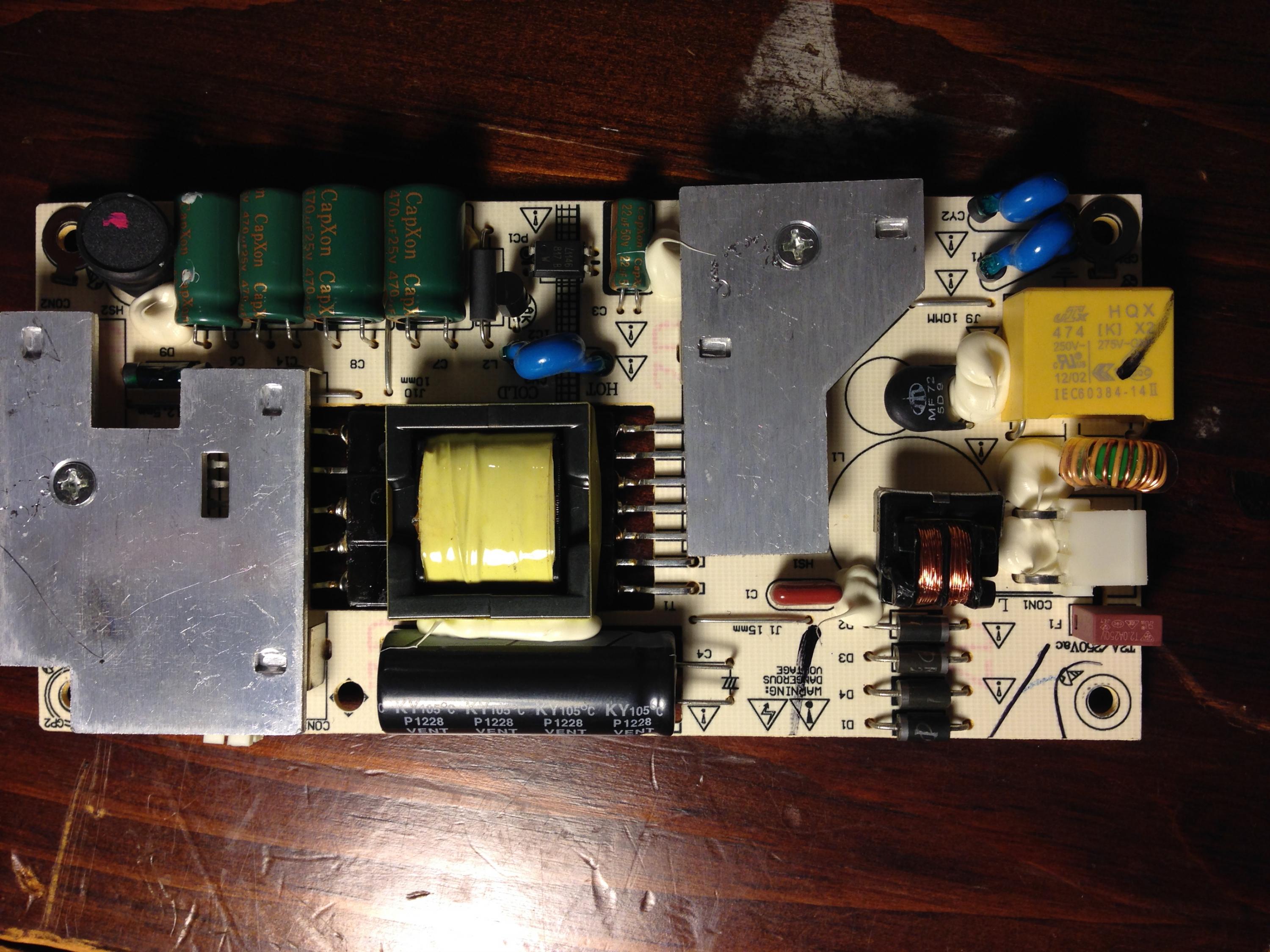

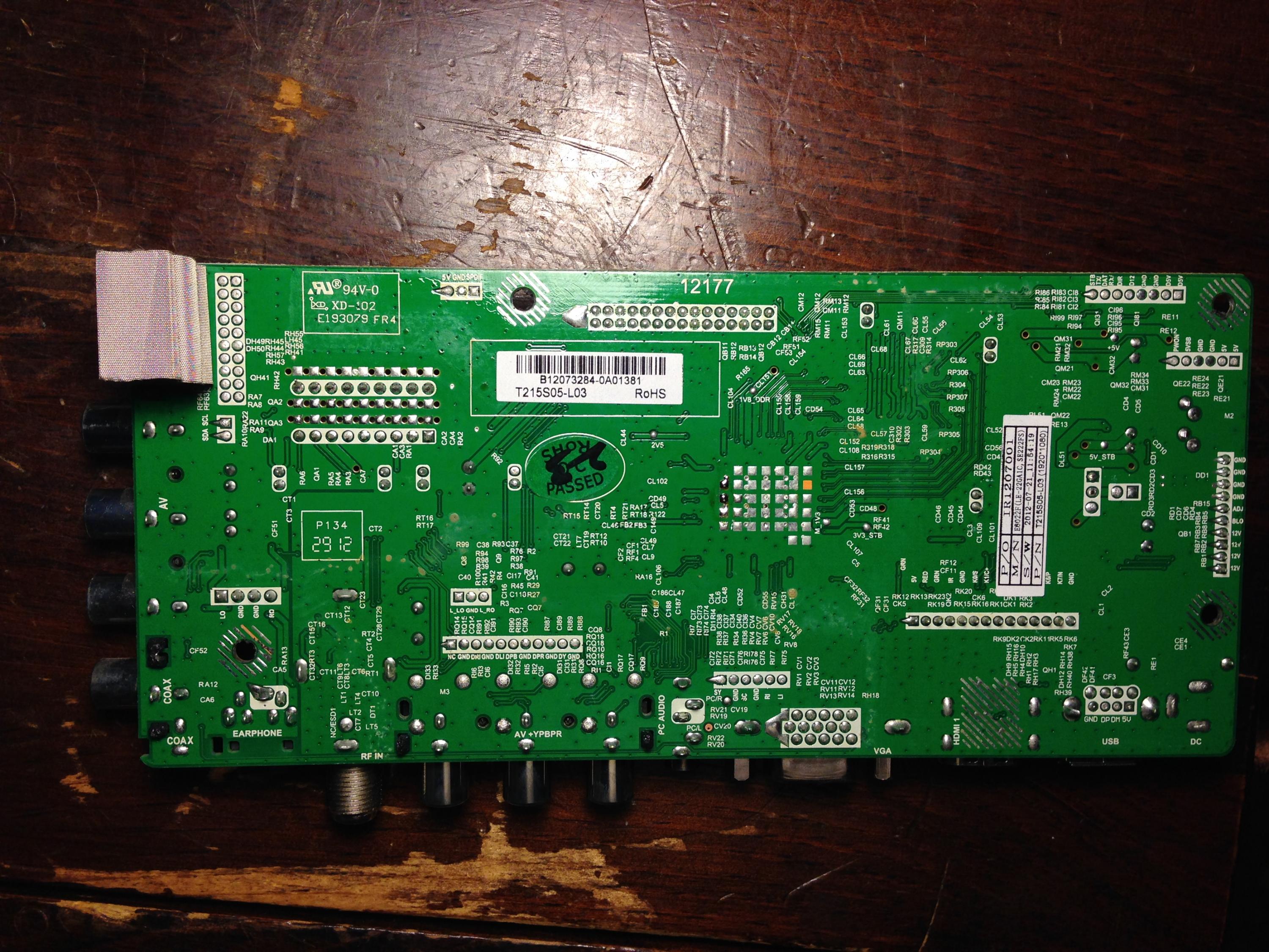

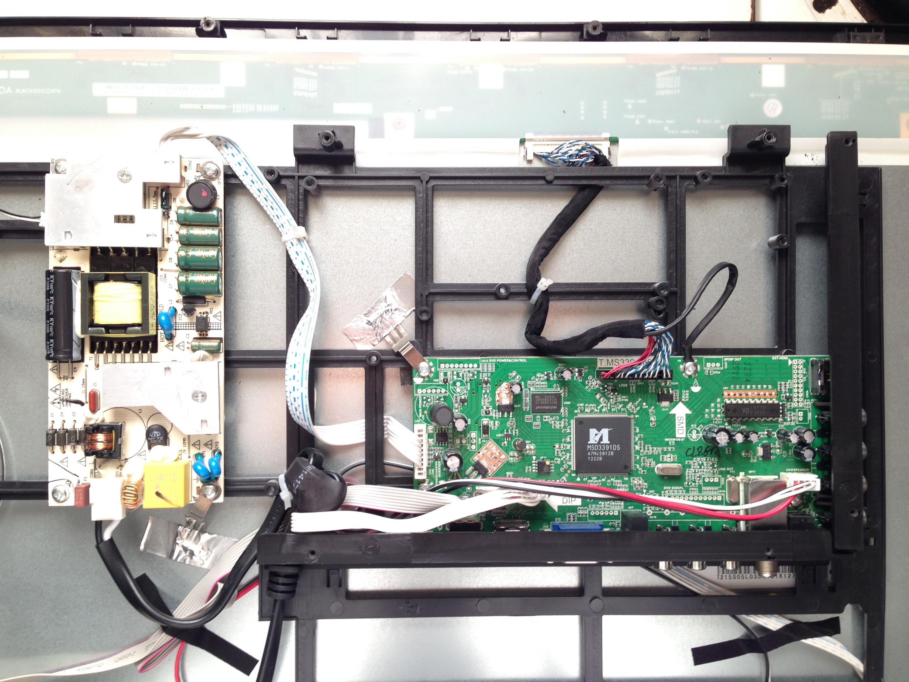

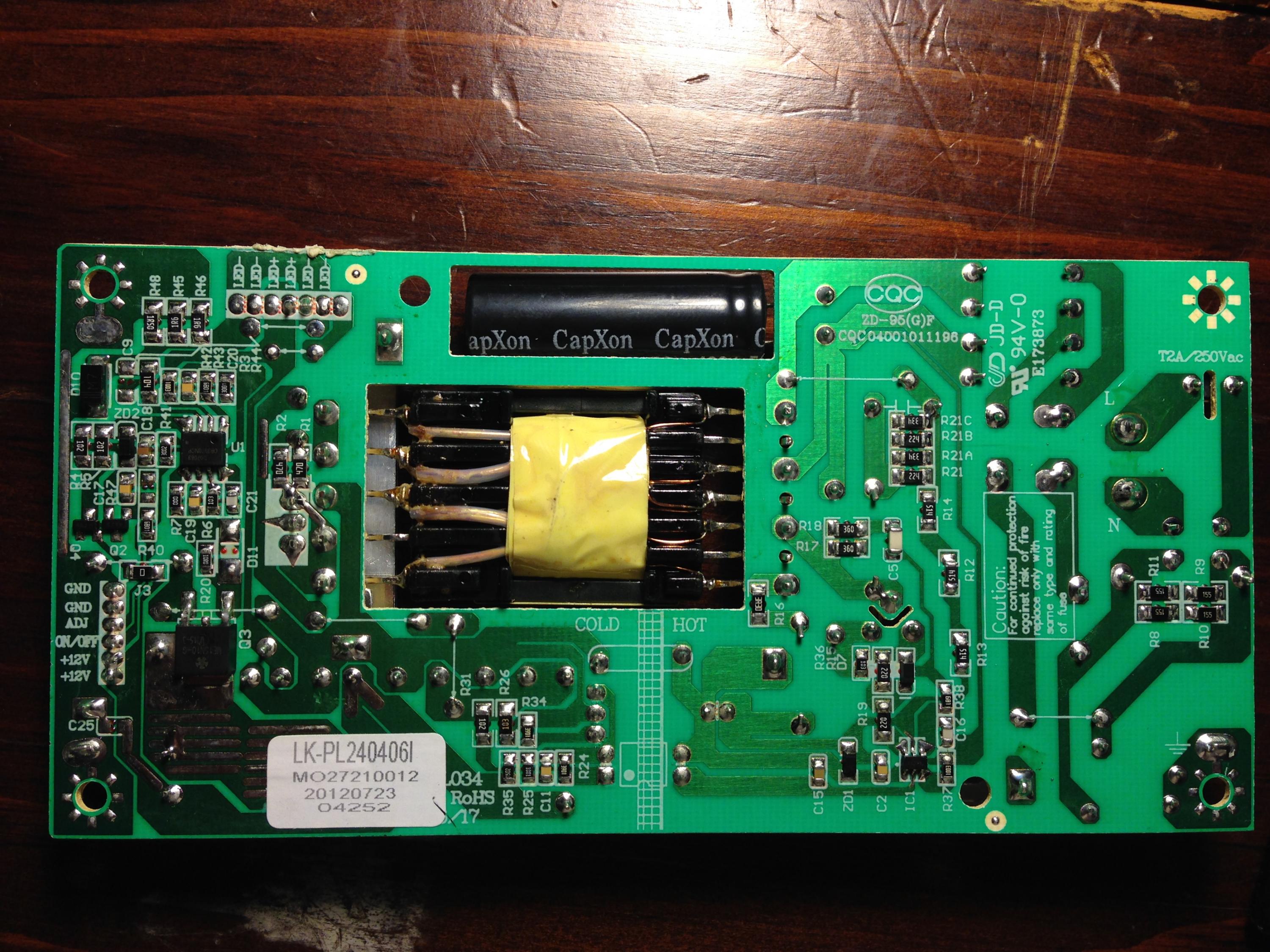

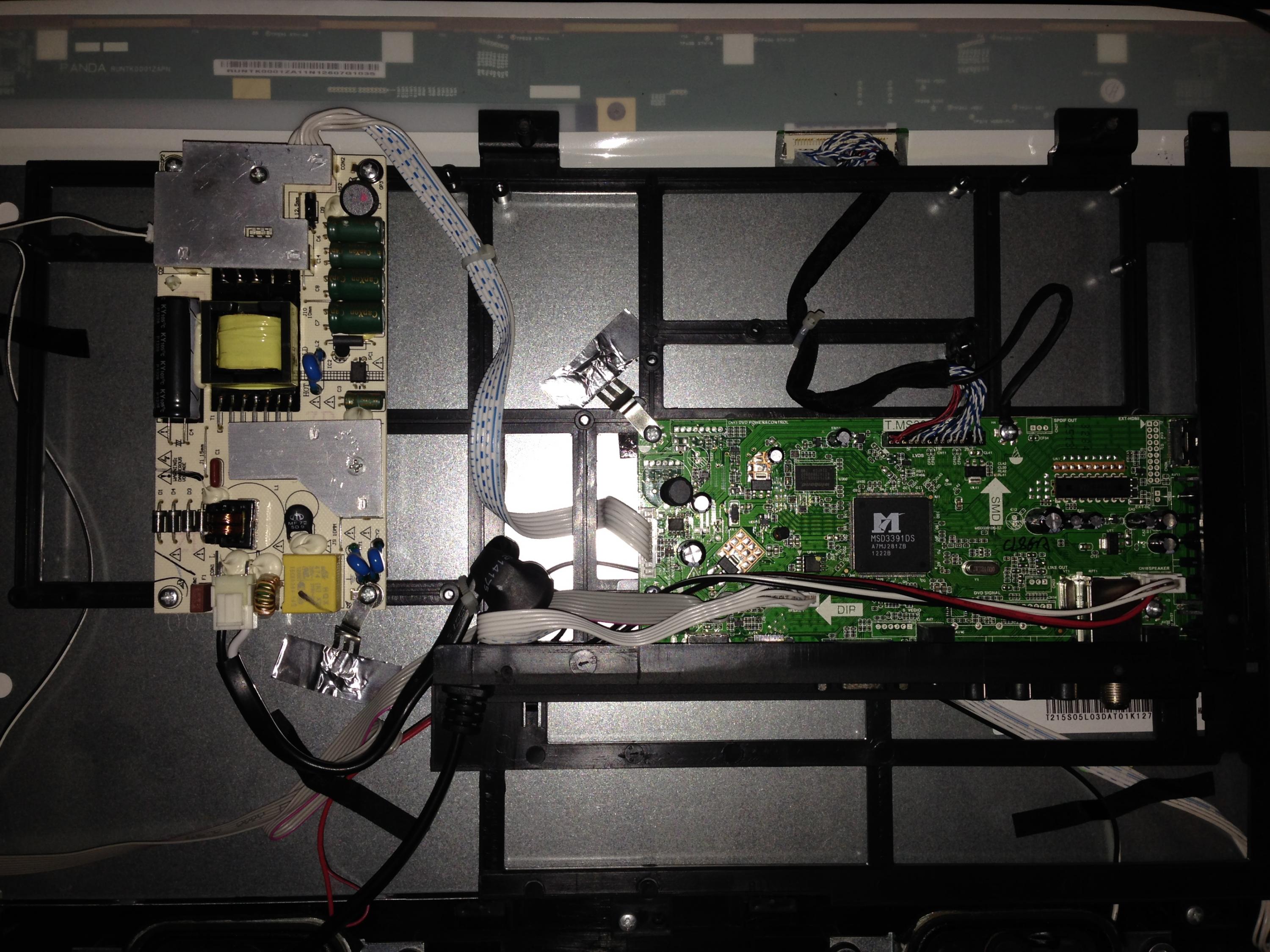

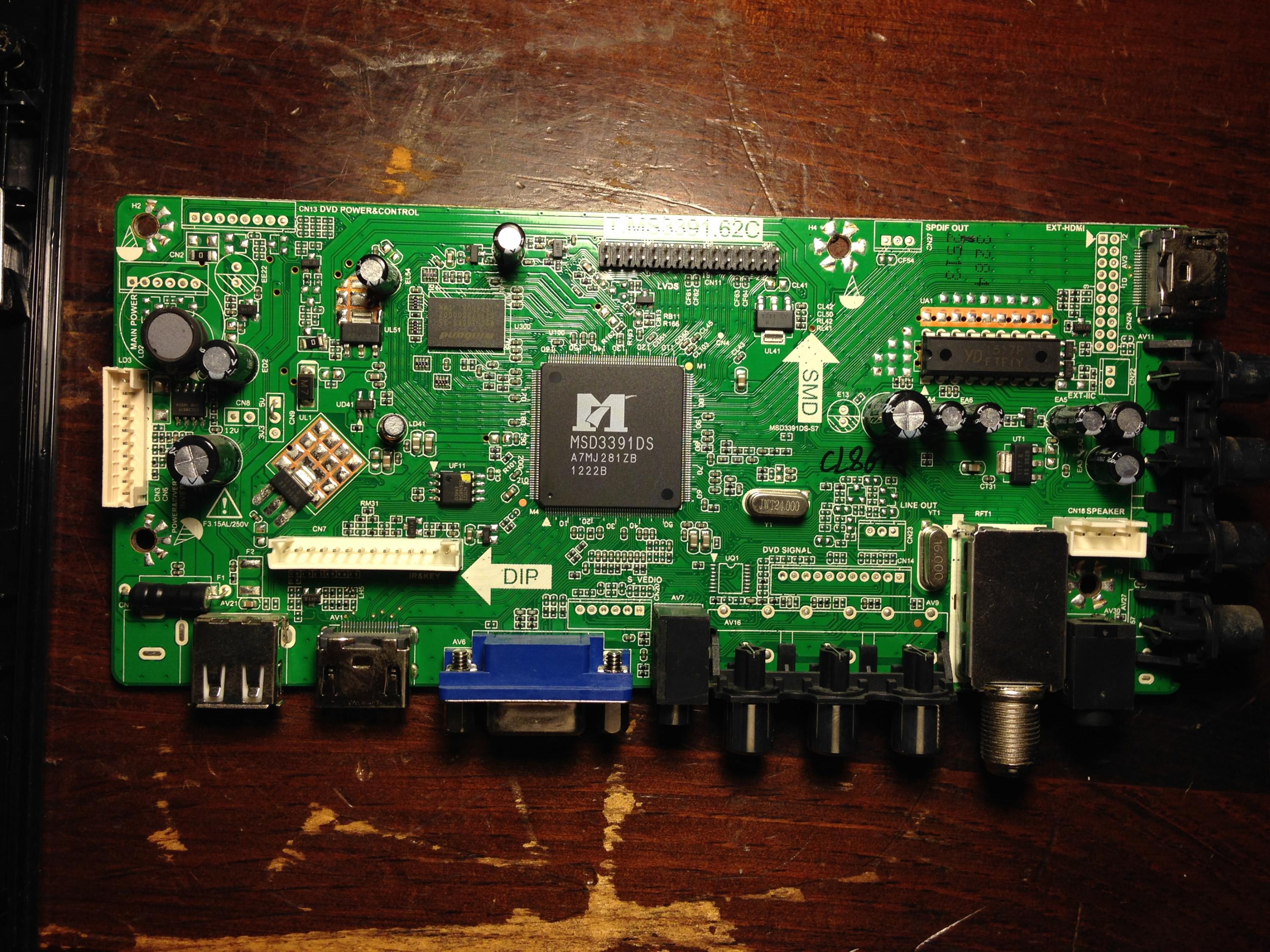

    I have a SEIKI SE222FS TV that does not power on. The LED on the front is lit when plugged in, but does not change when the power button is pushed. There is 12v, 12v, but no BLON on the main board. I have not been able to find the service manual for this TV so I am unsure what else to check. I suspect that the main board is bad, but would like some advice/guidance. I would also appreciate it if someone has the service manual that I can get.

    Funny, because I can see clearly BLO written on the backside of the main board. I think on the PSU its called on/off. If you don't see any activity on that pin while turning on the tv, the main board is the problem. You can try checking caps, regulators and freeze the eeprom.

            The flash Ic tends to become heatsensative and the firmware on it becomes corrupt meaning the Tv wont come one. You would need the firmware flash and a new Ic which is hard to come across. Easier just to get a new mobo.

                  By freezing the eeprom I mean: Taking a can of air upside down and spraying the eeprom on the main board until it is frozen, then turn on the TV. I have a 70% success rate identifying a bad eeprom like that.

                      Heres a word of warning frezzing the flash Ic's on these does not work but buy measuring the power on outout pin you can see if its failed.
