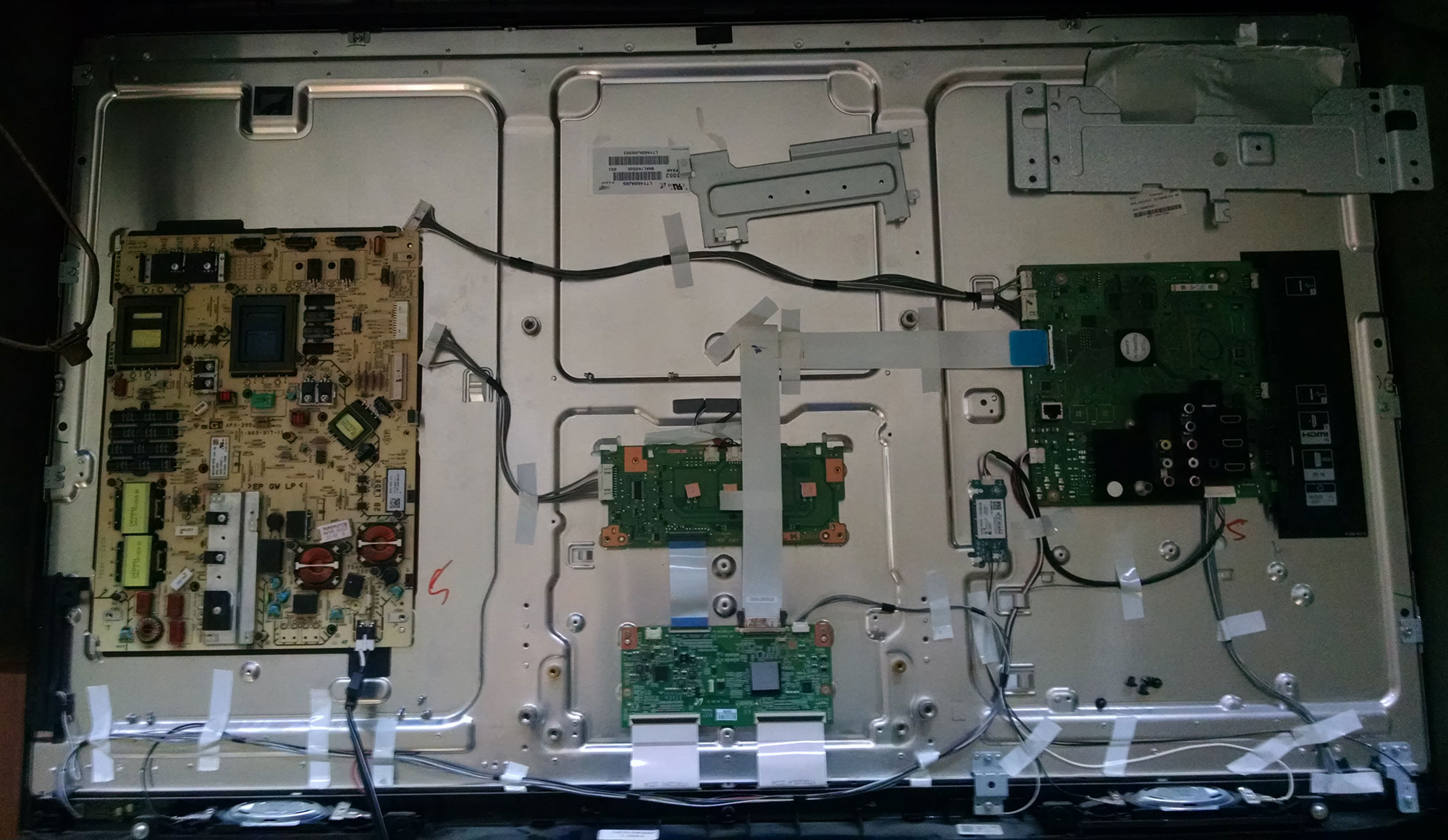

    Hi folks,
    it's been a while since I've posted on this great resource! FYI I have exhausted myself searching and testing but still need some assistance please.
    The original situation: It started as a 5 blink error code, which means TCON, Panel or HWR(from service manual). I tried reseating the LVDS cable and nothing changed, then I disconnected the two ribbons that go from TCON to Panel and viola!! The TV came on with green LED lit and backlights lit.
    So I tried again with one of each panel ribbon connected and with the left one connected it was 5 blink error and with right cable connected the TV came alive.
    The situation NOW: The TV was sitting there on and I was testing the TCON fuse voltages and all of a sudden it turned off(I am 99% sure I didn't short it out). Now the PSU is DEAD!!

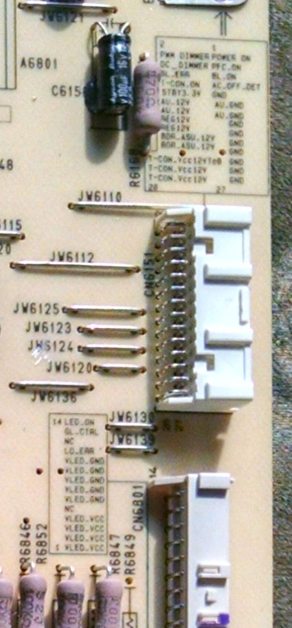

    There is zero power on the secondary connector pins including STBY.
    The main filter cap is getting ~170v(USA 120v mains).

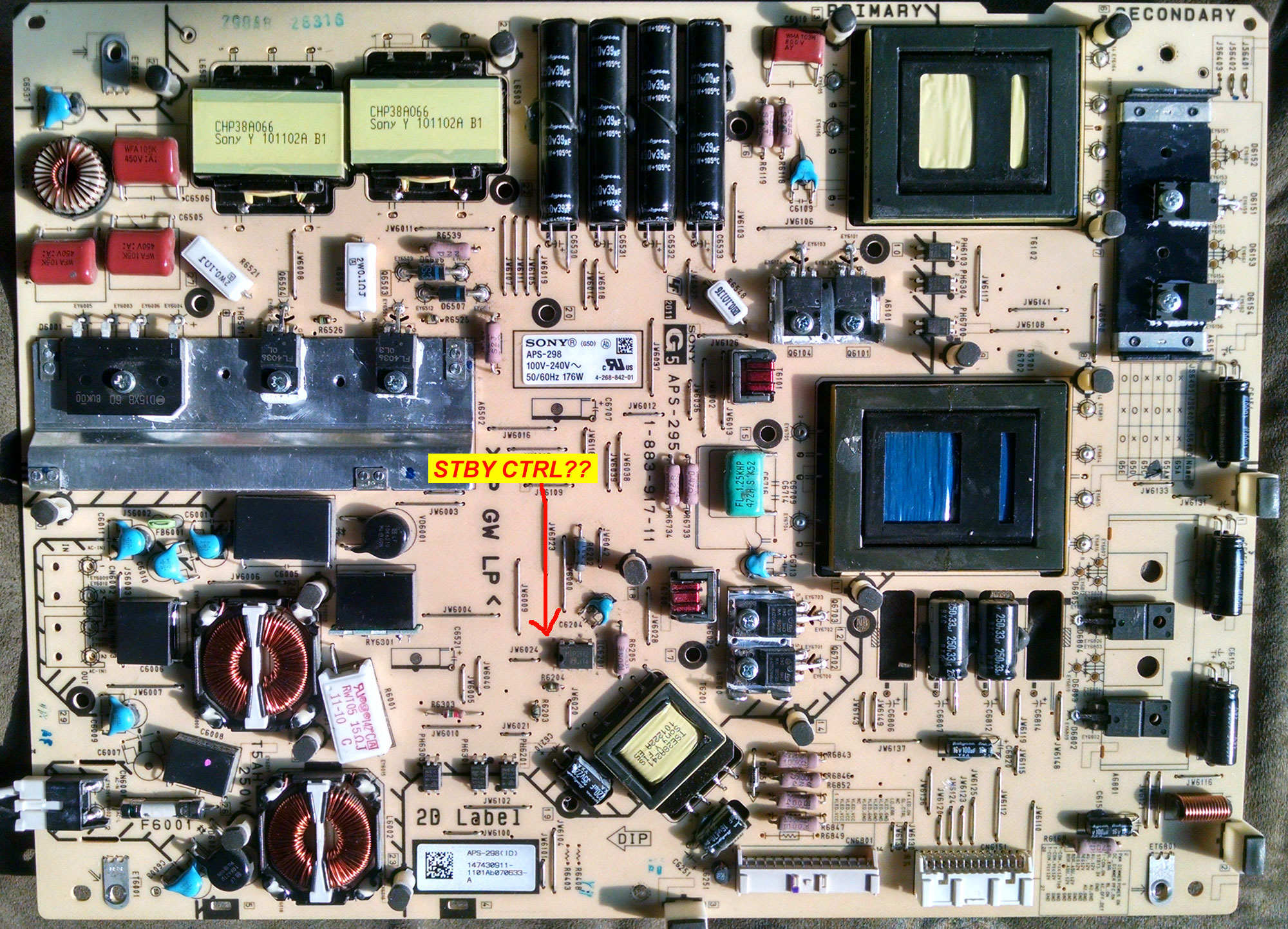

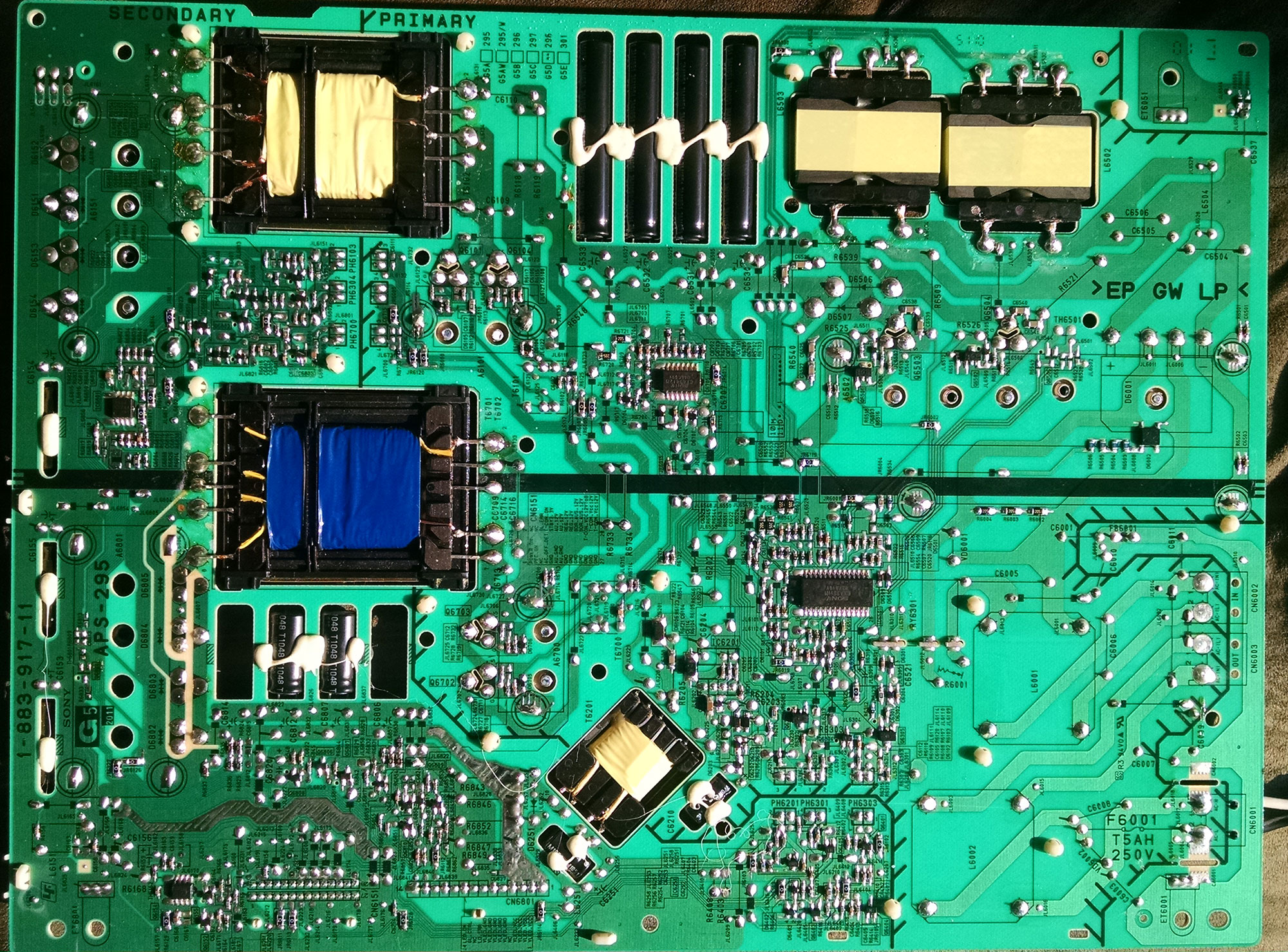

    I'm suspecting the standby IC cct but not sure how to go about testing to be sure. The IC is:
    MIP2H2
    No datasheet available but there is a cct here: http://www.irantk.ir/Power_IC/irantk_Datasheet/MIP2H2_Schematic.pdf
    Would any of you kind folks be able to help me proceed?
    First, do you think it's a bad panel and I should just scrap my efforts? Or maybe it's tcon(cheap) and I should pursue fixing the PSU(expensive)?
    Much appreciated! Pictures attached.
    Marty P
    MD, USA

    UPDATE: Standby 3.3v is THERE... Not sure if it was my oversight or maybe because it was sitting in the sun for a while. Still no front led or relay click. Hope I didn't kill the main board...
    I guess the next test is manually trigger BL_ON?
    Every pin on BOTH connectors reads 0v except STBY3.3.

      One more update: I applied voltage to POWER ON via 470ohm resistor and STBY3.3v. This fired up the PSU. I heard the relay click and most of the 12v pins came on.(tcon vcc did NOT come on but assuming because I need to also apply 3.3v to TCON ON)
      Is it a fried main board?
