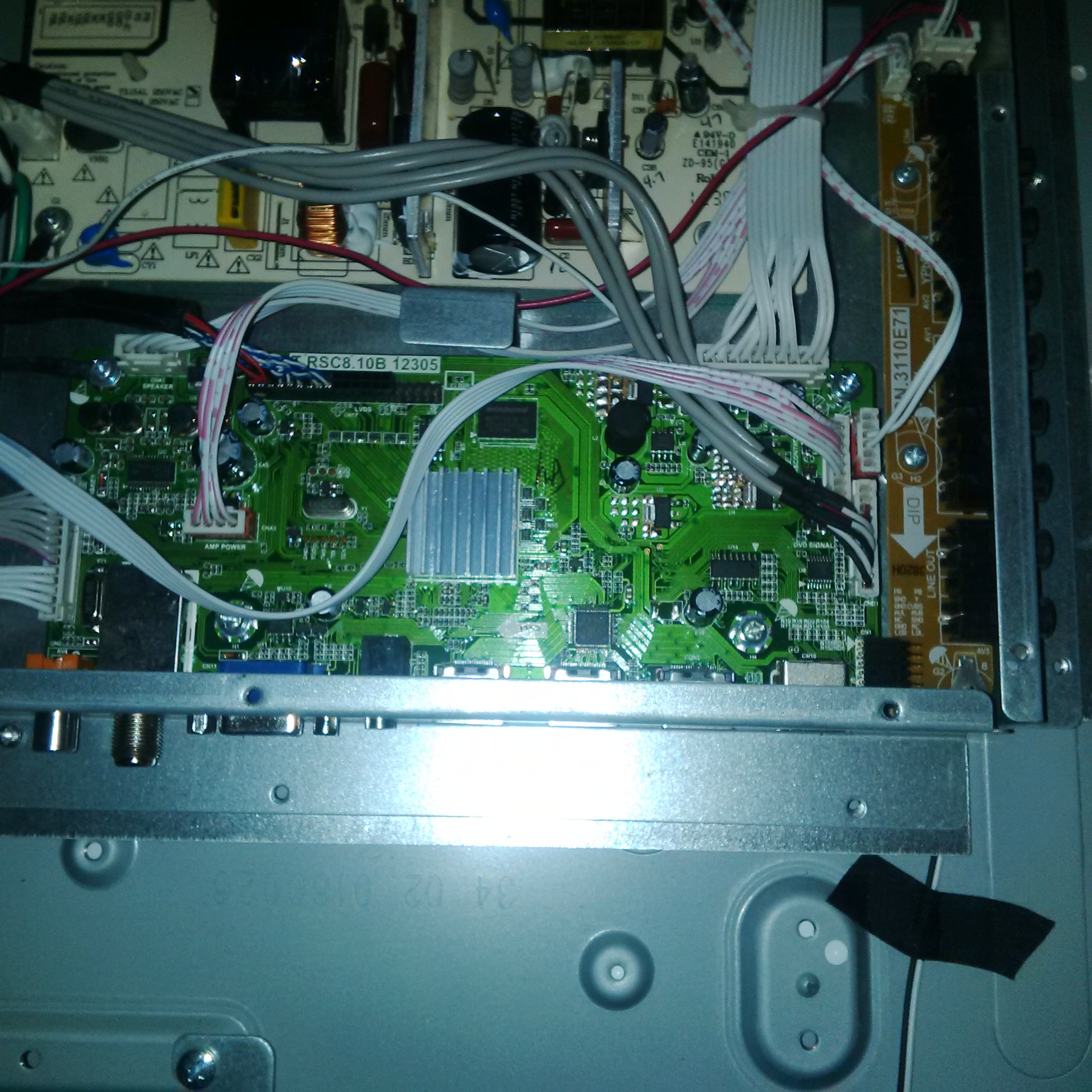

    Re: RLCDV3282A-B Turns on then off with t.rsc8.10b 12305 main
    Forgot to add a pics.

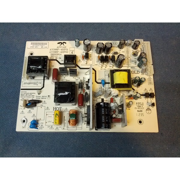

                I metered the psu outputs today. I don't have pson or blon but the equivalent is +5vsb and SB going to the main board. My 12v out is 12.58v. My 5v out is 5.18v. The SB is 4.61v. The +5vsb is 5.18v with the tv on or off. But reading from the psu to the back light board, I think I have some answers. The back light comes on with the splash screen but I don't get solid voltages, then the tv turns off. I tried to read voltages with the back light board connected and not connected. Both give the same readings. My voltages while the tv is on for PB is .08v, VS is 2.23v, CS-IC is .9v and my VBL connection bounces from 100v to 1100v. I'm going to take out the psu and do some metering and resolder some points. I think I have a psu problem and not a main board one. Any ideas?
                I need a schematic for the psu. Model AY098P-4HF02.
                  What happens to SB when the tv acts up?
                    I turn the tv on and it goes 4.61v and stays that way until the tv turns off. I haven't gotten the tv to stay on today.
                      So when the TV reboots, the SB disappears? If that's the case that is a clear main board problem. Try disconnecting the backlights and see if the TV stays on without rebooting.
                      If you want to test the PSU, force it on with 1k resistors.
                            The SB doesn't move at all. It stays at 4.61v while the tv turns on and reboots until the tv turns completely off. The only thing that hiccups is the back light rail. But even if I unhook the cable to the back light board, it still hiccups on the psu. The power rail coming in from the main board never hiccups. Here is the readings at the back light out on the psu.
                            PB .08v
                            VS 2.23v
                            CS-IC .9v
                            VBL flucuates all over the place.
                            Looking like I have a problem with the psu.
                            I'm trying to get it to turn on and stay on so I can test it while it's working.
                                I have to agree with you. I finally got the tv to turn on and stay on. The voltages on the psu are reading the exact same way they did when the tv wouldn't stay on. Maybe something isn't engaging on the mainboard? I can get a cheap main board to test. Since I will never find an RCA one, I'll have to get a Sceptre one and swap the eeproms. Sound like a plan?
                                        The more I read about a faulty eeprom, the more I think it's an eeprom problem. The boards I have been looking at on ebay and shopjimmy have the right amount of connectors, but I have a feeling I'll lose the dvd capabilities of the tv. Which really doesn't matter since I have a blu-ray player hooked to the tv anyways.
