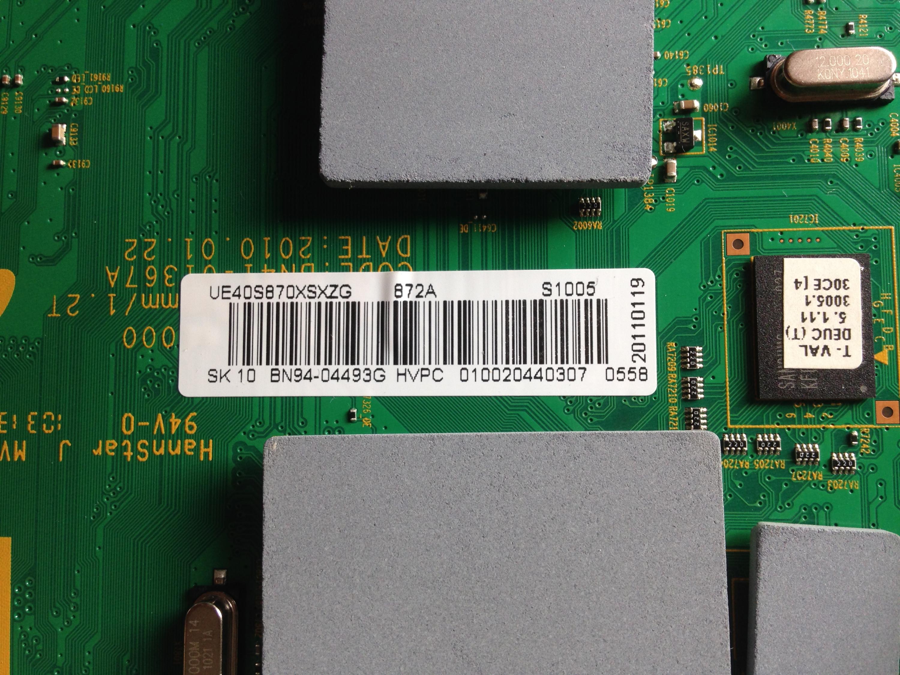

    Hello
    i have an Samsung TV here that has no signal on sat, because
    the lnb voltage are not available.
    -when i gave the voltage over an remote receiver the tv works.
    -LNB voltage are "on" in the menu
    -i also tried a factory reset
    so the problem is only the missing lnb voltage, but i
    cant find a service manual or other useful infos.
    did anyone know about this issua or have anyone a similiar problem?
    thanks

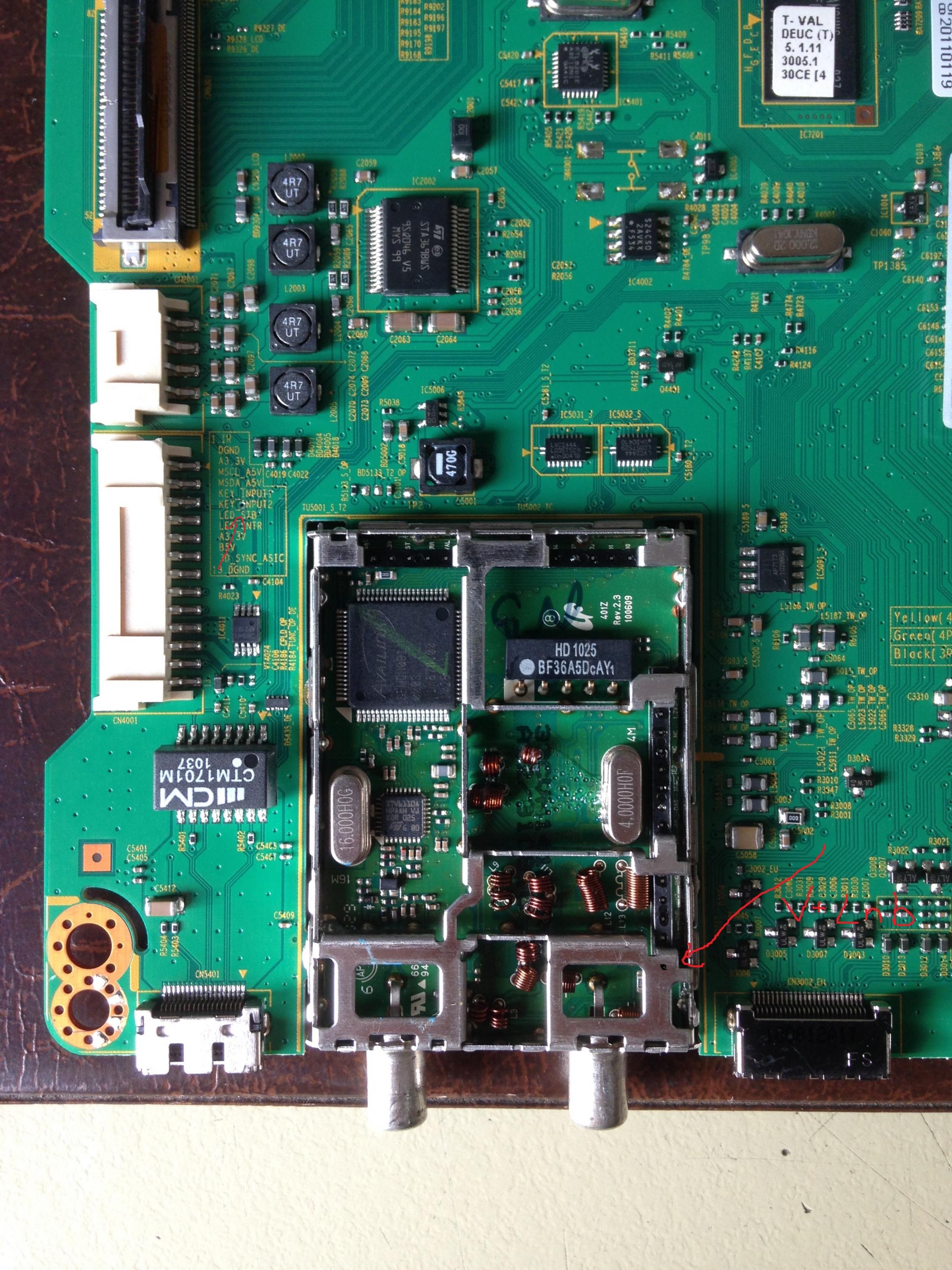

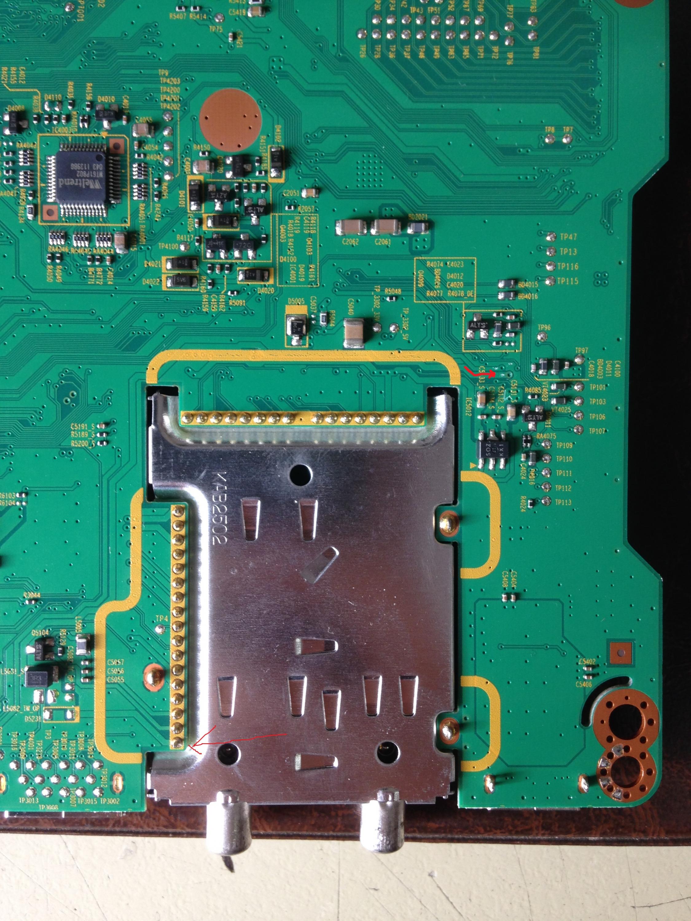

      Re: UE40S870 No LNB Power
      there are nothing connected to f-connection.
      thats right the nearest was the supply voltage pin. (0,6V)
      but i cannot track the line i lose it at the doppleprinting print.
      Do anyony know which ic is responible for the lnb supply voltage??
      and hava anyone a servicemanual?
          in the attechment some pictures
            • 31054
            that looks a slow job.
            never seen a sat tuner with those connectors before either.
              yes of course
              the print is probably a three-printed-circuit,
              without a service manual i dont came forward......
