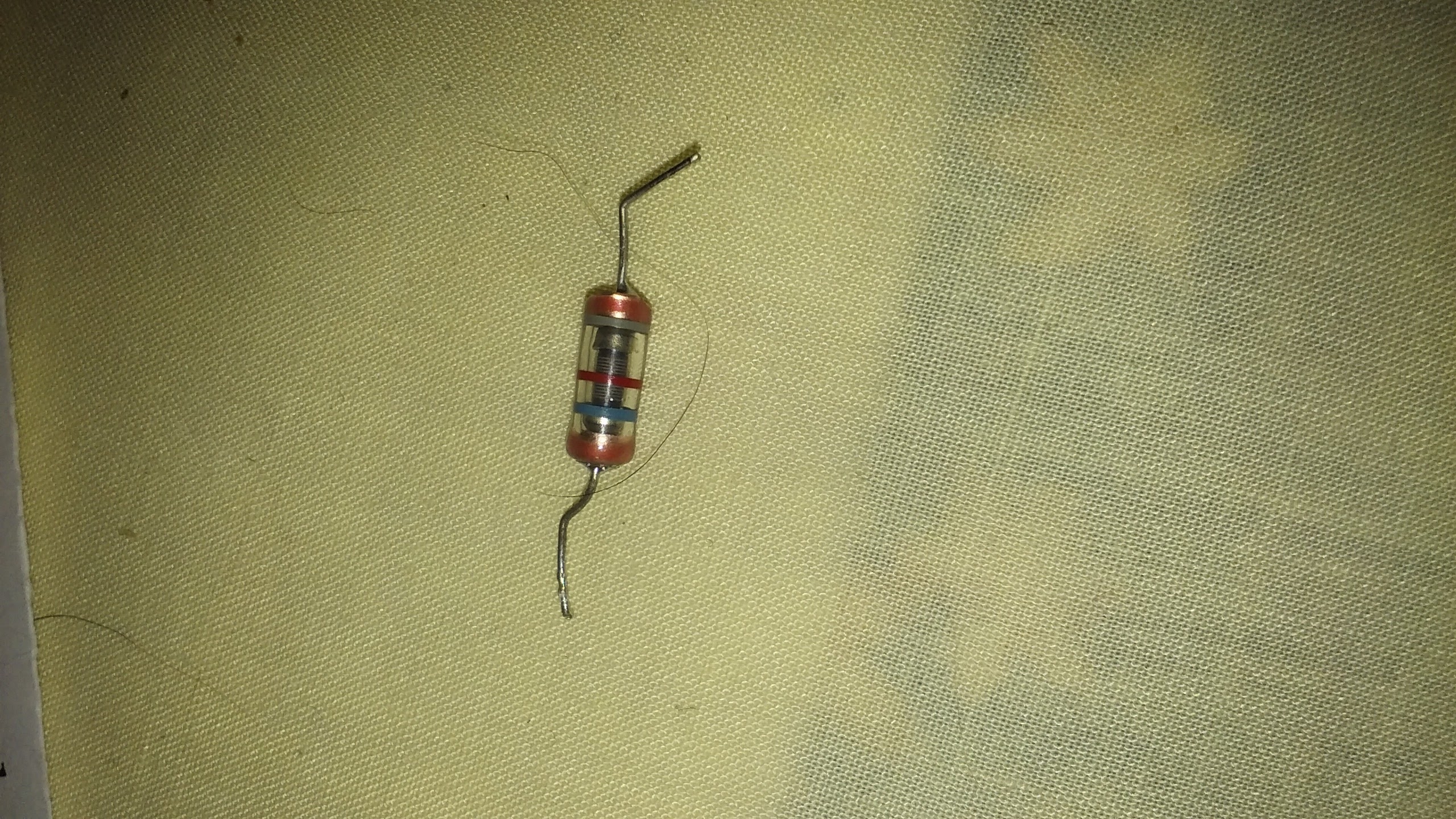

    what is this component?

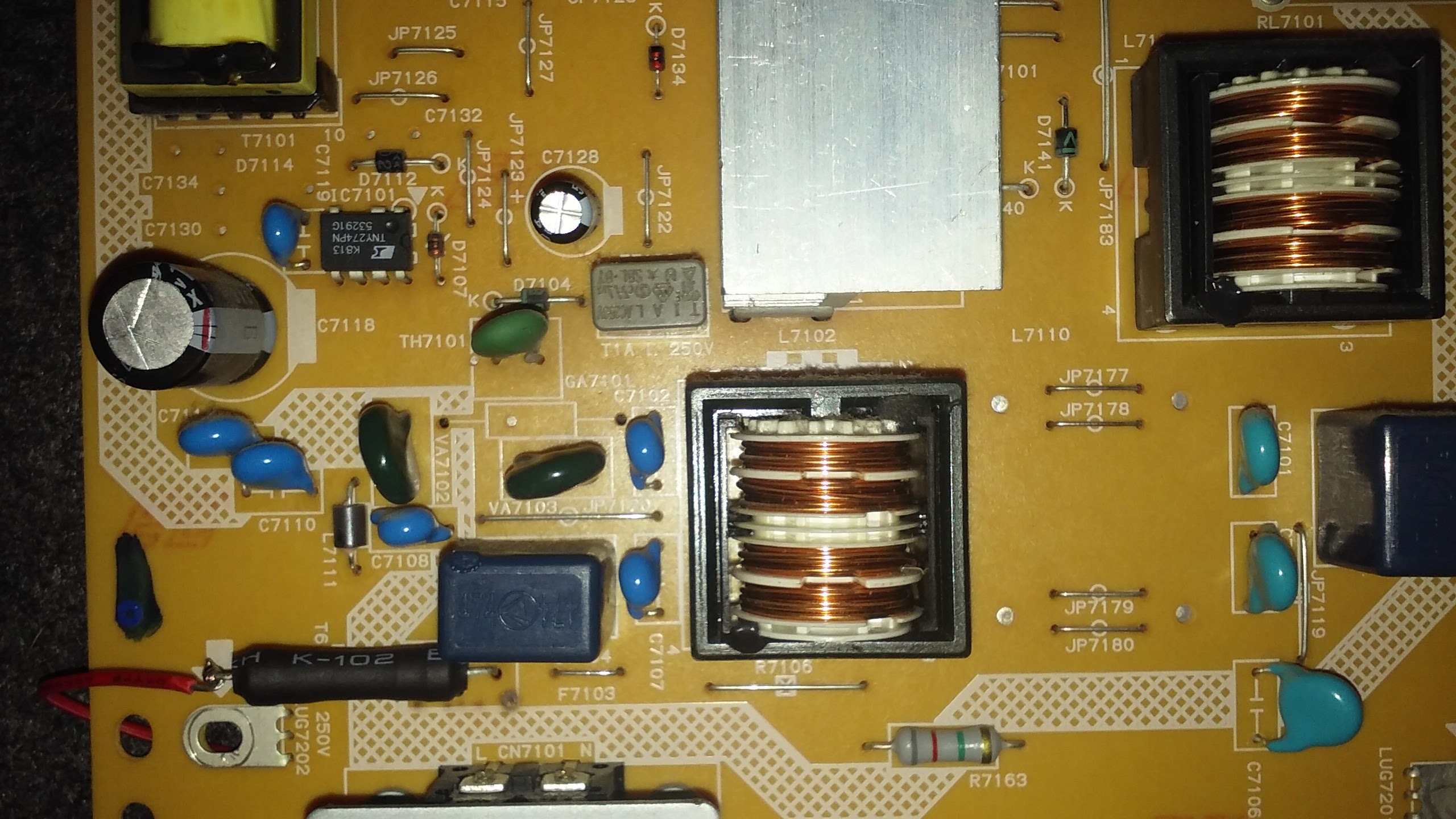

    what is this component i took it off of a power supply on a sharp tv LC-37SB24U i downloaded the service manual but it doesnt have a component list and i am not getting any voltage to the big filter capacitor this seems to be on the primary side of transformer and i am getting 150vdc from the bridge rectifier
    this component does not have any resistance at all but has bands like a resistor but it is clear it is labled c7102

    it is labeld c7102 as all the other capacitors on the board are and the only capacitor codes i can find are for 4 band capacitors not 3 so how would i go about finding a replacment

      Re: what is this component?
      It looks like a gas arrestor like this, http://www.alibaba.com/product-detai...073513344.html

        That is GA7101 Gas discharge surge protection, the circuit does not need it to operate. C7102 is the small blue disk cap next to it.
        What DCV are you not getting at the connectors in the cold side of the circuit? Please up load good clear pictures of the whole board top side and the bottom side.
