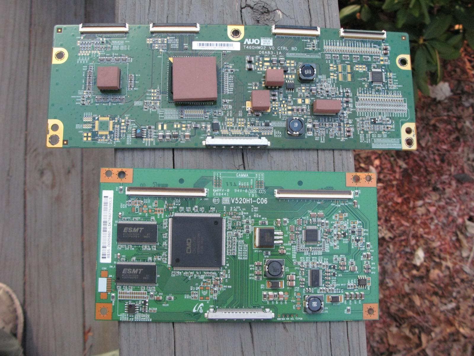

      Are these what you mean when you say "tab bond driver board"?
      I don't see any pots on them. In the photos, I left the heat sink pads on them.

        Those are the T-CON boards.
        How about the pictures of the screen shot so we can see what the pictures look like, you may have GAMMA Voltage reference problem which you can verify by checking the GAMMA Voltages at the test points on the T-CON board.

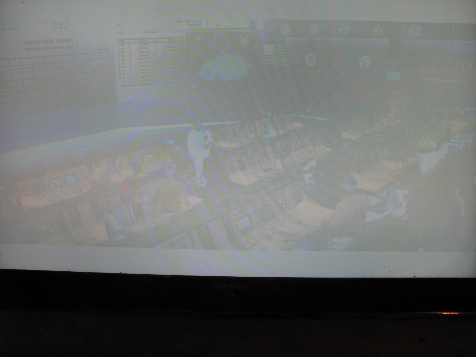

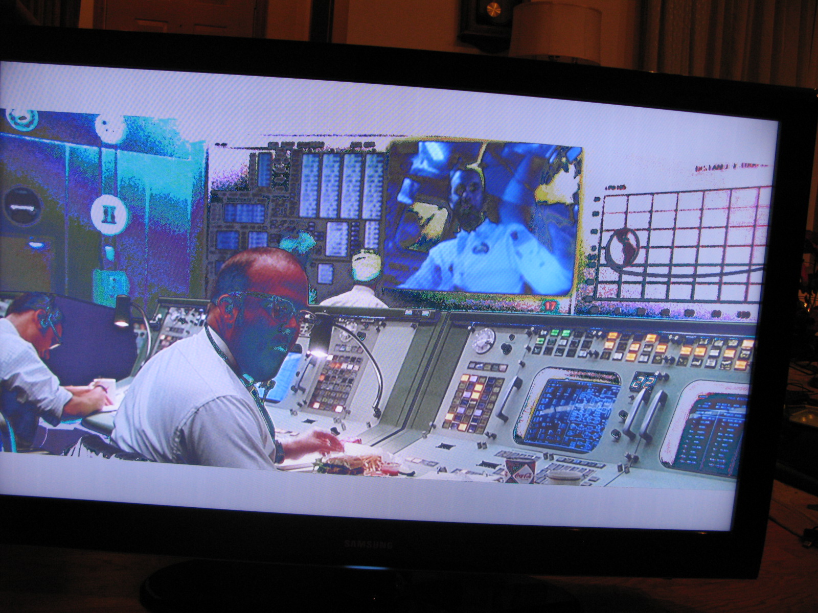

            I really have to stop hopping between projects.
            I had only turned the sets on without a picture source. Now that I used a Blu Ray disk, I see the symptoms are quite different than just a white screen.
            The first image (IMG_4696) is from the LN-T4661F.
            The second one (IMG)4695) is from the LN-46A550P3F
            Sorry about leading you on the wrong path.
              Re: Samsung LN-T4661F & LN-46A550P3F White Background
              https://www.badcaps.net/forum/attach...8&d=1454030854
              This one is more likely have bad GAMMA ref Voltage IC.
              Same for the second picture.
              You need to take the GAMMA Voltage readings.
