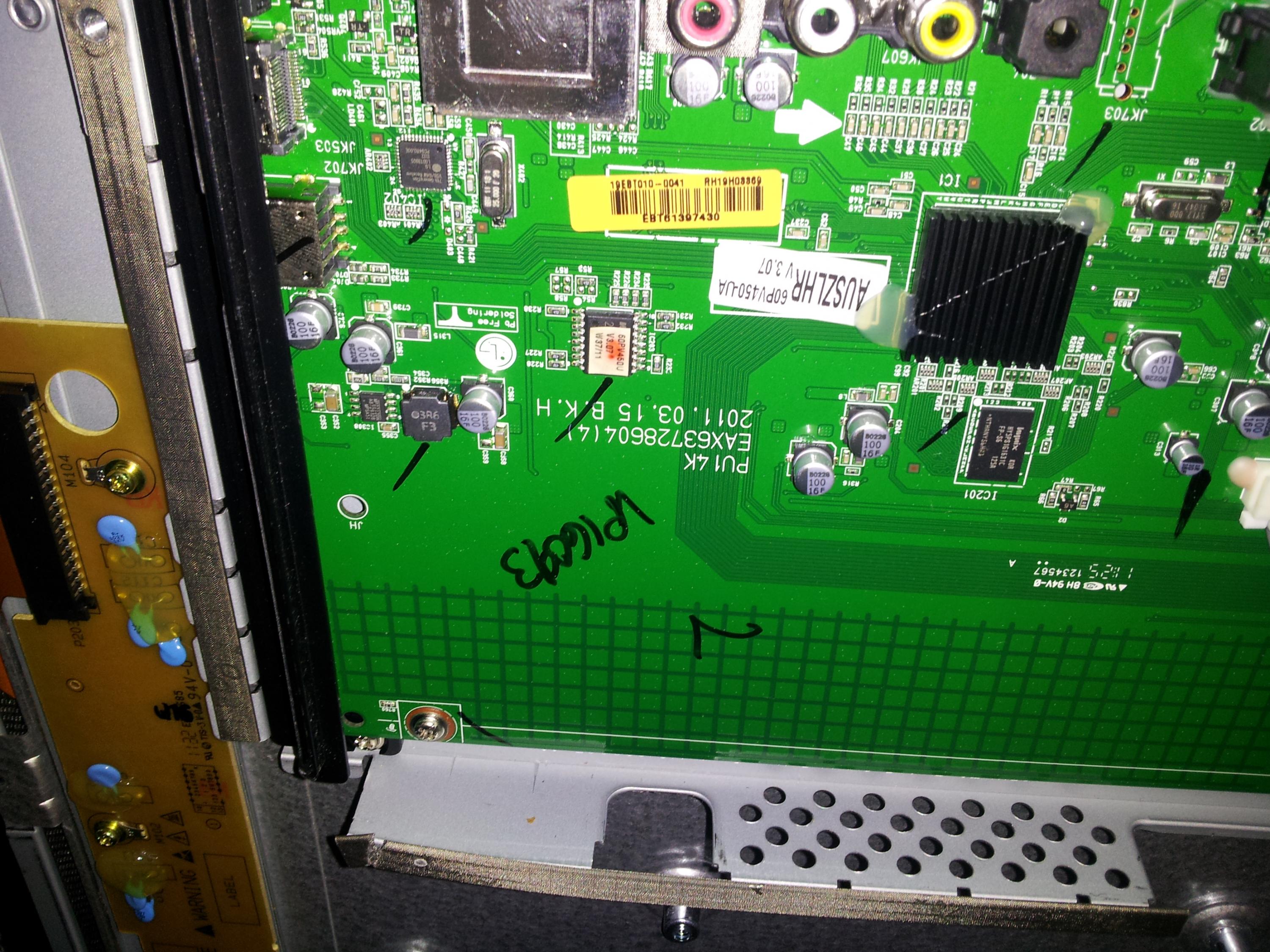

    I have a plasma tv lg 60pv450 that has a bad mainboard.
    I get great test patterns from logic board. I can not find a replacement board for mine because it it a version 2 board.
    The only difference I can see is ver. 1 has the connector in a different place and the angle of it is 45° to the right.
    Does anyone know a fault for this board or know if ver.1 will work if I can change the connector or splice in some wires to fit? Any help is welcome.
  • Nick's Tvs
    • Jan 2014
    • 621
    Re: Lg 60pv450-ua

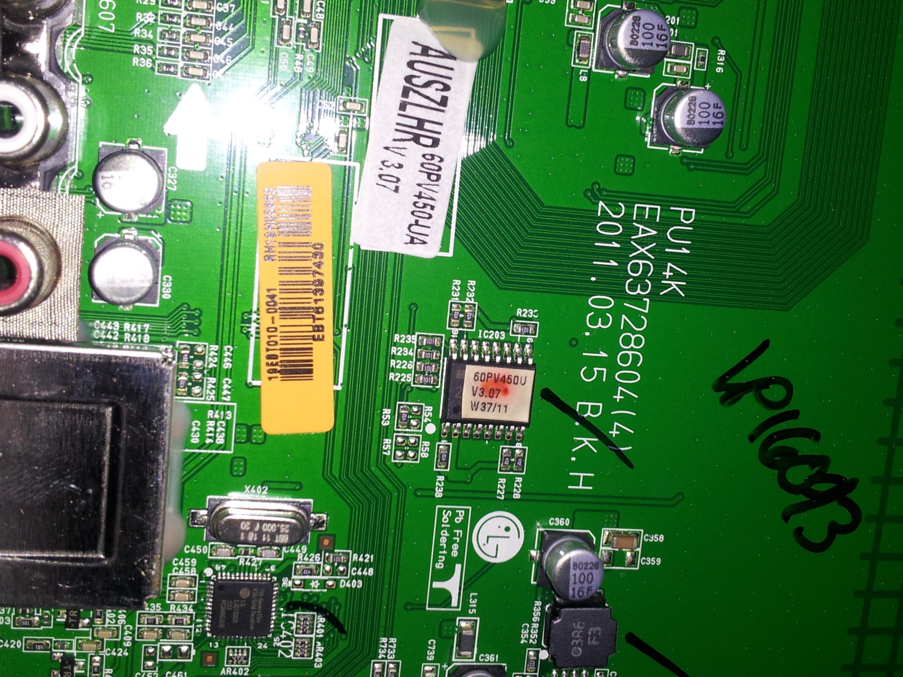

    Please let us know what the part number of your main board is. We won't be able to help you other wise. Pictures of the board would also be great. Lastly what exactly are your symptoms?
    • tvtimmy
      • Mar 2015
      • 1160
      • usa
      Re: Lg 60pv450-ua
      LG EBT61397430 Main Board for 60PV450-UA Version 2
      TV turns on with screen glow and sound. I get great test patterns, but no picture or menu. Sorry about the crappy pics, they are all I have at this time. A parts company on ebay said a version 1 main board will work. It is a $50 gamble I think Im gonna take, as I cant find a ver.2 anywhere in the world. Maybe you can help with this one? Advice or maybe a lead to the correct one?

          Re: Lg 60pv450-ua
          Tv doctors was right! The version 1 mainboard works great.
          $10 for the tv, $50 for the mainboard, a dollar an inch is awesome!!
