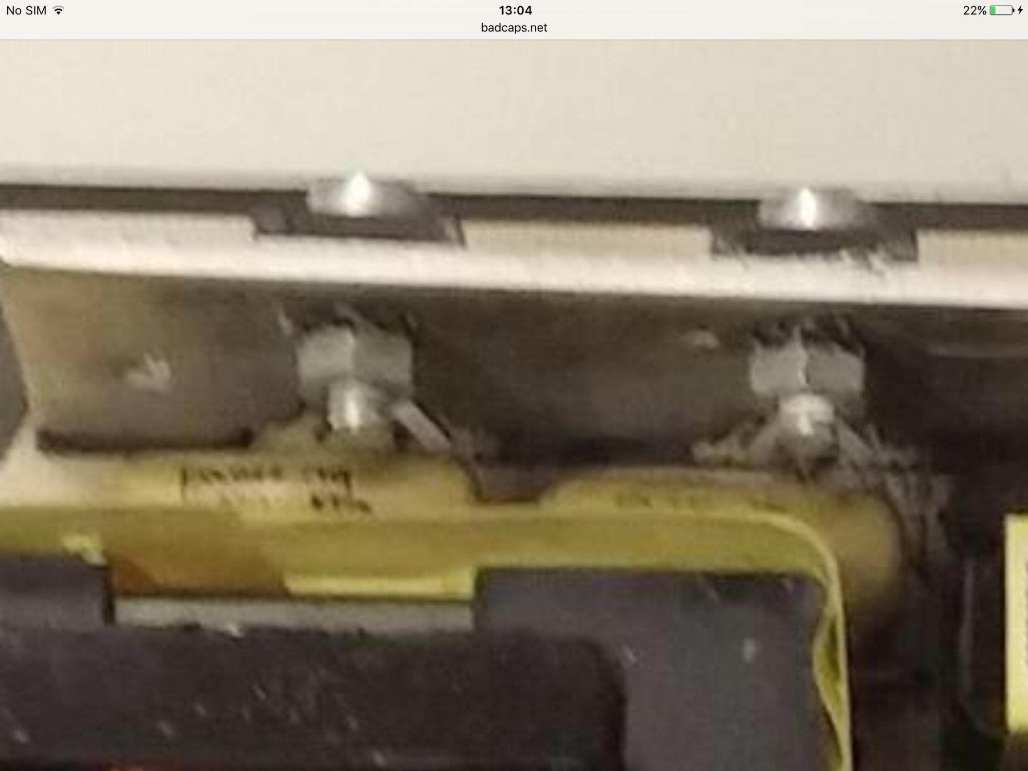

            This is just my opinion and it could be a faulty regulator etc but I'am wondering if you've gone over the power supply board and checked the soldering connections bec it sure sounds like either a bad cap or a bad connection or a combo of both.The caps that you replaced did you use Low ESR good quality caps? Dis you check the other parts that are connected to any known bad caps that you have changed? Did you change all the caps close to the heatsinks? When you double check the board be sure to look at all the hot spots very closely.When the set kicks off if you let the set sit unplugged for awhile does it start up and perhaps work longer?Again from what you're mentioning it could be a cap that is not holding it's charge properly or a solder connection that is disconnecting itself after it gets hot etc.Don't forget to check the regulator connections too.

                Checked the Polly caps above the transformer ?

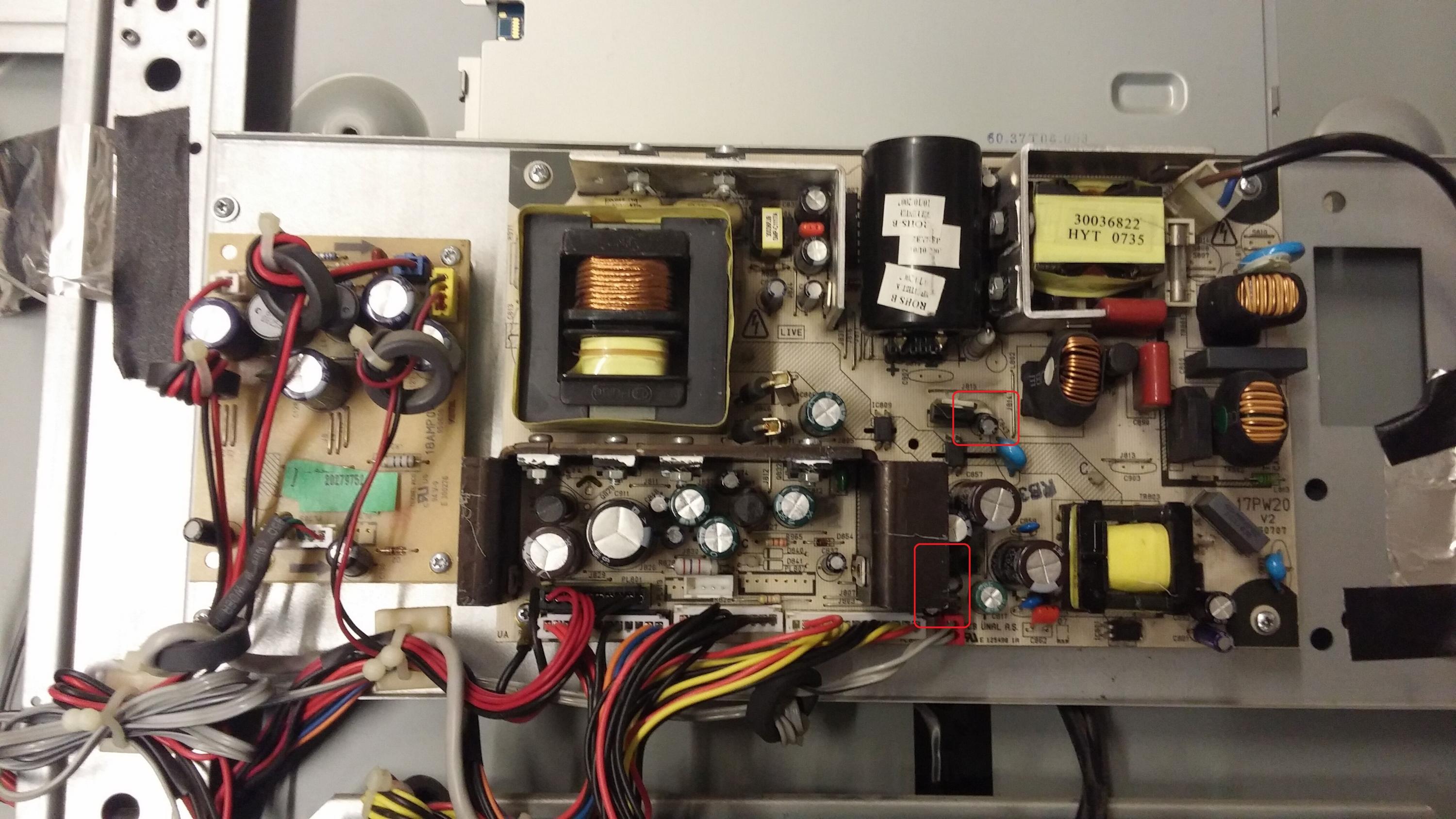

                  I had a similar faulty power supply and it was one of the smaller electroytic capacitors but I cannot remember which one. Check the ones that I have highlighted. It had gone high ESR approximately 17 ohms.

                    You need to check the Poly caps at the top of the Psu as imaged, they can cause this issue:

                      think it are the poly caps,but till monday nothing,gota buy them
                      thx for now
                      write back when i change the capacitors

                        Changed both electrolytic and the poly ...
                        the tv works for 50-60 minutes and goes to stanby...
                        when i try to turn it back on it goes to stanby at once
