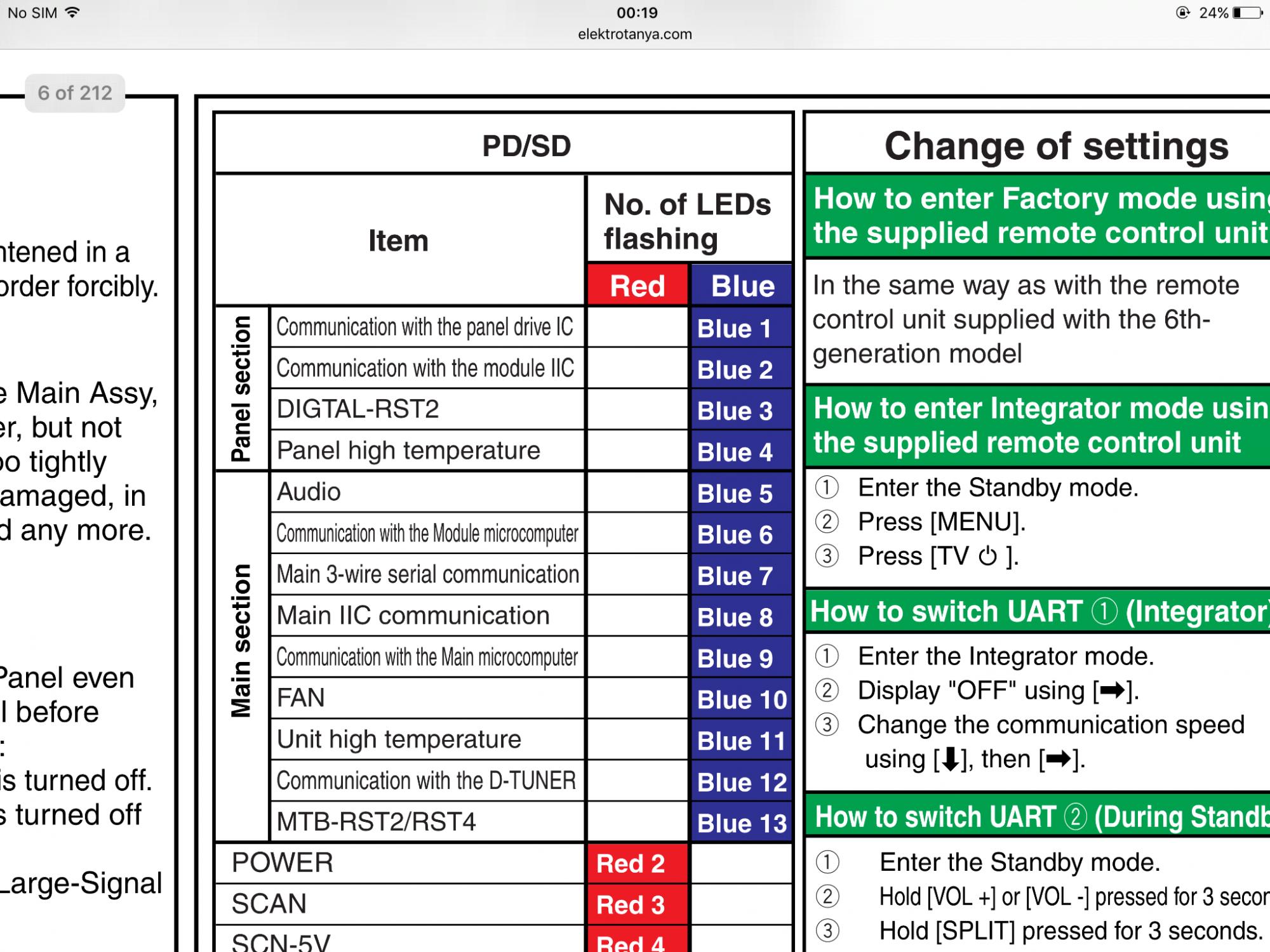

    Need to get a serial wire on order lol or get one when I next go Maplin. In the mean time does any one have any info on the 7 blue blink error ?

      Any ideas chaps ? Got a serial cable on order to see if I can run the service menu. All main voltages present until shutdown.

        I got an Rs232 but cant seem to get into the Sm on this one. From what I read the Mb appears to be at fault.

          Will be giving this a go soon, definitely a mainboard fault but I will need to fix it as I cant find a replacement just short of time atm.

            Are you using an usb to serial converter so it can run from a laptop. I have found that although they work 90% of the time, on connecting to some serial ports they do not work because the output voltages from the converter is to low.
            Sometimes there's confusion over the Tx/Rx pins so it may be worth crossing those pins and try again.

                          Long due update, the set was repaired by replacing the main board still alive till this day under practically 24/7 use.
