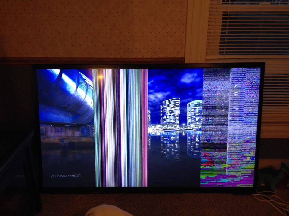

    i have a sharp 70'' i bought 3 years ago and developed this issue recently. I bought a used T-con board on ebay but when i put that one in the vertical line were all across the tv. Any input would help...thanks...the model number on the tv is LC-70LE745U

    Failed Lcd Panel not fixable sorry. Try pressing on the Tab bond see if that helps but likely your COF driver for that section of the screen is toast which isnt fixable.

      That really sucks. these tv's dont seem to last long.I paid over 2 grand for this so hopefully i can sell it for parts. thanks so much for your
      quick response.

        im going to try to take the tv apart tonight and press on the tab bonds to see if that helps. I dont want to give up on this tv so soon.

          As Reecey said. Try pressing on the tabs to see if it disappears.
