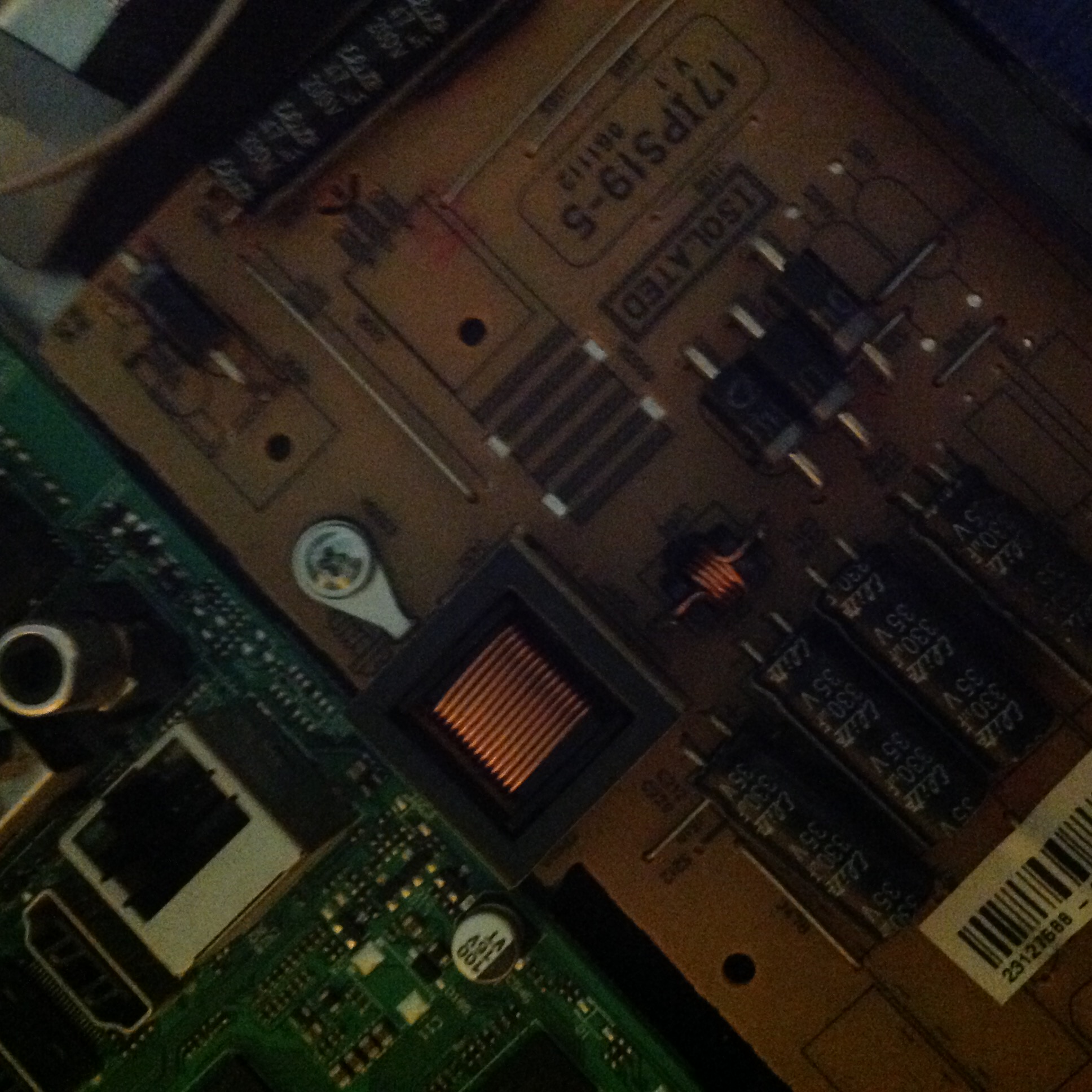

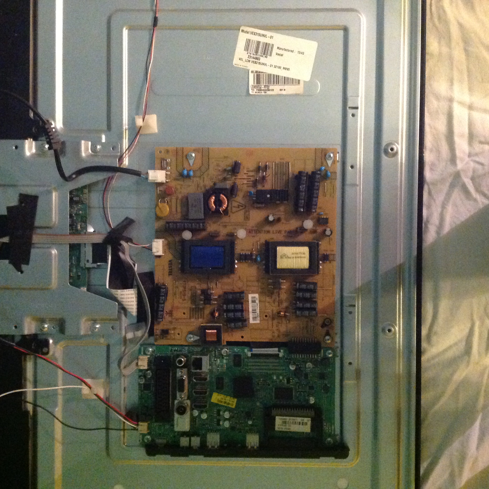

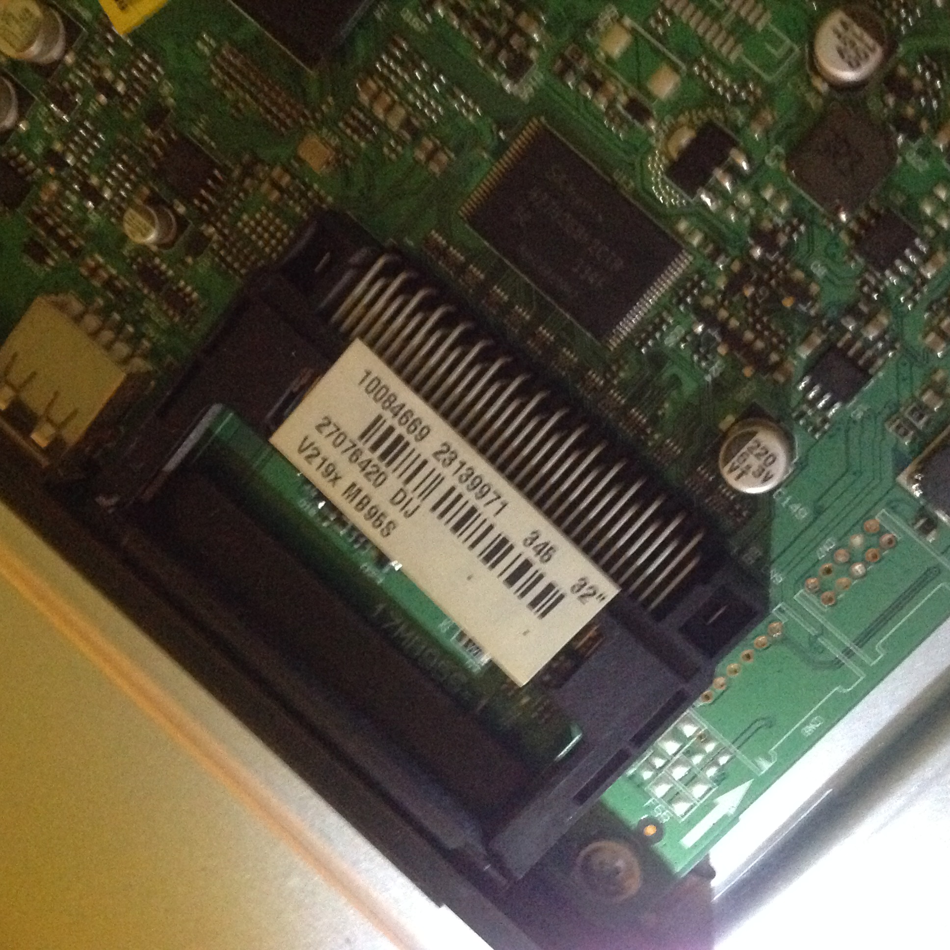

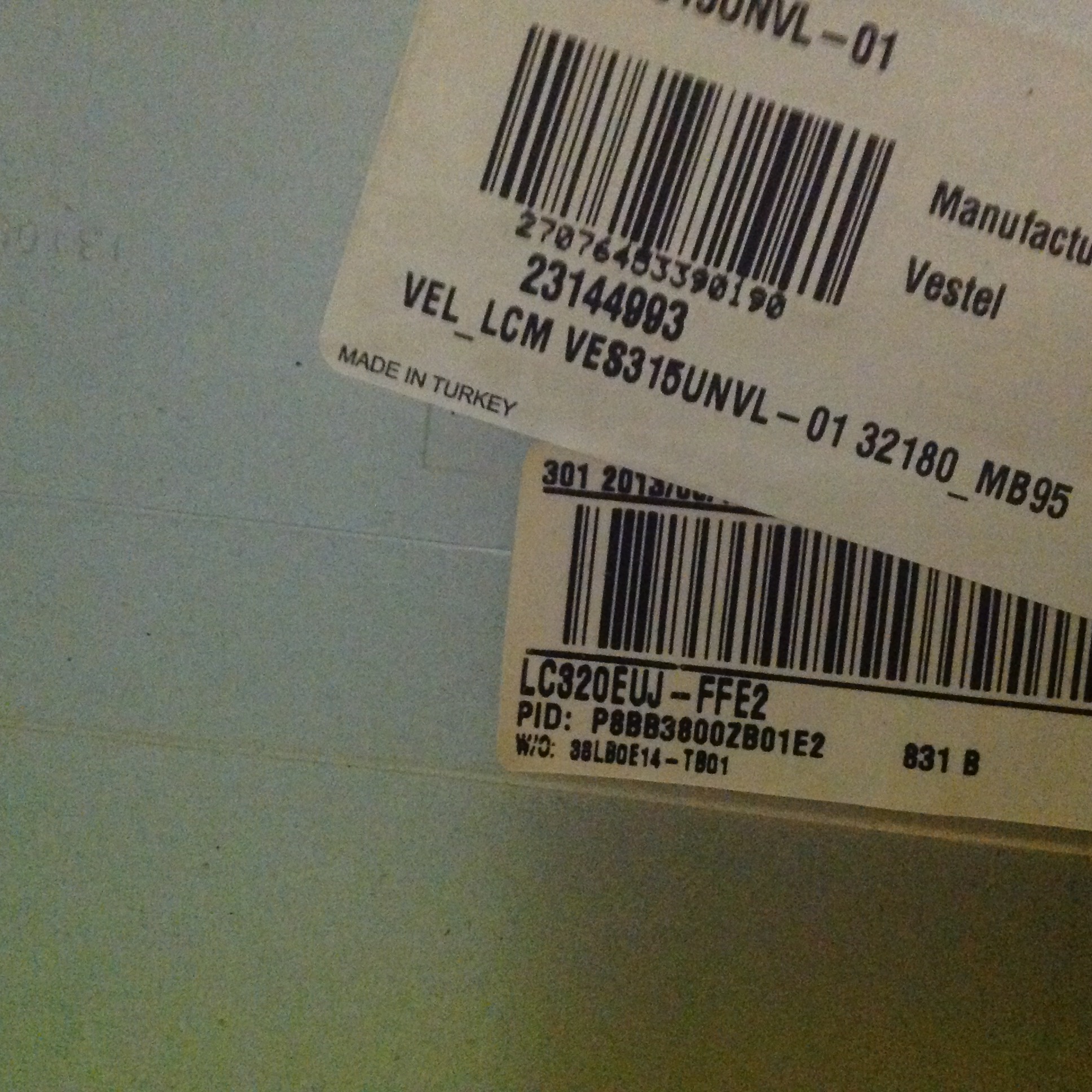

    Wow got this 32" Led crap Tv in a few days ago, all working fine owners replaced it with a bigger 50" Polaroid..... Yes another Vestel crap in their 9 year old sons room. This is a JVC LT-32TW51J 32" rebadged Vestel Smart Tv. Normally these fail with under 2000 hours in most others I have repaired. This set uses:
    17IPS19-5
    17MB95-1
    VES315WNDL-01 Led Panel based off a AUO glass
    Ves Rev0 94V 11 Led strips (two in panel so 22 Leds in total to light the screen)
    This Tv is a piece of junk, but not been previously repaired or serviced, owners kept backlight on low (reduces risk of Leds burning out) and kept Tv on for hours at a time, believe it or not keeping these on for hours reduces the risk of Psu diode failure and mainboard firmware failure. Surprised that the Lcd screen is still good as its a POS normally fails after about 5000 hours (seen two previous Lcd screens in these fail in just over 5000) but wow over 9000 hours with in 2 1/2 years of use thats some serious Tv watching. Still this thing is a POS and will probably fail soon so I replaced the diodes and reloaded the firmware from fresh just incase, but hey just thought I would let you know that these Tvs can actually live over 2000 hours with out having to be repaired

      Hmm strange, Leds do have high failure rates early on in life this one must have been a lucky one. Also what they do is Vestel source the glass and driver board from Lg or who ever then they assemble and bond the glass themselves which saves them money but the rest of the module (Led, Panel and diffusers) are Vestel, they dont have an Lcd production factory so cheaper to source the glass separate.

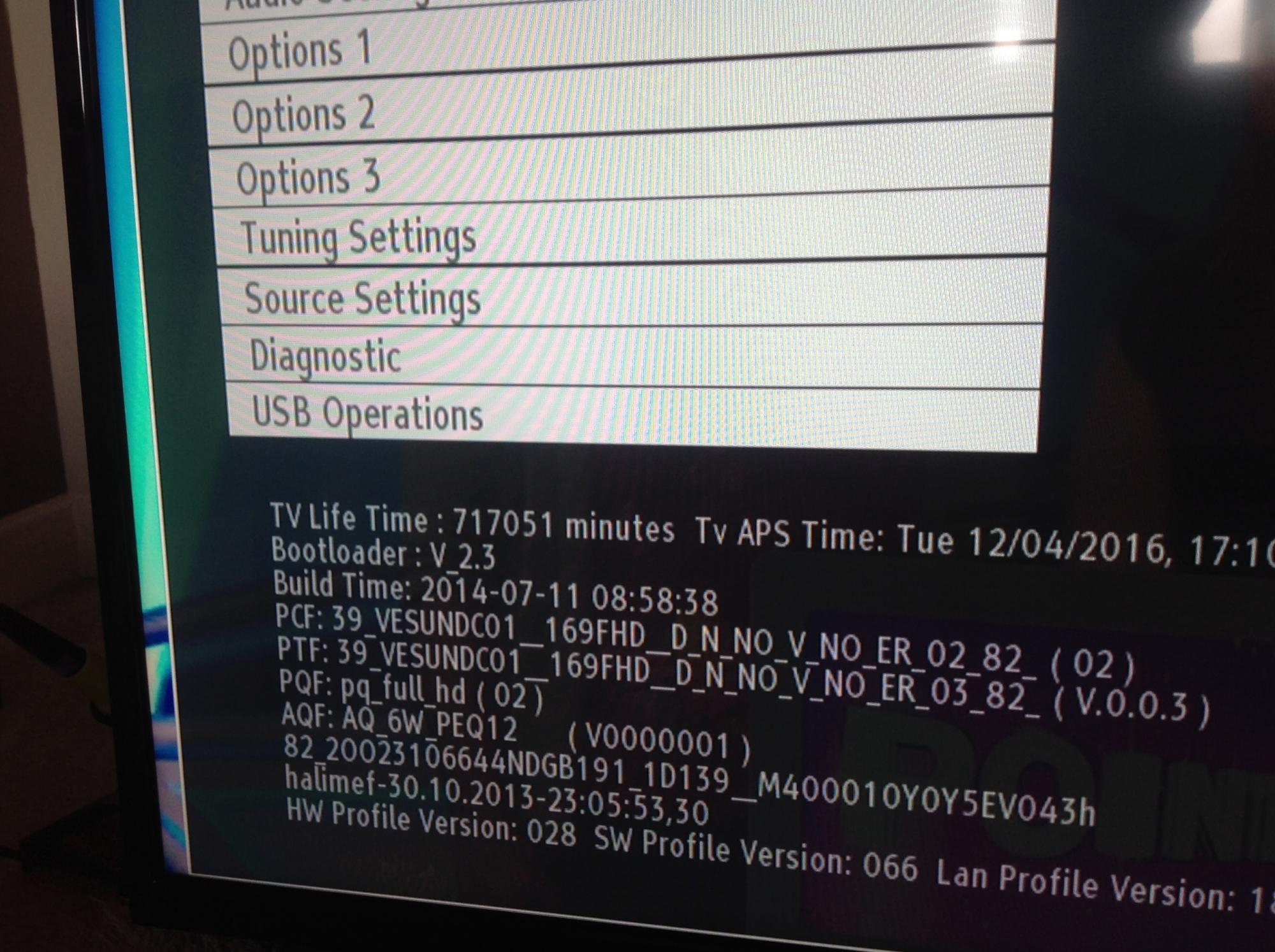

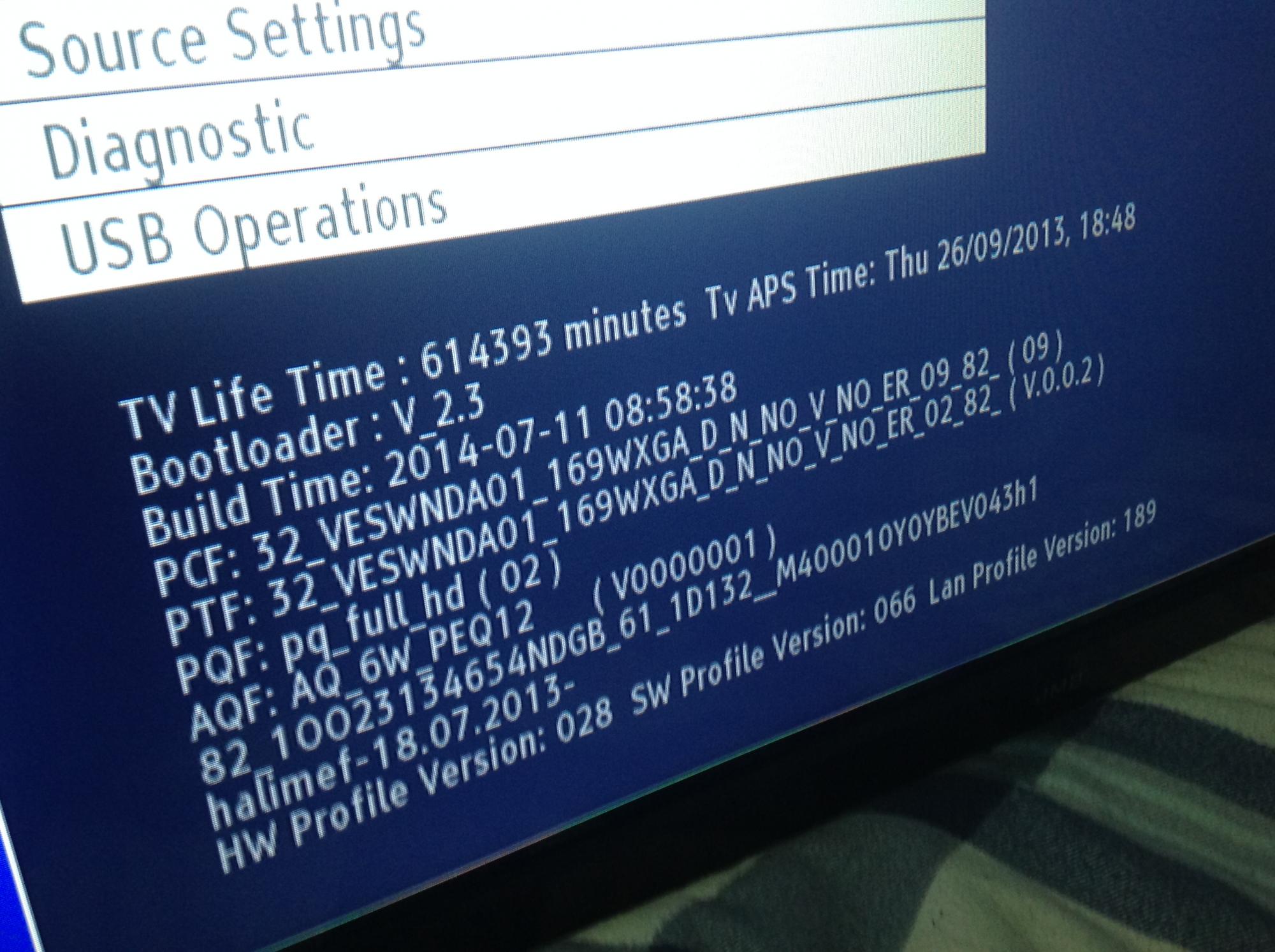

              Well we have a new winner here for the Ves315WNDA series screen ! JMB 32" with 10239 hours on it, backlight on max caused one bulb to pop but wow 10000 hours on a Ves315 panel and it only just failed, uses AUO glass an usual Ves315 22 Led type 0.2 strips. New record for such a shit Tv !

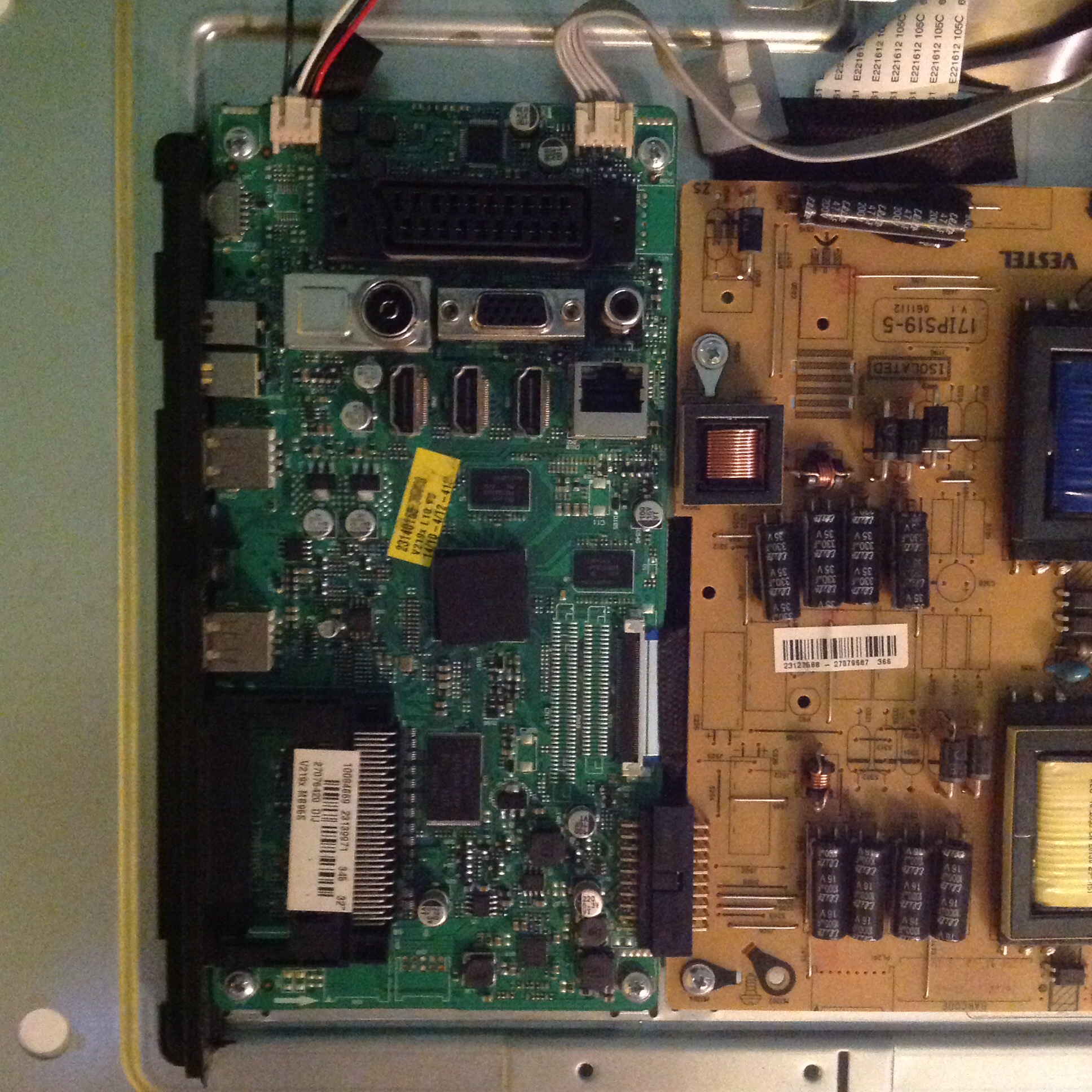

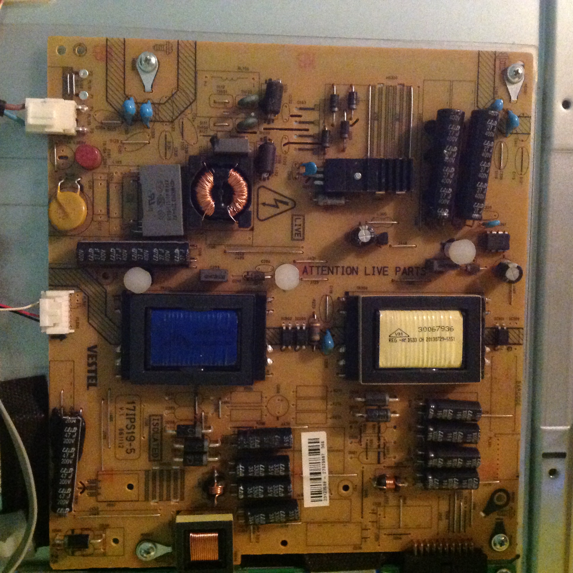

                          I have a problem with Quadro Tv 32" "LED SMART 32HN90. Turn on the TV to the power supply, the red light appears but will not play the channels with the remote and no button on the side.
                          This set uses:
                          power supply model : VESTEL 17IPS19-5 V.1 061112 barcode 23128588
                          motherboard model : VESTEL 17MB95S V219x 27076720 DIJ
                          Panel : VES315UNVL-01
                          Attached are pictures I please for help
