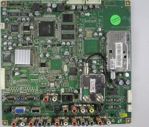

    I have a Samsung HPS5053X/XAA. It has a M.B. BN41-00694B.
    When I look up that number is always shows its for Samsung
    HPS4253 TV. They physically look the same. Will this board work if there is a menu option on set up for a larger screen size? I know it can be done on some LG TV sets.

    Yes it can be on these.

      The number you should be tracking is the white barcode sticker affixed to your tuner module BN94-00925B not BN41-00694B as that sounds like it's the PCB board blank number so yes they will use the same PCB but put different parts most likely the eeprom data loaded onto the board.
      SJ Also says BN94-00925A, BN94-00925C, BN94-00971A, BN94-00971B, BN94-00971C are substitutes.
      You would have to read up from the service manuals what serv menus are adjustable but i have my doubts otherwise why would they have so many versions if they could use the same board for either size/

        Most Samsung boards can be used with different screen sizes....
        Ive on occasion used a 40" LCD Mainboard--In a 42" Plasma set, just changed the screen type in the eng menu....

          Ok thanks guys.
