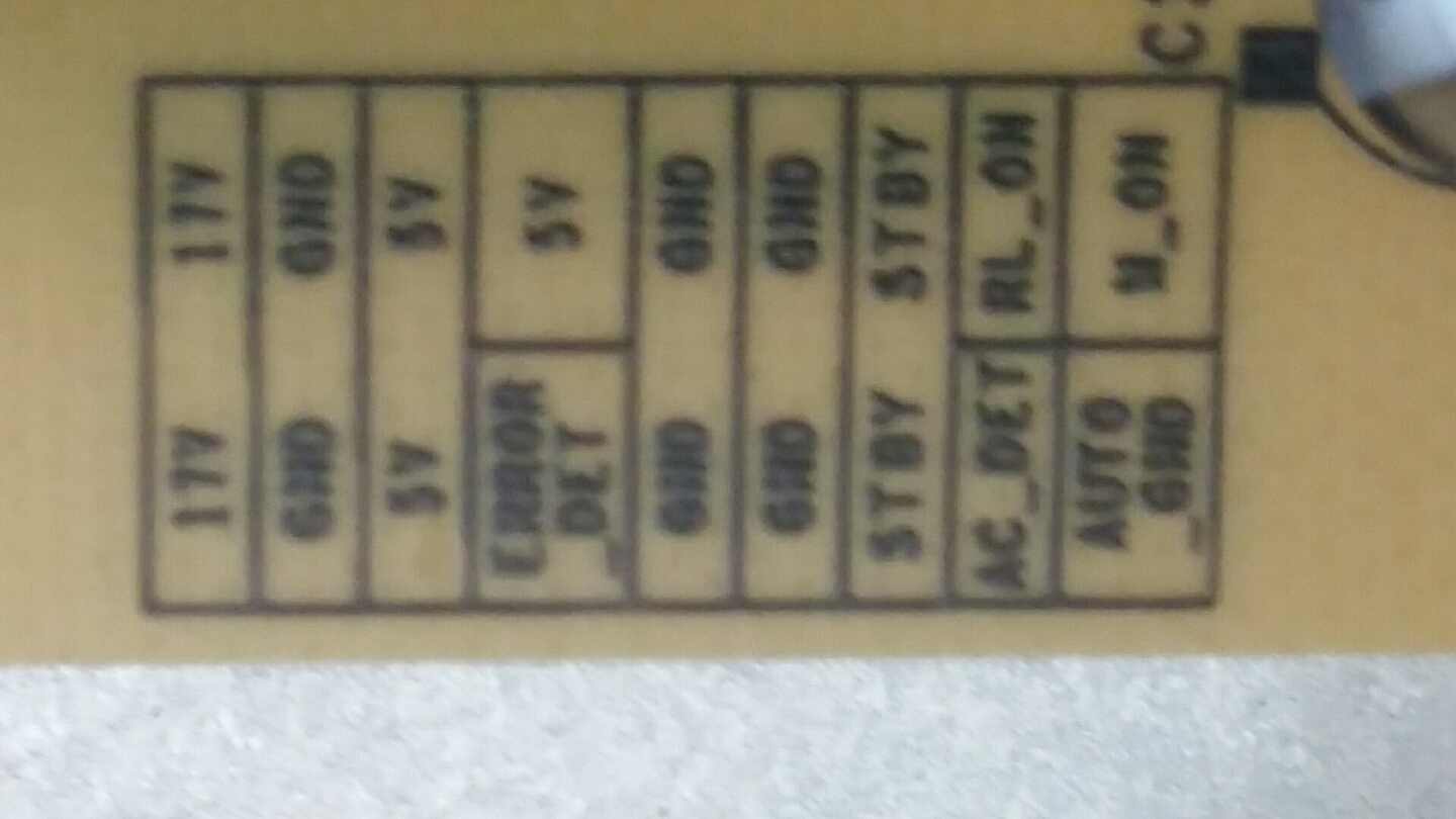

    It's not going to turn on without the main board connected.
    The mainboard sends the RL-ON and M-ON signal to the power supply.
    With a resistor (100ohm) connect RL-ON to 5vstby.
    What voltage do you get at VS and VA?

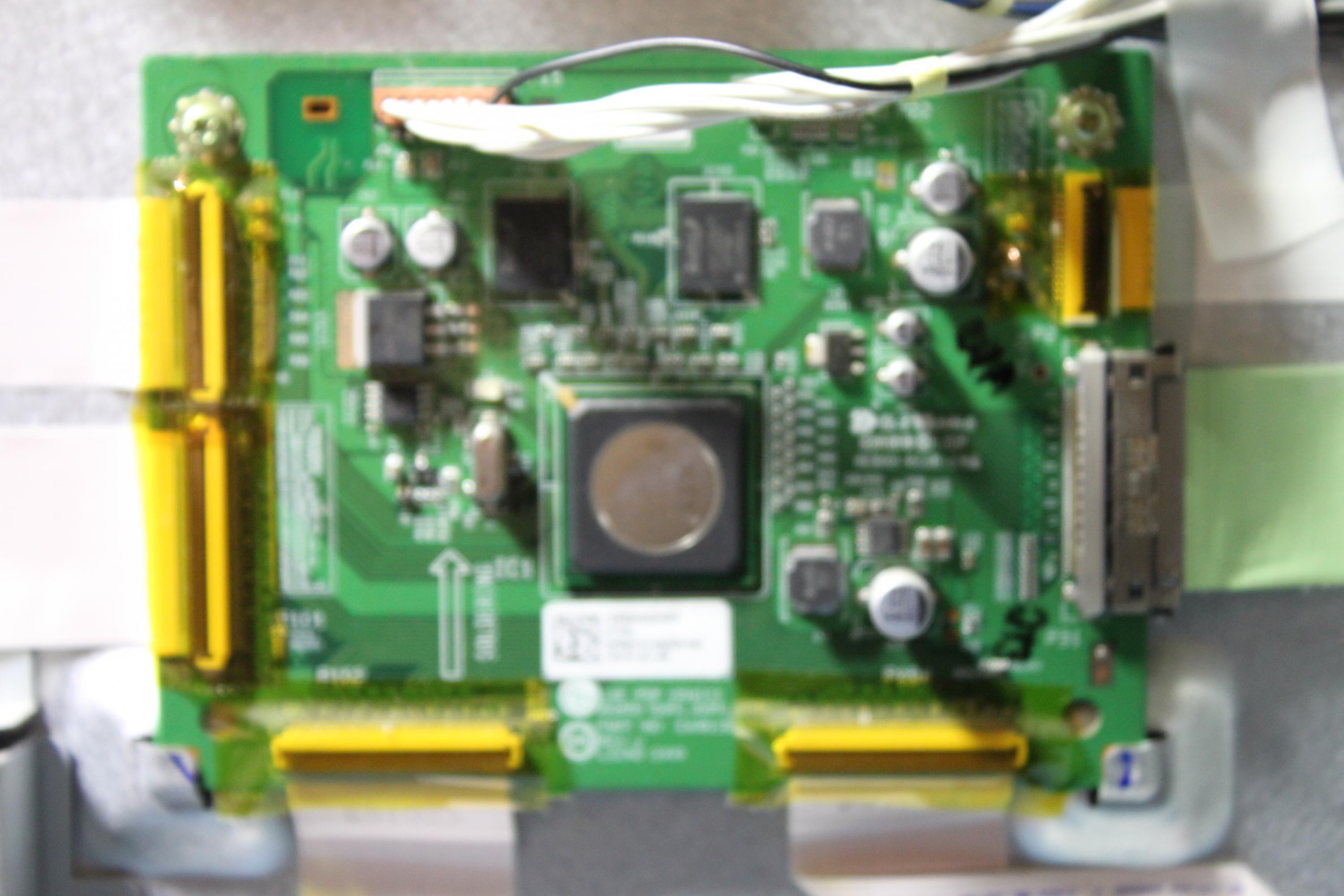

          Ok so leave the resistor in place just now.
          Disconnect the LVDS cable that connects the Main AV Board to the Control Board (t-con).
          Now with a paper clip or piece of wire connect the 2 holes on the control board marked EXT_AUTO_GEN
          If it's not marked, it's usually 2 holes beside R51 and R52, or R501 R502.
          Your picture isn't of good quaility but I think the 2 holes are located here:
          Plug in the tv, it should now power on and display test patterns.
          Does it?

            Good morning. I am more awake now. Ok, you are right, vs 200 and va 59. The issue is that i get that without having the resistor put on but in both cases with it on or off the voltage drop. still hear the two click. The test that you mention i already did it last night and nothing happen, still hear the two click sound. in the first click the tv will start and you can see a white screen immediately it click again, it turn off. It will not stay on.

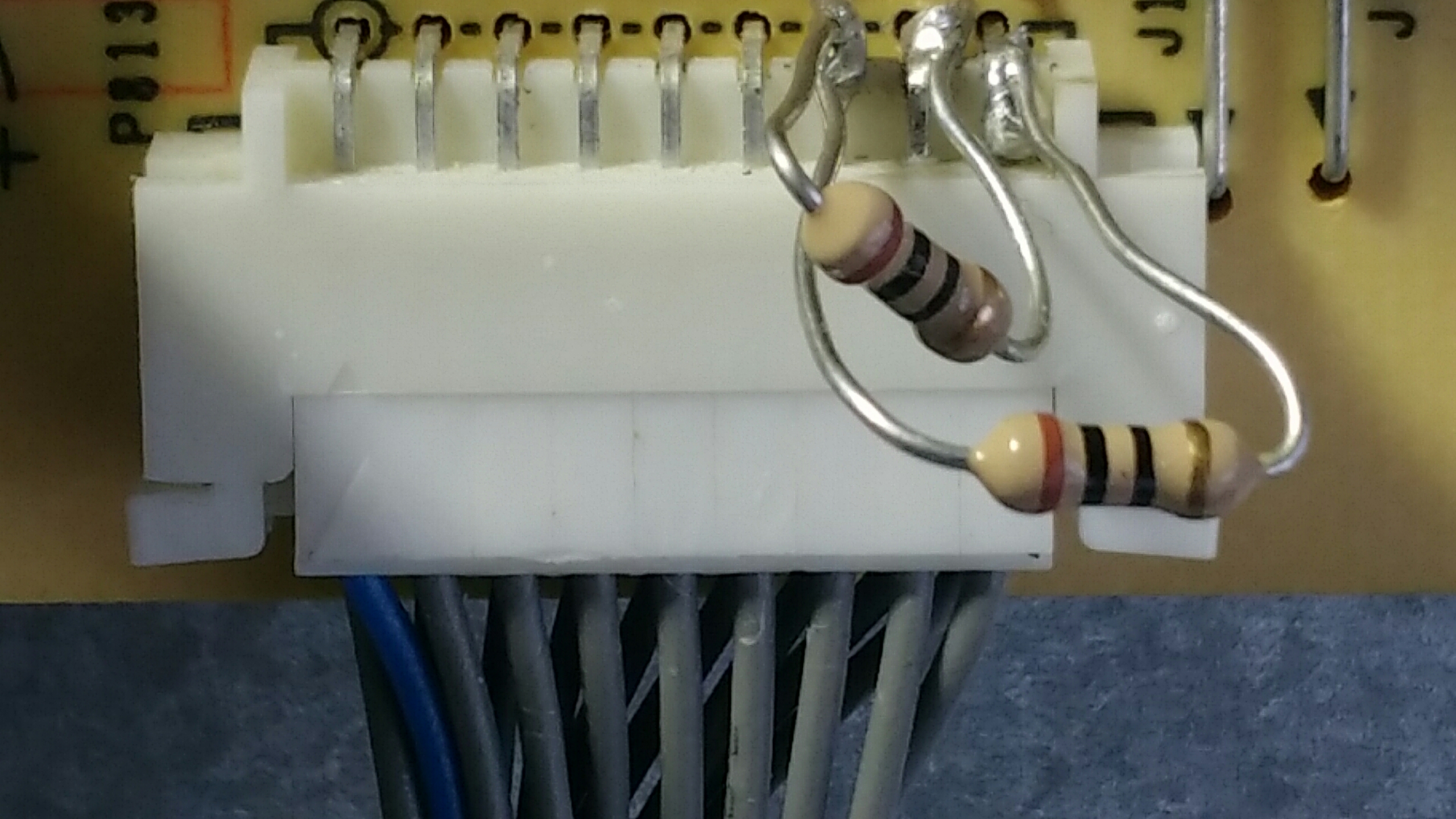

                    If you link up 5vstby to RL-ON
                    And also 5vstby to M-ON
                    Do the voltages stay up?

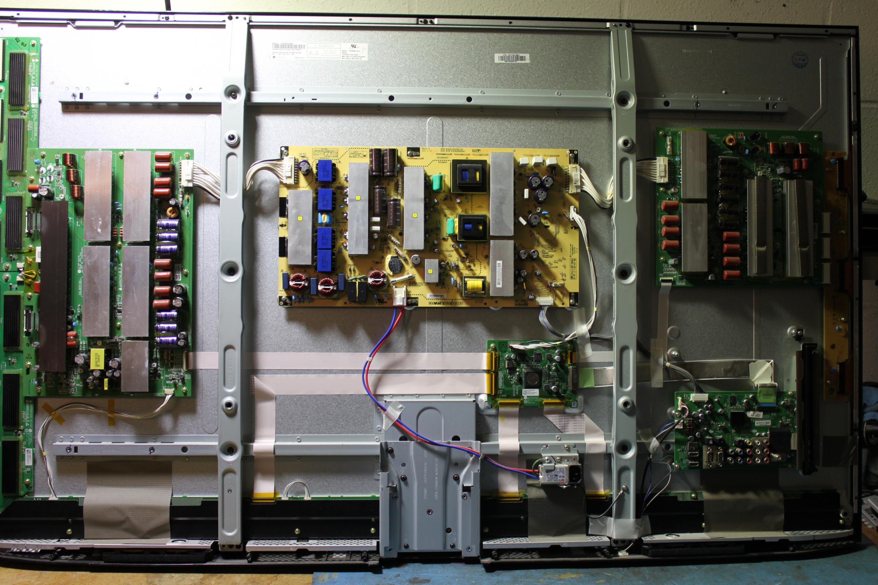

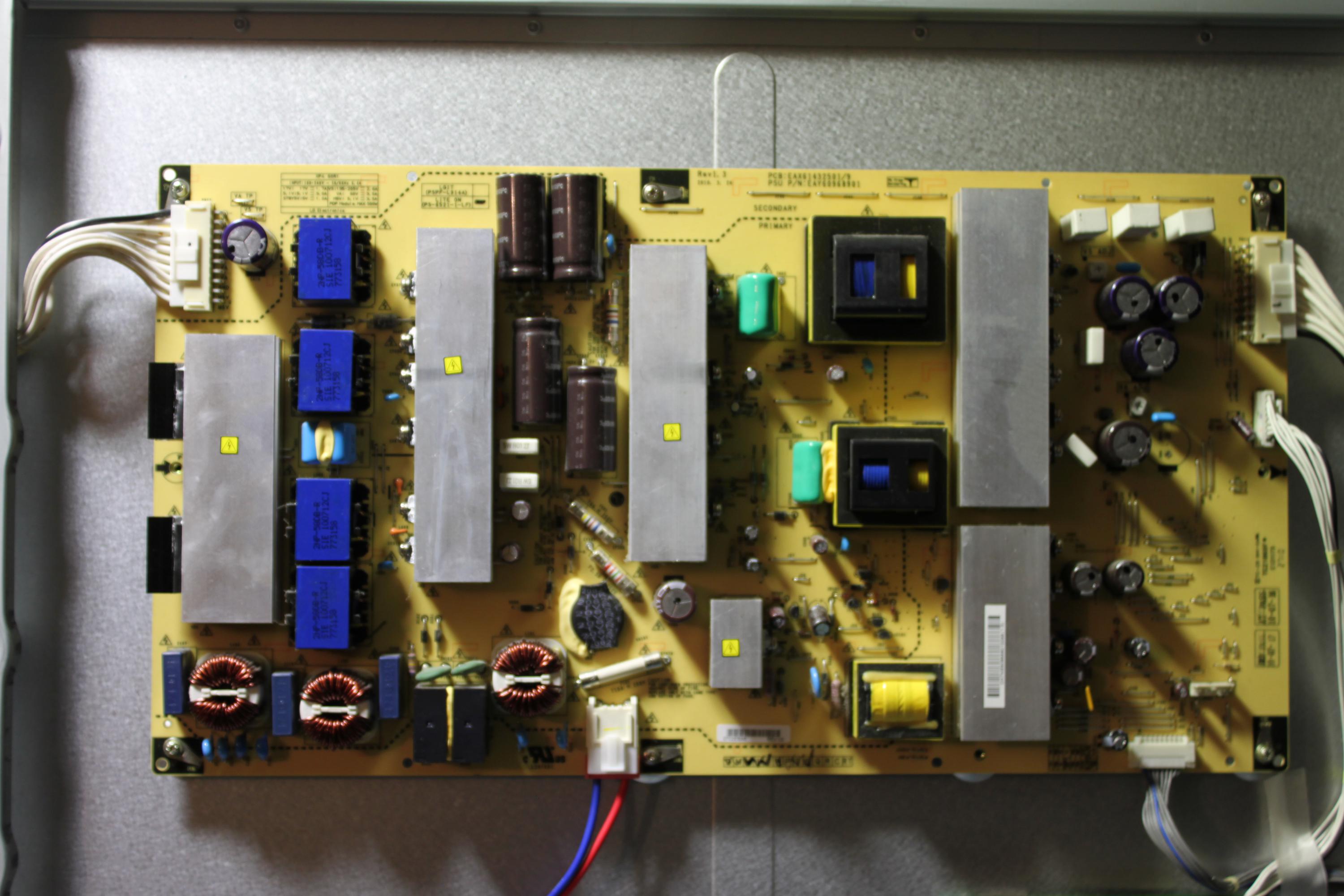

                        I did as you said. I put the two resistor 5vstby to RL-ON and 5stby to M-ON but still wont stay on. I am going to take a picture of the power supply back and front to see if you can see something that i may be missing

                          Re: LG 60pk550 turning on and off
                          I did check the solders again and i just can't find anything suspicious
                            I take it that with the jumpers in place you have unplugged it at the mainboard end?
                            It's a strange way that you have done that.
                            I would have put the resistors in more like this.

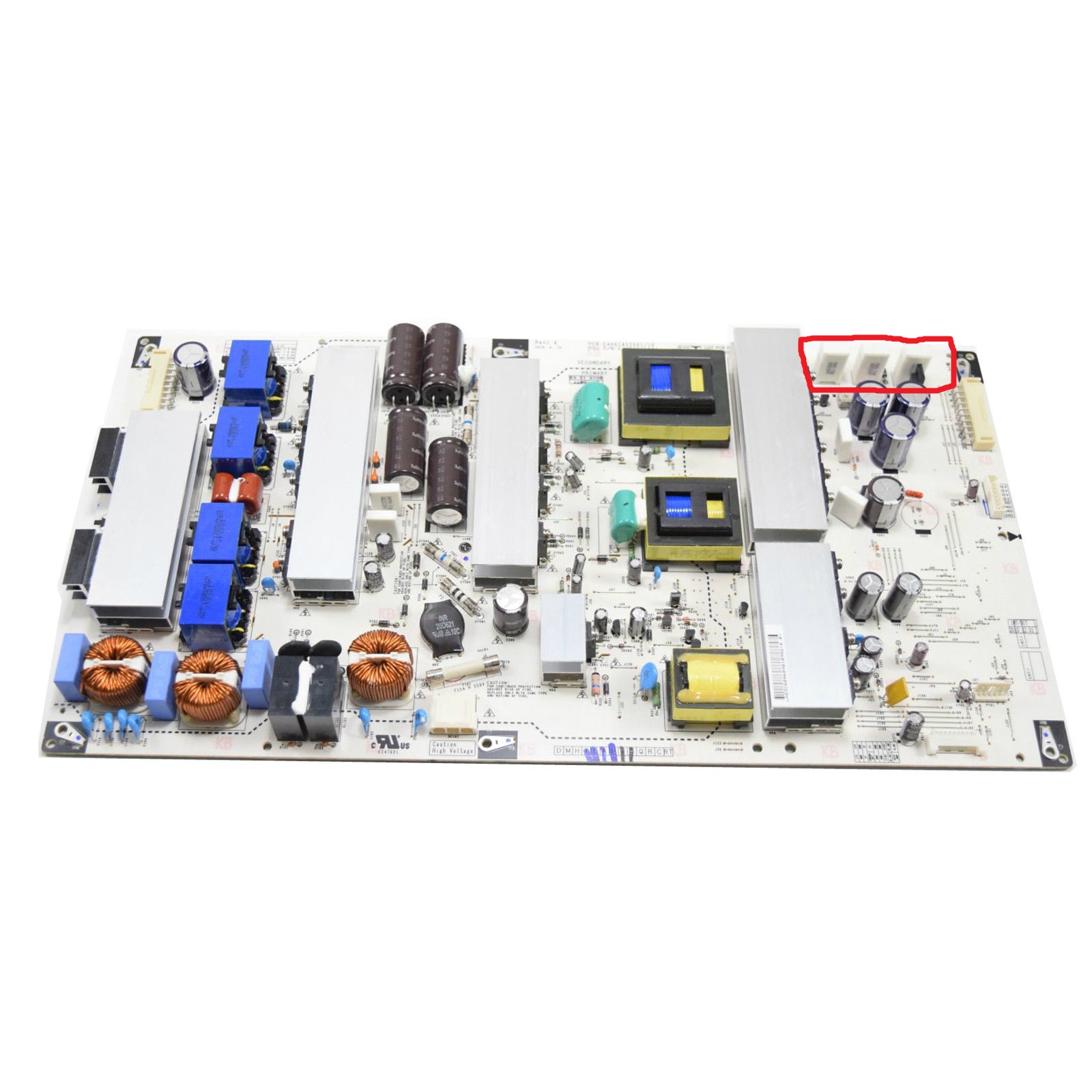

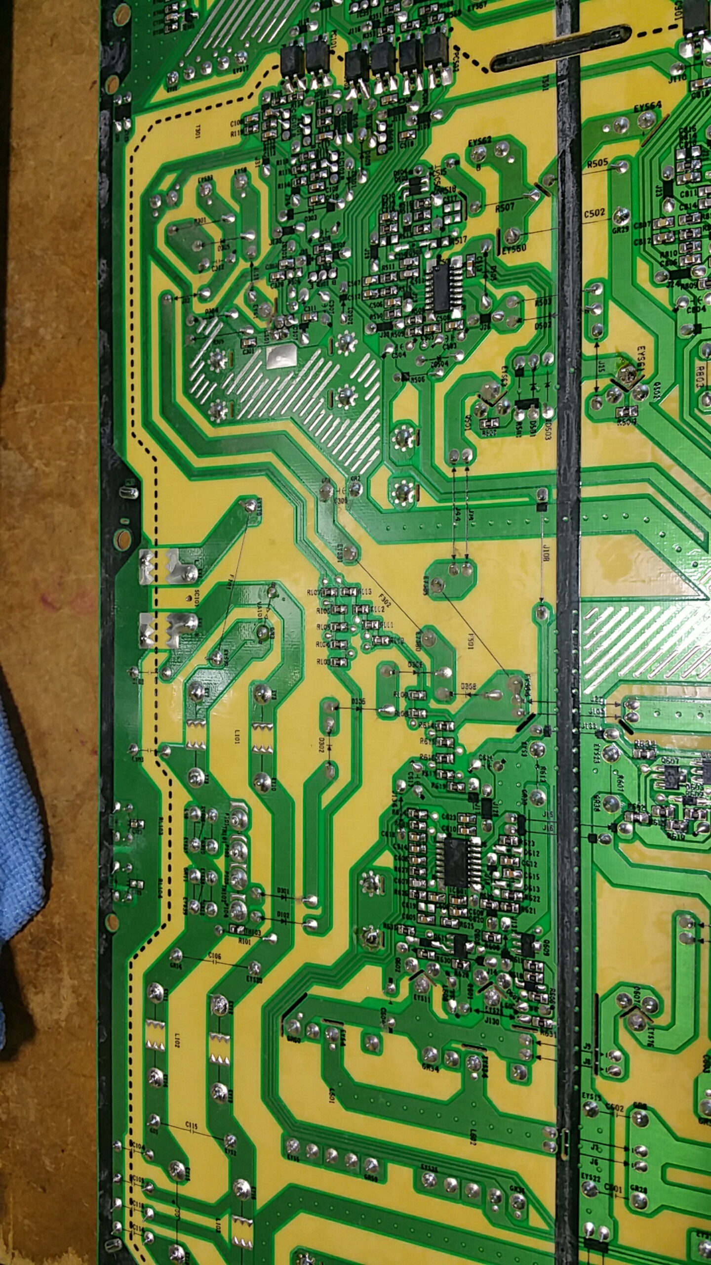

                                the problem is your power supply isn't staying on.
                                I can only give you advice but really finding the problem will be down to your own fault finding ability.
                                Check and make sure that all voltages going to the main AV board are present (17v etc) and not fluctuating.
                                Reflow all joints on parts attached to heatsinks. Resolder transformers and coils.
                                The 50" versions of these Tvs suffer from either one of the 3 wirewound resistors failing (located in top right of the power supply.) test them and make sure they are in spec.
                                It could be a faulty regulator, these can sometimes be easily found with a can of compressed air turned upside down and freeze them. If the power supply turns on and stays On with them frozen then change it out and best to change any parts in circuit with the regulator.
                                The smaller caps on lgs fail all the time but will look good. Try heating up the caps with a hair dryer then applying power once they are hot.
                                Good luck.
                                    pay particular attention to these.
                                    R108
                                    R109
                                    R110
                                    R111
                                    R112
                                    R113
                                    • Hamie
                                      • Apr 2014
                                      • 1383
                                      check these.
