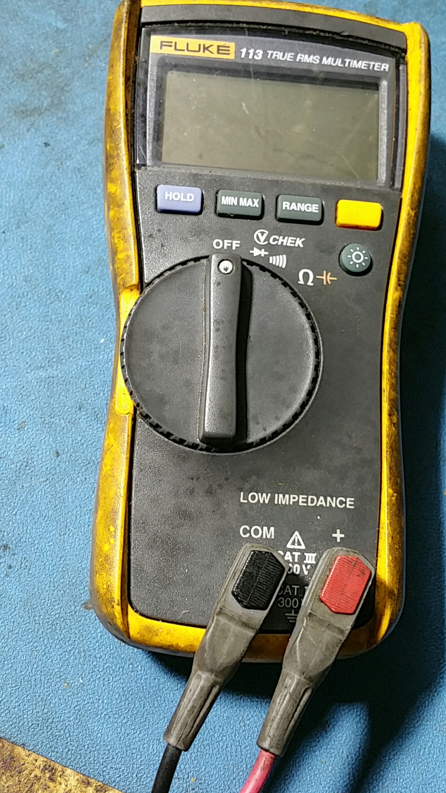

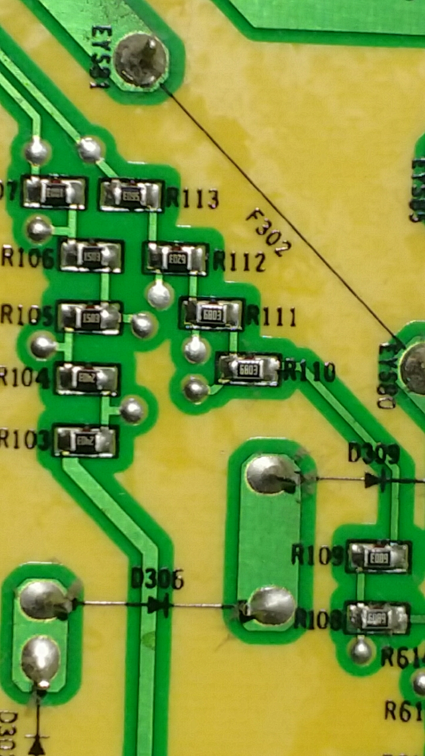

    I DID THE FREEZE test a nothing happen. In Parts r1108 thru r1113, how do i set my multi meter.
      Re: LG 60pk550 turning on and off
      Ohm range.
      Test the 3 wirewound reistors first.
        I think there is something here. I test the resistor, r927 = 10.3 r928 = 10.2 r929 = OL
          There's your problem
            Change all 3
            Don't just change the one that's bad.

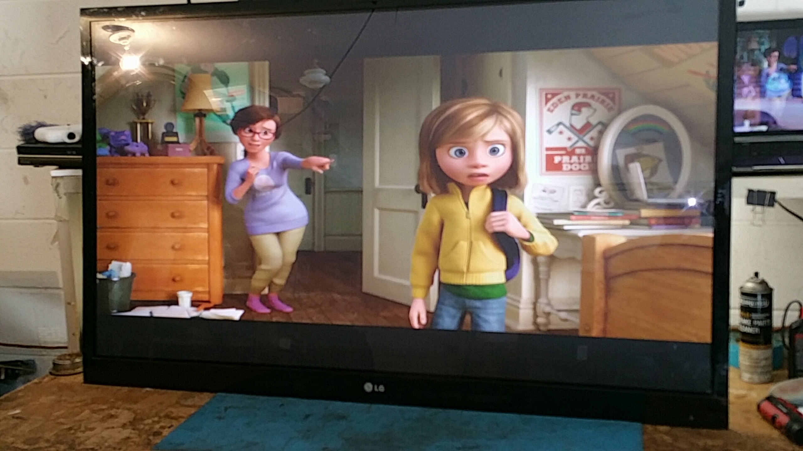

              ok, let me go ahead and change it. I will keep you post it. thanks for having patience with me.
                I love this side and the people that take from there time to help other. HAMIE, this is one more for you and your team, job well done, what surprise me more is your patience to work and explain to a person that know not much about electronic. I feel like a champion, especially when i show it to my wife. But between you and me, you know who the champion is. Thanks, Champ.
