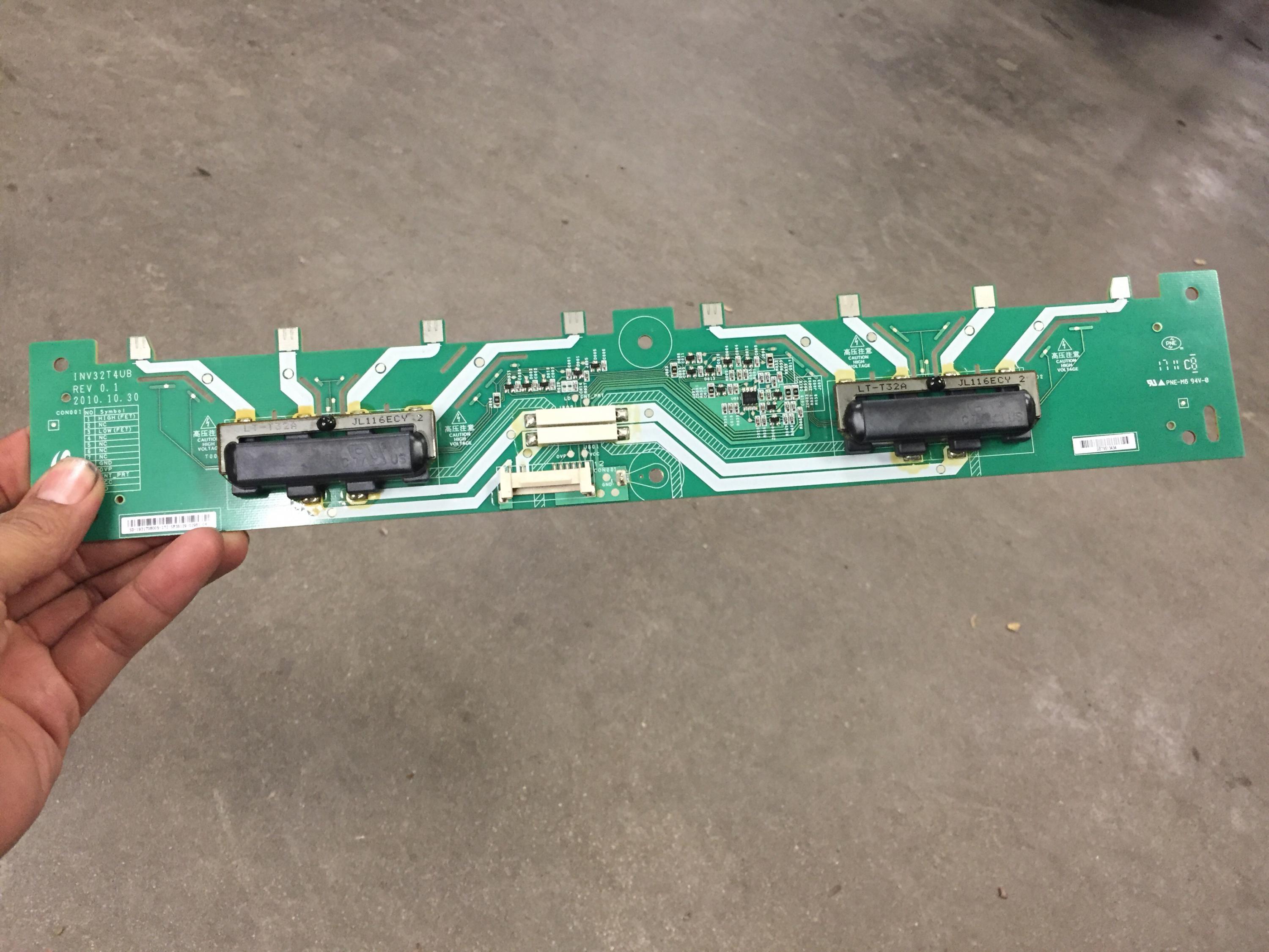

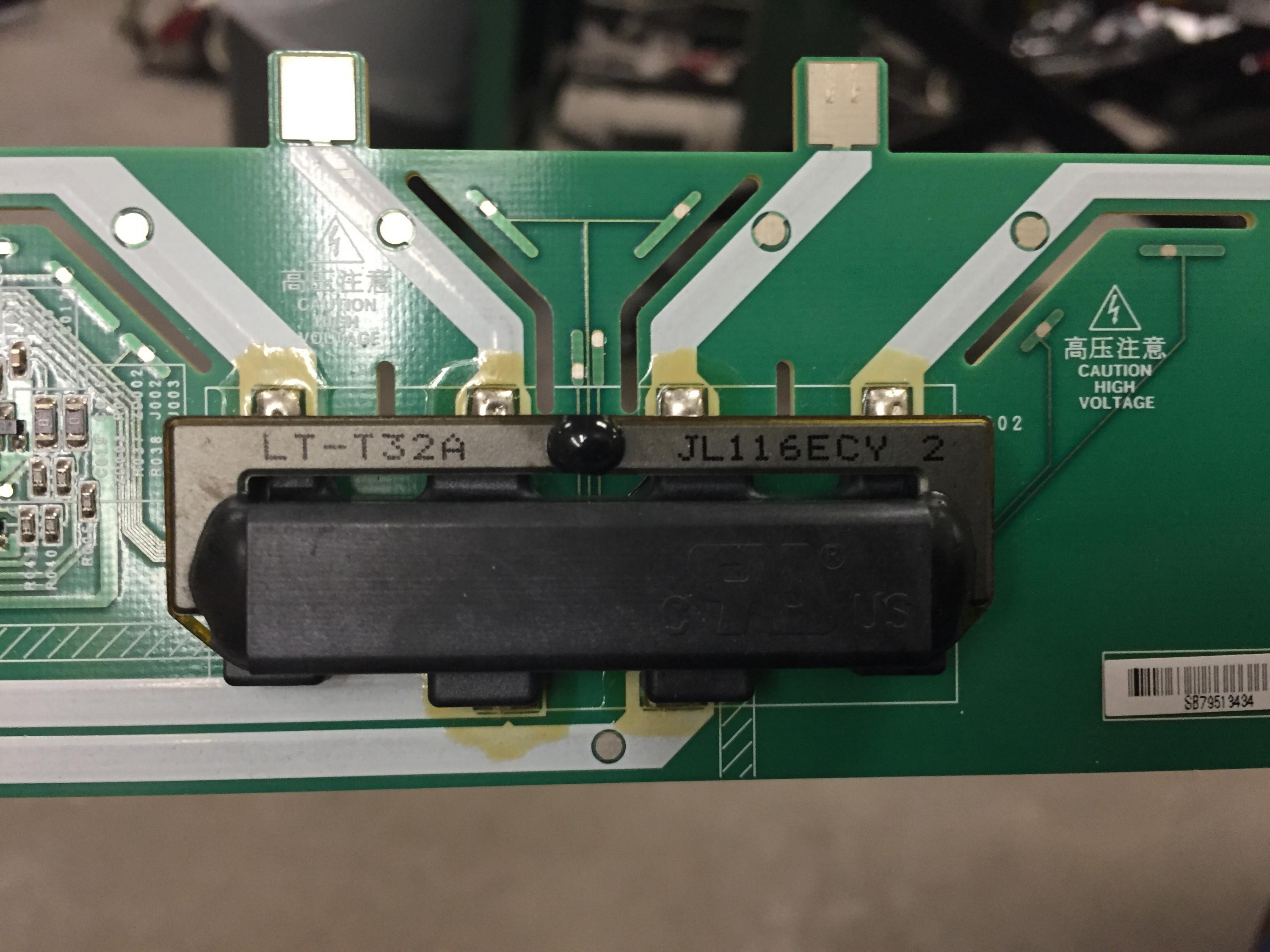

Does any one know what the primary and secondary resistance specs are for this lt-t32a.
Samsung Lt-t32a transformer
Re: Samsung Lt-t32a transformer
Did you do the resistance comparison readings?Never stop learning
http://www.badcaps.net/forum/showthread.php?t=24809Comment
Yes a little off. Primary 1.50 ohm left side 1.55 ohm right side.on secondary there are 4 pins 1 and 2 read .9793 k ohms 3 and 4 read .9775 k ohms the other one right side 1 and 2 read .9978 k ohms 3 and 4 read .9959 k ohms.do they look bad?Comment
They are within 3% so they are fine.

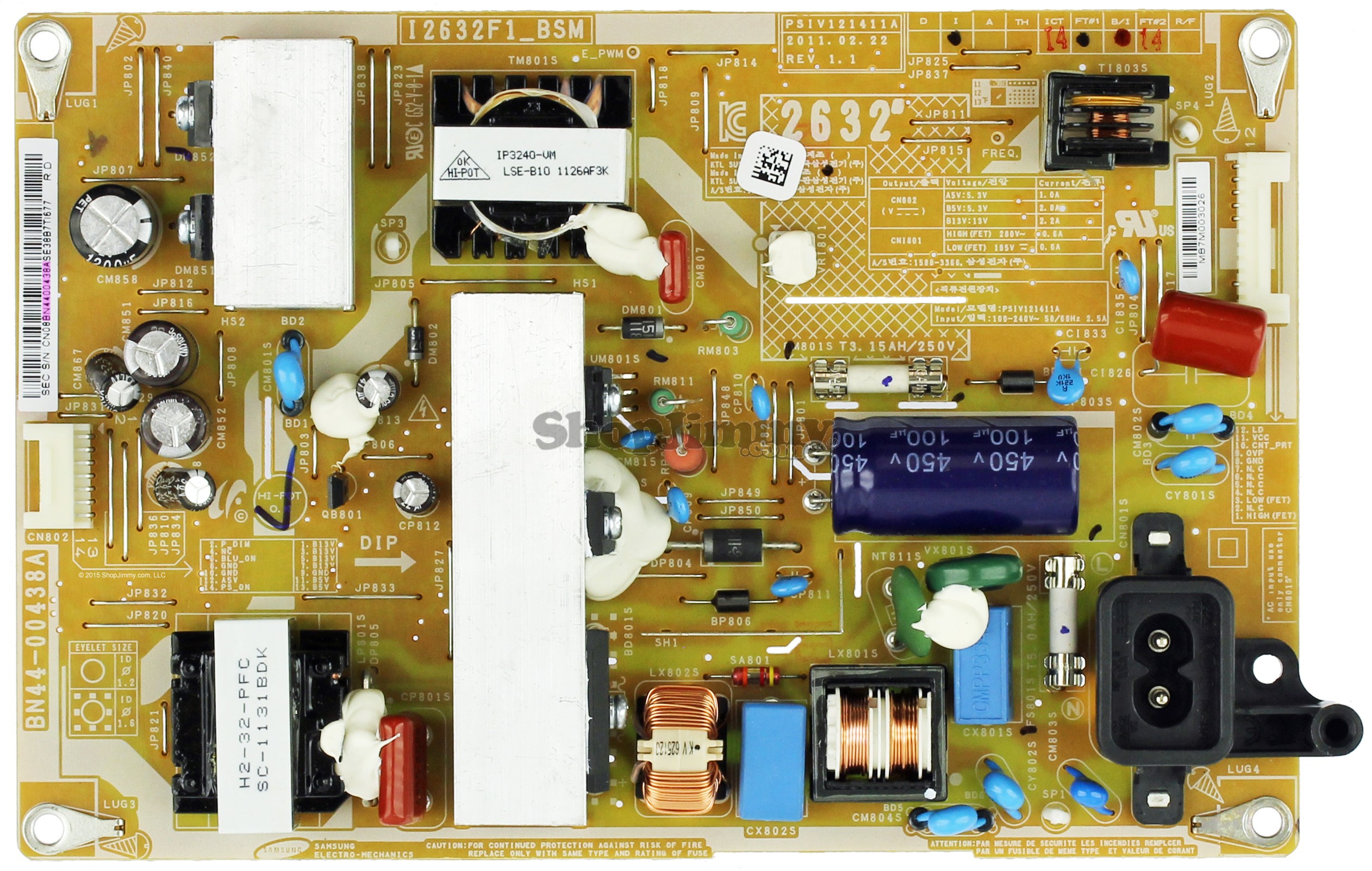

Checked VCC to inverter also what about the fuse ?Please Do Not PM My Page Asking For Help Badcaps Is The Place For Advise, Page Linked For Business Reasons Only. Anyone Doing So Will Be Banned Instantly !
https://www.facebook.com/Telford-Tel...7894576335359/Comment

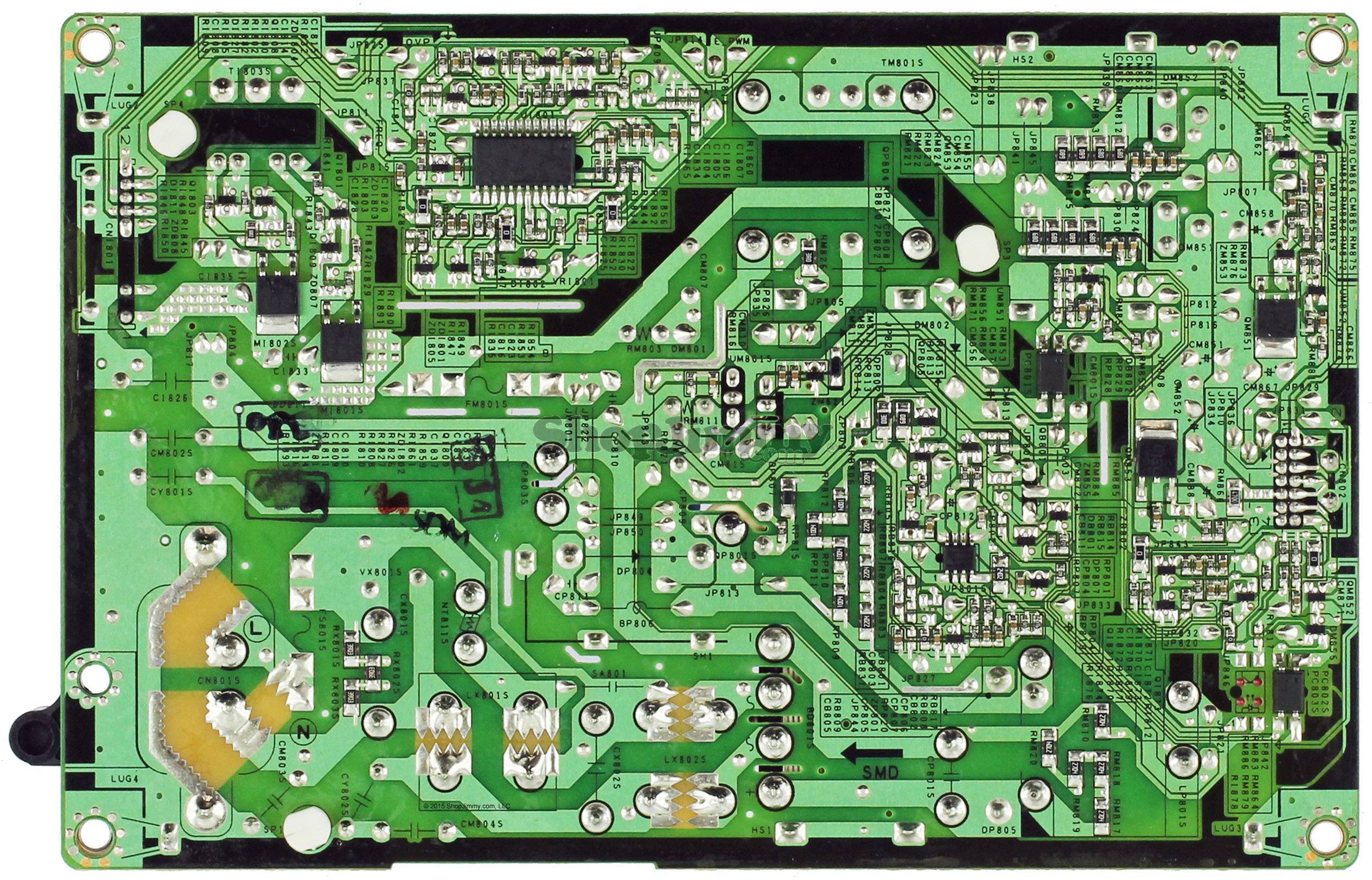

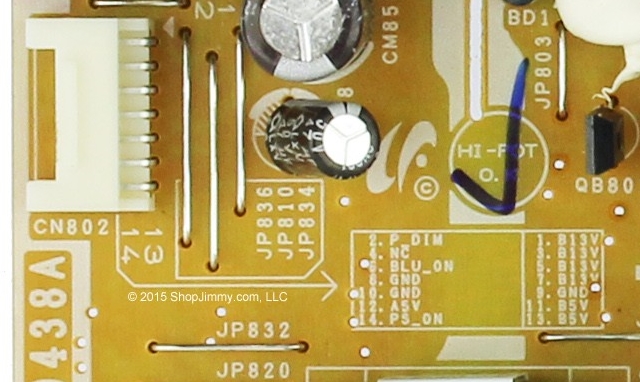

The board with the high Voltage inverter transformer is just transformer board, the transformer drive circuit is on the power supply board.
So you need to find out first if the power supply is getting the command signal from the main board to turn on the power supply and the inverter circuit.
