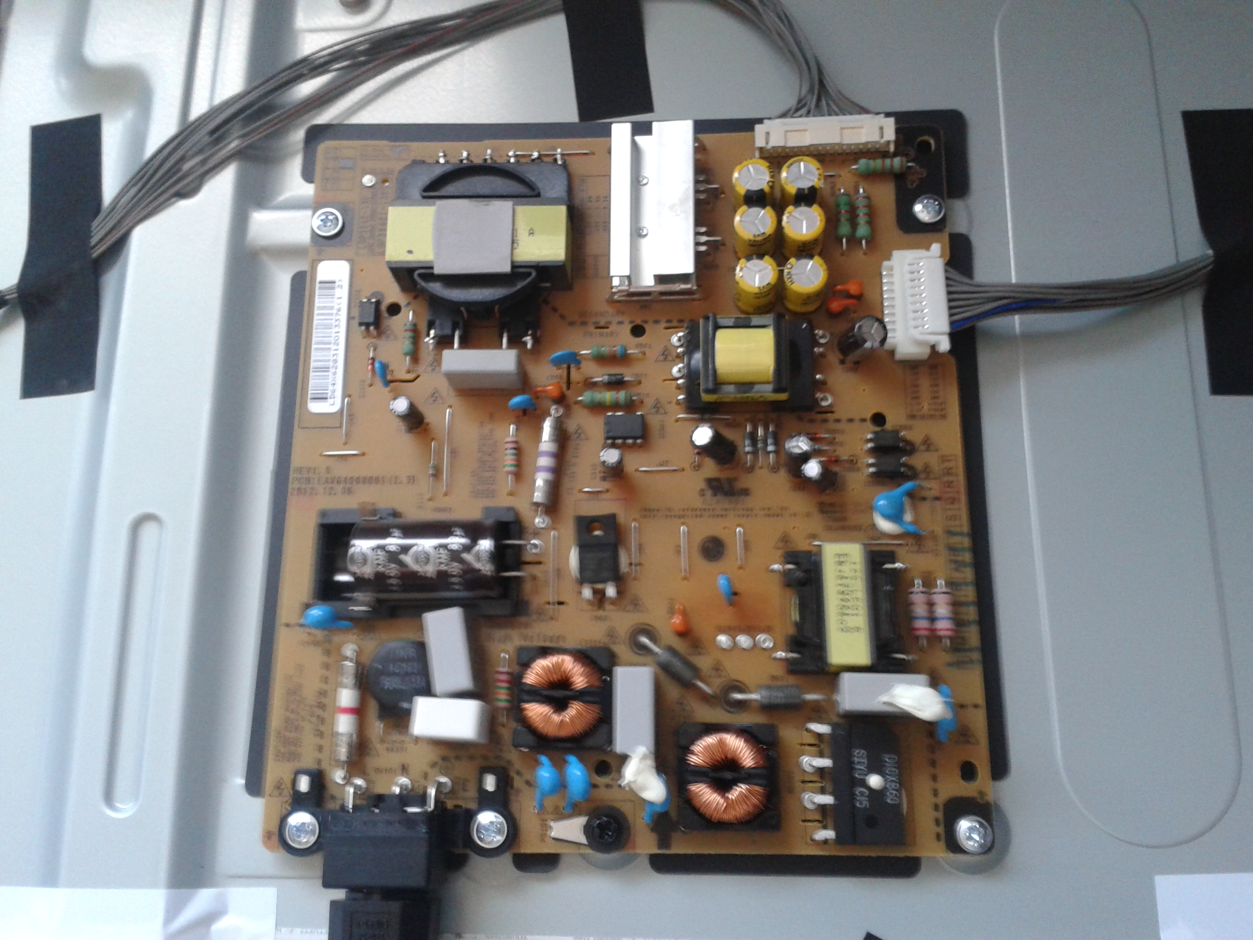

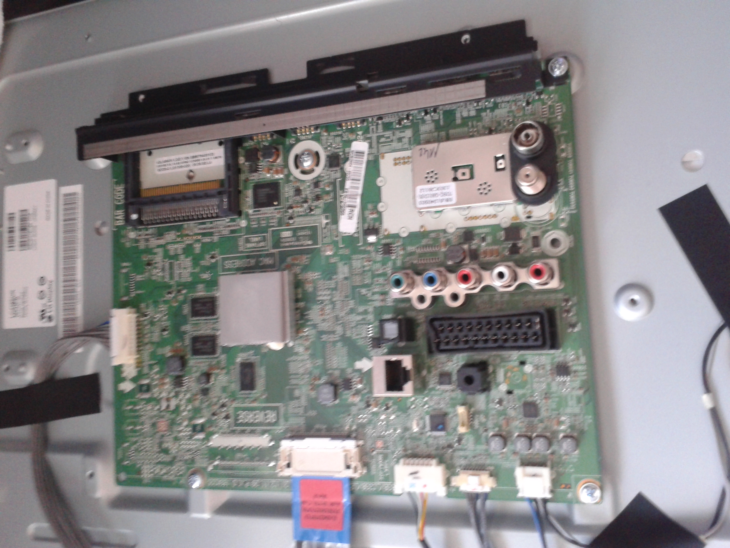

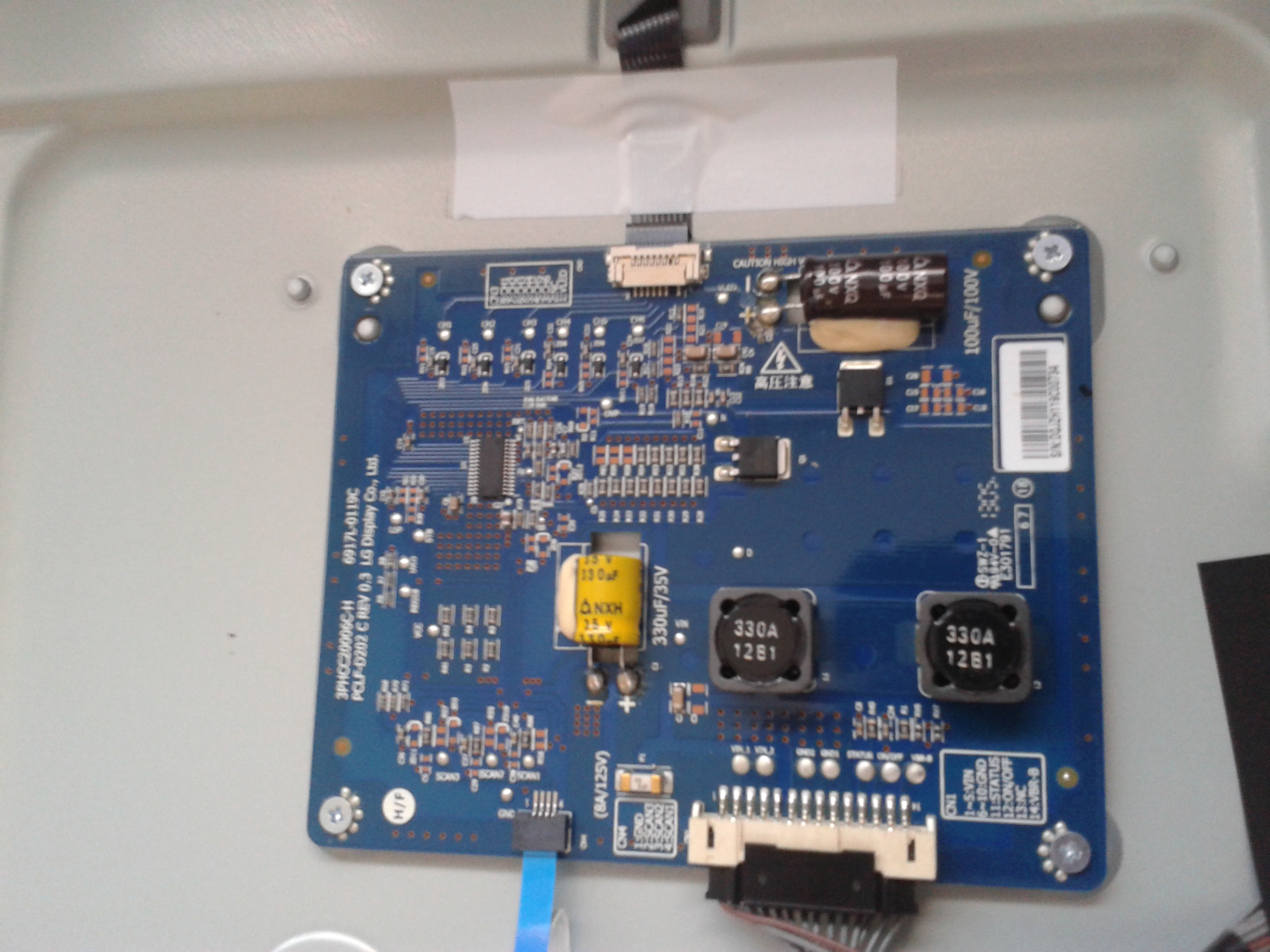

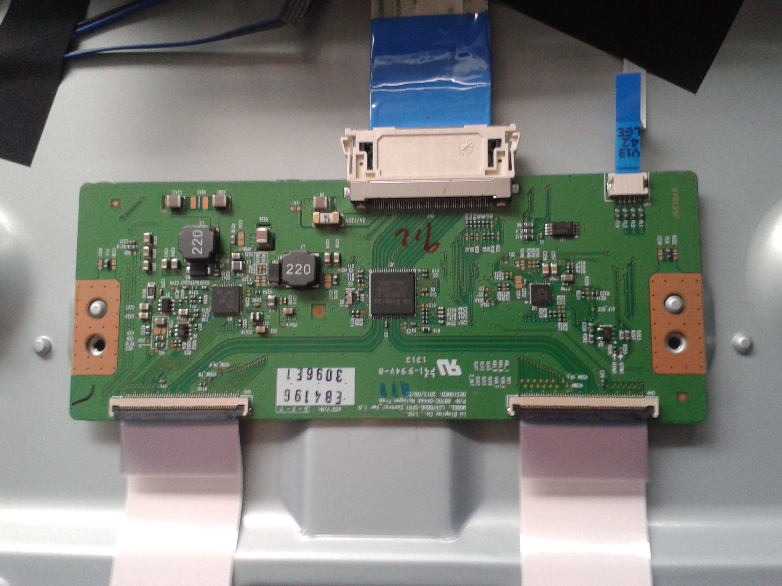

    Lg 42l641v
    Got this LG tv, no picture or backlights, check volts and get 24v ok, but blon only .01v, so suspect mainboard, can these be swapped out ok?
  • riget
    • Sep 2011
    • 66
    Re: Lg 42l641v
    Found a burnt ic, think it's to the hdmi circuit, all working fine again now.
