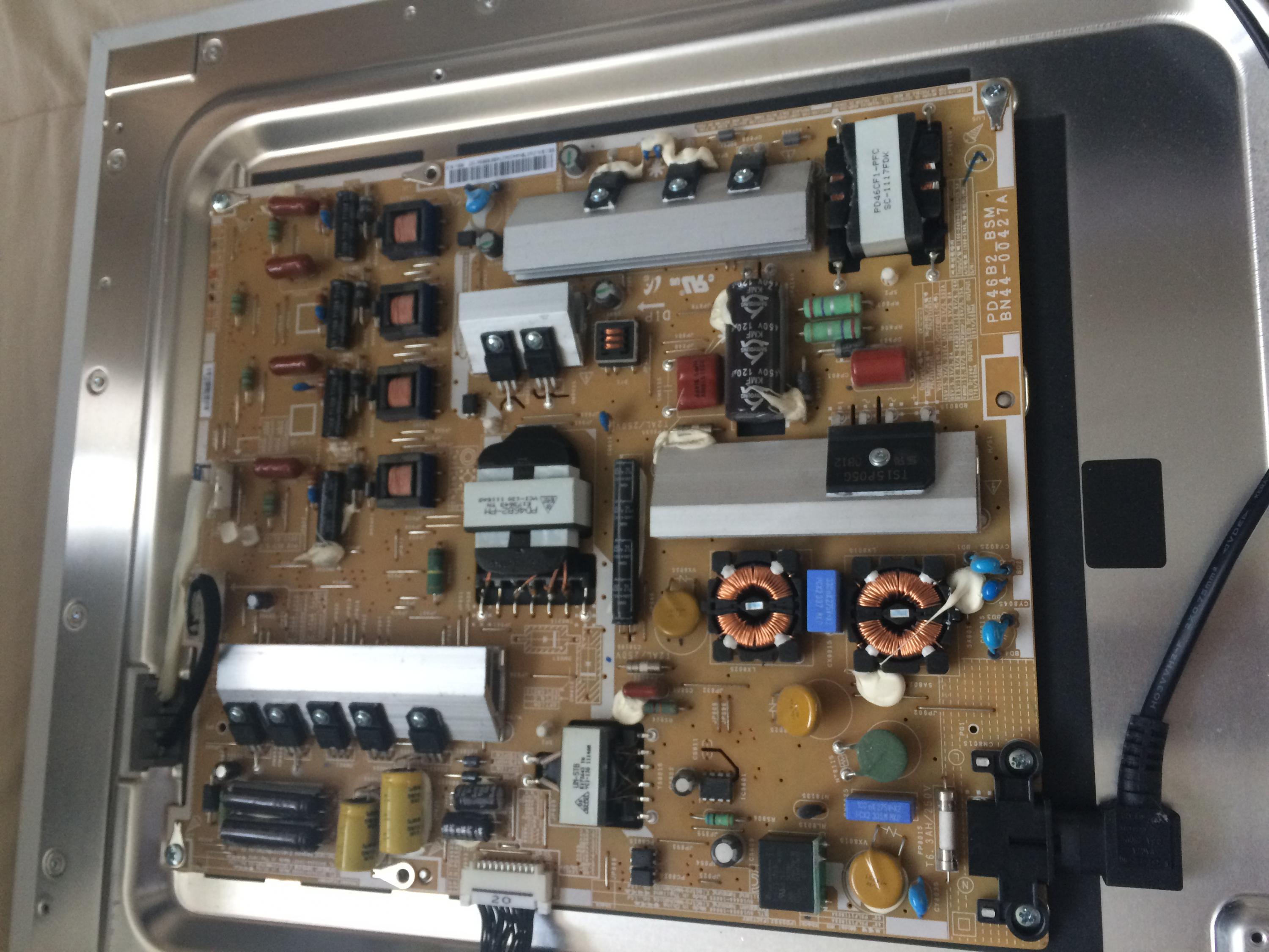

    Hi i have a samsung ue40d6510 which comes on fine but after 10-15secs turns itself off. It does not come straight back on unless turned on by the remote/on button. Ive checked the caps but none are bulging.

              Re read my other post again. A PSU with a pull up resistor doesn't need the main board with the power button to turn on the backlight.
                Re: SAMSUNG ue40d6510 TURNING OFF AFTER 15secs
                OK, the power supply/LED driver board has built-in pull-up resistors to allow you to do the self test of the power supply and the LED driver circuit without the need of the main board. So unplug the TV from the outlet, then unhook the cable between the power supply and the main board, plug the TV AC plug into the outlet, then you should see the backlights come on and stay on as long as the TV is plugged into the AC outlet (the main board is not active at this point).
                If the backlights stay on then you know the power supply, LED driver, and the Backlights LEDs are OK, if not then you need to do more troubleshooting of the power supply circuits, LED driver circuits, and testing of the LEDs.

                  Right I've plugged the Tv in with the cable to the main board loose so theres a connection to get the Tv turned on. Tv comes on but if i remove the cable to the main board tv goes off straight away. Does this mean the main boards at fault?

                        un-plug main board ............ plug tv in and it does a self test and the backlights will come on like magic see if they stay on
                        its a self test ciruit built into the power supply just un-plug main board nothing else then plug into mains supply simple

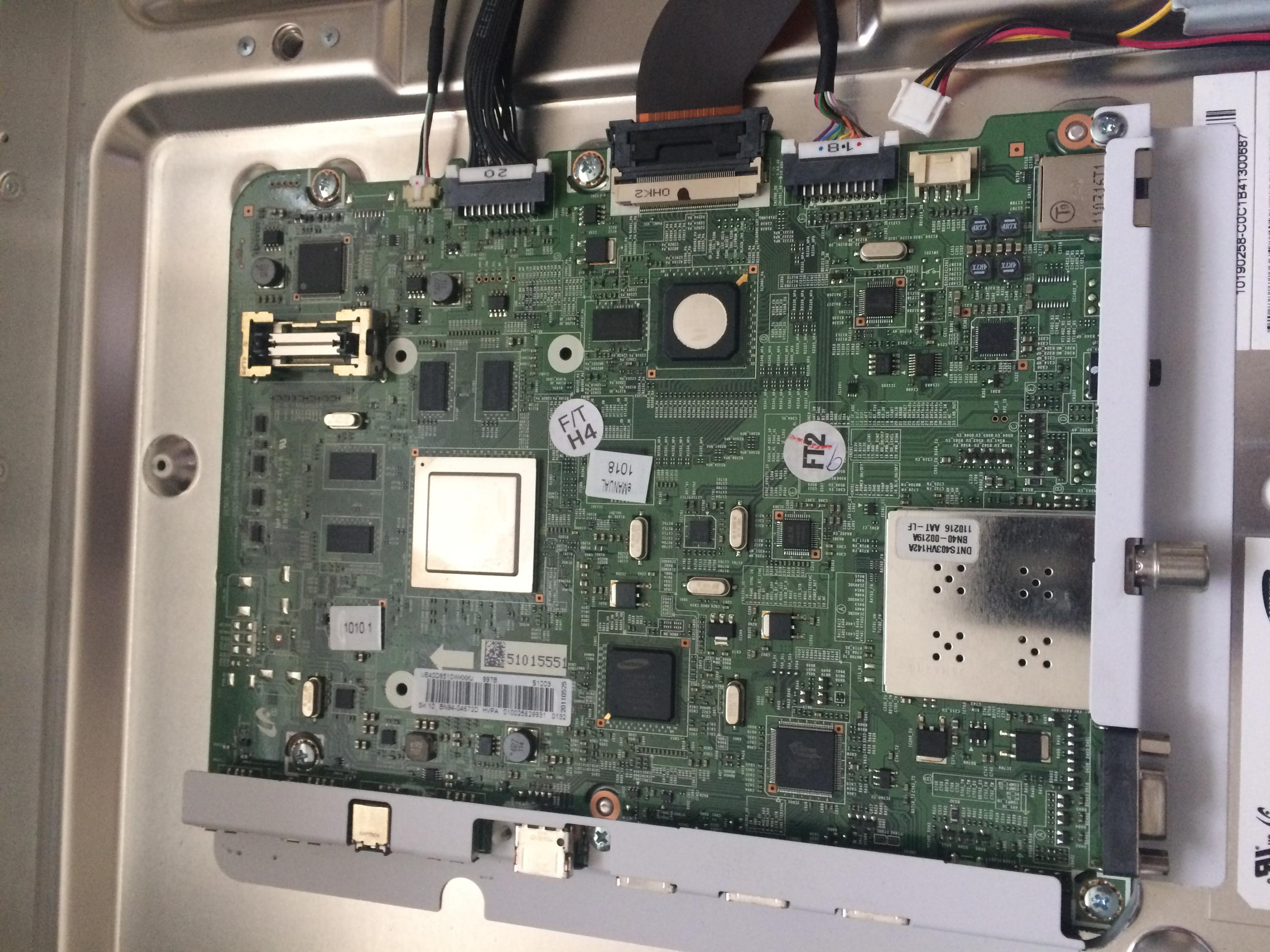

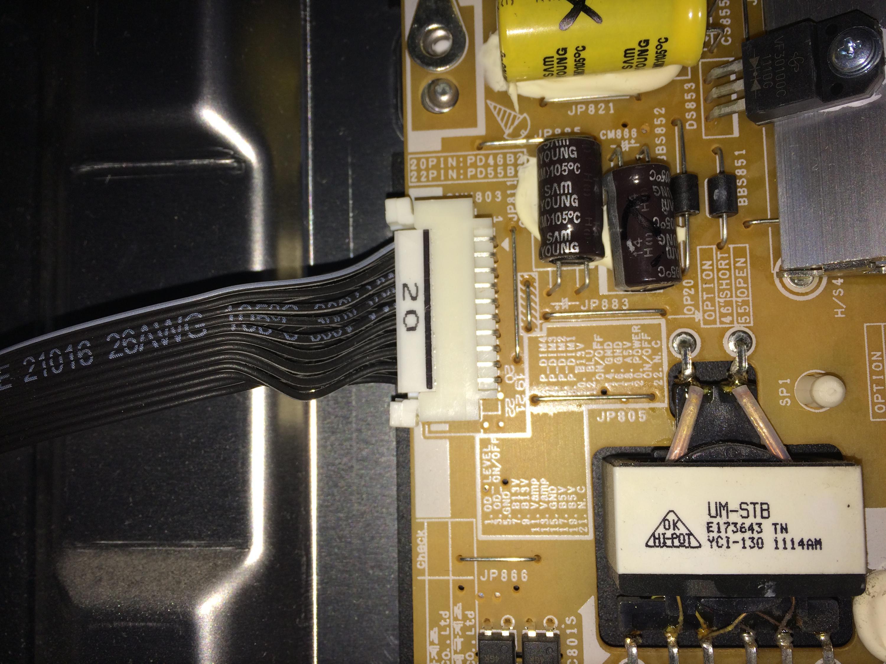

                          • Hamie
                            • Apr 2014
                            • 1383
                            Unplug this wire here:

                              Right guys sorry for the blonde moment. Tried this and no Backlights come on. What should i try check next, caps, diodes, resistors. Also maybe worth a mention that the Tv clicks when coming on and turning off but I've never come across this before.
