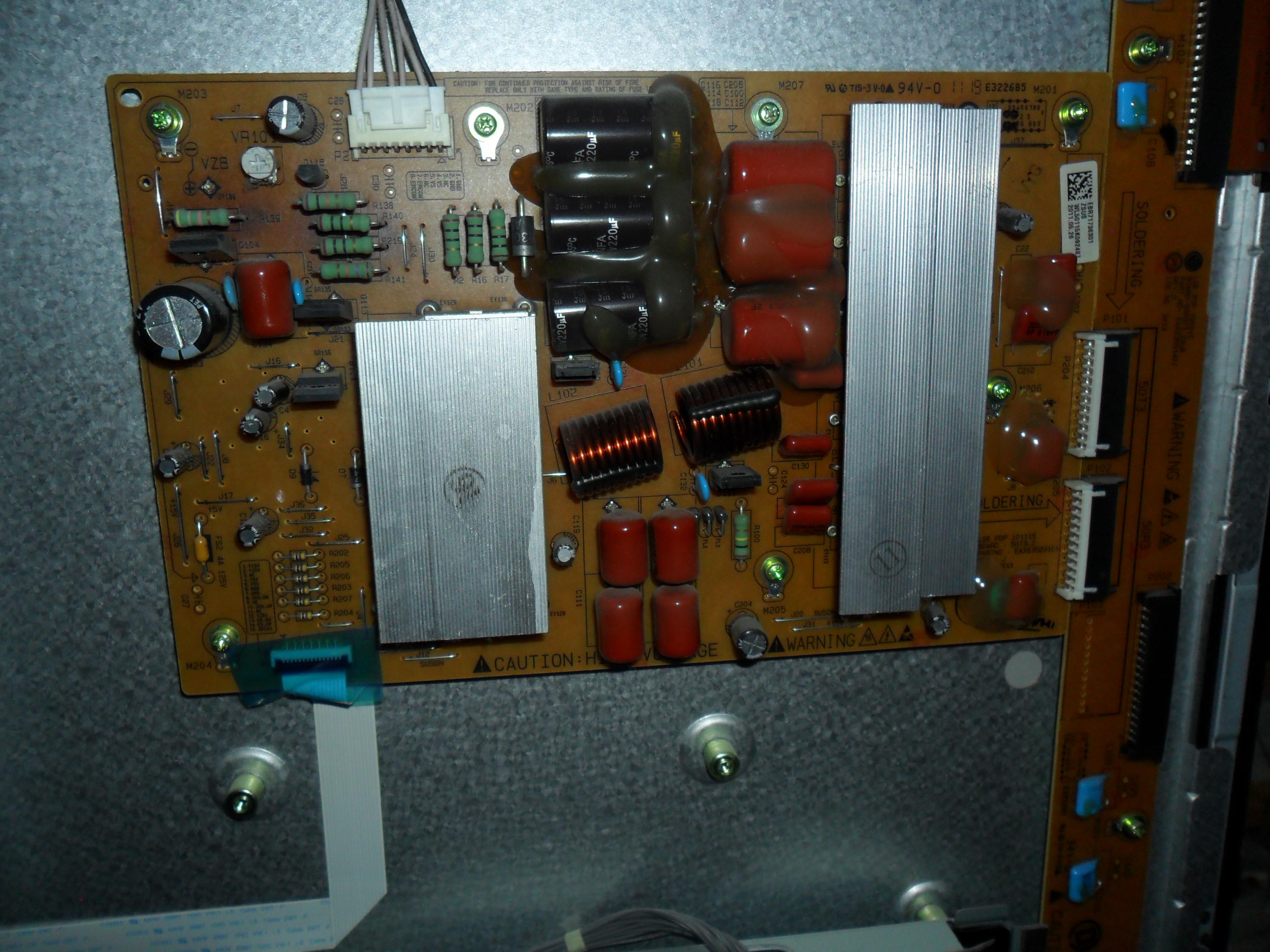

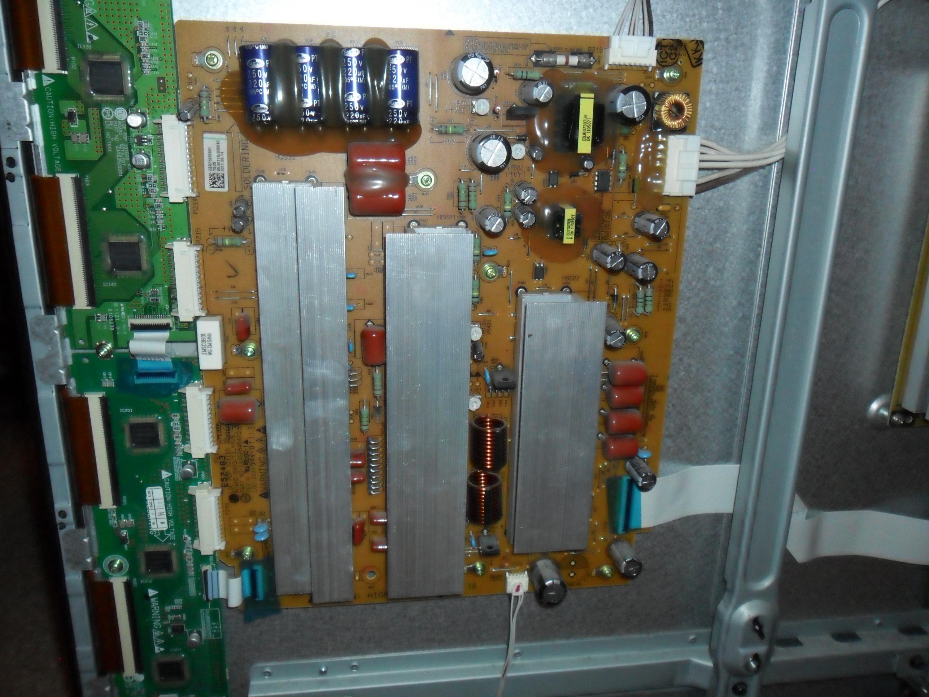

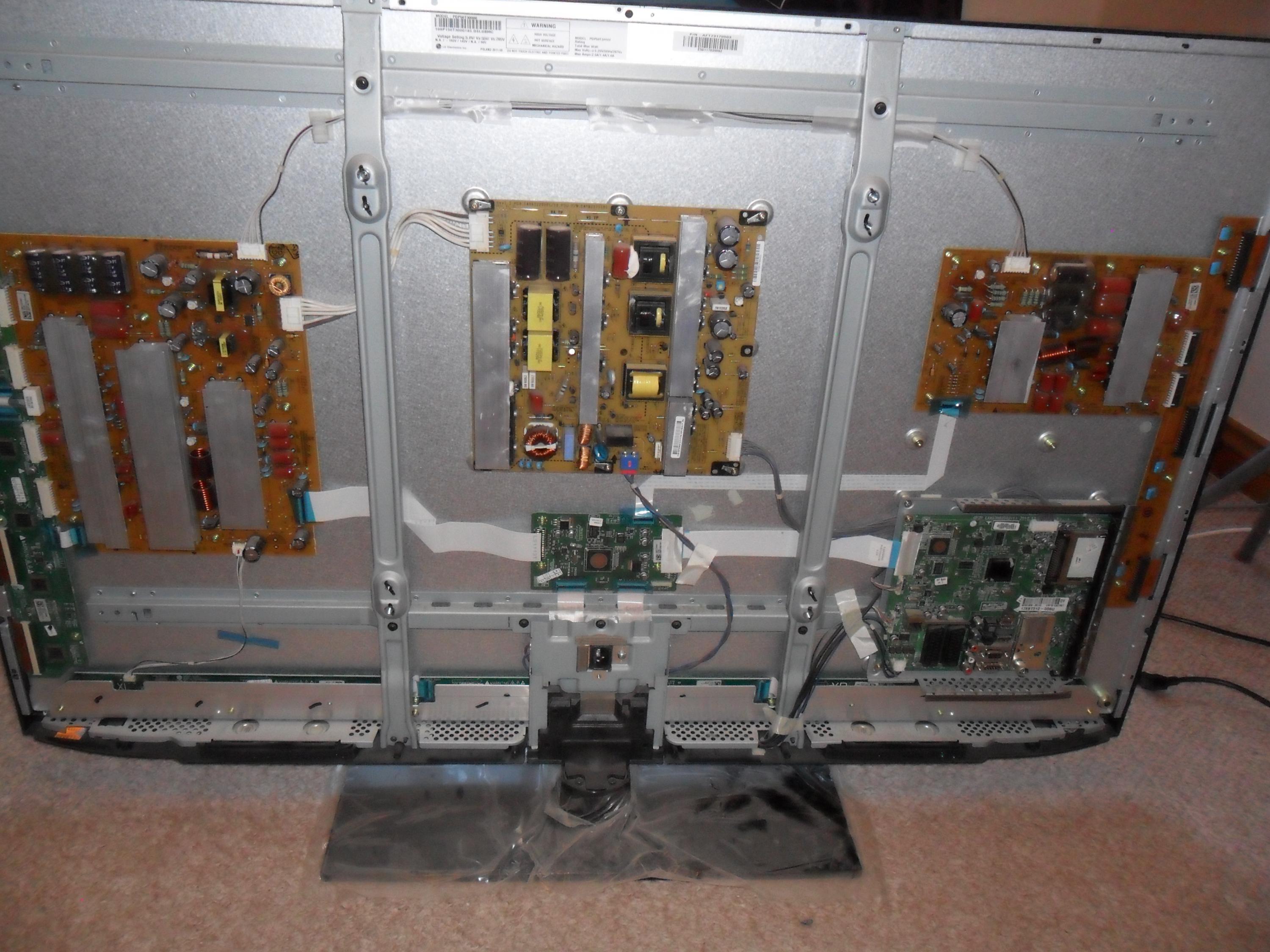

    hi i have the above tv havent troubleshooted much as unawre where to start things i have done checked the fuse on the ysus board and it read 00.3.left the tv on for 30 mins to check the heatsinks.heatsink on the zsus was very hot heatsink on the power supply warm and heatsink on the ysus warm.thats about as far as i have got as above the problem with the tv is that there is sound but no picture.any help much appreciated.there is a green light flashing on board below the power board.

    Please upload pictures of all the boards singularly.
    I need to see the test points.
      Re: Lg 50pw450t sound no picture

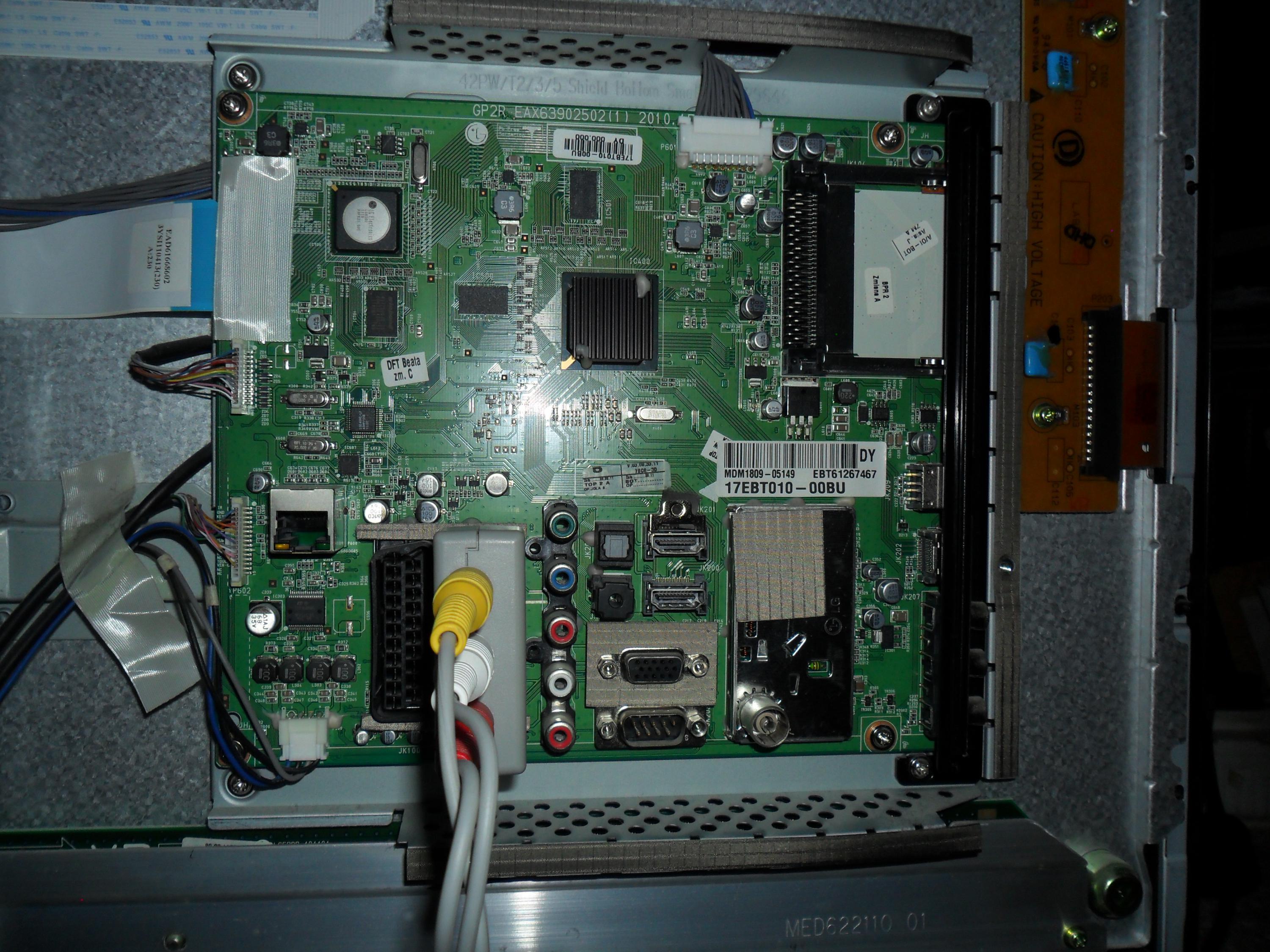

      hi thanks for your reply these are the boards.

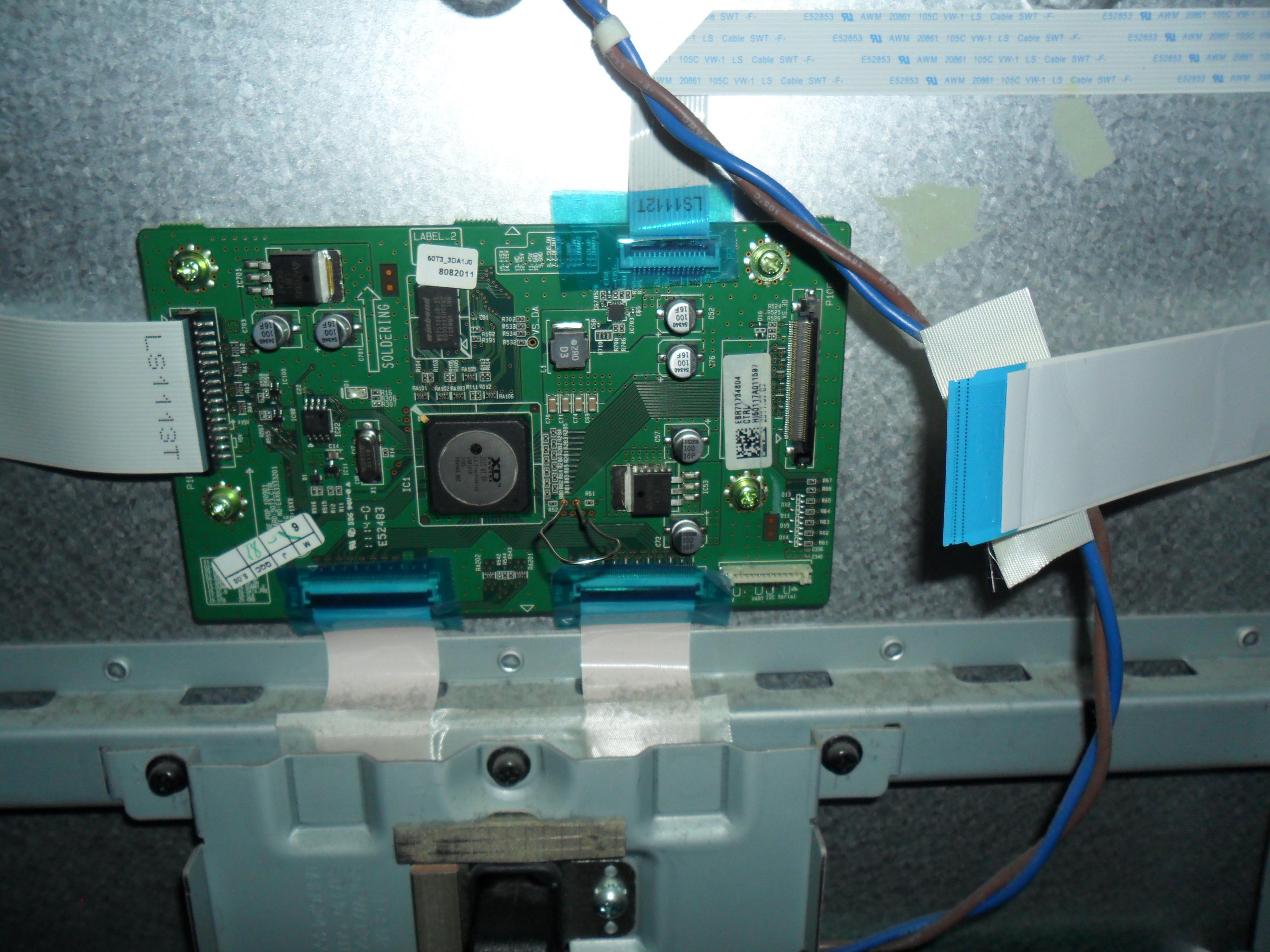

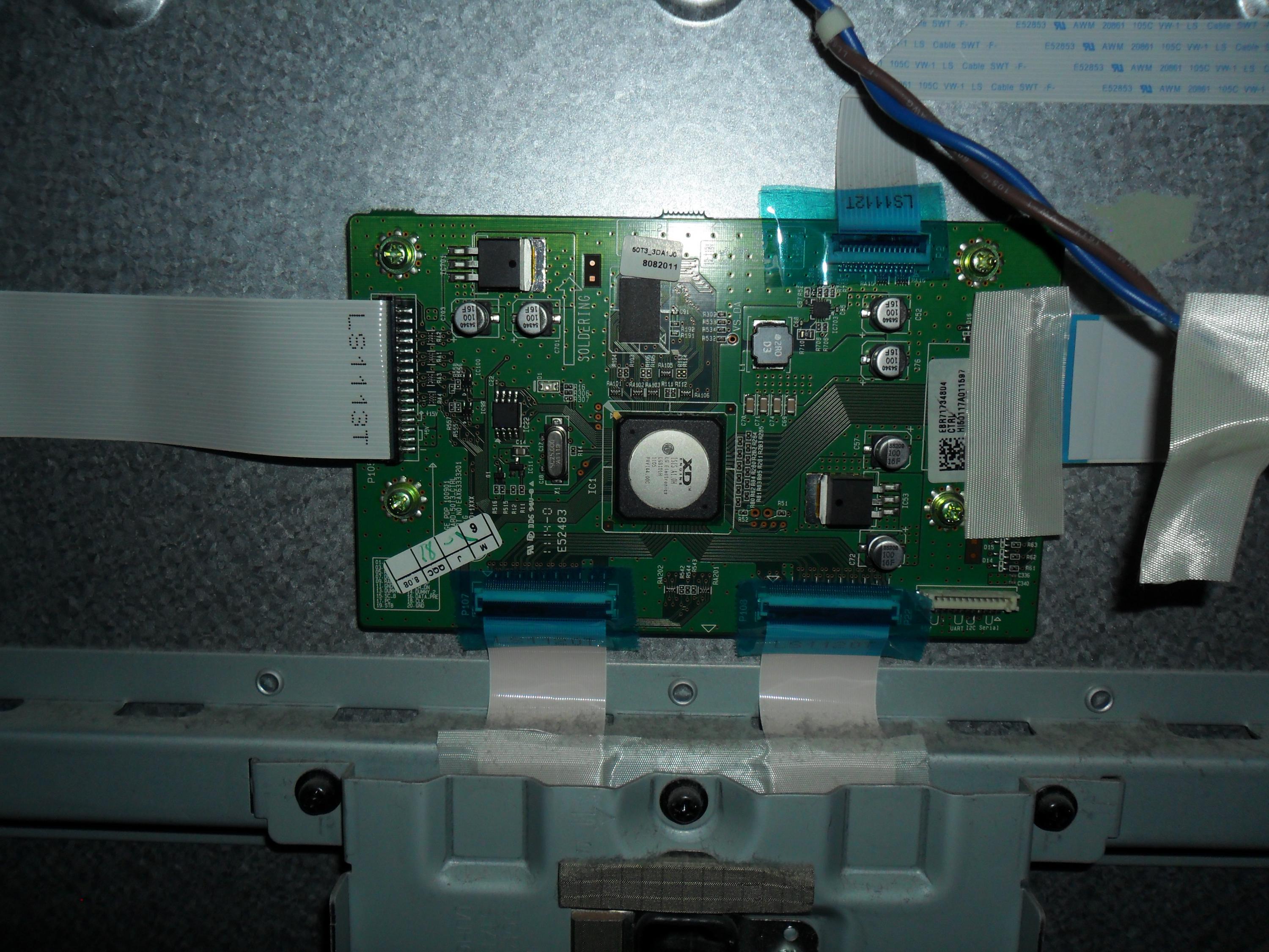

        Ok on the control board. (The one with the green flashing LED)
        Connect these 2 holes beside r51 and r52 with a paper clip, but of wire etc.
            Now peel back the tape, lift the latch, and disconnect the LVDS cable,
            Here:
            Power on the tv.
            Do you get test patterns on screen?

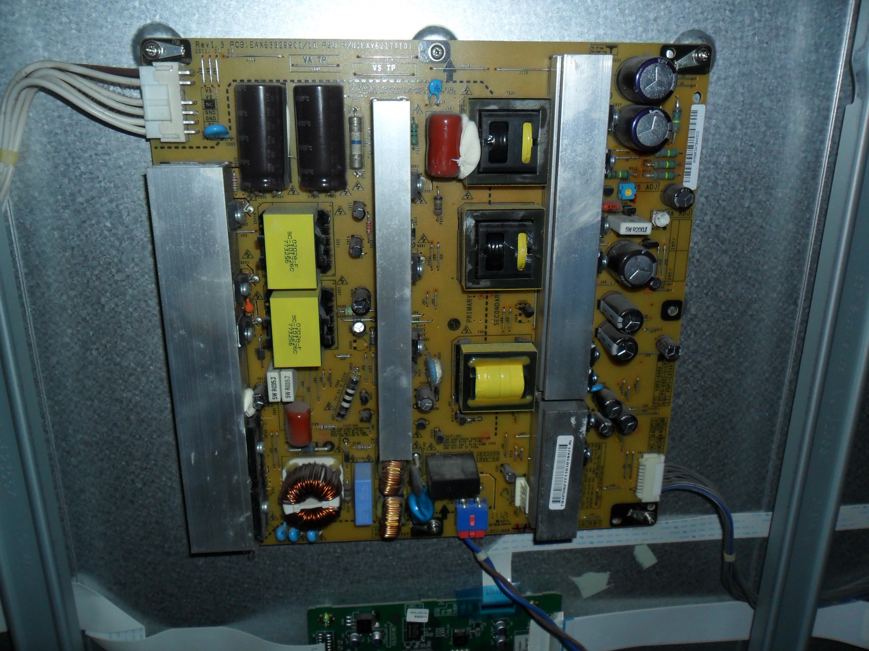

                        Ok you need to check voltages.
                        VS and VA on the power supply.

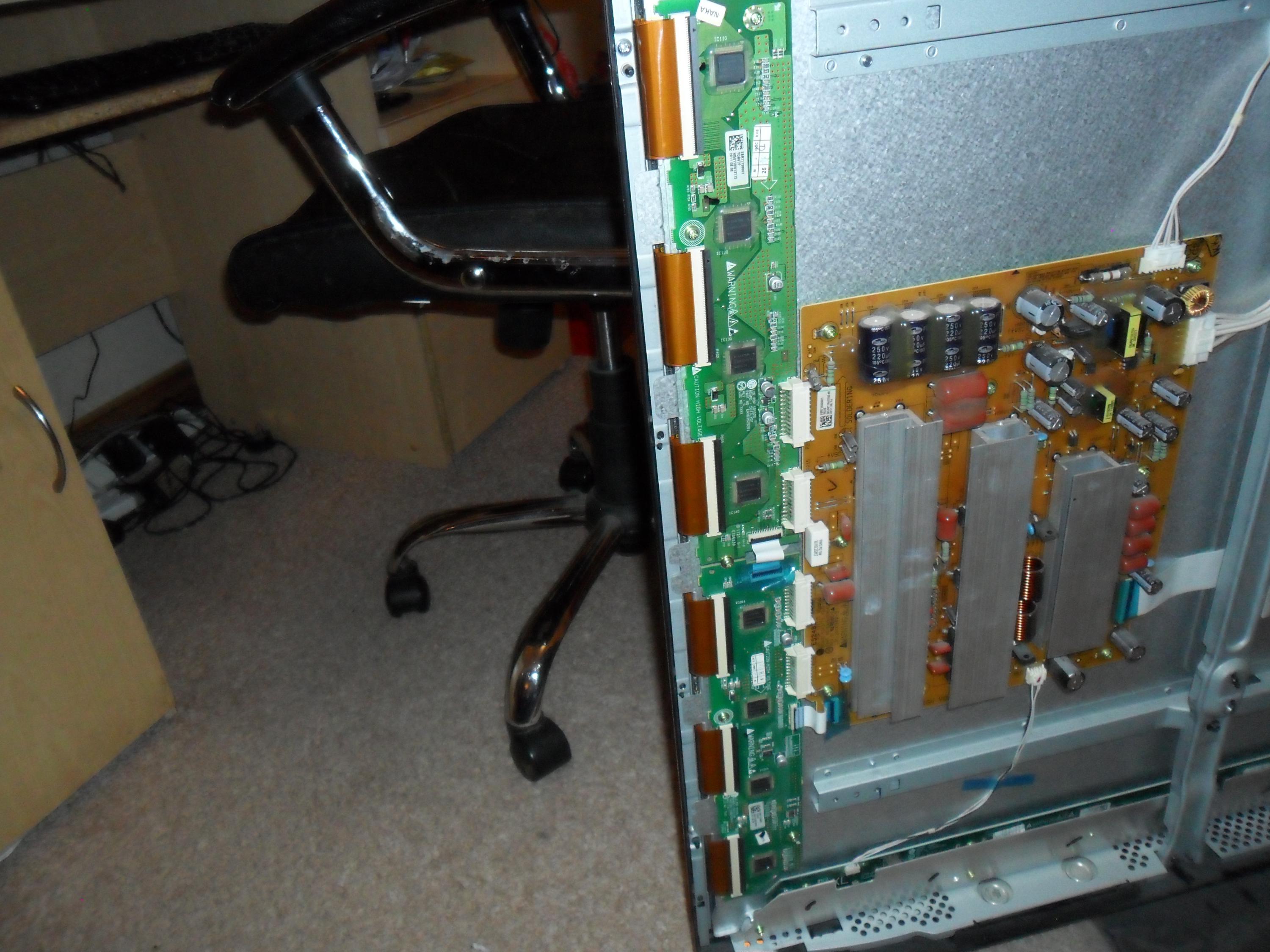

                        VSC and VY on the Y-sustain
                        Z-Bias on the z-sustain.
                        VY and VSC are measured across a resistor.
                        Put you probes at the corresponding - +
                        Post your results.
                        *please note that the voltages may, rise then fall, so you may need to quickly measure them whilst turning on and off the tv.

                              ok after reconecting the zsus board to the ysus board the tv turns on but goes straight to standby which wasnt happening before.removed zsus board from ysus board to check the voltages and the powerboard vs is 204 and the va is 54 can you point out where the vsc and vy are on the ysus board.so can i check the zbias on the zsus board in standby?thanks
                                ok checked the vsc on the ysus board and it goes from 003 to 001.the vy is 096 these readings are with the tv on and the zsus board disconected.because when the zsus board is connected the tv goes straight to standby which has just started happening since i tried that jumper test.
                                  Are you measuring the VSC and VY across the resistors?
                                    yes i put the the 2 multimeter prongs on the resistor 1 on each end.

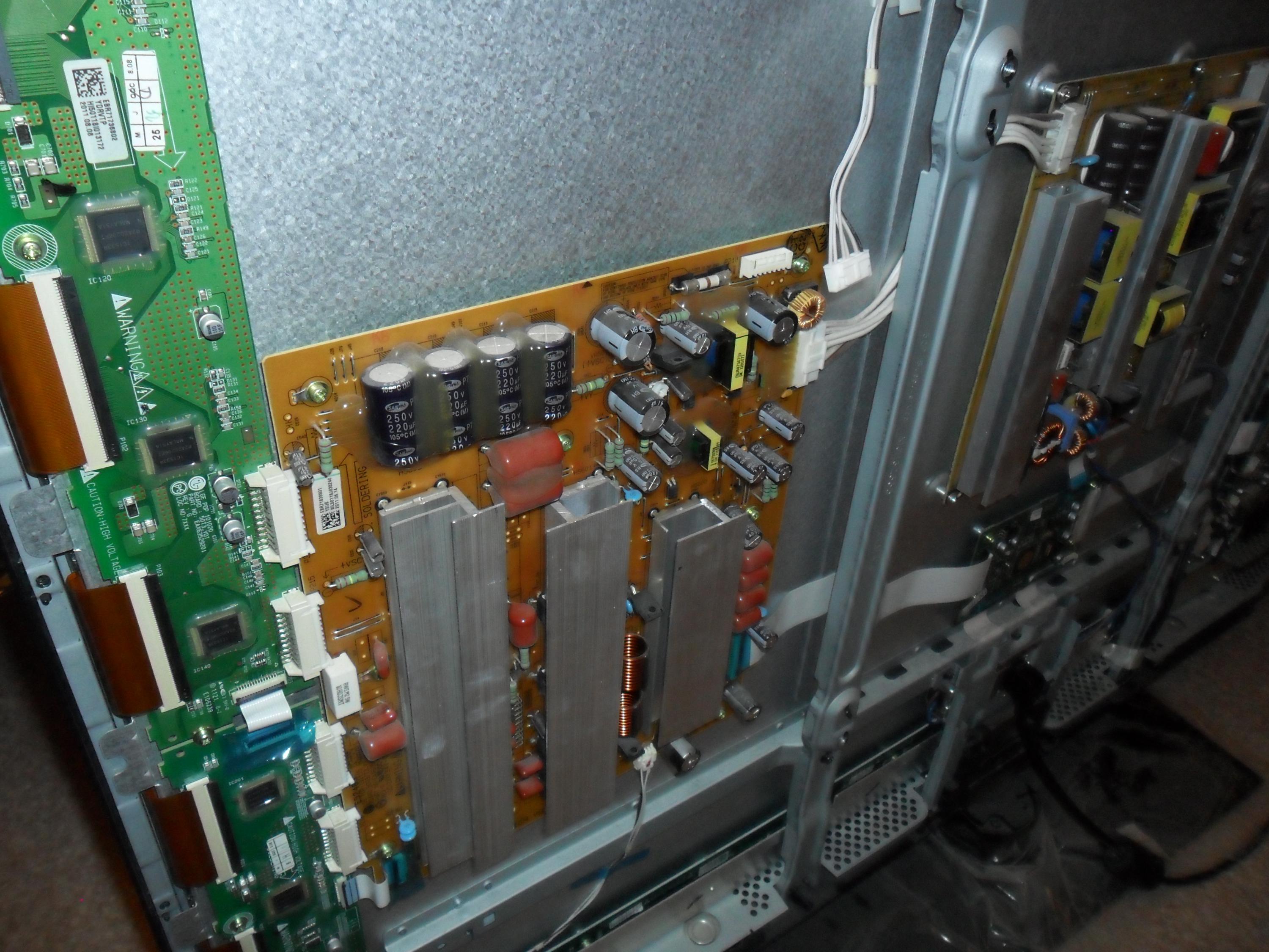

                                      And what are the VSC and VY voltages with BOTH buffers unplugged?
                                        Is this plugged in correctly?
                                        Might just be the camera angle but it looks like it's at an angle.
