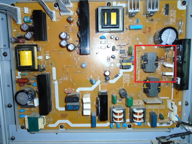

    Hi i have a toshiba regza 55zv635d here,
    fault from the person i got it off (for £40) says the house electrics went and it wouldnt switch on again after that!
    so on first test plug in tv green led comes on at the front for about 9 secs then red led no flashing just steady green/red..
    inspected power supply no bulging caps, no dry joints, fets and bridge rectifiers seem ok no shorts the 3 fusable resistors measure ok theyre in series, only the lower relay clicks on, there is a green led that lights on mainboard, also the spdif led shows red, after about 5 mins relay clicks off green led on mainboard and red spdif led go out, all the time red led on front stays on.....
    press power button on switch panel relay clicks front led goes green and then turns red again after 5mins (approx) and that is all its doing, tried disconnecting inverters and makes no differance
    tested voltages on power supply with all plugs in place and are as follows

          hi Jeffecor i noticed the burn too its a resistor that gets warm is common as far as i have read it measures ok
          i jumped 5.v with pow-sig with a 1k and the 24v now appears on power supply and second relay clicks

                    Well a green light means the motherboard is getting power from 5v stand by to turn on the 12v etc if the 24v is not there I would say there is a issue with the power supply or inverter.
                    I'm still thing something is not working right on the burn side of the board. The remote idea is to rule out if the buttons are not working. Because the other boards online don't have that mark there on them and they are used boards.

                            You can disconnect that POW-SIGNAL wire going back to the main board first and use the resistor between POW-SIG pin and the STBY Voltage pin on the power supply board to force on the backlights, if other functions of the main board are OK, then you should have sound and pictures and all other functions, the we may be able to use other control signal to turn on the power supply.
                            Forget that idea, you also do not have:
                            4 pow-lcd 0 volt
                            But try the force on resistor anyway to see what happen.

                                Budm as suggested and a bit more i have done some jumping here as follows
                                LEAD______FROM____________________TO
                                RED _____5V (pin 13 pj90)_________POWER SIG (pin 2 PJ91)
                                GREEN___5V (pin 13 pj90)_________BL-ON (pin1 cn653)
                                BLACK___12V (pin 11 pj90)________12V LCD (pin 11 pj90)
                                result backlights come on no function from main board though still red light on front...
