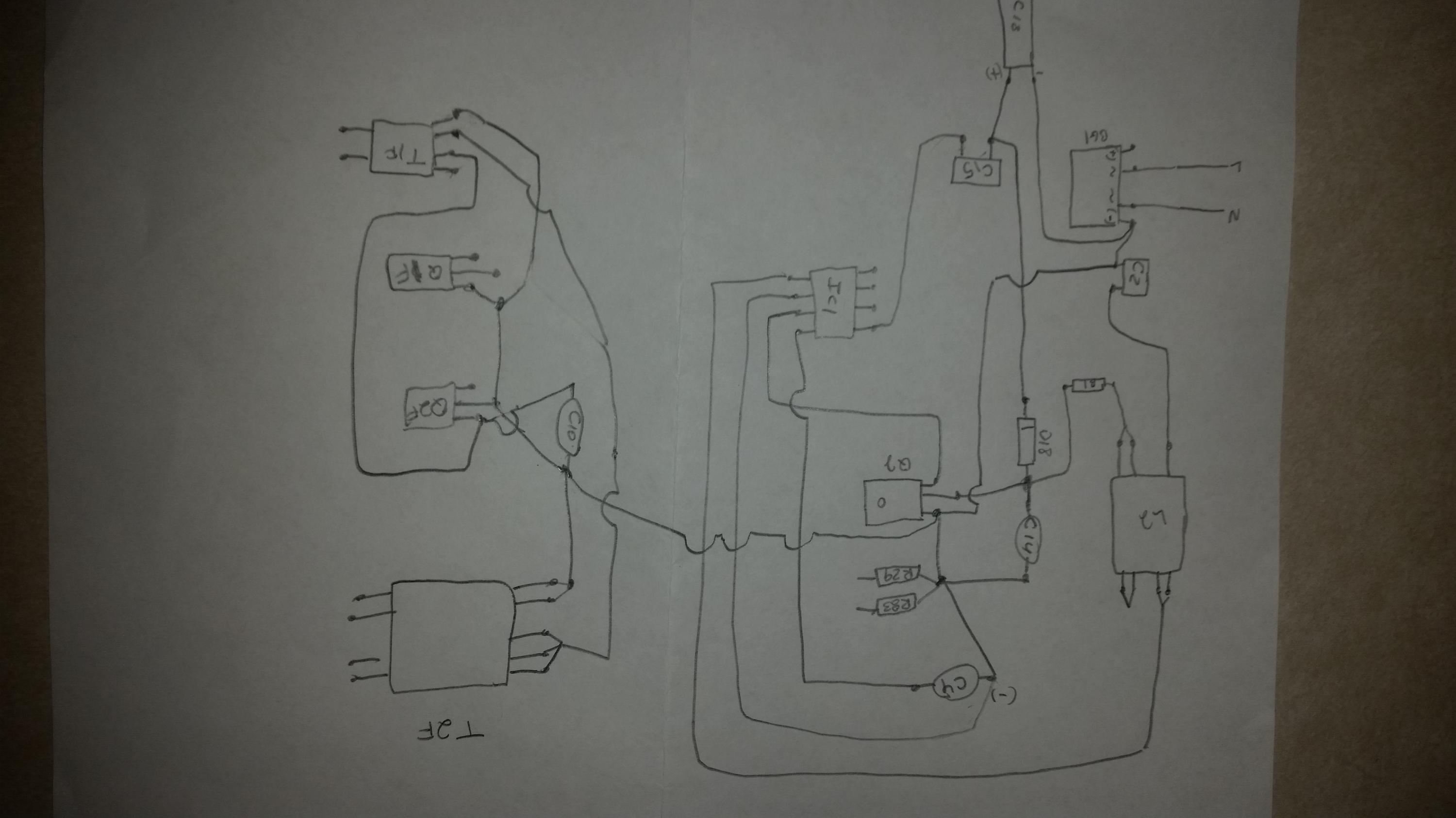

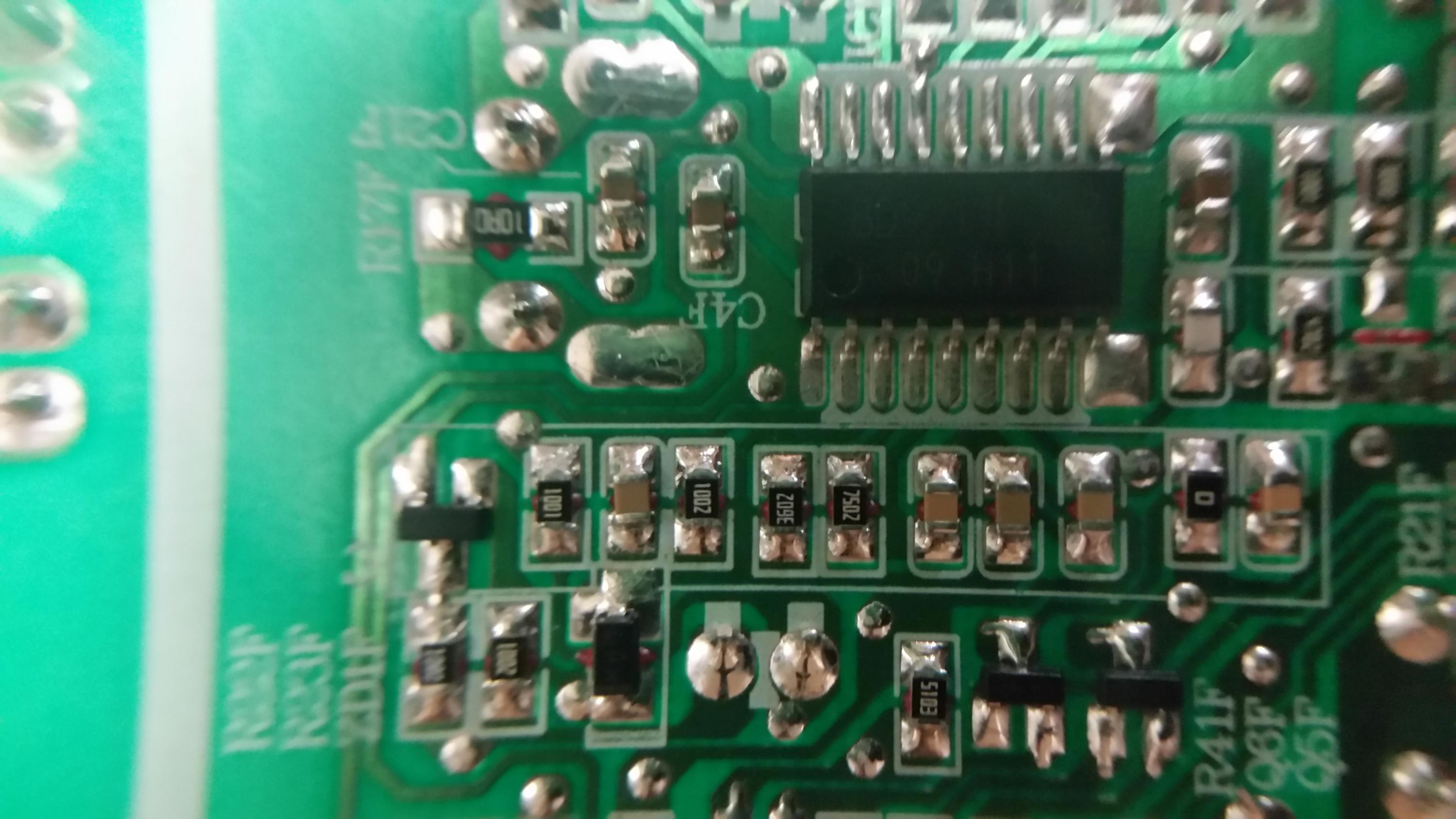

OK, so we do have Voltage for the LED driver circuit, the MOSFET Q 1F, Q2F are for driving the power transformer T2F which is for providing the Voltage for the LED driver circuit.
What DCV do you have between the two legs of the brown cap C8F, and between the two legs of brown cap C9F?
