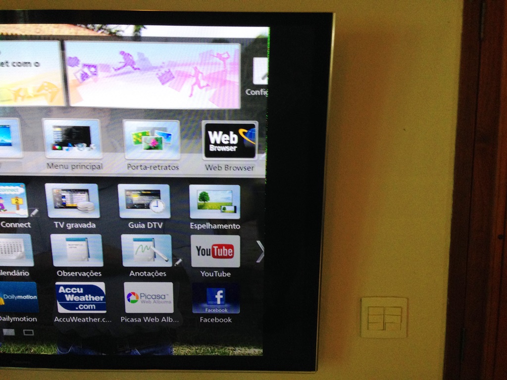

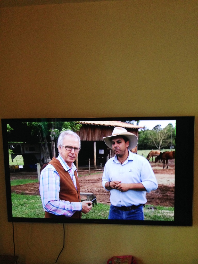

    Hi everyone, I have a Panasonic Plasma TV (TCP65VT60B ) that, before one year of use (500 hours), started to show a black vertical bar (4´wide) in the right side. Can you guys confirm if it is a bad panel problem ? Is there any chance to be other issue?
    Find attached a photo.
    Thanks in advance.
    Re: Panasonic Plasma TCP65VT60B - Black vertical bar
    Unfortunately, it does look like the panel is bad
    This is really bad, as the VT60 is a very nice TV. (I keep looking out for a cheap faulty one to fix!)
    I guess you are lucky it only affects the far right of the TV and not the centre. You now have a 63.5" display with a slight aspect ratio distortion.
